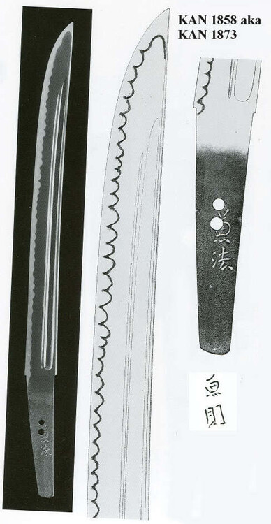

Does anyone have any example oshigata of Kanenori that moved from Mino to Echizen around 1573. He normally signed Echizen no Kuni ju Kanenori.

Hi Marius,here comes your Kanenori!According to Cox's book,it could also be the Kanenori from the "Echizen Seki Ha of Echizen",who worked in the first quarter of the 17th century:KAN 1859 (pics in Fijishiro-Shinto hen on p.48 or Tokuno on p.115,in Cox's Mino-book on p.218).Ludolf

Are you sure it is the kanenori who moved from Mino during Tensho?
I've this one where the style (tagane mannerism) is more resembling. There are nevertheless some differences
Jacques
The more I look at the oshigata the more your statement seems to be the case.
