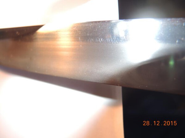

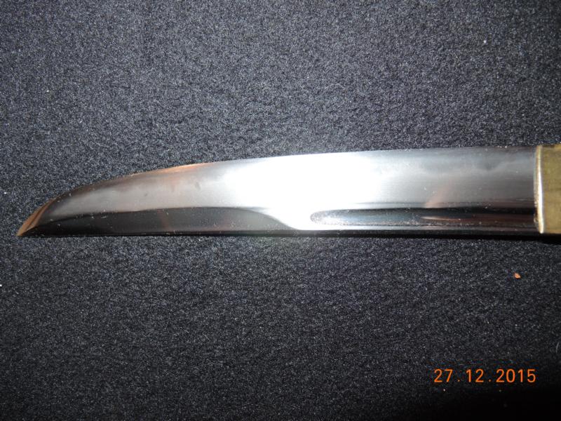

Michael 67 Posted December 27, 2015 Author Report Posted December 27, 2015 Unfortunately my photos are not good to see the ko nie crystals .. I try to make better photos 1 Quote

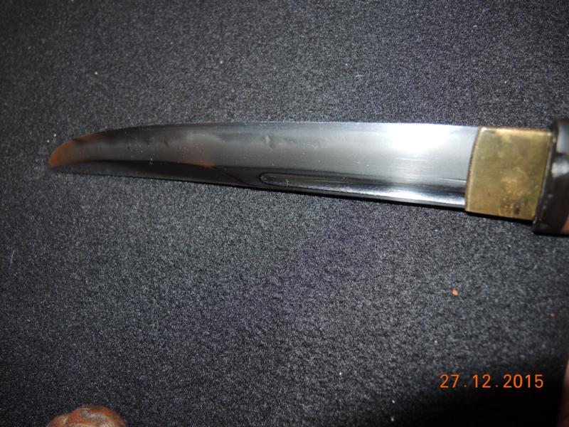

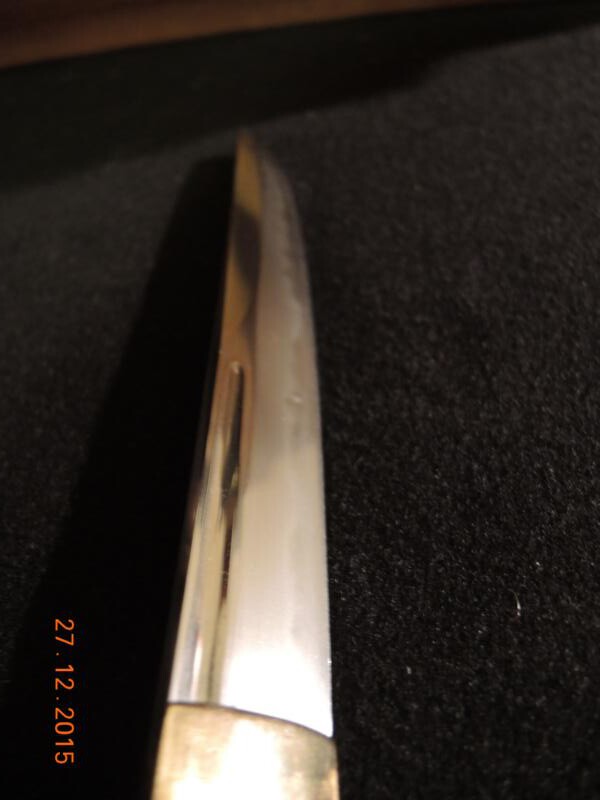

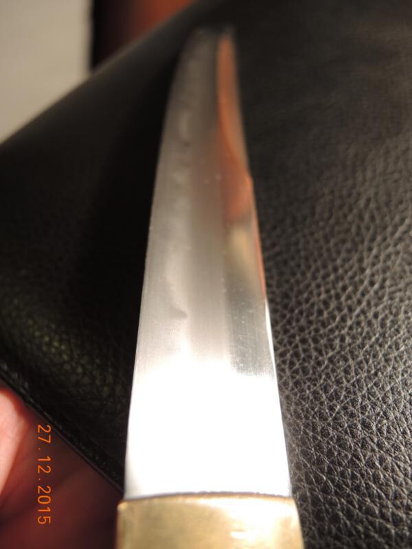

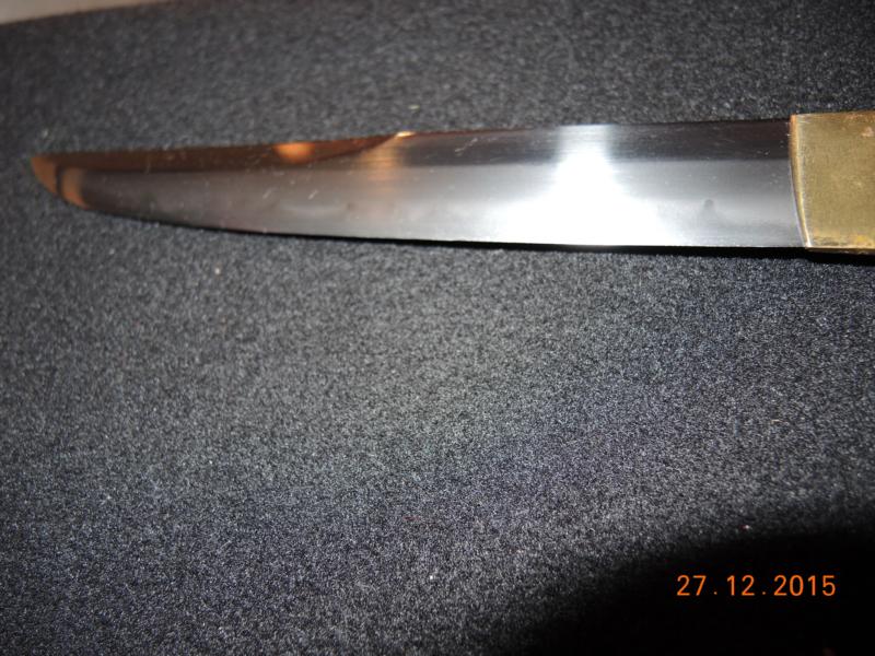

Michael 67 Posted December 27, 2015 Author Report Posted December 27, 2015 On 12/27/2015 at 7:00 PM, Michael 67 said: Unfortunately my photos are not good to see the ko nie crystals .. I try to make better photos See picutres 2 Quote

SteveM Posted December 27, 2015 Report Posted December 27, 2015 Hello Michael, None of us can say for sure. It looks to me like it is older than Showa. It looks like it is of the kanmuri-otoshi type of construction. The signature on the tang of your blade appears to be 兼元 (Kanemoto), or possibly 兼光 (Kanemitsu), but I am leaning towards 兼元. I cannot tell if it is an authentic signature or not. An interesting feature on your blade is the groove on one side. Actually it appears to have a double-groove, but the smaller bottom groove looks like it has been almost completely polished out. It is just visible above the habaki (the copper-ish collar). If you have been studying Japanese swords for a couple of years you probably know that there is a huge quantity of counterfeit swords and reproductions, particularly on the auction sites. So I am always suspicious of auction sites. I don't think your sword is Showa. The hamon appears to be genuine (from looking at the photos on ebay). I think the groove on one side is curious, but it doesn't strike me as being fake. The tang certainly looks very old. Quote

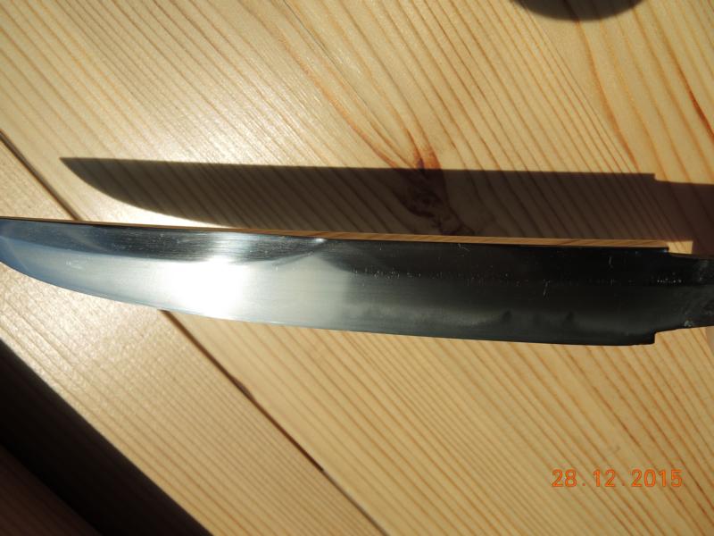

Greg F Posted December 27, 2015 Report Posted December 27, 2015 Hi guys, is the tsuka a tight fit? If not maybe moisture has got in and aged the nakago more than expected? In regards to the blade are you able to put some more blade pics up with some hd close ups of hamon and blade surface? Cheers. Greg Quote

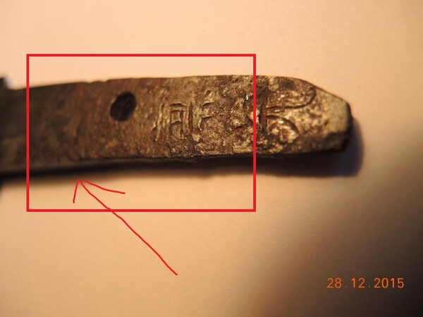

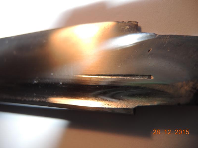

Michael 67 Posted December 28, 2015 Author Report Posted December 28, 2015 Here more pictures. I think the signature is Kanemitsu 2 Quote
Dave R Posted December 28, 2015 Report Posted December 28, 2015 Aha, Orikaeshi-Mei, extreme shortening of the tang with the signature preserved..... http://www.ksky.ne.jp/~sumie99/suriage.html 1 Quote
Dave R Posted December 28, 2015 Report Posted December 28, 2015 Retained signature on an o-suriage blade. Quote
Stephen Posted December 28, 2015 Report Posted December 28, 2015 not folded over but cut and added...good eye, gaku mei tho 1 Quote
Michael 67 Posted December 29, 2015 Author Report Posted December 29, 2015 Wow, I am impressed. Thanks Dave for the explanation. 1 Quote
