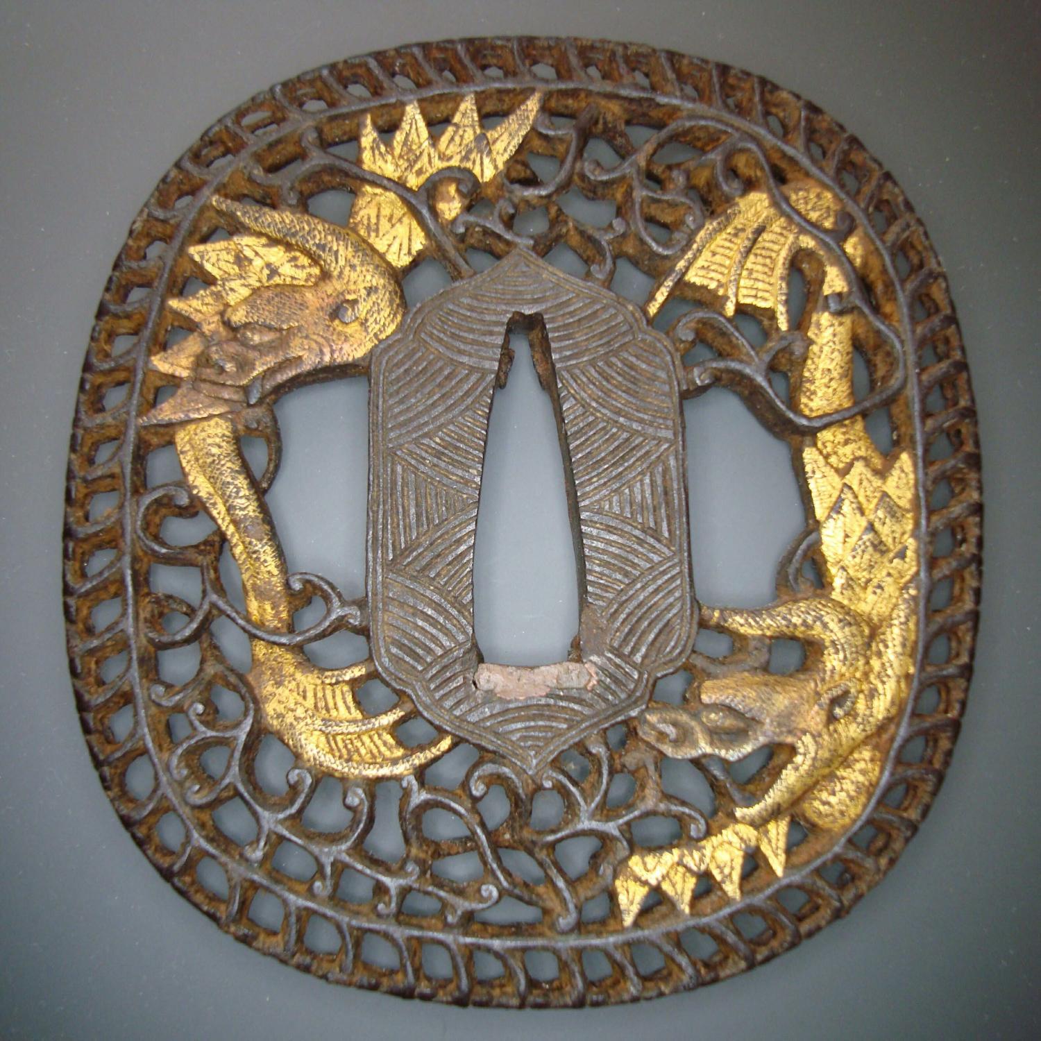

Grev, Here is my take on the subject:  Stylistically, namban tsuba are exactly comparable with Chinese metalwork and in particular items from the regions towards the Himalayas - see Tibetan saddles, pen cases and allied items. A good number of Chinese swords have guards decorated with similar pierced, scrolling tendrils. An important consideration is that most Chinese swords do not have an habaki and are fitted into scabbards that consist of little more that two pieces of wood covered in leather of more or less rectangular section, hence, that part that in Japan would be called a seppa dai, visible when the sword is drawn, decorated and rectangular. There exist a considerable number of namban tsuba that have had hitsu ana cut through the original design and have these rectangular, decorated  'seppa dai'. I would suggest these are of Chinese origin, the obvious source being trophies taken in the Korean campaigns and adapted to fit the returning samurai's wakizashi. This flaunting of captured trophies created a fashion trend that was satisfied by Japanese tsuba makers, and probably by workers in the Chinese colony at Nagasaki. These later tsuba have a more normally shaped seppa dai, although still often decorated, and hitsu ana that are integral with the design. Gradually the original Chinese design were expanded to include anything novel and foreign, such as the VOC monogram and copies of small-sword hilts. If I am correct this would date the earliest namban tsuba to around 1600, those of the VOC and small-sword designs to around the mid 18th century.
Ian Bottomley

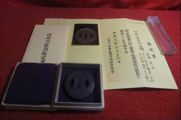

These are the first Namban tsuba that I've seen papered
Is there any date or location shown on these papers?
Lots of information for me to collate
Thanks

it is not so uncommon!
here two of mines!
the first one is probably a votive one ( besause of the size and weight 14x13cm 490g )
the second one were papered but the preceding owner lose the kanteisho!!

actually some Nanban tsuba got a paper from NBTHK, and sometime even not the best ones. I remember a nice one from David Stiles, but I'm unable to find it on his site.
Here some NBTHK papers I collected on the net (unfortunately just the pics... - please delete if suspect a copyright infringement).
Nanban tsuba - NBTHK kanteisho.pdf
Bye, Mauro

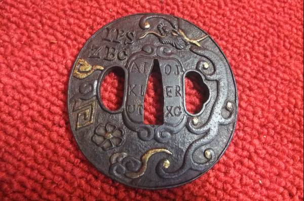

- I really don't think that namban tsuba comes from european sword guards. It is true that there are quite similar in some cases...but as well chinese or indian sword guards. Many people wants to link namban with Europe, but in that case I think that the namban tsuba only has link with the "old" namban people, I mean, extrangers coming from the south before 1549.
- Also It is very common that people has confusion about "namban tsuba" and "nippon tsuba with namban decoration". For example, a tsuba fro Hirato/do Kunishige with european letters and motifs it is an original Japanese tsuba. But a tsuba maked in China, India, or a Japanese copy of this tsuba are namban tsuba.
