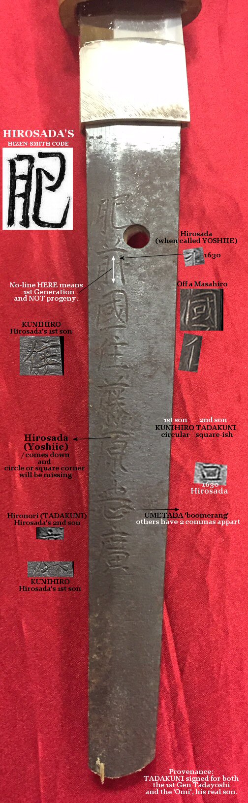

KarlPeterSmith Posted December 30, 2015 Report Posted December 30, 2015 SOMETIMES... you have to look at what your own children DO... and see what they have picked up from YOU They have to get it from somewhere... I'll guess the blade is 1630 by YOSHIIE (who was previously called HIROSADA and is the half-brother of 1st Gen Tadayoshi... and signed TADAHIRO [as everyone had to... as the 1st Gen was still alive]. Hirosada's 1st son was Kunihiro and his second was Hironori [who later became TADAKUNI - who also signed for 1st+2nd Gen 'Omi'] Not far fetched. Realistic. And the sword speaks for itself. All notes are on the pic.

Daniel Posted December 30, 2015 Report Posted December 30, 2015 Hi John A couple of years ago I had a Gimei Hizen Tadakuni which coincidentally also was bought from nihonto.au Some thought it to be a Bungo Takada from the 1600's so maybe that's not a bad call afterall. Please have a look, I think there are some similarities. http://www.militaria.co.za/nmb/topic/13776-hizen-tadakuni/?hl=%2Bhizen+%2Btadakuni Anyhow I hope you'll enyoy your new sword. BTW hope you will like it here in Sweden. Best Regards Daniel 1
Jussi Ekholm Posted December 30, 2015 Report Posted December 30, 2015 The most important thing is that you like the sword, I don't think anything else really matters. As you are buying it for yourself. I will say that the "Hizen smith code" by KarlPeterSmith is bit controversial subject and it is a research in progress. See more here -> http://www.militaria.co.za/nmb/topic/14763-tadayoshi-waki-expert-help-on-mei/page-4 How long are you staying in Sweden? There are people who have great nihonto knowledge in Sweden and also on Hizen swords. I am not personally that fond of Hizen swords, and I don't know a thing about them. Still I'm guessing I should have around 100 Tadahiro signatures (various generations) scattered across my books & magazines. I think I could gather bunch of them up for you if you'd like. Like others before me, I would be leaning on gimei. I also think John at Nihonto Australia seems like a good guy, I've only exchanged few emails with him. 1

Alex A Posted December 31, 2015 Report Posted December 31, 2015 Here we go again, Ok, having had a look at the mei and comparing it to other examples, I think its fair to say there is more wrong with it than you can shake a stick at. I enjoy to speculate too sometimes, but that doesn't get you an Hozen I'm afraid, unless maybe there is a special Hozen award for speculating . I respect Karls efforts, but unless he gets on a plane to Tokyo and convinces and educates the NBTHK/NTHK of his theories/findings or even gets on to a shinsa panel then in my humble opinion this sword will receive no Hozen for Tadahiro. Ps John, all the folk above (including me) took time to help you and you have kind of come across slightly insulting and ungrateful in your last statement. Oh well, I suppose we can only try to help. You will need to remember that giving advice, checking mei etc can be time consuming and a bit of a pain, its not something that I or anyone else take on likely, it can also make one look a complete plonker should one get it wrong, so think on.
paulb Posted December 31, 2015 Report Posted December 31, 2015 John Please do not mistake enthusiasm and confidence as expertise. Can I suggest you go back to basics before getting carried away with sending the sword to shinsa. Let me start by saying I dont know what your sword is. But as a beginning ignore the signatue and look at the sword. 1. Shape will give you an indication of period 2. Hada will indicate tradition 3. Hamon school 4. Boshi smith (this is a very rough rule of thumb not fully accurate but if you look at a sword this way you will have a clearer idea as to what you might be looking at.) In the case of your sword if you compare it to other examples of Hizen swords of which there are numerous illustrations I would suggest the shape is not typical, it lacks the elegance you would expect to see. The hada is not the classic Konuka hada of Hizen and although in their early days they produced other forms they are far less common. I cant see detail of the hamon structure but it should have a broad nioi-guchi interspersed with ko-nie. The boshi should be a well proportioned ko-maru. Now if your sword doesnt comply with the majority of the above it is unllikely to be a Hizen sword. "If it looks like a duck, walks like a duck and sounds like a duck chances are its a duck" conversely if it does none of the above it is more likely to be something else. Now having done all that if you conclude it is a Hizen blade you can then look at the mei to decide if it is gimei dai-mei or dai-saku all of which would be possible. What is extremely unlikely is that a well known Hizen artisan would sign a sword made at a difftrent time in a different school and tradition. Therefore before you get carried away with theories relating to caligraphy work style or some conspiracy theory and code system please look at the sword. Certainly dont start thinking about spending money on sending it for shinsa until you are confident in your own mind, based on a lot of study that it stands a chance of being what it claims to be. End of soapbox lecture but please lets not get caught up in another eccentric debate about Hizen swords! And can those commenting be clear that what they are offering is opinion not a statement of fact. Part of the role of this board is to assist and educate not to confuse and mislead. 5

KarlPeterSmith Posted December 31, 2015 Report Posted December 31, 2015 [At present do not spend any money on a Shinsa. The identification of your sword should not be by democratic vote based on it's hamon... which would say Tadayoshi School full stop. God I hate that hamon. They are currently not using the correct information regarding signatories. Which is why the boat is being rocked with my research.] Factual evidence will disappoint a lot of 'dealers', 'auctioneers' and 'freemasons' who think they have a 1st Gen Tadayoshi when realistically they really don't. And having a piece of paper will make your sword no greater than it really is (listen to post #41 Jussi...) Your sword spoke to you. It has a soul. A truth. It is an honest sword... with honour. They all want their sword to be signed by the 1st Gen... And your sword has been signed within THE FAMILY. And we are not saying it was THE 1st Gen. Tadayoshi himself... but they a fuming that THEY missed a trick here. That bargain got away from them. ON A POSITIVE STROKE ...One THING I HATE about your sword (yes, on a positive stroke) is i really HATE the hamon (it is boring) i.e. IT LOOKS LIKE A TADAYOSHI SCHOOL sword)... call it sugar, call it flat water, call it whatever you want ... the bit i HATE HATE HATE about it is is looks like a generic TADAYOSHI SCHOOL blade haha. I hate that hamon. I really do. I hate it because I know it is a Tadayoshi School blade LOL. My own negativity.... my pet hate is also saying YUP it's a real one... because I just hate that hamon. To Sherlock Holmes (the hater)... If 60 Smiths work for 1st Tadayoshi - then you have 60 suspects when determining who made/signed the swords from the Tadayoshi School. Right? Correct. Argue with Sherlock Holmes will they? They still will. The HIZEN-SMITH CODE identifies not everyone... but just enough to get to the bottom of the usual suspects and even ones that the masses do not even know are on the MAP yet! I would love to blurt out more secrets but I am sitting on my hands with parts of my CODE (swordsmiths and named assistants from Yamashiro and Osaka... that's right Hizen swords signed as such made elsewhere) that will rock most 'professional' collections. I'm not even joking that I expect a Ninja to crawl over my roof within the coming months. I know you'll keep and cherish your sword. I can Skype with you to tell you where your sword fits in the bigger picture. Relax... it's a good one. Oooouu... when I mentioned Hirosada's children Kunihiro & Tadakuni... I invariably disappointed many who thought they had a good-one. Relax - they're good too... in fact some are GREAT! That's why they are in museums with TADAHIRO on them because the master agreed they were good enough to pass off as the master's... and signed as such. Phew.

KarlPeterSmith Posted December 31, 2015 Report Posted December 31, 2015 My name is Karl Peter Smith BA... I live in the UK (and I have never met JOHN or are associated with anyone called JOHN in Oz... I've never even been to Australia) ...and to reply to the post above by (Brian #54)... a CODE being used by the SMITHS when signing for their master... is the brainy thing to do. I would love to divulge everything before my book comes out... but... defending the odd 'GOOD' blade isn't beyond me. This currently (not know by the masses) knowledge is what my research is based on. It is what I have uncovered/discovered on the blades and have NOT created from thin air. I am NOT a Shinsa panel... guessing/voting using an unsigned blade and using merely opinion. Saying a sword is by a 'School' which is a pretty broad (all encompassing) guess if you ask me. And that mundane fact is not questioned? I mean... WOW. I can tell you WHO it was! Cheque is IN-THE-POST As for my research....My characters are in sequence... 'unlike the dug-up pieces of a dinosaur in a museum'.... mine are all in order... just as the signatory intended. I get to see the actual work as it was made to be seen. I don't create it using a best-guess. My primary material is almost factory mint. A great reference point. Too good? I do like to stick to facts and NOT vague opinion. Those 'not in the know'... keep still... you may fall-off this flat Earth.... Shhh... it's really a Sphere. No-way!? Yes-way.
