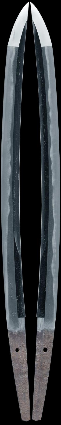

I recently received a request to try help recognizing a certain wakizashi, or at least try to dig up from details.
Apparently, aside from the item being already in germany during the 1930's, there isn't much information.
Here are the pictures and what i can gather from it (i took them, and handled the item personally)
Gallery of closeups, nakago, and the different parts:
http://imgur.com/a/55AtK
Seems like a shinshinto, big kissaki (though i'm not sure if this should be called an o-kissaki, probably not long enough)
Suguha hamon, nakago seems ubu, mumei.
I'd date the mounts (both by style and condition) to very late edo period, tsuba doesn't seem to fit with the rest and might be from a later time, the kozuka seems like someone juts shoved it in there, is a completely wrong size, and probably not related at all to the whole set.
Unfortunately, there is evidence of usage of sand paper quite long ago (rust has already settled on the scratches), and polishing paste not long ago.
Inspection under a magnifying glass didn't reveal any hagire, karasu-guchi or shinae, surprisingly aside from the bad surface condition (rust doesn't seem deep.) the blade looks like it's in very good condition.
If anyone can pour more light on this, or point some mistakes i made in my evaluation (these are just my thoughts- i did not give them out as an advice or something) i'd be glad to receive any help, and every comment is much appreciated.
..., possibly the end of a much larger O-suriage daito.
What makes you think that? This type of wakizashi isn't that uncommon, attached is a photo of an ubu zaimei Anonji Masayuki wakizashi I used to own.
I tend to agree with Guido-
When i received the picture you can see with the white background i thought it has to be a shortened blade, it's very wide and a bit thick.
But after seeing the nakago, i really don't think it was, can't see any signs of it being shortened.
Brian- what would you say is a decent price? the owner wants to get rid of it, for 300-350$ish.
The fact that it comes with full koshirae in decent condition is already worth it i think, i'm tempted to get it myself and send it to get a new polish.
RE: Ubu vs. suriage.....look at the temper at the machi....  what does it do?  if it turns down to the edge it is ubu or retempered, if t appears to continue onto the nakago it may be shortened (still could be ubu or just machiokuri a little)... hard to see in the pictures but it appears to turn down and end at the machi
I also think it ends at the machi- but it's harder to see there, unfortunately. The clearer parts are on the blade itself.
Going to upload a full-res picture soon and link, i'd  like your opinions as well before making a decision. It's probably going to be a while before i'll send it to get a new polish (and of course, trying to get as many details on it as i can to see if it's even worth sending)

Direct link to high-resolution picture:
http://i.imgur.com/Td5wlDD.jpg
Looks like the hamon goes off a tiny bit after the machi. I highly doubt this was shortened.

The blade seems to be in healthy shape. Definitely worth a polish. Nakago condition says late shinshinto- or more likely, early gendai. Probably made around the time of export to Germany.. 1920's-30's? The tsuba, kozuka, Kogatana, Fuchi-gashira, ribbed saya, and menuki could all be sold separately to recover your investment twice over. Or sell koshirae as a whole. Based on what I can see.. Every part in that package has value. Any way you cut it, you're winning.
I would buy it, study it, resell it at a profit and put the funds toward your next better sword. If you polish it properly you will end up with more in it than it is worth. So if you like it and are going to keep it long term polish it, if it is for resale sell it as is.
