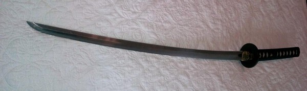

hddennis Posted December 20, 2015 Report Posted December 20, 2015 Just picked up a buke zukuri mounted sword. Either late koto or early Shinto. Scabbard was leather wrapped at on time and it has a WWII metal ring hanger and remnants of a leather snap so it was carried in WWII but everything about it is several hundred years older. It has a 23 1/2" blade but looks exactly like a katana but just a hair shorter. Since it appears to be all original and never shortened what is it called? Pictures and tang rubbing to follow after I get home from the holidays Thanks, Howard Dennis Quote
Guido Posted December 20, 2015 Report Posted December 20, 2015 On 12/20/2015 at 5:46 AM, hddennis said: 23 1/2" blade 23.5" = 59.69 cm = 1 shaku 9 bu 7 sun = wakizashi Quote
Guido Posted December 20, 2015 Report Posted December 20, 2015 On 12/20/2015 at 8:07 AM, Bazza said: Katate uchi??? That's the way a sword is intended to be used, with one hand - which probably is the case here. However, it's not a proper length classification; on a tōrokushō - or shinsa papers - it most certainly would by called a wakizashi. 1 Quote
Bazza Posted December 20, 2015 Report Posted December 20, 2015 My goodness me, the last person I want to engage in verbal joust is Guido, who has I'm sure forgotten more than I will ever know!! (Bows). Of course, by definition such a blade is indeed a wakizashi. However, I'd just like to elaborate on my simple and of the cuff response to the OP. It revolves around his words "It has a 23 1/2" blade but looks exactly like a katana but just a hair shorter." I immediately thought late Koto, one-handed sword, which is a distinctively different fish, say, to an Edo period wakizashi. So we do indeed need to wait on more information. Just for interest in the context of this discusion, a friend of mine has a 70cm katana with a "one-hand" nakago. It is papered to Eisho Bizen Yukikane and would appear to be a katate uchi, as Guido says, intended to be used with one hand. Two shaku 3 sun!!! BaZZa. Quote
hddennis Posted December 20, 2015 Author Report Posted December 20, 2015 Just looking to further my education here and learn more about my latest addition. Definitely an amateur I still have been dabbling in swords for almost 30 years and this is the first one I've seen push the accepted measurements so closely. Why would a sword purchaser pay for better than average mounts , a signed blade, tsuka almost 9 inches long and not pay for that last 1/2". I'm 6' 3" tall and this sword feels perfect in a two handed grip although I'm no expert in what is proper technique. Just wondering if there is more to this seldom seen size than a purchaser who ran out of money? When I first started reading about Japanese swords I seem to remember something about short katanas meant for quick draw or fighting in close quarters. Was that just legends passed on as fact? Thanks for your responses, Howard Dennis Quote

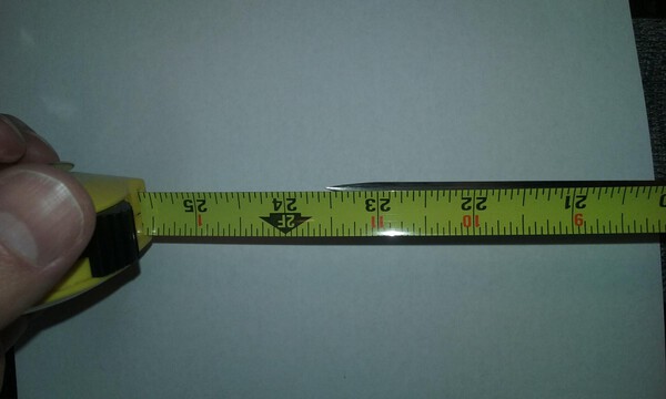

Stephen Posted December 20, 2015 Report Posted December 20, 2015 I would like a re-measurement please kissaki tip to munemachi? Quote
seattle1 Posted December 20, 2015 Report Posted December 20, 2015 Hello: I think the essence of the question posed is directed more to the functional purpose of the blade than the arbitrary distinction between katana and wakizashi. The 60 cm rule for designation as a katana is an artifact of the modern legal need to draw the line somewhere, and while Guido is technically correct,the missing 0.31 cm would hardly disqualify it for use as the longer of two blades if a samurai were carrying such a blade as part of a daisho. Arnold F. Quote
hddennis Posted December 20, 2015 Author Report Posted December 20, 2015 On 12/20/2015 at 2:56 PM, Stephen said: I would like a re-measurement please kissaki tip to munemachi? I only have a large tape measure now but it is just a tick short of 23 5/8 inches. Howard Dennis Quote

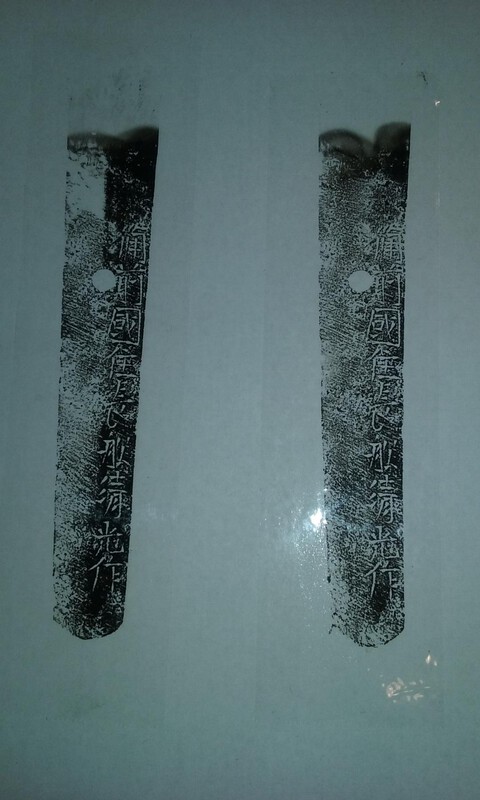

hddennis Posted December 20, 2015 Author Report Posted December 20, 2015 Hope someone can read this for me please? Howard Dennis Quote
John A Stuart Posted December 20, 2015 Report Posted December 20, 2015 BTW, 23.5" is 1 shaku 9 sun 7 bu. Yes? Quote
hddennis Posted December 20, 2015 Author Report Posted December 20, 2015 On 12/20/2015 at 4:00 PM, hddennis said: I only have a large tape measure now but it is just a tick short of 23 5/8 inches.Howard Dennis Quote
Mark Posted December 20, 2015 Report Posted December 20, 2015 Howard Bizen Kuni Ju Osafune Kiyomitsu saku Quote
John A Stuart Posted December 20, 2015 Report Posted December 20, 2015 Bizen no Kuni ju Osafune Kiyomitsu saku. I believe. John Quote
Stephen Posted December 20, 2015 Report Posted December 20, 2015 Thank you Howard was posting the mei but two came in at same time, agreed. 1 Quote
John A Stuart Posted December 20, 2015 Report Posted December 20, 2015 23 5/8" is closer to 1 shaku 9 sun 8 bu. John 1 Quote

hddennis Posted December 20, 2015 Author Report Posted December 20, 2015 Thanks Guys. So what exactly is an uchigatana? Does it pin this down to a certain time period or style? If the signature is good how does this smith rank? Howard Dennis Quote
Stephen Posted December 20, 2015 Report Posted December 20, 2015 Another way of saying one handed sword, Good smith: was going to copy and paste, but too many to pick from, is it dated? Quote
hddennis Posted December 20, 2015 Author Report Posted December 20, 2015 On 12/20/2015 at 6:11 PM, Stephen said: Another way of saying one handed sword, Good smith: was going to copy and paste, but too many to pick from, is it dated? Thanks Stephen, no I posted all of the signature, the other side is blank. Howard Dennis Quote
Stephen Posted December 20, 2015 Report Posted December 20, 2015 KIYOMITSU (清光), Eiroku (永禄, 1558-1570), Bizen – “Bizen no Kuni Osafune Kiyomitsu” (備前国長船清光) too bad its not dated, more shots of blade are in order 1 Quote

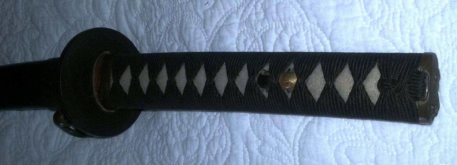

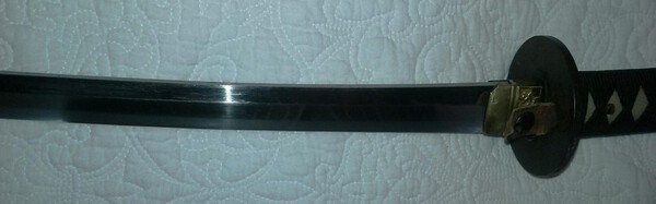

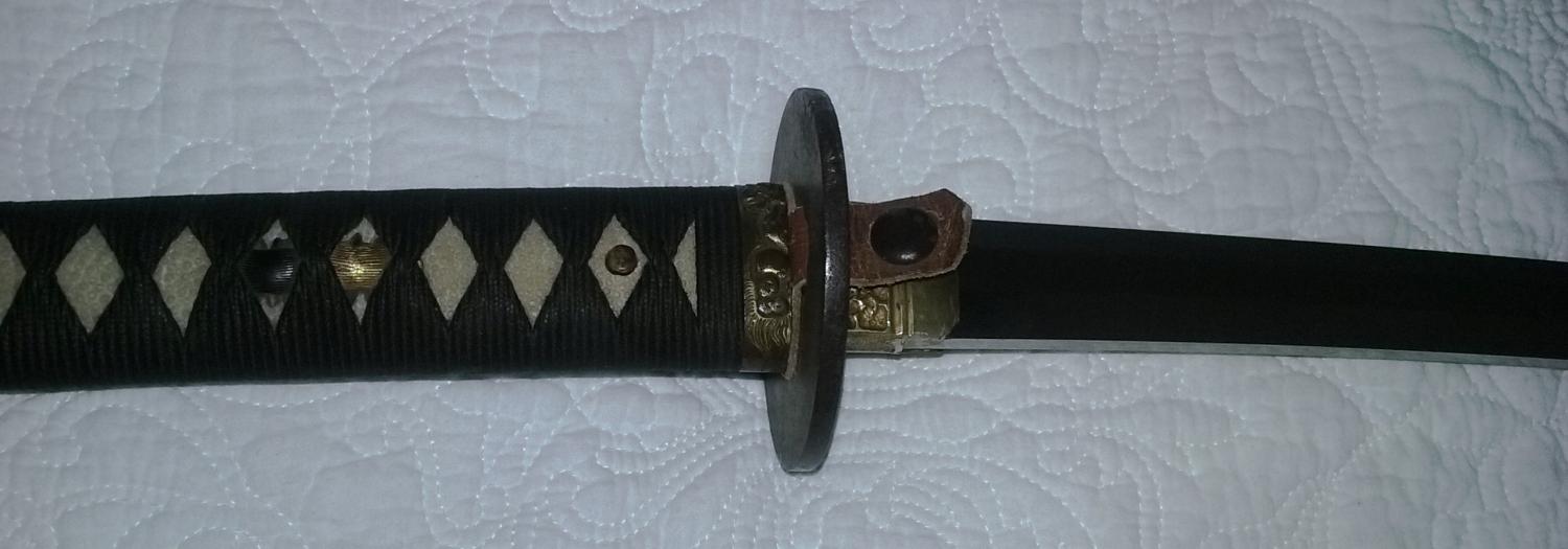

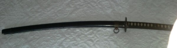

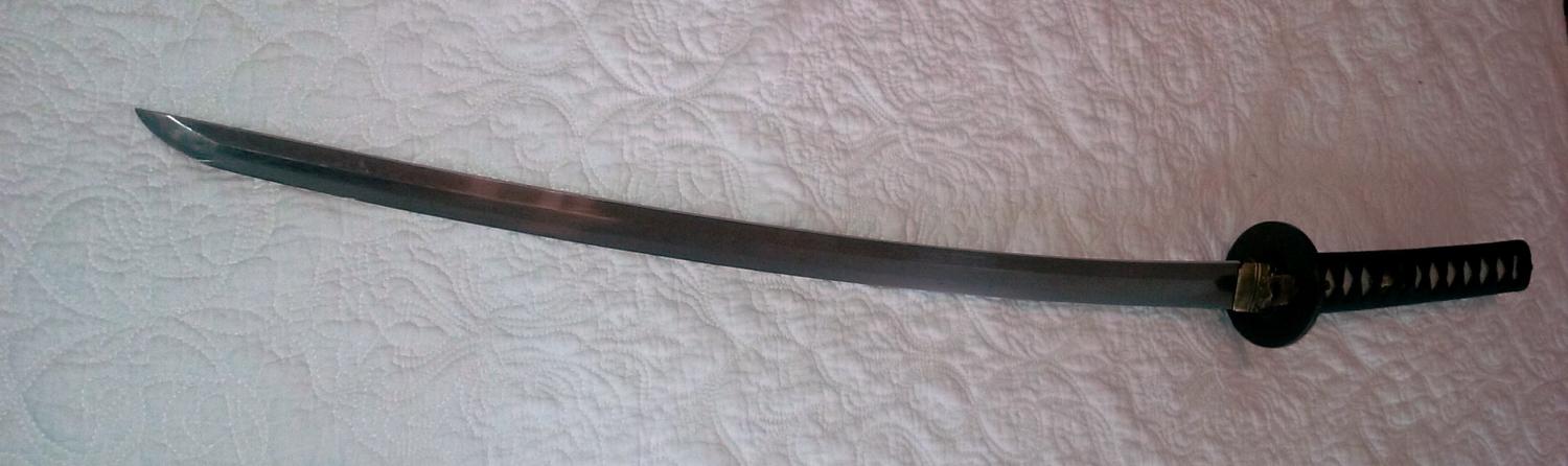

hddennis Posted December 20, 2015 Author Report Posted December 20, 2015 Sorry for the poor photos but I'm not home to use my digital camera, all I've got is a cellphone which doesn't do very well. Howard Dennis Quote
Stephen Posted December 20, 2015 Report Posted December 20, 2015 very nice pick up, well done 1 Quote

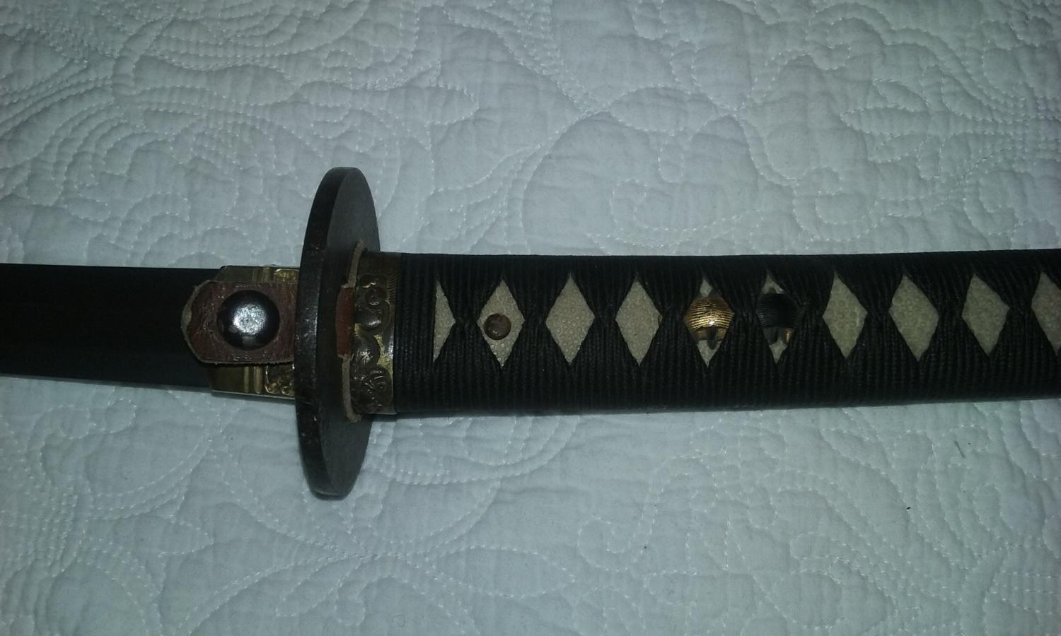

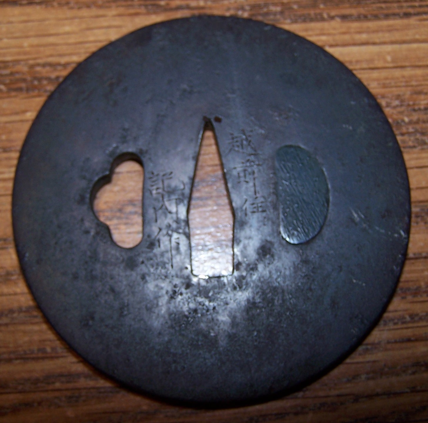

hddennis Posted December 31, 2015 Author Report Posted December 31, 2015 Just noticed the rather plain tsuba on my sword has a signature. Can anyone tell me what it says? Howard Dennis Quote
Bazza Posted December 31, 2015 Report Posted December 31, 2015 Right side ECHIZEN JUU Left side KINAI SAKU BaZZa. Quote
hddennis Posted January 1, 2016 Author Report Posted January 1, 2016 Thanks for the translation. I must admit I was really surprised to find this plain iron disc signed. Apparently this is from a good school of fittings makers that made mostly sukashi or open tsuba. Any idea why this would be signed? I've never seen a plain tsuba like this signed before has anyone else? Howard Dennis Quote
