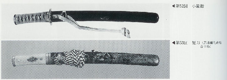

Hi Guido san,
I suspect that you already have the book "Nihonto no kansho-kiso-chishiki (日本刀の鑑賞基礎知識)" by Ogasawara Nobuo (小笠原信夫). There is a description about ko-wakizashi on p. 59. He says in the book that ko-wakizashi means a small (or short) wakizashi and the term is for a style of koshirae.
