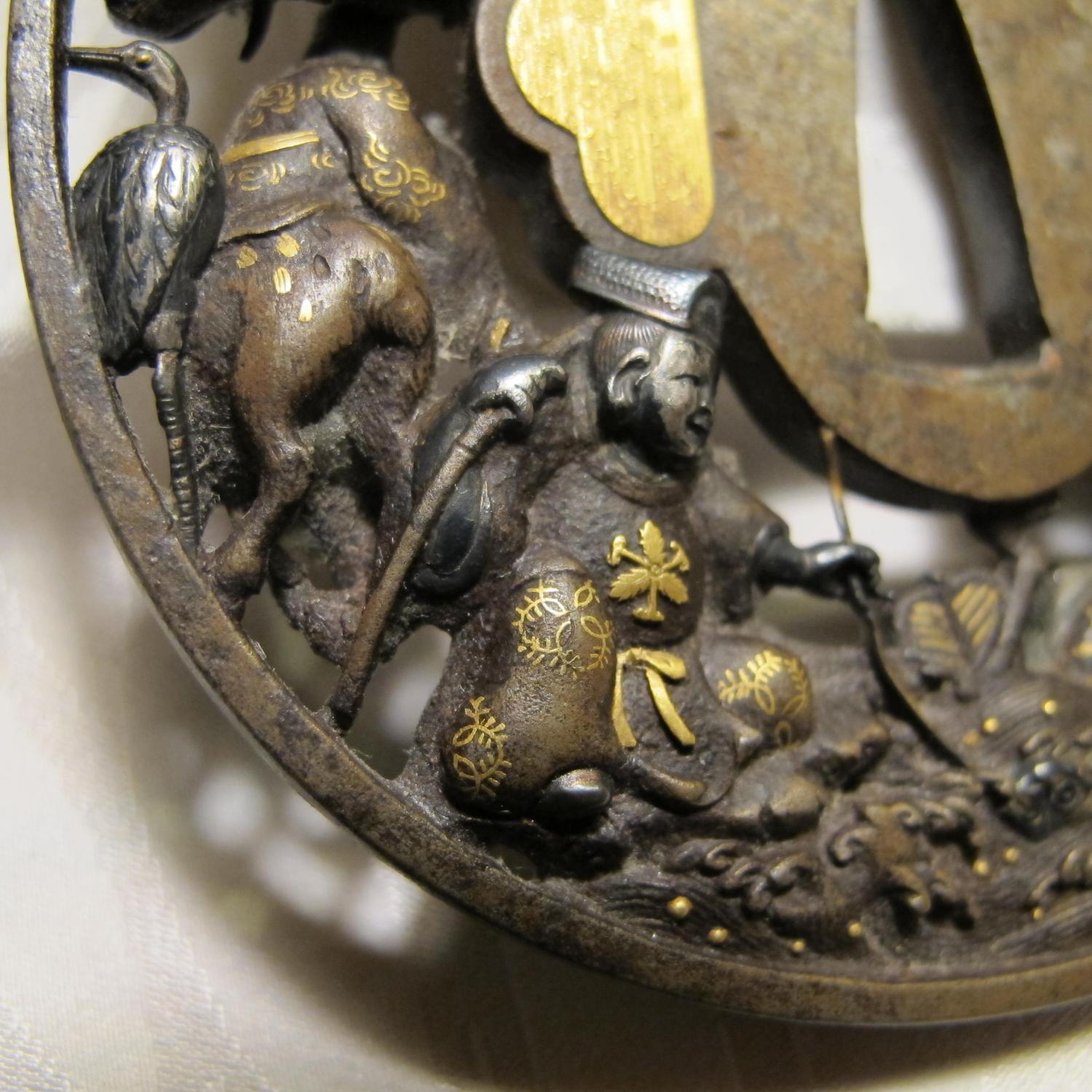

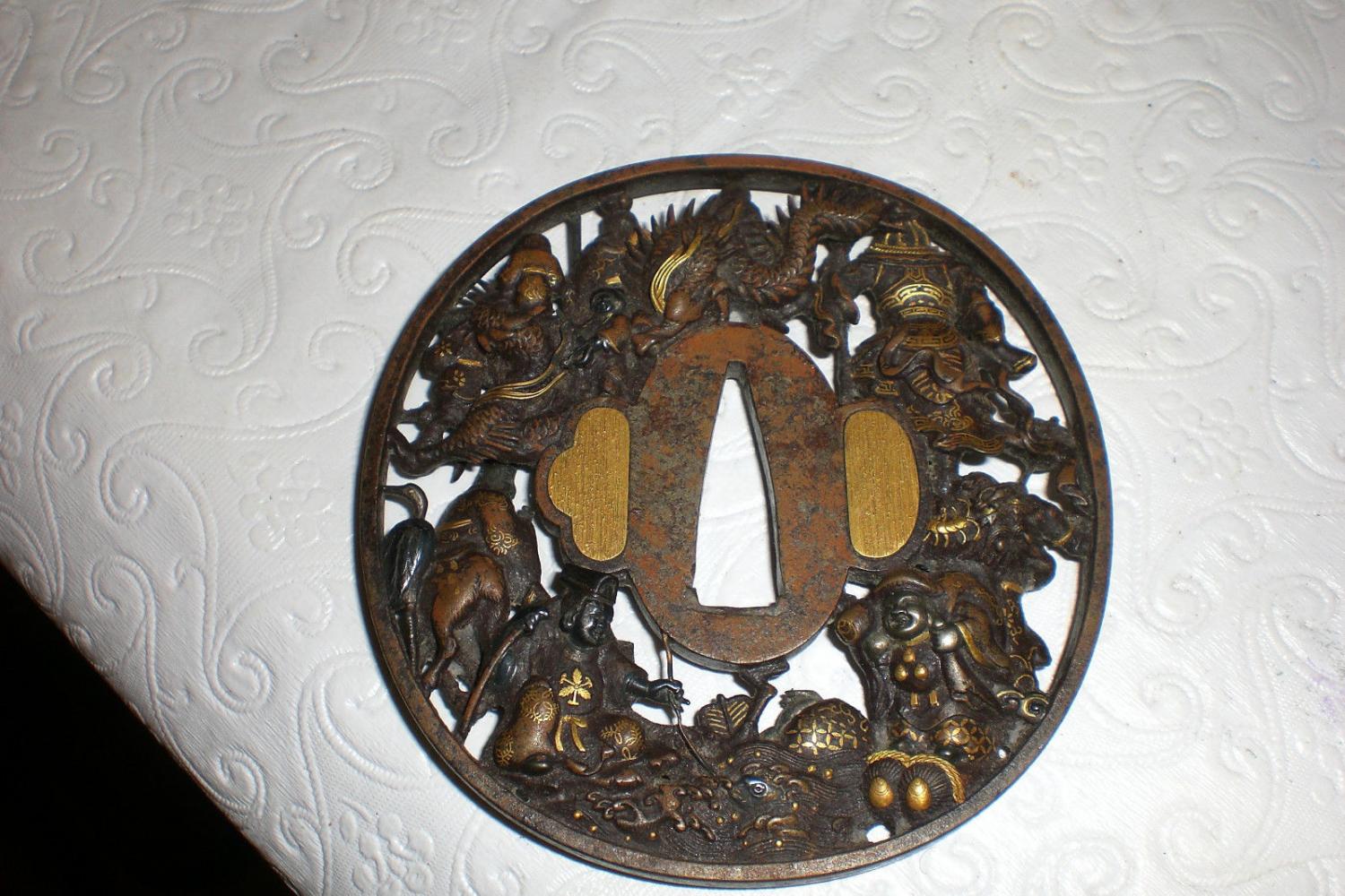

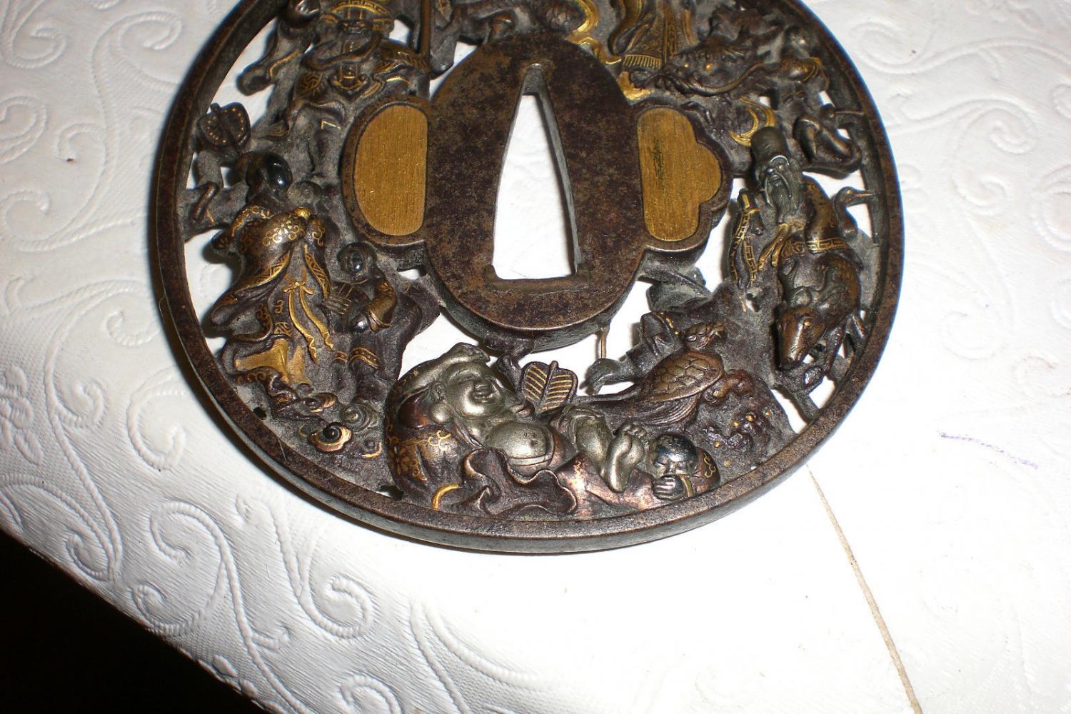

Hello Nihonto lovers,
I was wondering if anyone is willing to share thier knowledge, and tell me when and who made this bad boy.  I really have no idea how old it is.  The work is pretty outstanding, so I am hoping that someone has seen a signed one that is similar, or can point me in a good direction.  Not interested in paying $250+ for NBTK answer, knowing that some of you are knowledgable and kind enough to help me for free.
These are the ebay photos.  I found it on ebay from an estate reseller in Florida. They listed it a Soten style, but I don't know if soten or another school, or some talented nobody.  It is iron with inlayed alloys and guilding.  The patina has some active rust around the nakago ana, which i tried to wipe off with a napkin soaked in rubbing alcohol (some came off too!).   Not planning on further cleaning or adding any oil or anything (I don't want to hurt it in any way - worried that oil layer will become a pourous water trap after a long time without re-application - after I'm gone).  I imagine it came over in the war, and was handled for 50 years by someone who didn't think about it's longevity, and that is why the active rust.
I paid a grand for it, so it is my most expensive piece of Japanese art thus far.  As always, this unknowledgable puke thanks you for your efforts and time.

 was watching that and had wondered if it had been a cast copy, mainly because having been burned by one of late everything seems fake to me, yours i cant tell, the walking staff had to be added....you have more guts than me going for it,  good luck.
Thanks for the well wishing and compliment.  If it is cast, then my answer will come quick, becasue there will be others.  Anyone ever seen this exact casting (if it is such)?

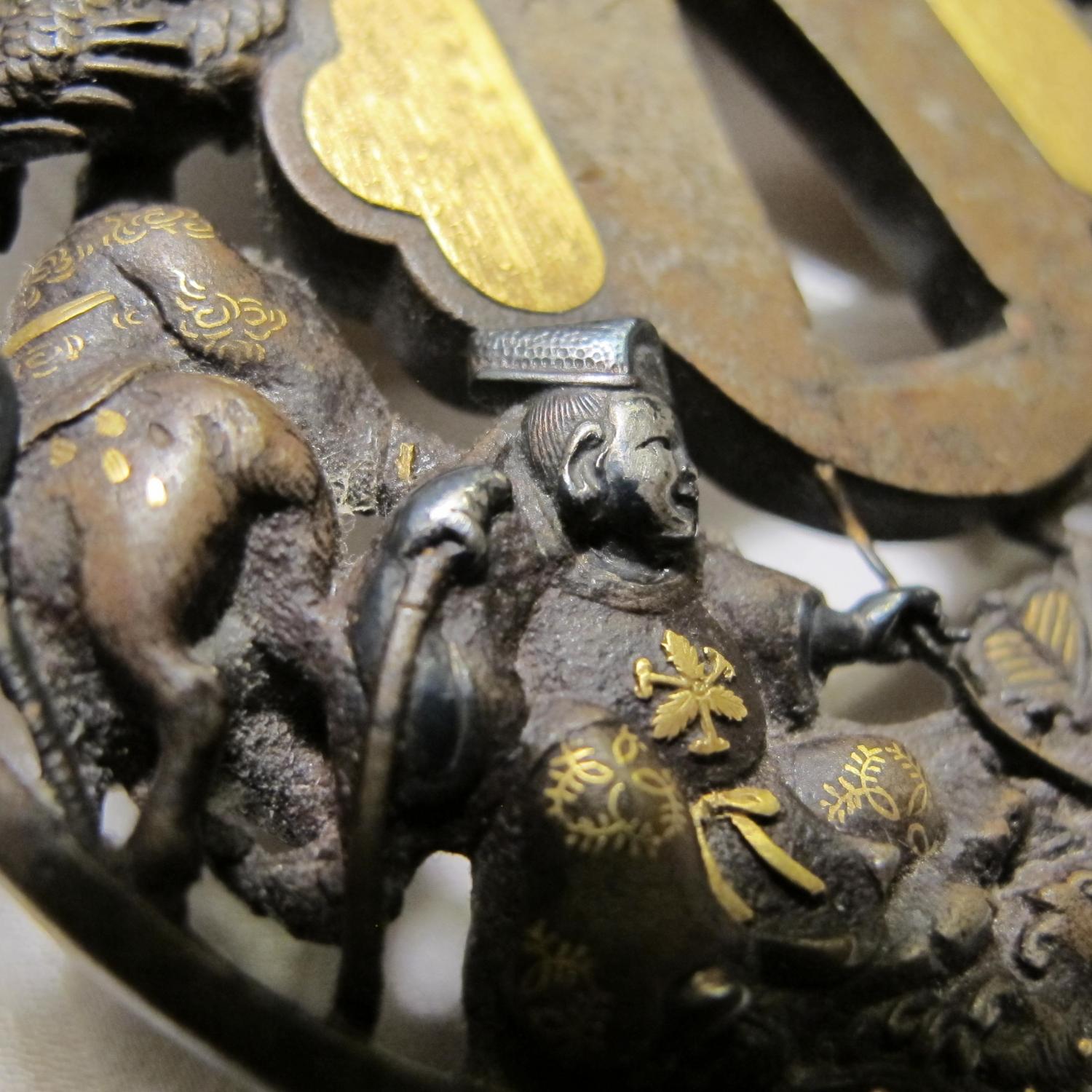

I think you are referring to the fishing pole Ebisu has in his left hand.  I imagine that it is mostly gold, or would have been corroded long ago (being so thin).  It does kind of stick out as different than the other work (the rest is alloy guilded over iron, and therefore has exagerated depth when veiwed from the side, but this part is thin as a wire).  My though is that it was original, pure gold, and is so crooked becasue it has been banged on and deformed through norman handling.  I could be wrong though.

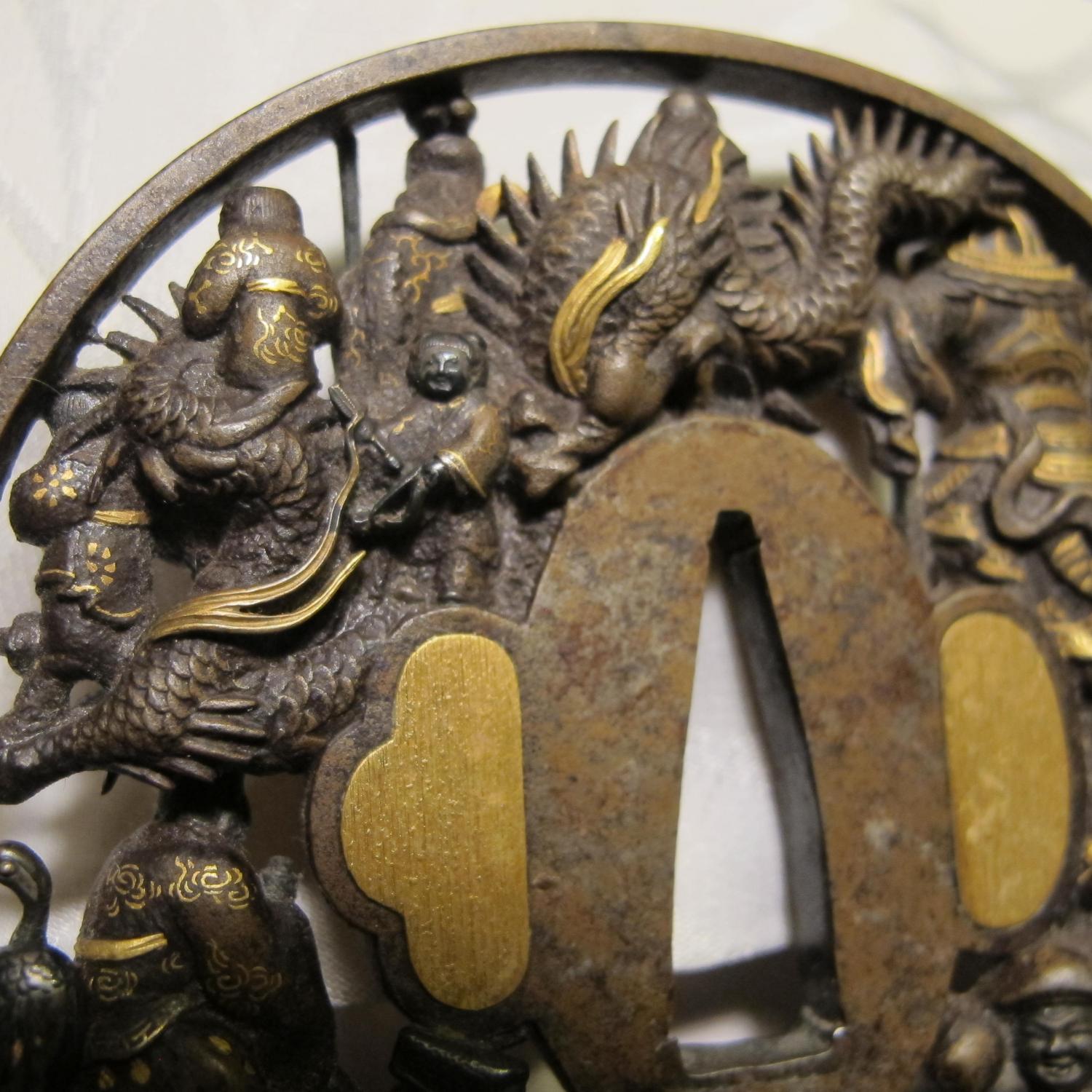

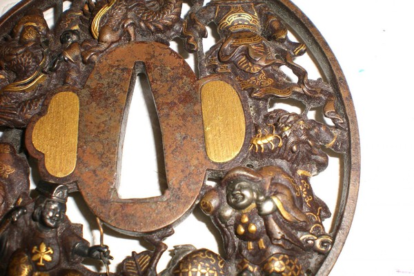

Hi Grant , this looks like a good quality piece and I can see no reason to think that it would be cast . I feel sure that no one would apply the quality finishing touches that this has to something that is cast . There is a great article on Soten tsuba elsewhere on the site . I would think that if you spent $250 on papers then they would probably tell you what you already know ie Soten school . Its a nice piece that is well worth owning in my opinion .

Ian, I agree, it is a pleasure to have.  I am just curious if I can get more info on it, or if someone has one which is by the same person (if the artwork is that unique or not, I have no idea).  I think it may be relatively new, becasue the patina isn't black like old iron peices.  Anyhow, lots going on there, and it must have really been something brand new.

Hi
I have a cast Namban tsuba which is easy to see that it is cast
If you look inside the opening for the blade (nakago ana) you will see a joint line.
On mine it was easy to see but I can't see a joint line on your tsuba
Grev UK

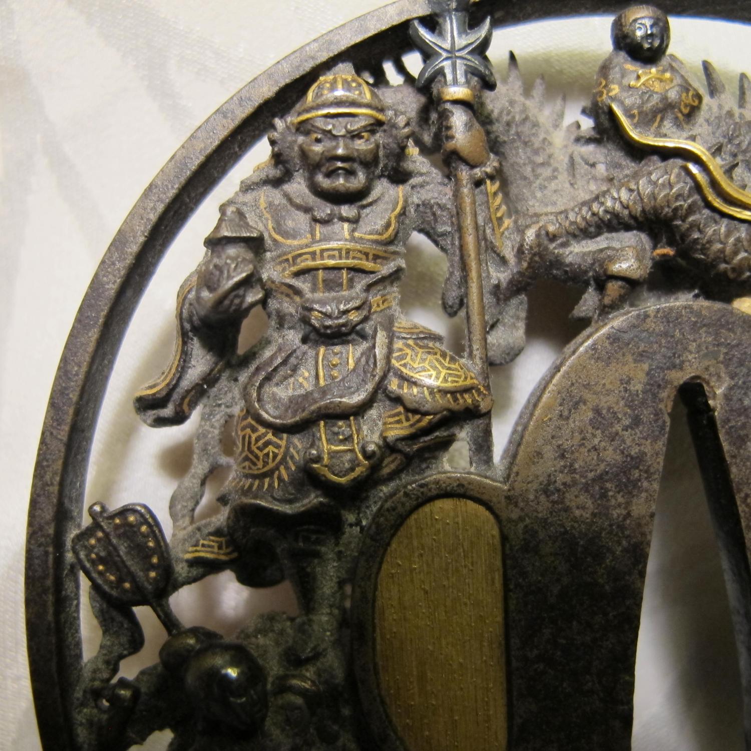

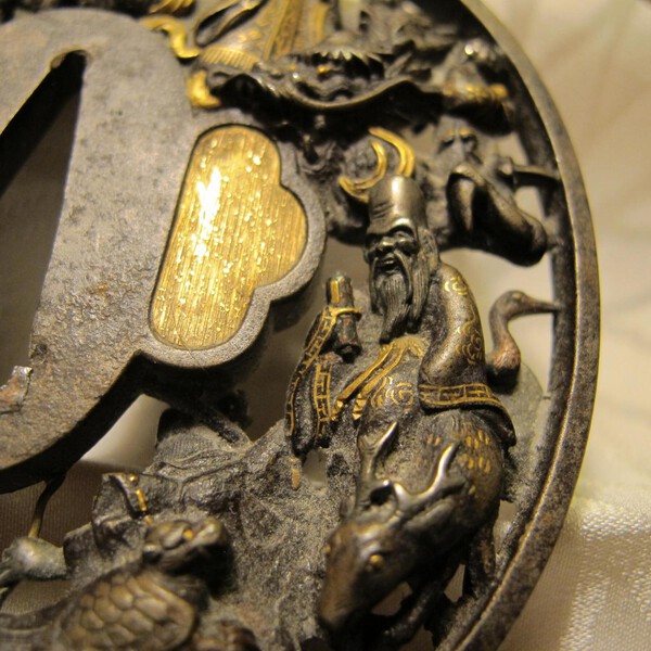

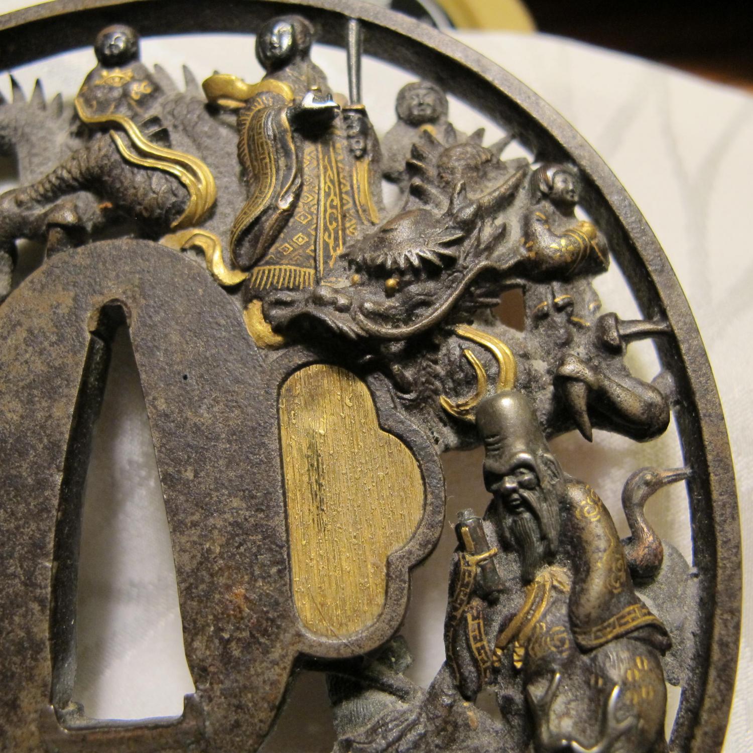

Brilliant photos and a good find for the tsuba.  If you think in terms of design and execution then the flowing and balanced distribution of figures allied to the fine carving and modelling and the detailed inlays work would all suggest that this is a good piece.  Can't help with the attribution except to say that I think it is well above the average Soten school work but probably quite late.  Look at the way the dragon is carved and his head comes above the level of the surrounding plate.  And as always look at the carving of the faces.  If you can see character in faces carved on this scale then whoever made it was damn good at his craft.
Enjoy, I think you have got a keeper.

In my opinion this is a nice TSUBA with a lot of skilled craftmanship put into it. It's appearance would profit a lot from careful cleaning (with a soft brush or even with mild soap and warm water) as the dust is obscuring many details. There are hints that the basic body may have been cast, but even if so, the main work has been put into it after casting. The design is good and full of well placed details, the faces are expressive and nicely modeled, and to my eye all the different soft metals are very well executed.
Unless Ford says that my old glass eyes need to be replaced, I congratulate you to this purchase!

First rule is: Do not touch the TSUBA's surface mechanically or chemically if you don't know how! You will not see deteriorate the TSUBA in this life or the next, if you keep it dry.
So: No soaking in oil or other chemicals! Applying heat after a little water wash may be a good thing if it is very moderate. Your central heating system or sitting it near your stove for half an hour may be sufficient. No heat gun!
The warm water may even be enough if you dry your TSUBA thoroughly with household paper right after the cleaning wash.
Second rule: Never mess with the patination until your nickname is Ford Hallam! What was built up in centuries is gone in seconds!
Don't bury your TSUBA in an airtight coffin (or box) for display, but use a standard KIRI wood box. That will be appropriate and technically sufficient.
My suggestion for a first step is a soft dry cleaning with your wife's toothbrush. Then look carefully if that was enough. If not, PLEASE read what you find here on NMB about cleaning, rust removal or restoring TSUBA. There is a wealth of information, and you are not the first collector to face the problem!

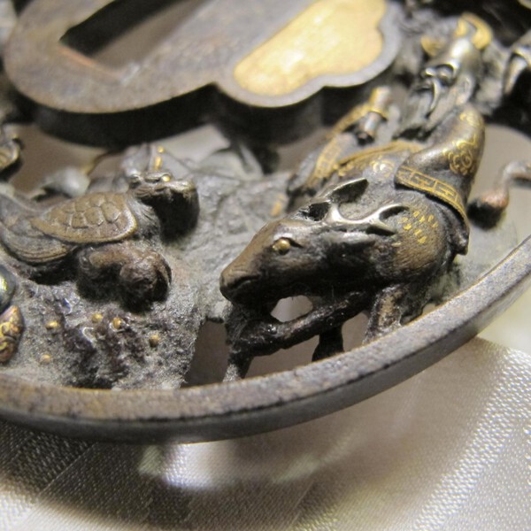

this piece is a very good, relatively early (for the school, perhaps mid 18th cent.) Soten style work, imo.
Sadly the original patina has been stripped off at some point relatively recently. By the looks of the various metal surfaces it looks to me as though a mild acid or pickle of some sort was the culprit. The biggest 'give away' for me are the bright pink copper patches on Hotei's robe.
What this really needs is a proper restoration and then it can safely be stored in a kiri-bako and treated just like any other tsuba in good condition.
Hope that helps.
ford
p.s. the iron is almost certainly a very finely worked wrought iron, which would be usual for Soten work.
