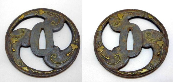

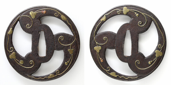

zanilu Posted November 15, 2015 Report Posted November 15, 2015 Hello to Everybody on NMB I have sort of fascination for Heianjo zogan tsuba. So I bought some over the years. Among those in my collection I have three that are extremely similar, practically identical in design differing just for their size. All tree tsuba are mitsudomoe testuji with bass inlay in the form of wines and leafs. The smallest of the tree has kozuga and kogai itsu-ana. The largest smallest I consider as part of a sort of daisho. I have found on the net several tsuba (fig-01 to fig-05) similar for design and dimensions to my trio as reported in the attached table. According to Haynes website: A form of brass inlay, see Figure 4.20. This method was used even in the old periods, but from the latter part of the Muromachi Jidai to the Momoyama Jidai, it was called HEIANJO ZOGAN and HIRA ZOGAN of SHINCHU (brass) was quite popular. There are a fair number of extant works by YAMASHIRO NO KUNI JU NAGAYOSHI, HEIANJO JU MASASHIGE, IZUMI NO KAMI KOIKE YOSHIRO, and the like. All my tsuba and the those found on the web look to be of the late Edo period to me, not as old as Muromachi. The workmanship and the designs of these tsuba look the same. Is it so also for a better trained eye? I mean there are subtle differences in the design and realization that I cannot see? I have rarely seen signed Heianjo tsuba (I could be wrong of course) and I have not find any specific information regarding schools or artisans (I could be wrong on this too!). In Heianjo tsuba there seems to be a sort of serial production of certain designs (this one and others). Is this due to the popularity of these designs reproduced by different group of artisans or can they be traced back to some workshop/groups or geograpic areas? I was wondering whether there are specific information about this style or school and whether it is possible to divide them by design or specific peculiarities. Also if anyone of you as information about this mitsudomoe design that he/she can share I would be grateful. Regards Luca Size Table --------------------------------------- tsuba-01 83.7 mm x 82.7 mm x 4.9 mm daisho (dai) 87.0 mm x 86.0 mm x 4.0 mm daisho (sho) 78.0 mm x 77.4 mm x 3.6 mm --------------------------------------- fig-01 83.0 mm x 83.0 mm x 6.0 mm fig-02 82.0 mm x 82.0 mm x 5.0 mm fig-03 85.0 mm x 85.0 mm x 4.5 mm fig-04 87.5 mm x 87.5 mm x 5.0 mm fig-05 84.2 mm x 83.6 mm x 4.5 mm --------------------------------------- 2 Quote

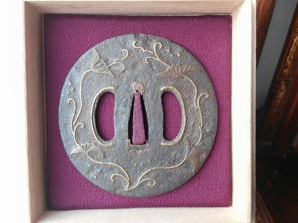

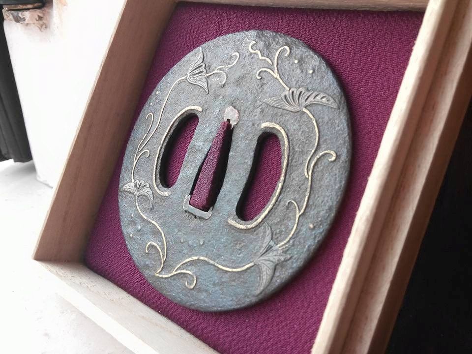

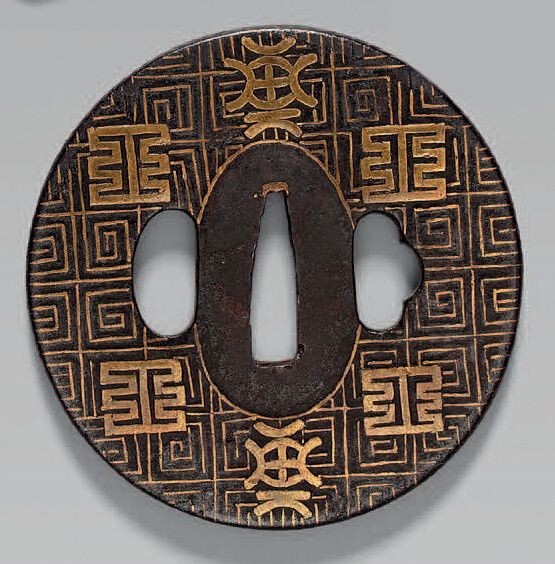

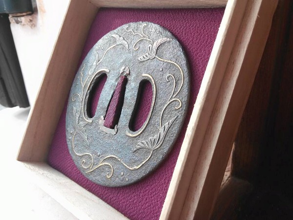

Stephen Posted November 17, 2015 Report Posted November 17, 2015 http://www.aoijapan.com/tsuba-mumeiheianjo-flower http://www.ebay.com/itm/Antique-Japanese-Heijo-TSUBA-for-Katana-Brass-Inlay-Openwork-Edo-Excellent-152g-/171999174423?hash=item280bf31f17:g:jDAAAOSwLVZViA7r Quote
zanilu Posted November 17, 2015 Author Report Posted November 17, 2015 Hi Stephen. Nice pieces especially the second one! Ford. I have a some knowledge about metal analysis from my work, but I can not thing to any technique that will not damage even in very tiny regions the metal or the patina. Do you know of any method that is at the same time cheap and harmless for the piece under examination to determine the composition of the brass. Regards Luca 1 Quote
Ford Hallam Posted November 17, 2015 Report Posted November 17, 2015 Luca there are a couple of non-destrustive methods for analysing metals but nothing is cheap, I'm afraid. Quote
zanilu Posted November 17, 2015 Author Report Posted November 17, 2015 Ford Quote there are a couple of non-destrustive methods for analysing metals but nothing is cheap, I'm afraid. I was afraid of your answer. X-Ray diffraction of SEM/TEM are too expensive to be considered for a personal research... Luca Quote
Ford Hallam Posted November 17, 2015 Report Posted November 17, 2015 http://www.nitonuk.co.uk/xrf-analyser/# I've used one of these in my own research recently and have plans to organise a broader analysis project but that must wait until my present work is completed. And £25 000 f0or that handheld gizmo may take a while to raise. However the data it will deliver may in some cases transform our present understanding of Japanese metalwork datings and in others serve as a valuable confirmation of authenticity. I may even issue papers. At least mine will be objective. 2 Quote

C0D Posted November 18, 2015 Report Posted November 18, 2015 Sorry i step in, what about this one? Heianjo made also mixed materials inlay too? This appear to be brass, copper and maybe some shibuichi drop. 1 Quote
Brian Posted November 18, 2015 Report Posted November 18, 2015 Good question, interested in the answer myself Ford, are those different metals, and would that then change the school completely? Quote
Ford Hallam Posted November 18, 2015 Report Posted November 18, 2015 Manuel, Brian We do see copper and brass together on Heianjo work. The shibuichi drops are more likely silver, it's possible they're original but may have been added later. If they are actually shibuichi they'd have been added after the start of the 18th century. Personally I wouldn't regard these brass inlay guards as belonging to organised schools as we think of them in the Edo period. It seems to me to be more of a communal production in that certain styles became popular and were centred on certain areas of production. It is often claimed that brass was at one time very expensive in pre-Edo jpan but I can find no evidence to support this assertion. In fact although zinc was never actually mined and refined in Japan until the early 20th century and was always imported from China it was used to make copper go futher. It was cheaper than lead and allowed the alloy to melt more readily. Brass coinage in China only really appears in the last 1/4 of the 16th century so that source of brass for the inlays is likely also unlikely in my opinion. It's also important to recognise that what we today see as a lack of originality was not necessarily regarded as a negative thing at all in the past. Continuity of style was highly valued. One only needs to consider the survival of the Goto to recognise that the 'powers that be' valued that tool (unchanging styles) for maintaining a sense of stability and continuity. 2 Quote
C0D Posted November 18, 2015 Report Posted November 18, 2015 On 11/18/2015 at 5:47 PM, Ford Hallam said: Manuel, Brian We do see copper and brass together on Heianjo work. The shibuichi drops are more likely silver, it's possible they're original but may have been added later. If they are actually shibuichi they'd have been added after the start of the 18th century. Personally I wouldn't regard these brass inlay guards as belonging to organised schools as we think of them in the Edo period. It seems to me to be more of a communal production in that certain styles became popular and were centred on certain areas of production. It is often claimed that brass was at one time very expensive in pre-Edo jpan but I can find no evidence to support this assertion. In fact although zinc was never actually mined and refined in Japan until the early 20th century and was always imported from China it was used to make copper go futher. It was cheaper than lead and allowed the alloy to melt more readily. Brass coinage in China only really appears in the last 1/4 of the 16th century so that source of brass for the inlays is likely also unlikely in my opinion. It's also important to recognise that what we today see as a lack of originality was not necessarily regarded as a negative thing at all in the past. Continuity of style was highly valued. One only needs to consider the survival of the Goto to recognise that the 'powers that be' valued that tool (unchanging styles) for maintaining a sense of stability and continuity. Thank you Ford, do you have any example of mixed inlay material tsuba? What you think about the age of the tsuba? It appears late Muromachi / Momoyama to me Quote
zanilu Posted November 18, 2015 Author Report Posted November 18, 2015 Brian, Ford If you look at the sho tsuba of the "daiso" of my original post you will see tha the beads just above the top (edge side) of the nakago ana are made of copper not brass like all the other inlays. Is this whst you mean with "mixed inlay"? Luca Quote
