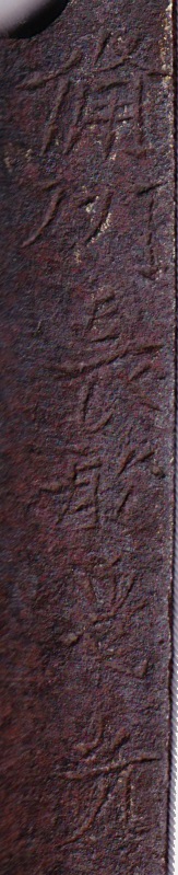

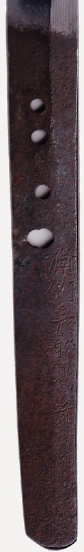

FletchSan Posted November 13, 2015 Report Posted November 13, 2015 Hi All, Having trouble translating the 2nd last character on this mei. This is from another thread I started in the Military Blades section. http://www.militaria.co.za/nmb/topic/18090-my-new-favourite-sword-kyu-gunto/ Not sure if it is Kagemitsu, Kanemitsu or Tadamitsu .. or something else? cheers, Ben Quote
Stephen Posted November 13, 2015 Report Posted November 13, 2015 Yukimitsu? best guestamation a light oiling and wiping may reveal more Quote
FletchSan Posted November 13, 2015 Author Report Posted November 13, 2015 Thanks Stephen - tried a light oil and wipe and took a few more pics. Should be a little clearer. Quote
Shugyosha Posted November 13, 2015 Report Posted November 13, 2015 Maybe Tadamitsu? It doesn't look quite right but there is an Osafune connection...so definitely maybe... Best, John Quote
FletchSan Posted November 13, 2015 Author Report Posted November 13, 2015 I think it is Tadamitsu looking at the Tada Kanji in Yumoto's book. 1 Quote
Stephen Posted November 13, 2015 Report Posted November 13, 2015 http://sanmei.com/contents/en-us/p1695.html http://www.sho-shin.com/sue4.htm Quote
FletchSan Posted November 14, 2015 Author Report Posted November 14, 2015 Thanks Stephen. Probably impossible to work out which Tadamitsu as there is no date I can see unless its obscured by the rust. Would be interested in your thoughts on the sword in the other thread. cheers, Ben Quote

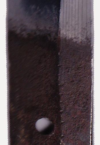

FletchSan Posted November 18, 2015 Author Report Posted November 18, 2015 Slightly off topic, though same sword. Does anyone know what the notches represent on the nagako? thanks, Ben Quote
Brian Posted November 18, 2015 Report Posted November 18, 2015 Short answer is "nothing" They don't represent anything. Maybe used when assembling a certain koshirae to keep parts together, or maybe something else. But nothing meaningful to a collector. Quote
Stephen Posted November 18, 2015 Report Posted November 18, 2015 oh come on now we all know its how many ninji the sword has wasted....geeessh 1 Quote
Shugyosha Posted November 18, 2015 Report Posted November 18, 2015 Or it could be his score for a long weekend in Yoshiwara. 1 Quote
FletchSan Posted November 19, 2015 Author Report Posted November 19, 2015 Thanks, was just curious - both explanations are awesome Quote
