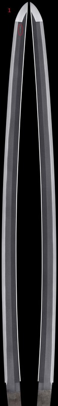

I have been researching “KIZU” and would appreciate any input on the following pictures. What I trying to distinguish is what is actually considering a flaw and what is not.

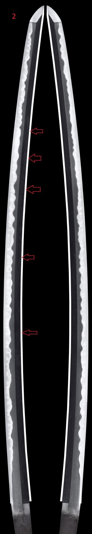

Good topic!  I still struggle with the difference between "O-Hada" and Ware.  Given that preface, I would say sword one has a ware, since it is in a single spot and doesn't appear to have been deliberate.  The second looks like o-hada, since it appears pretty uniform in the shinogi.  That said, it's not present on the omote shinogi, so maybe early signs of being tired :dunno:
Looks like just a little bit of Ware/loose grain which is very common. To elaborate, pic 1 is ware, pic 2 is probaably ware as well, however in context this what looks like a shinto katana which were almost exclusively made with masame in the shinogi-ji which seems to be more prone to splits in welds between layers.

Picture 2 is of newer (Kanbun era) sword. My assumption would be that it probably wouldn’t have been over polished(?) The hada looks to be very tight everywhere else other than on the SHINOGI-JI. I thought that areas rough hada were indication of a poorer quality forging? This however didn’t affect the sword from getting Juyo. Am I making a newbie mistake by thinking this?
To some extent Ken you are making a mistake. Masame hada is often (very often) present in the shinogi-ji of shinto swords. It is one of the features looked for when trying to determine period of manufacture. This masame lends itself to causing roughness, or openning along the shinogi-ji. In the work of some smiths this is seen as a characteristic of their style and not necesarily seen as a fault, For example works by Hankei and Sukenao often exhibit this but both are regarded as very talented smiths and this a feature of their workmanship.
On a pure personal level I dont tend to think of this parallel roughness as a kizu but nor do I find it very appealing  others are less concerned. It is certainly less of a problem than blistering or delamination within the Ji. Whether this type of fault is seen as fatal is debatable. Fatal flaws are generally regarded as those that impair performance such as hagiri, or the loss of the boshi. However if a sword is important enough it can receive high level papers despite having lost its boshi.
Sorry there is not a black and white answer ( as with much in this subject) but because a sword has the type of openness you see in your second example does not make it a poor quality sword or undesirable. It is one contributing factor you need to assess against all the others.

The left katana is a Shodai Hizen Tadayoshi. It's a damn shame it has that ware, because it's otherwise very a nice sword.  I've actually noticed ware in the same exact spot a few Hizen Tadayoshi blades.
