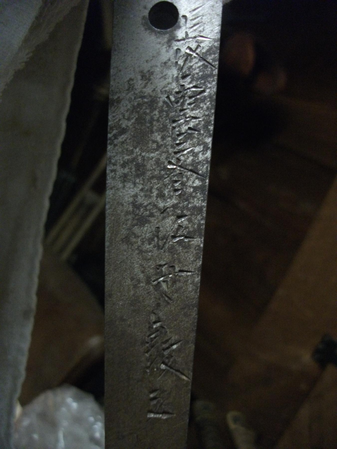

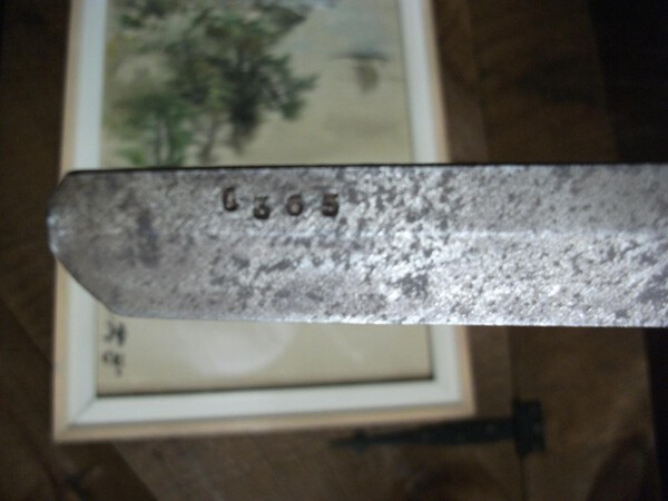

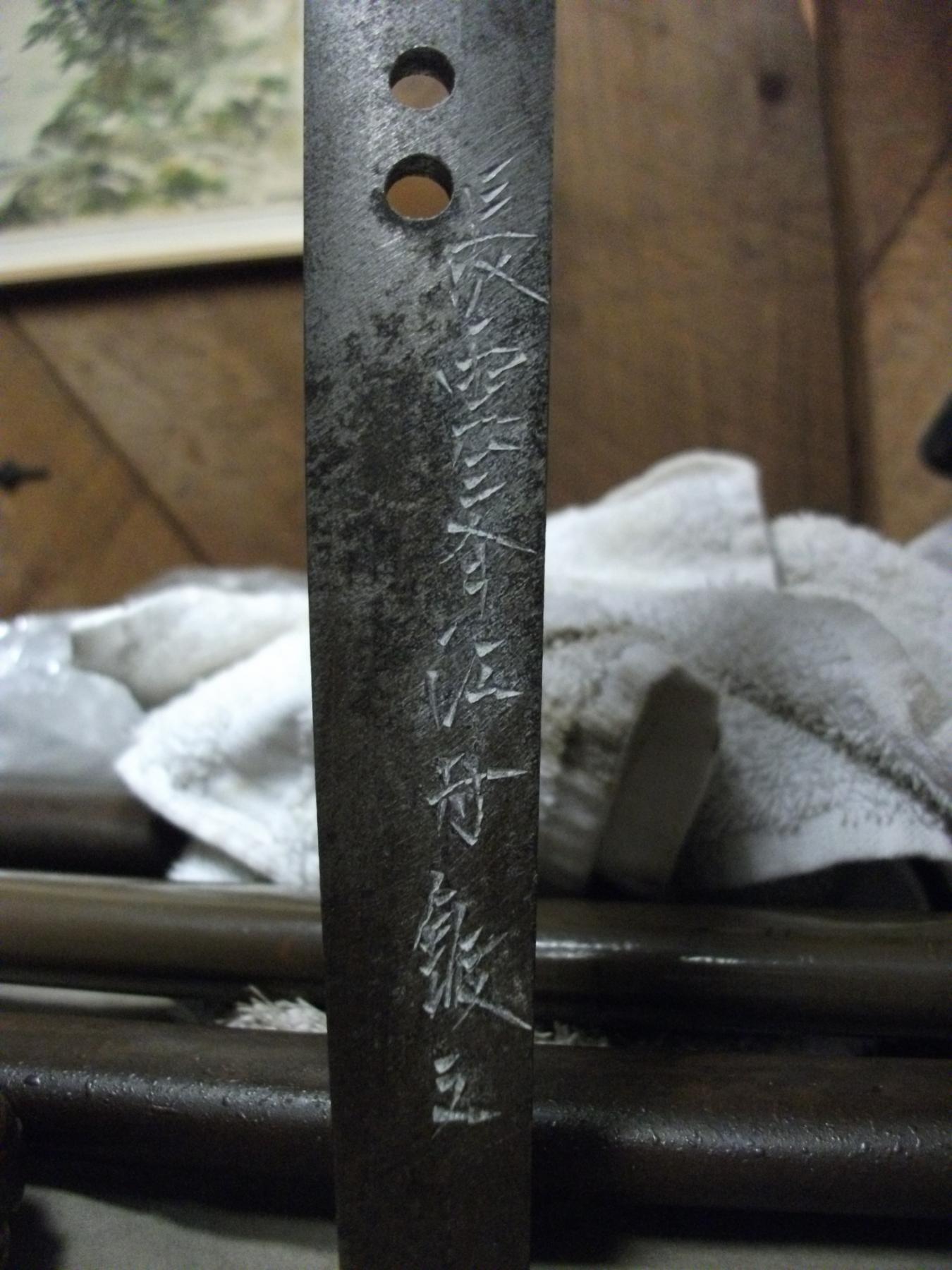

mauser99 Posted November 11, 2015 Report Posted November 11, 2015 as always thank you all ahead of time.. As this is something we shouldn't take for granted. The chances of me learning Japanese is slim to none A very difficult tang to photo.. Kanji is small and tight. Dark as well. I can try the chalk trick if we cant get there.. Tang is single sided less a serial #. No arsenal stamp visible. Quote
SteveM Posted November 11, 2015 Report Posted November 11, 2015 Looks like 長雲斎江丹鍛之 I would have expected 村 rather than 丹, but it looks much closer to 丹 than 村. (But, if it is 江村, you would expect 長運斎). Edit: Actually, I take that back, it does look closer to 村 than 丹.So, 長雲斎江村鍛之 Chōunsai Emura kore wo kitaeru (but perhaps still a puzzling 雲 which I would expect to be 運. Pronunciation is the same either way.) Quote
Brian Posted November 11, 2015 Report Posted November 11, 2015 That kind of "chippy" style mei (usually on Showato) doesn't fit well with any of the standard type signatures of Emura http://japaneseswordindex.com/emura.htm Quote
mauser99 Posted November 11, 2015 Author Report Posted November 11, 2015 Thanks as always.. So this may be my second prison made blade. The other being the Nagamitsu I posted. Or was Nagamitsu put into prison and then made blades while there. I can caulk in the Kanji if this may help. Any idea why or what the serial # means ? The fittings aren't numbered on this example. So I doubt its an assembly number ? Quote
SwordGuyJoe Posted November 11, 2015 Report Posted November 11, 2015 It's not THE Emura unless this is one of the worst signatures I have ever seen... Also, Nagamitsu had no affiliation with a prison - that was Emura. About Emura: http://www.japaneseswordindex.com/emura.htm About Nagamitsu: http://www.japaneseswordindex.com/naga.htm The Emura and Nagamitsu debate: http://www.japaneseswordindex.com/nagamura.htm Quote

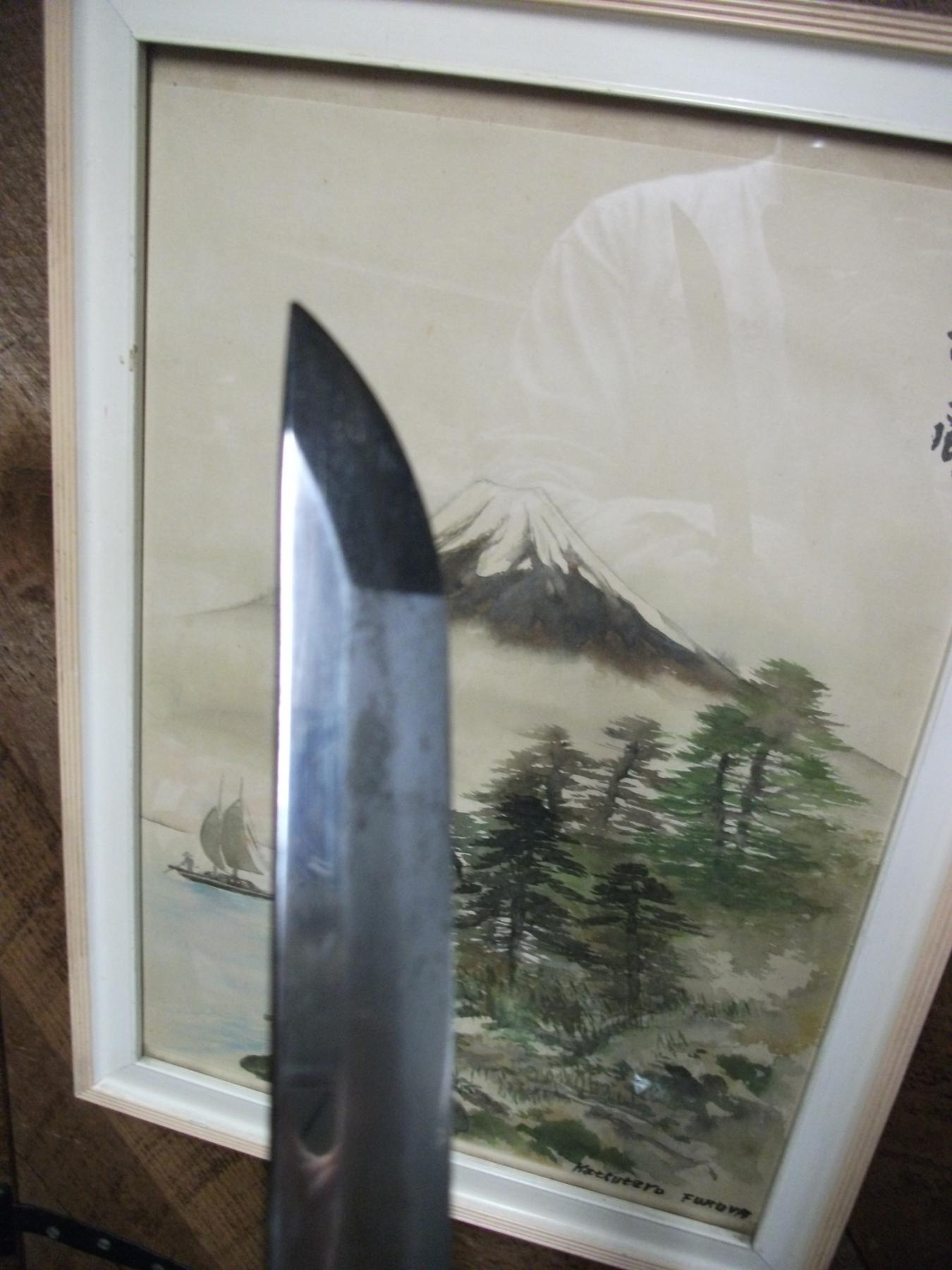

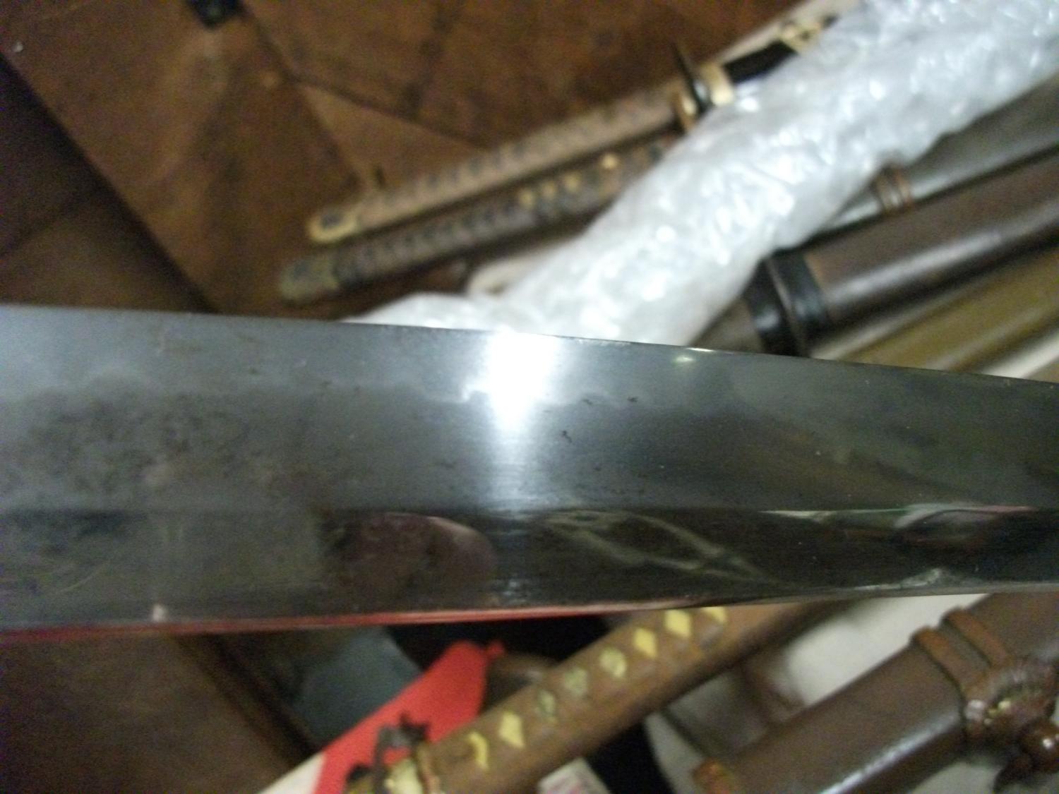

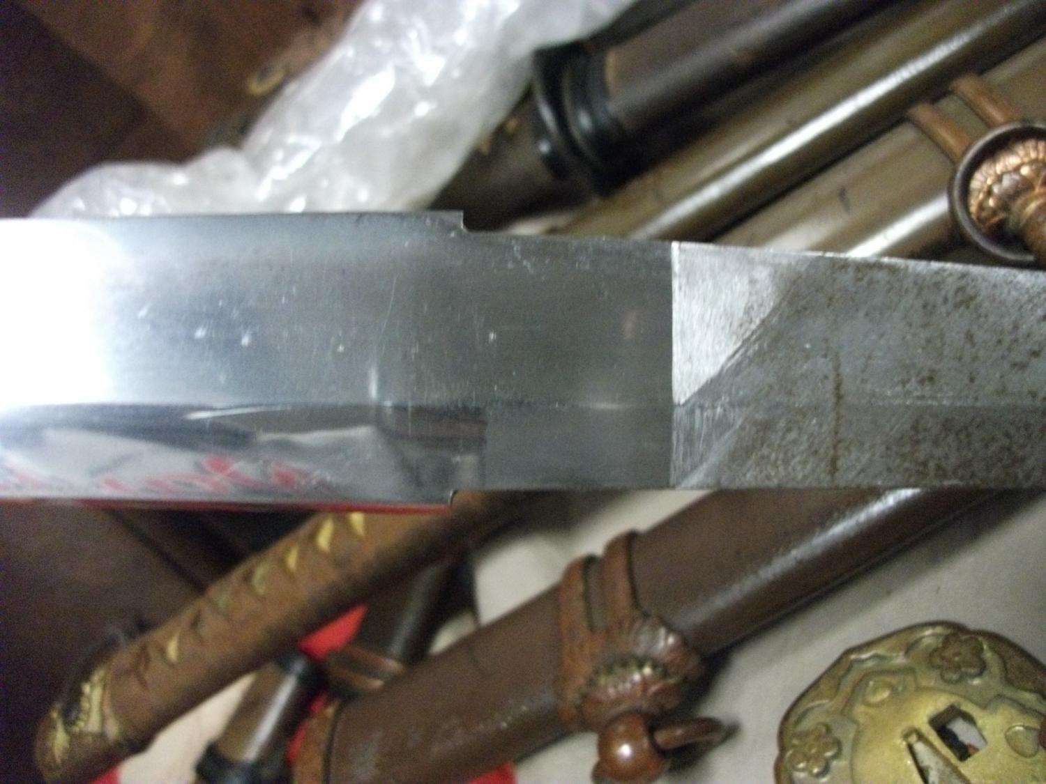

mauser99 Posted November 11, 2015 Author Report Posted November 11, 2015 here are some better photos with chalk added to highlight the kanji. Also showing the polish and harmon. My comment of the wartime Nagamitsu was based on what I was told as he was put in prison for killing his wife and made blades while incarcerated. Another myth ? Im sure it is.. Quote

mauser99 Posted November 11, 2015 Author Report Posted November 11, 2015 Yup - Myth. Well at least I've never seen, heard, or read that one before. ok, No more mentioning this myth. What about the clearer signature ?? Doesn't match any on the posted link. But, if he had many students there is a possibility of many variants. Similar to nagamitsu. Also having both I can say this blade is much lighter than the Nagamitsu I own. That blade has a thicker nose and more overall weight. This blade is as light as a feather. Quote
mauser99 Posted November 11, 2015 Author Report Posted November 11, 2015 I posted a really clear chalk filled photo to help with translation. There seems to be some discrepancy with this one.. Quote

mauser99 Posted November 11, 2015 Author Report Posted November 11, 2015 I have to agree that it doesn't match any of the examples listed on that web-site. I'm not 100% if this guy was famous enough to have his signature copied ? The blade to me is very good quality but, I'm just a novice. Quote
SteveM Posted November 11, 2015 Report Posted November 11, 2015 Hello Wayne, As far as I can tell, the chalked in version makes it a bit clearer to see, but it doesn't change how anything looks. The mei still reads 長雲斉江村鍛之 But the 村 is very odd. I changed the 斎 to the simplified version 斉, but the reading/meaning is the same. 1 Quote
mauser99 Posted November 11, 2015 Author Report Posted November 11, 2015 Hello Wayne, As far as I can tell, the chalked in version makes it a bit clearer to see, but it doesn't change how anything looks. The mei still reads 長雲斉江村鍛之 But the 村 is very odd. I changed the 斎 to the simplified version 斉, but the reading/meaning is the same. thanks, Steve . I guess the text doesn't lie. So it says Chounsai Emura Kore wo Kitaeru Is the that the name and Province ? Quote
SteveM Posted November 11, 2015 Report Posted November 11, 2015 長雲斎 江村 Chōunsai Emura would be the name. Emura the family name, and Chōunsai is kind of his artistic nom de guerre. 鍛之 Kore (wo) kitaeru means "made by" Quote

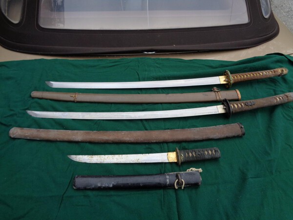

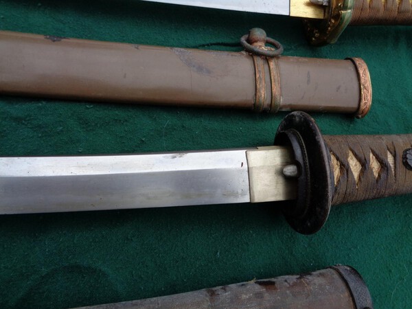

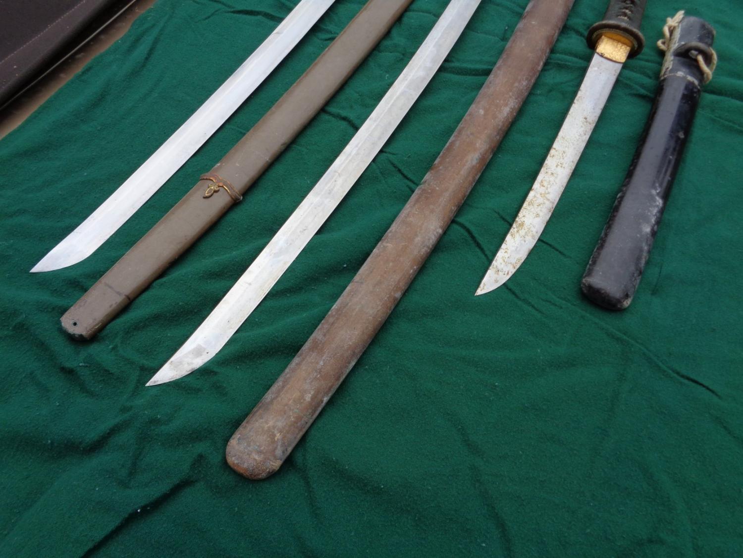

mauser99 Posted November 12, 2015 Author Report Posted November 12, 2015 I will do a shoot on the type3 soon. I will do it before I attempt to take it apart. Lots of these seem to have screws not pegs and they do some damage when removed. I know a guy who sets up @ the Allentown PA show and may bring it again to him and he can help me do it with as little damage as possible. These are the photos when it was pulled out of the basement along with the two others. In the one photo you can see the paper used to mask off the burlap so when the wrap is treated it doesn't discolor it. We were thinking maybe the sword was never finished ? Quote
Brian Posted November 12, 2015 Report Posted November 12, 2015 That tanto is very nice. I hope you kept it? Little less enthusiasm for the Type 3 now though. But gendaito..yes. Quote
mauser99 Posted November 12, 2015 Author Report Posted November 12, 2015 no, I sold it off to help finance the others. I think the guy who bought it still has it ? If anyone is interested. The blade is just dirty in the photos. It's fine believe me. The vet coated all the blades in some sort of grease ?? Came right off. Again, I showed a couple knowledgeable people the blade and said it was nice. I just didn't feel temped at the time to tear into what's been in place since 1945. Quote
SwordGuyJoe Posted November 12, 2015 Report Posted November 12, 2015 Probably another Nagamitsu. Edit: looking at the sugata again, maybe not. Maybe Kanehide... Quote
mauser99 Posted November 12, 2015 Author Report Posted November 12, 2015 I can provide better photos. I just happen to remember I had this stored so I posted them. Quote

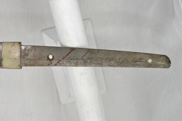

george trotter Posted November 13, 2015 Report Posted November 13, 2015 Hi Wayne, I think you might have a RJT blade there in that "Type 3". These are good quality fittings. I have an identical one ,,,same fittings maker... which contains a star stamped RJT blade by "Fushimi Ju Takashima Kunihide Saku" of Kyoto. Nothing much known of my guy but after cleaning, a very nice sword. The two photos here are from the ebay seller a few years ago...blade pic is taken at an angle so blade looks shorter than it is. Fittings are identical to yours. Looking at your handle wrapping, I'd say that the paper has slipped out of place under the binding (mine was the same...also had a strange "hessian" looking material instead of same). A gentle prod back into place with a slim screwdriver blade or a wooden toothpick or something will sort out the paper " triangles. You should then see the tops of either screws or pegs or maybe one of each (mine is two pegs). Yours and mine would have originally had leather combat covers on the saya.. Just be careful and don't rush. If you have a problem just ask here and one of us will help ...maybe there is a member near you who can show you how to be careful and get a handle off without damage to binding, handle or sword. Good luck and let us know what you find. regards, Quote
Bruce Pennington Posted May 26, 2024 Report Posted May 26, 2024 Old Thread Warning!!! @SteveM @Kiipu Still feel good about the Chonsai Emura translation on this? Thomas, What do you think that first character is before the 365? Quote
SteveM Posted May 26, 2024 Report Posted May 26, 2024 Yes - still Chōunsai Emura kitaeru kore. 1 Quote
Bruce Pennington Posted May 26, 2024 Report Posted May 26, 2024 Thanks, Steve, just discovered this and adding it to my charts of blades with stamped numbers. Quote
