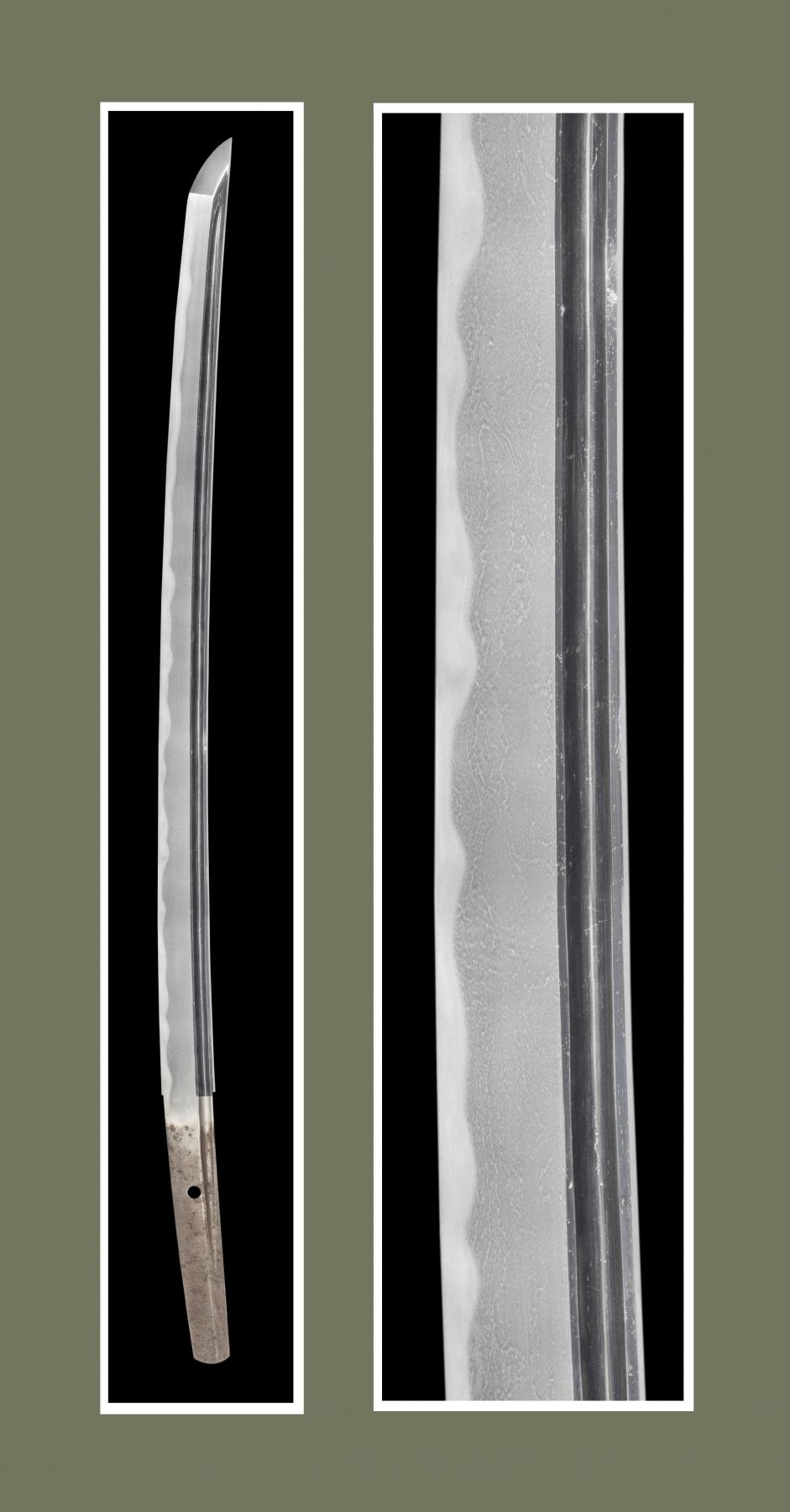

One of the problems with this area is the term has multiple meanings. I had a long correspondence with Tanobe san about this when I was writing the article on the subject. In his words "even the average Japanese student struggles to understand the use of the term" A Yamato Shizu sword can be:
1. A blade made by Kaneuji after he moved from Yamato to Shizu
2. A blade by one of his students still in Yamato (so looks like Tegai work)
3. A blade made by successive generations prior to them moving to Naoe.
Then you have the added complication when all of these become blurred and the balde is just designated as Shizu (which can actually mean something different again)
As a result you do see a lot of variation in blades with this designation.
If it is thought to be by Kaneuji the paper will usually say Shodai Yamato Shizu (according to Tanobe san) If it simply says Yamato Shizu then one of the other groups apply.
I have seen a fair number of Yamato Shizu swords and I think they do vary far more than some other schools in both style and to some extent quality (most have been extremely good just some better that others)
The one at Nihonto.com is obvious enough for me to call Yamato, but would have probably guessed at Hosho had I not seen the attribution. The sword at Aoi art doesn't (to my uneducated eye) have sufficiently obvious Yamato traits for me to even call the province - far too subtle for me.
