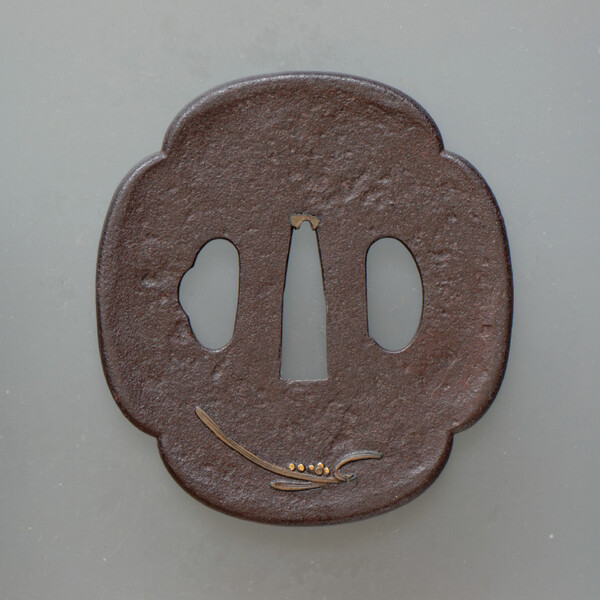

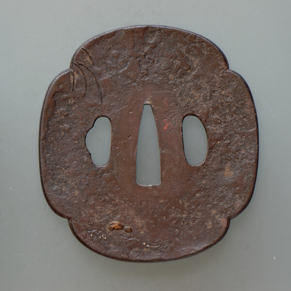

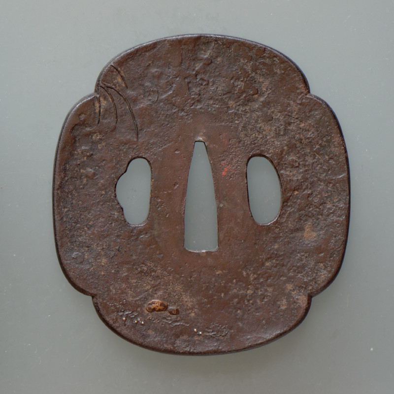

Whenever I see a tsuba of this form (mokku shape, lightly hammered surface, mixed metal design in lower right quadrant, usually wakizashi size) in auctions they seem to be catalogued as Tanaka school.  Not that the Tanaka school only produced tsuba in this style.  What interests me is that, on the reverse, the decoration often appears to be a couple of small rocks lying on the ground (as this example) or a small plant in the lower left quadrant.  Always seem to be a bit odd and nothing to do with the main subject.  It appears that the artist was happy with the main theme and then just stuck something simple on the back.  Any ideas why they should choose rocks?

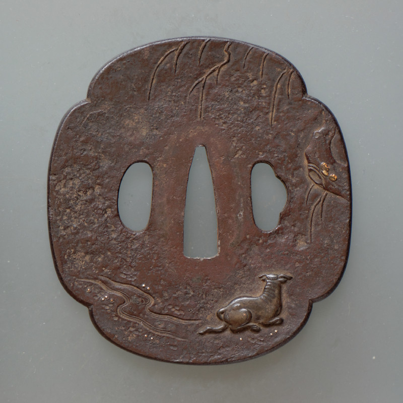

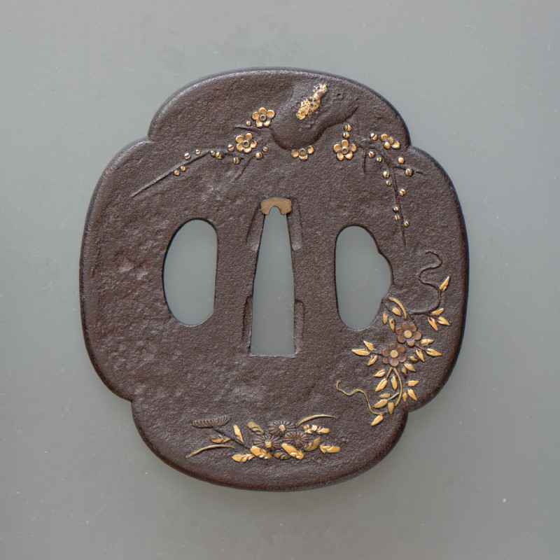

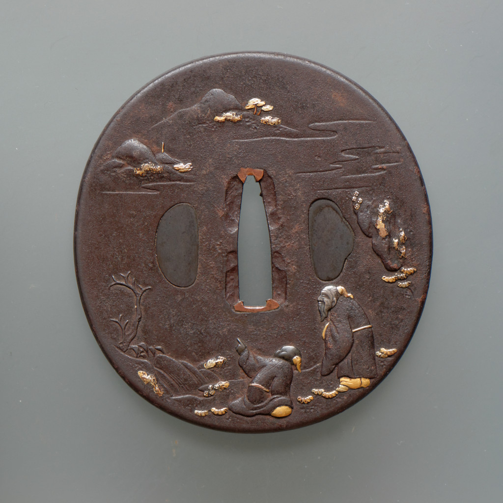

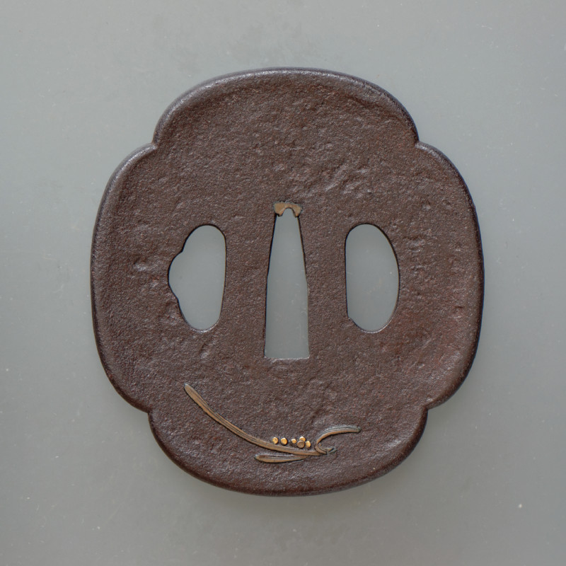

no much to add. Here as reference 3 tsuba :
the first one is papered as Nara ( the workmanship is very similar to the one on your tsuba)

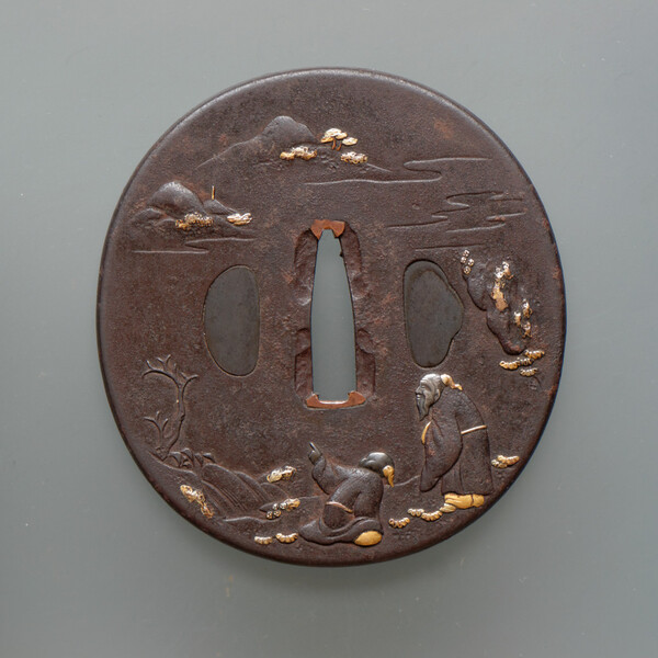

the second on is the one with the same theme (no paper)

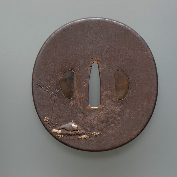

the third one is papered as Aizu shoami
Thank you very much for your reply, Thierry. The working on the iron plate on #1 and #2 are very similar, #3 not so much. I am leaning more toward Nara then on mine.
