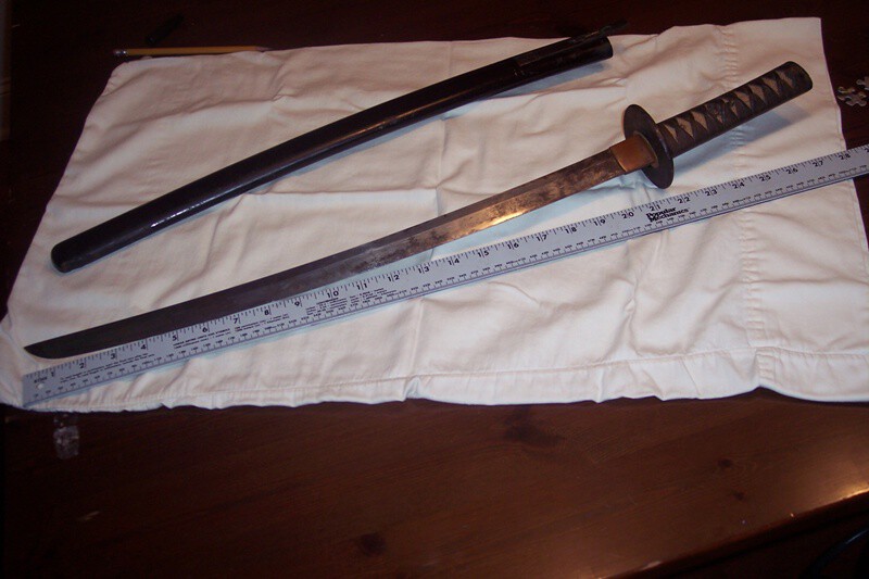

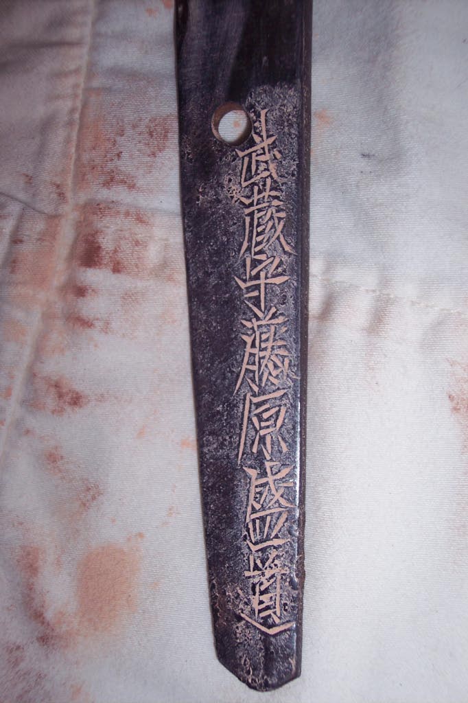

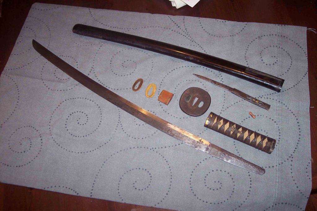

RayE Posted October 18, 2007 Report Posted October 18, 2007 Hi all, I'm new to the forum and new to these swords. My dad has a couple that he got in Japan right after WWII. I have one of them with me and took a few pictures. What can you tell me about this one? The mei (I think that's what it's called) is enhanced with chalk so it stands out fairly well. This is a wakazashi, I think - total length is 26.5" (~67cm). Are there other specifc things that you'd need to see in order to help me figure out what I've got? Thanks for your help, Ray Quote
RayE Posted October 18, 2007 Author Report Posted October 18, 2007 Help if you can - please. Here are more pics: Ray Quote

kitsune Posted October 18, 2007 Report Posted October 18, 2007 Hi, This blade is signed Musashi no kami Fujiwara MORIMICHI, Shinto swordsmith with a rank chû jô saku, Kanbun shinto (In the late 17th century). Quote

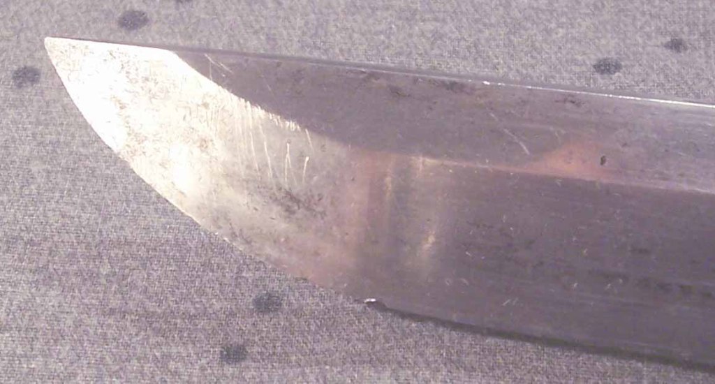

RayE Posted October 27, 2007 Author Report Posted October 27, 2007 Well, I've exhausted all of the available resources that I can find on the net and am really frustrated. I have not been able to come up with anything else on this smith. At Sho-Shin, I found a handful of Morimichis but nothing that really tells me anything. Are there other examples of his work that you can point me to? Where did he work? In one case, I see Owari, but he has Musashi in the mei. What does this mean? Can anybody unpack the meaning of the mei for me? I'm really sorry to ask - I like doing for myself - but I can't think of anything else to do short of trying to find and buy a bunch of books. What school was he from? Is/Was he a "good" and respected smith? I know I need to post some pictures of the blade, and will as soon as I have the chance. May be you could tell me more after looking at them? Thanks very much for whatever help you can give me. I REALLY appreciate it. Ray E. Quote

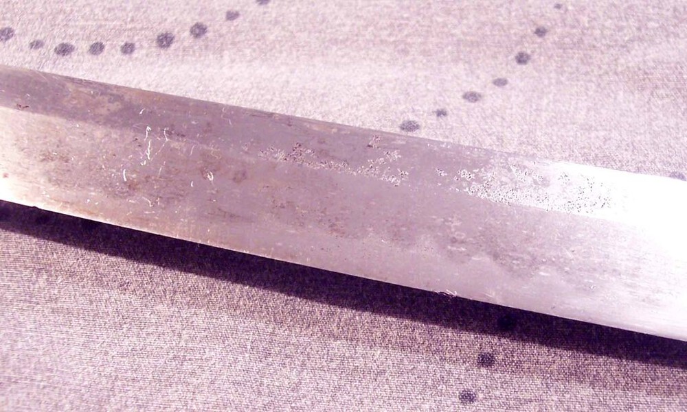

RayE Posted October 29, 2007 Author Report Posted October 29, 2007 Thanks for the info! I took a lot of pictures tonight, but very few really show anything. I tried to capture what I can see of the hamon, but it's tough. I'd call it Gunome (from http://token.cz/external/meiboku/guide/ ... /index.htm), which I believe is a typical Mishina style (?) Mune = Ihori Hada = Can't see it well, but probably Masame. Sori = 9/16", 1.4cm (measuring from line from Mune -Machi to tip) Nagasa = 20-7/16", 52cm Nakago = 6", 15.2cm Kasane @ Mune-machi = 7/32", 6mm Mihaba @ Mune-Machi = 1-3/32", 2.8cm Kissaki (tip to yokote) = 1-1/8", 2.9cm Any more info from these pics? Thanks, RayE Quote
Jacques Posted October 29, 2007 Report Posted October 29, 2007 Hi, There are several Morimichi; Morimichi ha worked both in Mino and Owari, smiths of this school are descended from the late Koto Smith Muromichi of the Seki Muroya ha. Two main families with parallel dévelopment each succeding to their own title: Sugura no kami fujiwara Morimichi (shodai, nidai, sandai) Musashi no kami fujiwara Morimichi (shodai nidai sandai) worked in sue-seki style. Darcy, it is not a eventuality, it is a fact, i have an oshigata of Suruga no kami Morimichi (nidai) wich reads Mishina Fujiwara Morimichi. source: Mino-tô Quote

Jacques Posted October 30, 2007 Report Posted October 30, 2007 Hi, Darcy... oshigata is here RayE's blade seems to have been machi-okuri (kiri and takanoha yasurime) About yasurime takanoha is not in conformity with Mishina-ha but some smith in Morimichi-ha used them. Quote
RayE Posted October 30, 2007 Author Report Posted October 30, 2007 Just to make sure I got the terminology correct: MACHI-OKURI - blade shortened by moving up the ha-machi and mune-machi Is this what you mean? If so, what do you see that brings you to this thought? And the "yasurime takanoha" refers to the feather pattern of file marks on the nakago? Thanks to all for your observations so far! Ray Quote

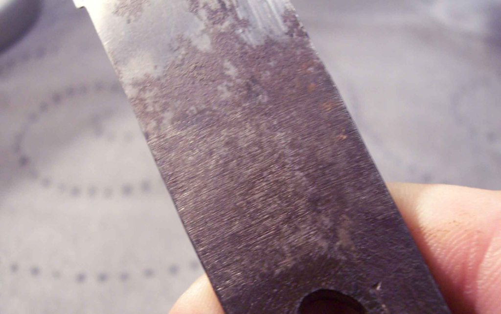

Jacques Posted October 30, 2007 Report Posted October 30, 2007 Quote MACHI-OKURI - blade shortened by moving up the ha-machi and mune-machi Right, So, i think that because the yasurime (file marks) are not the same all along the nakago; they are kiri (horizontal) and below takanoha (hawk feather) and the patina of the upper part (up the nakago-ana ) is more clear than the bottom. Quote
RayE Posted October 31, 2007 Author Report Posted October 31, 2007 You are wise! Now that I'm looking for evidence of this, it is clear. Some of the best looking steel (in terms of polish) is from under the habaki. I can also see the relatively fresh steel right behind the Machi (both). It is interesting that the other side of the nakago (opposite the mei) also has the kiri marks, but they extend about twice as far down toward the tip as on the mei side. It is also curious to me that in the original condition the nakago would seem to too "short" - could it have been mounted without a habaki? I believe the blade was shortened by almost exactly the length of the current habaki. Why might this have been done? Finally (until I think of something else to bother you with!), what does this do to the value of this piece? In my mind, nothing - since it's value is all sentimental to me, but for others? Thank you so much for your help. You have been very generous. Ray Quote
Paul Martin Posted October 31, 2007 Report Posted October 31, 2007 Quote It is interesting that the other side of the nakago (opposite the mei) also has the kiri marks, but they extend about twice as far down toward the tip as on the mei side. This would have been done in order to adjust the nakago without damaging the inscription. If you look down from above the mune of the nakago, you may notice it taper slightly more on that side. It is an indication of a well carried out machi-okuri/suriage procedure. Best Quote
