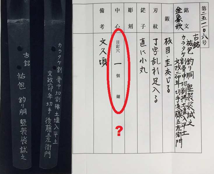

Thats my question how accurate are Kinzogan-mei? And is a strange that it isn’t singed (Kao) by the appraiser? I thought that the Honami family would also sign with their given Kao when they did this?

This might be my poor Japanese and I apologise in advance if I have it wrong, but is there a discrepancy between the date of manufacture as stated on the papers and that of the cutting test?

Well, it's a nice, suriage shinto or shinshinto blade but IMHO the papers and maybe the cutting test are dodgy.
The cutting test looks more like kinpun mei than the kinzogan mei stated on the papers: it doesn't look like it has been cut with a chisel with inlay added and there is no loss of gold from in the mei which wouldn't be unusual. It's signed with the name of a genuine sword tester, but as stated above, no kao...
According to my reading, the papers also say that the blade was made 文久頃 (around Bunkyuu which started 1861). The cutting test says that it was done in Bunsei 文政 starting in 1818. So unless I'm really off the mark (not unusual for the partially educated), the cutting test took place before the papers say the blade was made.
So all in all it doesn't add up for me, but I'm learning so please tell me if I'm overlooking something.
Your reading is correct. It raises a question about the kantei-sho.
