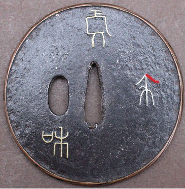

SteveM Posted October 11, 2015 Report Posted October 11, 2015 Can you post a picture that shows the whole tsuba, instead of just the close-ups of the kanji bits? The top right kanji is 音 oto (sound), bottom right is probably 味 aji (taste) but without knowing where they sit in relation to the other ones, its hard to say or even guess what the overall message is. Quote
Guido Posted October 12, 2015 Report Posted October 12, 2015 ... bottom right is probably 味 aji (taste) ... I think it’s 咊 (attachment A) instead of 味 (attachment B ). Quote
kissakai Posted October 12, 2015 Author Report Posted October 12, 2015 Hi Steve/Guido Guido, I think you are right with 咊 (attachment A) and great to see the image you have provided as this is the only image I can understand but I don’t know the meaning Steve, if I assume the top right kanji is 音 oto (sound), but it would help me to see it in seal script. Images below as requested. As I hope this puts thing in context. I was unsure about buying this one as there didn’t appear to be a mark for the seppa dai but now I have it in hand there is a faint mark and the rim is nice I have a feeling that you can ‘crack’ this one for me I have a load of Marcus’s book but not the seal one as I didn’t think I need it especially after struggling with is sosho book Grev UK Quote
SteveM Posted October 12, 2015 Report Posted October 12, 2015 Try this (its not very different from any other script, although depending upon how fancy/illegible/inscrutible you wish it to be, it can be quite intricate). Lovely tsuba, by the way. Quote
ROKUJURO Posted October 12, 2015 Report Posted October 12, 2015 Grev,that is a really nice TSUBA and I understand that you are researching the background! What are the dimensions? Looks like a big one!Concerning the TENSHO symbols: I have heard that their form can be individual to an extent, so it can be difficult to identify them. Quote
kissakai Posted October 12, 2015 Author Report Posted October 12, 2015 HiSize: 89 x 87 x 4.2 (body) - 5.3mm (rim) Steve - I can see what you mean about the charactersI'll get my kanji book out and see if I can find them although I've seen nothing like the first and last characters Grev UK Quote
SteveM Posted October 12, 2015 Report Posted October 12, 2015 Hello Grev, If you look on the bottom of the page at the link below, you will find tensho renderings of kanji used in Japanese. It may be of some help/interest to you. The three remaining ones are a bit enigmatic. I'm wondering if they haven't lost some of the inlay bits that would make the kanji complete. For example, the kanji you've identified as being in the middle of the front of the tsuba looks like it might be missing the inlay from the top section. I've taken that photo and added a red line to show you what I mean. (It still doesn't help me identify what kanji it is, but maybe it will jog something loose somewhere). http://www.bellemore.co.jp/mean.html 1 Quote
kissakai Posted October 12, 2015 Author Report Posted October 12, 2015 Hi Steve You are right with the piece you have added in red The last character seems odd but I can not see any missing inlay so I would say all the other are complete Nice link but as I'm just off to bed I check them out tomorrow With thanks Grev UK Quote

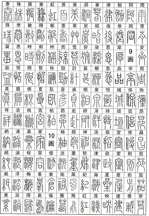

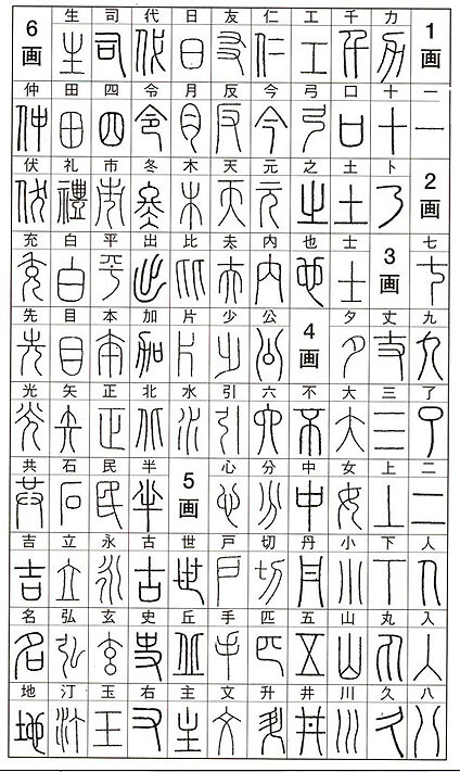

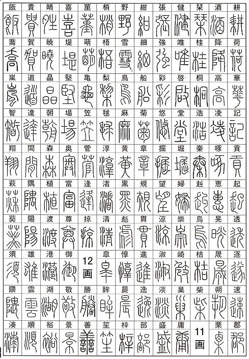

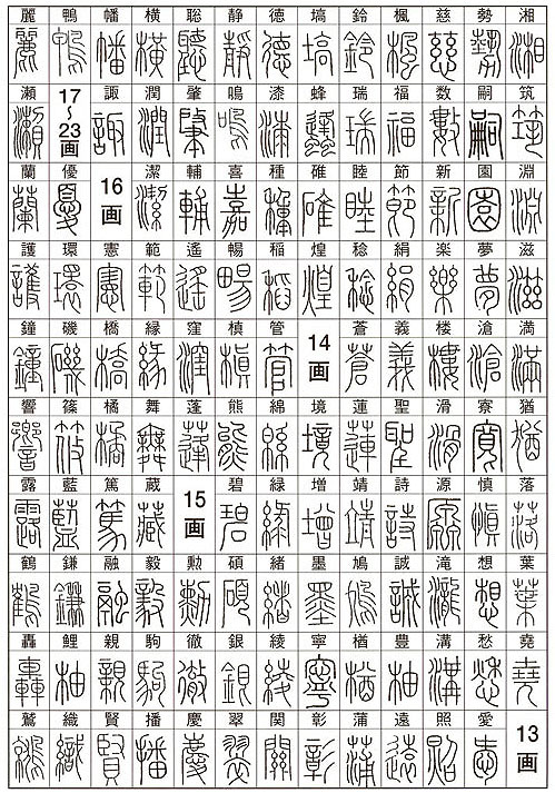

Brian Posted October 13, 2015 Report Posted October 13, 2015 I hope I am not breaking copyright if I post them here for future reference or if someone is looking for Tensho info. Looks like they were scanned from a book anyways? Good find Steve. Quote
Bugyotsuji Posted October 13, 2015 Report Posted October 13, 2015 Excellent. Many thanks. Can someone change the title of this thread, please, as Sanskrit is a very different question and no-one will ever find these charts otherwise?! Quote
Guido Posted October 13, 2015 Report Posted October 13, 2015 I have a feeling that you can ‘crack’ this one for me Sorry, but I have to throw in the towel. I think Steve is right, some of the inlay is missing, not only the one that's obvious. Furthermore, it seems to be a mixture of tenshotai and maybe kointai, since the character 音 is written that way, and not in "formal" tenshotai (see attachment). Quote

Guido Posted October 13, 2015 Report Posted October 13, 2015 Oh, I forgot to point out that the charts of the link / posted here only show the most common characters used for names, and are therefore far from complete; Markus' book lists 4,000 characters in tensho. Quote

Mark S. Posted October 13, 2015 Report Posted October 13, 2015 Sorry... I dislike trying to post from a phone, but I'll try even though we are going to have to play a bit of 'Battleship' to reference the proper info... Only have one symbol so far, on the front of the tsuba just below the kozuka hitsu-ana, I think it can be found on the fourth chart of Brian's post, 9th row down, 5th column over. Looks like the kanji for "Wa" or Harmony? Mark S. Quote
SteveM Posted October 13, 2015 Report Posted October 13, 2015 Guido beat you to it, about three days ago. (咊 is a variant of 和) Quote
kissakai Posted October 14, 2015 Author Report Posted October 14, 2015 May have to accept defeat on this one especially if it is a mix of styles 咊 = Harmony, peace - looks a good shout to me耒 - come, plough - closest I can get to front of tsuba second image Steve - the image you posted looks dead on for rear of tsuba 1st image but I can't find the kanji or meaning to this character I have tried to use radicals on the Jisho website but again to luck I still can't find any other missing inlay but you never know! With thanks Grev UK Quote
