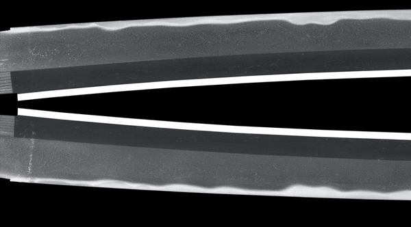

Shugyosha Posted October 9, 2015 Report Posted October 9, 2015 It looks like the nioi guchi falls off the edge of the blade in places. I know this isn't unusual with Muramasa's swords but is it a sufficient negative point for the shinsa team to give it Hozon rather than TH papers? Best, John Quote

Jamie Posted October 10, 2015 Report Posted October 10, 2015 Judge the work, not the paper. Study quality and then you'll know it when you see it. I think this is why it's important to study good swords. They have attributes that lesser swords just don't have. I personally don't see the hamon running off the blade. Close near the hamachi but not bad in comparison to some of his other blades I've seen. Quote

bigjohnshea Posted October 11, 2015 Report Posted October 11, 2015 On 10/10/2015 at 11:17 PM, Jamie said: I personally don't see the hamon running off the blade. Close near the hamachi but not bad in comparison to some of his other blades I've seen. Here's a few images of it. The hamon does not completely vanish, but the last polish likely took away its full character at this one spot near the hamachi. Quote
