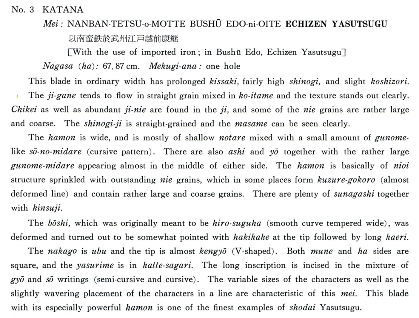

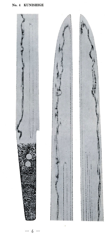

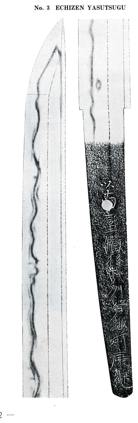

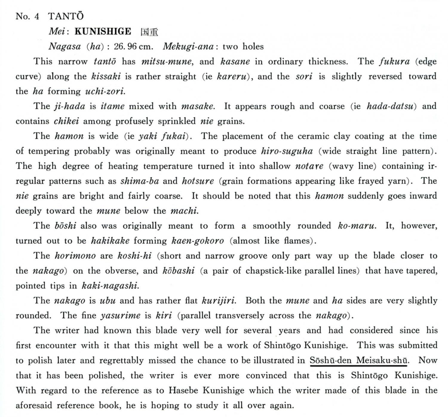

Hi Guys, It’s been a bit slow so I thought I would ask a question  :)  I was reading some old copy’s of Token Bijutsu the other day and thought it interesting that they could tell that a sword was different from what was intended. So how do you conclude that the original suguha has changed ? on the Kunishige is it  because of the shima-ba and hotsure or because the hamon suddenly goes inward at the machi ? when I looked at the few shintogo kunishige I could find on the web it did not help much. I see that Hasebe Kuninobu http://www.nihonto.com/11.6.14.htmlalso has  a shallow notare, and hotsure  Fred states the Hasebe School, generally tempered a hamon that is essentially ko-notare. So one more, Echizen Yasutsugu Katana this time it’s the boshi. http://nihonto.com/abtartyasutsugu.html Thoughts :)

In the first example you give the suggestion is that the smith intended to form one  hamon but misjudged the temperature which caused a different hamon to form.  The second example seems to be similar in that it suggests the boshi turned out to be other than intended.  Is this what you are driving at?  If so then the commentators are suggesting that there has been some misjudgment on the part of the smith during yakiire.
If you are asking how they could come to this conclusion then I suppose it is because the hamon is unusual both for the smith and perhaps not a form that suggest conscious control on the part of the smith.

Hi Paul/Geraint,  :)  I was asking  how did they come to the conclusion that the hamon was not what was intended when the Yakiire was done. If you look at the work of  kunishige most of the features are common in his work. I thought maybe it was because the hamon suddenly goes inward at the machi and that’s how they can tell it was meant to be suguha and with Yasutsugu the boshi is close to the one in the link so I am trying to understand what they are seeing that make them think it is not right. I think most of us would not pick them as all that different and just a variation from their normal work. If they were mumei probably most would just use Den in the description and not pick up on the change ?  it's amazing the level of skill of the commentator .

Hi Paul,  :)  I was trying understand his reasoning. The only thing I could see that was not on other examples was the big dip at the machi but again he could have done it deliberately so you are back to what is individual interpretation. So I am in agreement (I think I would question anyone’s ability to determine whether some slight variation was meant to be there or an accident.) when I first looked at this I thought that you can see what he is seeing if you break it down but again  as happens a lot in Nihonto its subject to interpretation . I also follow the ongoing debates as to whether Utsuri is deliberate or accidental or whether mune-yaki was intentional or just the result of clay falling off, I always thought if you make something with a set formula and you know the result it is intentional. I was speaking with a friend last week about a  hitasura blade and I was looking at  mune-yaki (as I could not see it on the blade) as one of the things to try and work out age. Papers had thought shinshinto, I thought rightly or wrongly that the shinshinto hitasura examples  did seem to have a more controlled feel and hataraki was profuse eg. sunagashi, so I sided with shinshinto not koto as the look of the blade suggested and most of my friends thought, so again I would have to side with intentional as  I look at how  temperature is a big decider of what you get (control is critical)
