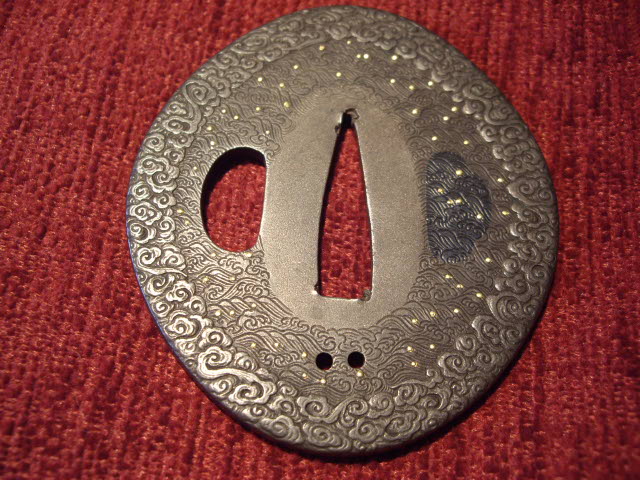

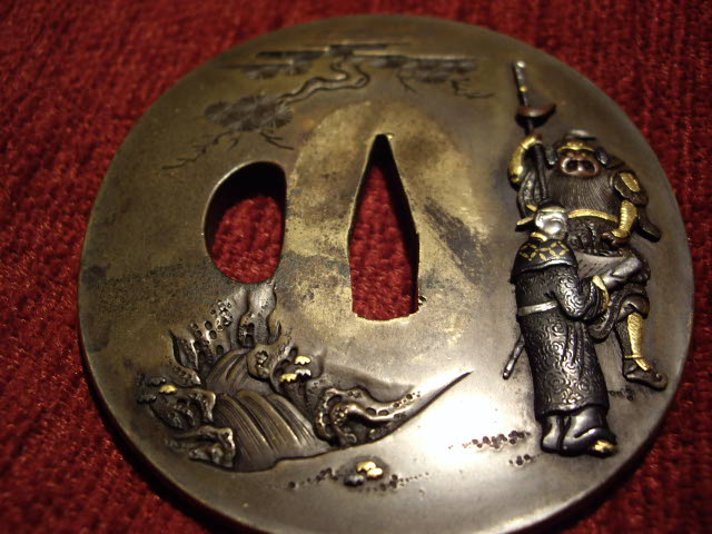

I have three shibuichi tsuba and they are all very dark, see pictures. One of the tsuba must have been mounted as it shows more of the original colour on the seppa-dai. I like them as they are but I'm not sure whether or not they may look better restored to their original colour. I'll have to spend some time considering whether this is something I should look into having done.
