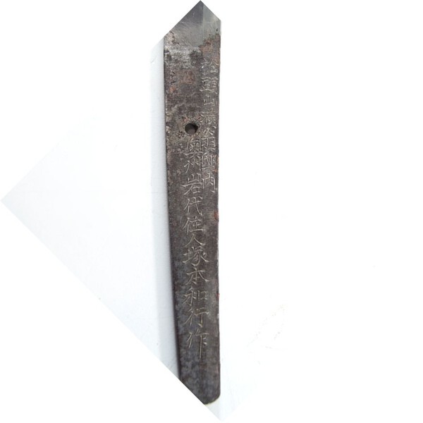

cisco-san Posted August 18, 2015 Report Posted August 18, 2015 Hello,I found this interesting blade and I tried to translate the Mei - but it´s struggling me.My reading is X X X X jūnin (住人) X X Kazu/Masa (和) Yuki/Kō/Tsura (行) saku (作). I am also not able to read the very right part.... The blade is dated August 1938 (Showa 13).I found one Kazuyuki, but I am almost sure that this is not the right one and I think it is also not Masatsura (these smiths are signing with different Kanji).from Markus´s book:KAZUYUKI (一行), Shōwa (昭和, 1926-1989), Aichi – “Kazuyuki” (一行), family name Suzuki (鈴木), rikugun-jumei-tōshōMASATSURA (正貫), Meiji (明治, 1868-1912), Mikawa – “Masatsura” (正貫), younger brother of Hayama Enshin (羽山円真)MASATSURA (正貫), Shōwa (昭和, 1926-1989), Aichi – “Masatsura” (正貫), family name Shōda (荘田), he worked as guntō smith, ryōkō no retsu (Akihide)The seller said that he think that the Kissaki seems repaired because it is not sharp - but I don´t think so... Any help would be highly appreciated.Many thanks in advanceKlaus 1 Quote
Peter Bleed Posted August 18, 2015 Report Posted August 18, 2015 Klaus, You have a neat sword, I am away from my library, but It looks to me like it was made by a smith names Tsukamoto AKIYUKI. who lived inIwashiro, and it has sexy 1938 date. I do not recall this name from the Sendai meikan - I'll check, but it probablyis a s amith from over in whatis now Yamagata-ken. This looks like a nice gendai-to Peter Quote
Markus Posted August 18, 2015 Report Posted August 18, 2015 Hi Klaus, The mei reads "Oshû Iwashiro-jûnin Tsukamoto Kazuyuki saku" (奥州岩代住人塚本和行作) and the left part "Tôyama Mitsuru'ô no teinai ni oite" (於頭山満翁邸内, "made on the grounds of Tôyama Mitsuru"). It is this Tôyama Mitsuru: https://en.wikipedia.org/wiki/T%C5%8Dyama_Mitsuru "Kazuyuki" was a name Tsukamoto Okimasa had used for a while. I have to add that info to my Gendai project. 2 Quote

cisco-san Posted August 19, 2015 Author Report Posted August 19, 2015 Der all, many thanks for the great help. @ Markus: from where you have the information that Okimasa signed with Kazuyuki (or Akiyuki) too. I have checked all my books, files... but found no such information. By the way, the knowledge and the willing to help on this board is really incredible. Again many thanks Klaus Quote
cisco-san Posted August 19, 2015 Author Report Posted August 19, 2015 ......and additionaly I have to check if the Mei is Gimei or if it is genuine. Any hint would be great too. Many thanks. Klaus Quote
Markus Posted August 20, 2015 Report Posted August 20, 2015 Hi Klaus, The info comes from the catalog to a 2010 Ise Shrine exhibition that is titled: Gendaito no 100-nen: Fukkô to Keishû - Chôkokan Kaikan 100-shûnen Kinenten: Zuroku (100 Years of Gendaitô: Renaissance and Succession - Commemoration Exhibition to the 100th Anniversary of the Opening of the Chôkokan) 現代刀の100年 復興と継承 徴古館開館100周年記念展 図録 Don't have a copy though but found a reference to Okimasa's earlier name online. Also that he signed with Kazunori (和則) for a while. As for the authenticity, well, my gut feeling tells me that this might be the real thing. Don't know if it would make sense to forge such a rare signature variant of Okimasa (and not a Okimasa mei right away). But you never know these days... Quote
