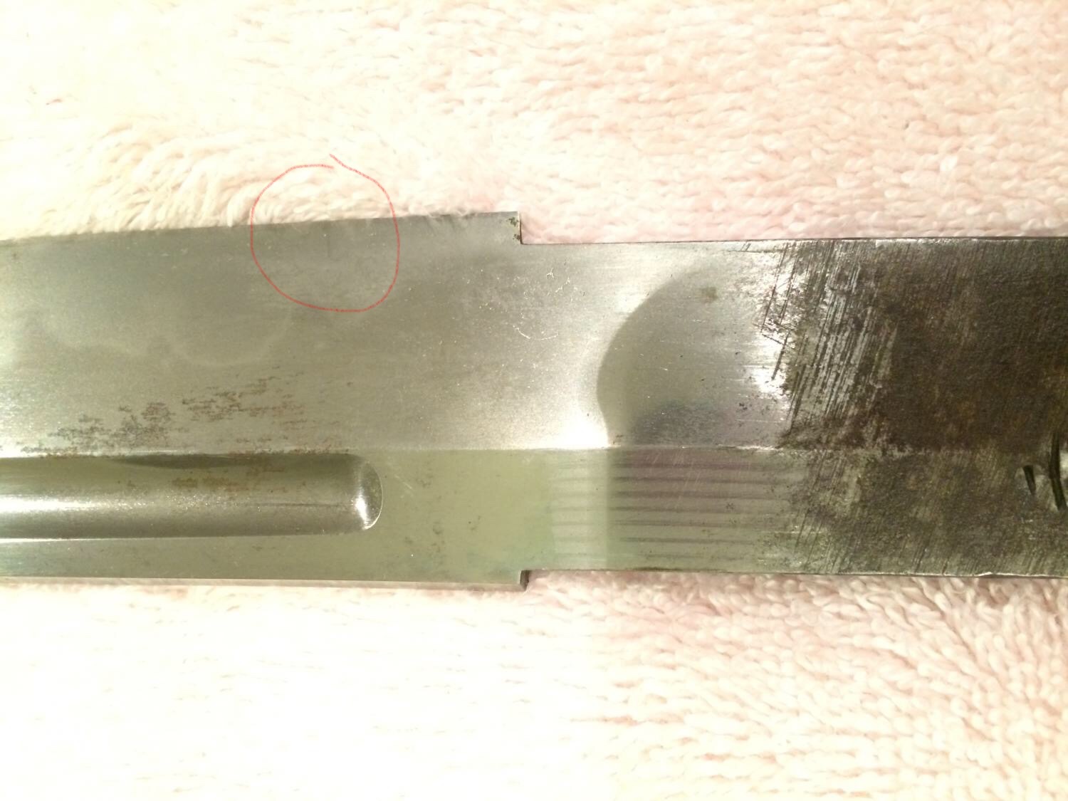

Ian B3HR2UH Posted August 21, 2015 Report Posted August 21, 2015 In the fourth photo in the second set of photographs there is a worrying mark about an inch up from the machi . Is this a problem ? Ian Brooks Quote
Ryan Posted August 21, 2015 Author Report Posted August 21, 2015 On 8/21/2015 at 8:12 AM, Ian B3HR2UH said: In the fourth photo in the second set of photographs there is a worrying mark about an inch up from the machi . Is this a problem ? Ian Brooks This spot? It doesn't seem to be a depression of any kind only a mark on the surface. Quote
pcfarrar Posted August 21, 2015 Report Posted August 21, 2015 It looks like a Hagire so you want to check this spot out carefully. Hopefully it's not. Quote
Ryan Posted August 21, 2015 Author Report Posted August 21, 2015 On 8/21/2015 at 3:57 PM, pcfarrar said: It looks like a Hagire so you want to check this spot out carefully. Hopefully it's not. not seeing anything like that. Must have been a dog hair lol. Quote
bmoore1322 Posted August 22, 2015 Report Posted August 22, 2015 What a beautiful blade.. I love the O-Kissaki 1 Quote
Stephen Posted August 22, 2015 Report Posted August 22, 2015 Pix in question of hagire would be under habaki Quote

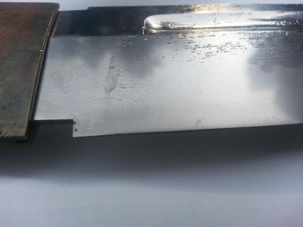

Ryan Posted August 22, 2015 Author Report Posted August 22, 2015 On 8/22/2015 at 5:22 PM, Stephen said: Pix in question of hagire would be under habaki It was an inch or so up from the habaki if I'm not mistaken, I added a couple photos of that exact spot and checked it carefully. Fairly certain it was a dog or cat hair. Quote

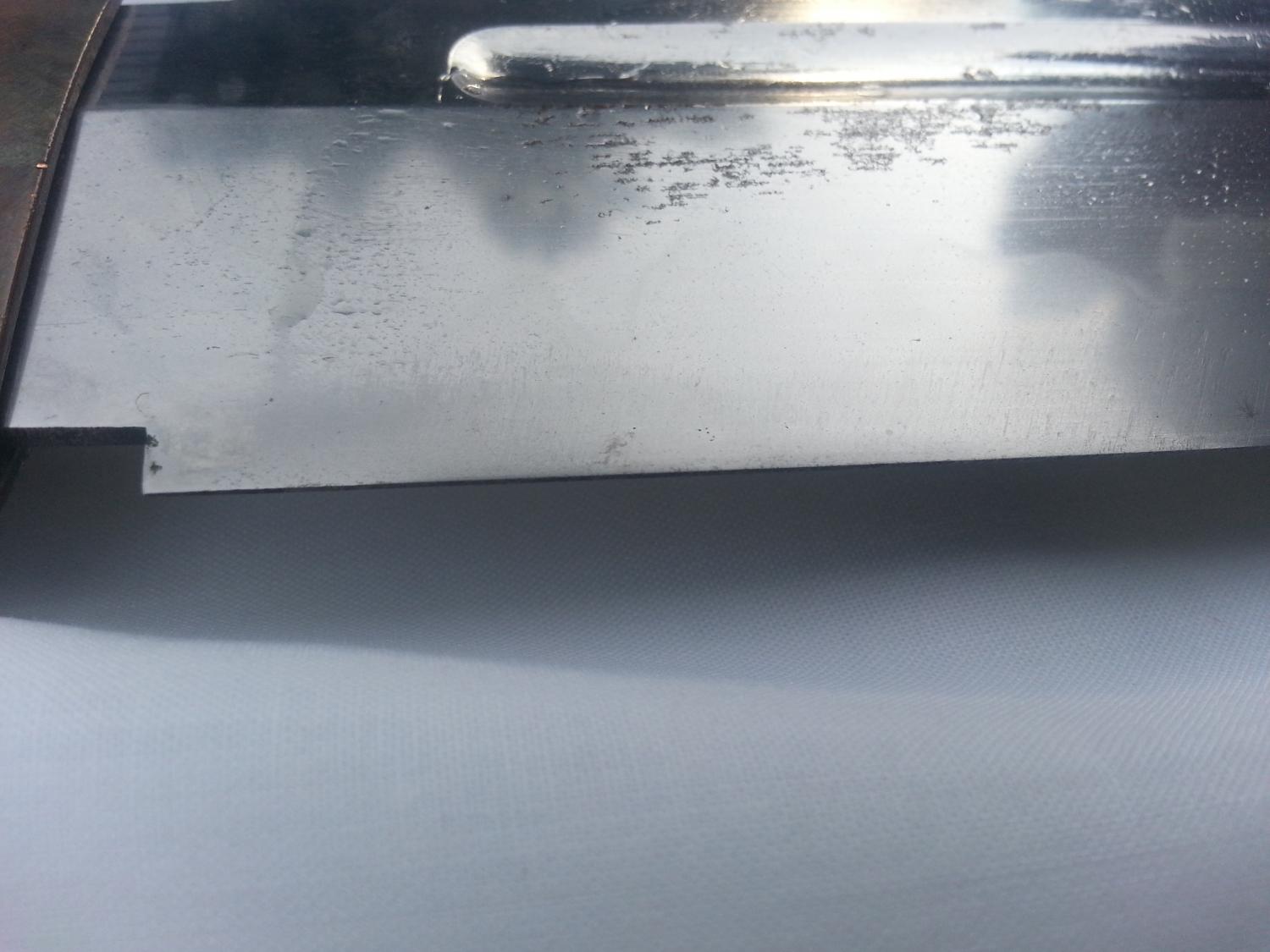

Jean Posted August 24, 2015 Report Posted August 24, 2015 Ryan, In the picture outlined by Peter, it does not looks like a dog hair. The pictures you have posted just above to show this area are uselees because the interesting part is in the dark. Could you post two high rez pictures of this area (ura/omote) well lighted? Quote
Ryan Posted August 24, 2015 Author Report Posted August 24, 2015 On 8/24/2015 at 2:16 PM, Jean said: Ryan, In the picture outlined by Peter, it does not looks like a dog hair. The pictures you have posted just above to show this area are uselees because the interesting part is in the dark. Could you post two high rez pictures of this area (ura/omote) well lighted? Here you go. Quote
