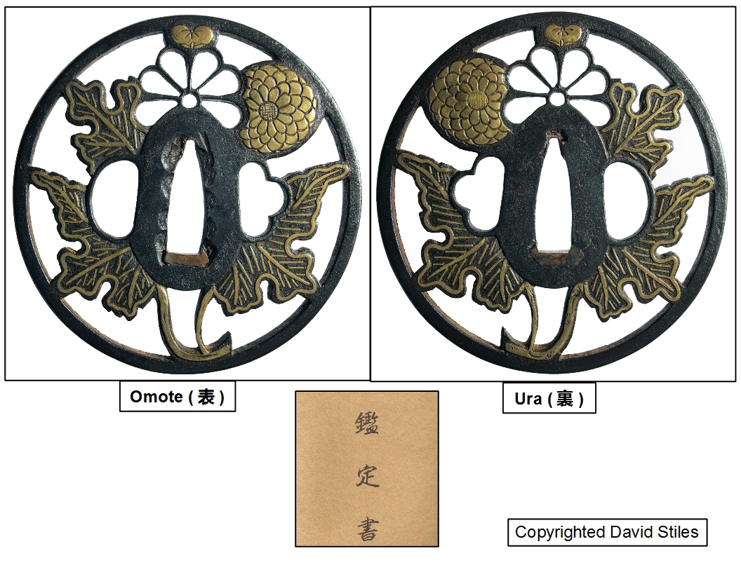

Soshin Posted September 14, 2023 Report Posted September 14, 2023 The term "den" (see kanji above in my post from 2015) means "in the tradition or style of". This means the tsuba in this context shows most of the important kantei characteristics of the stated school or group but then shows some additional characteristics that are either not often seen or not often associated at all with that specific school or group. I will share a NBTHK Hozon papered tsuba with the attribution "Den Hoan" for reference and educational purposes only. The iron and openwork design were excellent on this fine tsuba. 1 Quote
ROKUJURO Posted September 14, 2023 Author Report Posted September 14, 2023 Thank you David, for sharing this picture of your very nice TSUBA! 2 Quote
