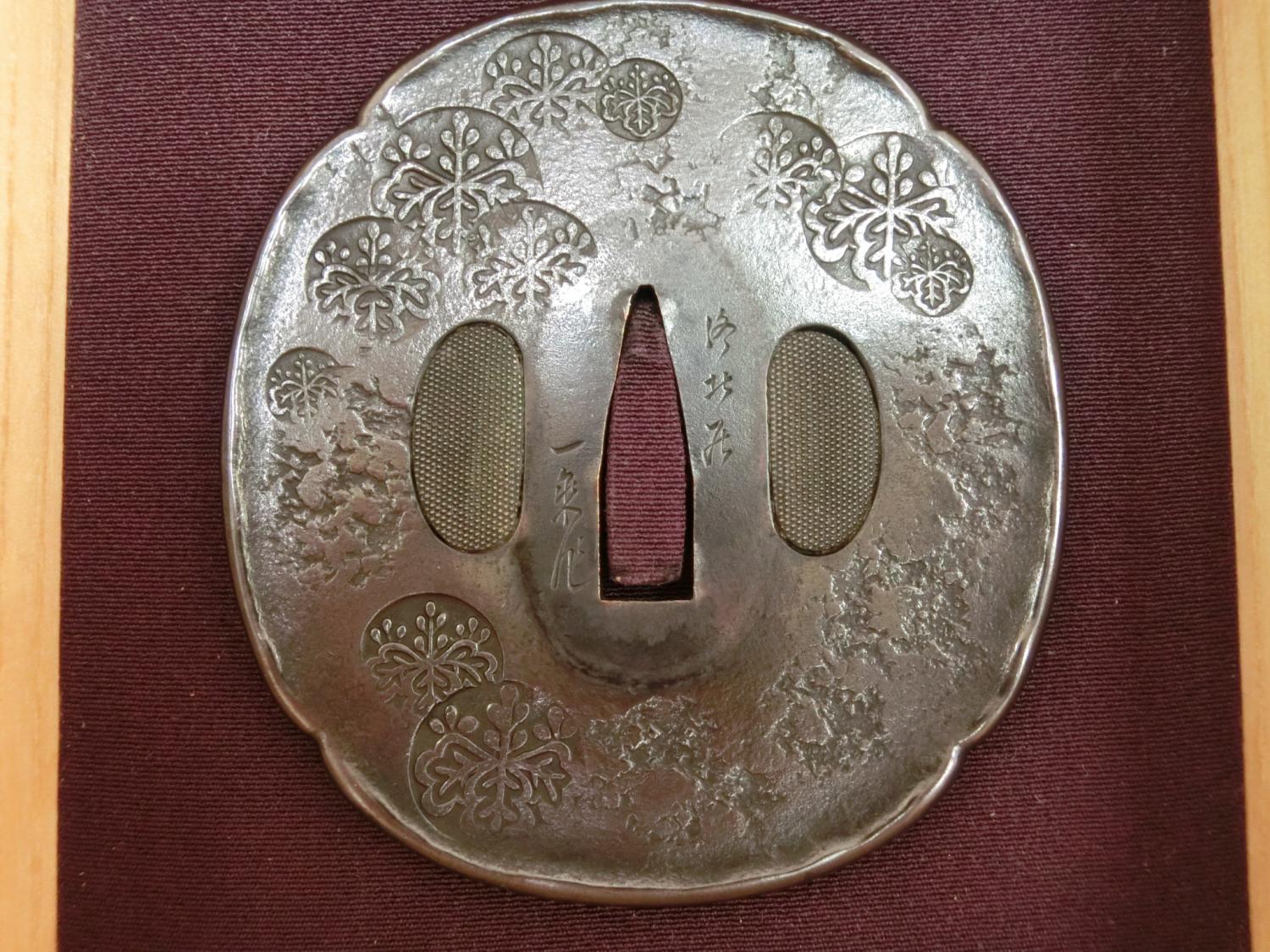

Was offered this tsuba by (?) Goto Ichijo. The seller is asking for quite a bit. Would appreciate your expert opinion if it looks genuine for you?
I readily bow to the expertise of those NMB members much more knowledgeable than I, but love your tsuba. My only question would be the brightness of the plate, and wonder about its patination; or is this just the excessive light reflection in your photograph?
John L.
Thank you, John,
It's not mine yet. The seller says it is of copper mixed with a quarter of silver and gold. 7,6 x 7,1 x 0,4 cm
Still not sure by the photos if it is genuine and can be attributed to Goto Ichijo. The price is genuine for sure!
Any thoughts?
Timur; my thought is that the alloy the tsuba is made of is called Shibuichi. More than that, I don't know much, except to say that I like it too, though my degree of liking might be influenced by the price.
[edit to add another thought: There appears to be some wear to the surface patina, evident at lower left of your pic where the reddish copper colour is showing through. and this leads again to the thought of the price, but maybe it's just an artifact of the lighting]
This is my mantra:  BIG name + BIG price - but - no modern NBTHK paper = no sale.  If it was genuine, the seller would have had it papered as proof of legitimacy.   As it is not papered, the seller has no back up on the mei.  Tough words I know but they may very well save you a bundle, especially since you have admitted you have little experience.
PS:  for what it's worth to me it doesn't look like anything close to Ichijo's craftsmanship and I don't want to hear about 'school work' either.  That's all rubbish.

At the moment there is an info that there are some papers from the previous owner stating that he bought it on Ginza Street at a specialty shop for 1.500.000 yen in 1991. Which was approximately $11.500 those days by the way.
I am pretty sure this is a copy in silver - the original was Shakudo
Look closely at the "plugs" - are they part of the piece or different metal inserted?
 a nice paperweight but not at that price...
mho
-t
mho
-t
Thank you, Toryu, the "plugs" are different metal inserted. Will keep updated as soon as will get the reply from the seller.

Nice one Barrie, I was (unsuccessfully) looking for that very reference when this thread was started. All comments about papering aside, the workmanship on the piece in question just isn't what one should expect from Goto Ichijo. I'd steer clear of this one.

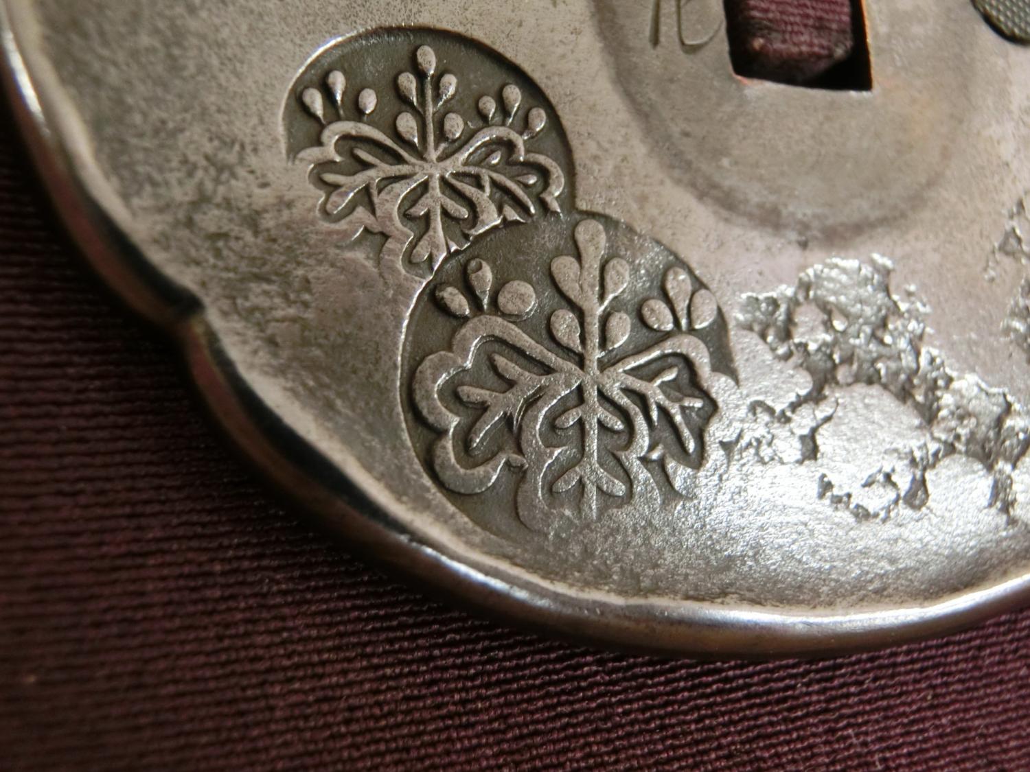

Here is an example of an Goto Ichijo from the Tsuba Shusei -Nakamura 1963 with the exact same mon stamp used on the piece in question. I think the craftsmanship actually is spot on for other papered and signed pieces in this particular style of his work.
I'm not sure what else you could ask for from a piece in this style. The patina on the shibuichi is worn thin but this could be repaired with little trouble.
The rest of the page from the same book to show some other examples he did in this style.
Here also is a link to another example without a signature that has been papered. The shape and design is almost identical other than the ground materials and stamps used. Scroll down to see example.
http://www.choshuya.co.jp/1/0805/member_frame_fittings.htm
Sometimes I think you must judge a work not on the papers, but the merits and evidence presented by the piece.
I have a feeling that many really great bargains are missed out on because of this way thinking.
Could be a bargain considering what some of his other works go for and to my eye the signature is direct and very convincing.

Lacking both the confidence and the necessary finance, I am reluctant to put my wallet where my mouth is.  But I remain convinced that Valery's tsuba, inscribed RAKU HOKUKYO ICHIJO with Hōgen (汪眼) kao (tn: residing in northern Kyōto), is a later, shoshin work of the master.

Finally got the piece. Well it is definitely shakudo, neither shibuichi nor casting. Just usual trick of shooting shakudo pieces. Personally I believe in it and probably need to give it for shinsa, never did it. Need i?
I think its a pretty good way to find out. Compared to the price, the papering/shipping etc. costs won't be that high.
