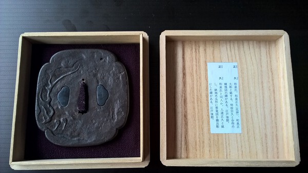

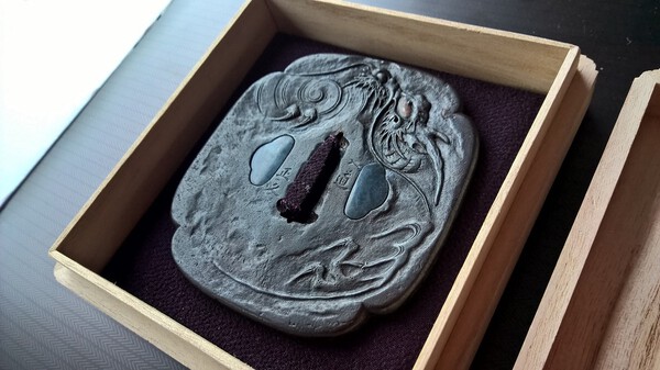

Been trying to identify this tsuba, but the world of tosogu is quite uncommon to me. Tried to translate the mei and the papers and came up with 入道正久 - Nyudô Masahisa. I could just and just understand the dimensions mentioned in the papers, but the "comments" section remained completely mysterious. I tried also to figure the school to which it belongs and my uncertain guess is choshu.

A quick Jeff Duke (look) seems to reveal that the comments explicitly state the physical characteristics and appearance of the tsuba. I am sure someone with plenty of time on their hands will be more helpful. In the meantime, why not have a blast (go) at deciphering the big scary kanji on an electronic dictionary. The information is embedded in the scariness.
This organisation would paper just about everything, so I wouldn't bother reading what they have to say. You have a nice, signed tsuba. Time to hit the books and other avaliable resources to see if the mei is legit.
This tsuba is inscribed NYUDO SHOKYU (H 04024.0).  Izumi Masahisa is described by Haynes as working ca 1800, and he describes one iron tsuba by this artist, listed as #51 on p.113 of the Red Cross catalogue, and illustrated, not on pl.CII as described, but on pl.CIII.  This artist is not included in Kinkō Meikan, and I do not possess Wakayama’s book to check Haynes' reference (W-344-L-2) for the mei.  Sorry!
