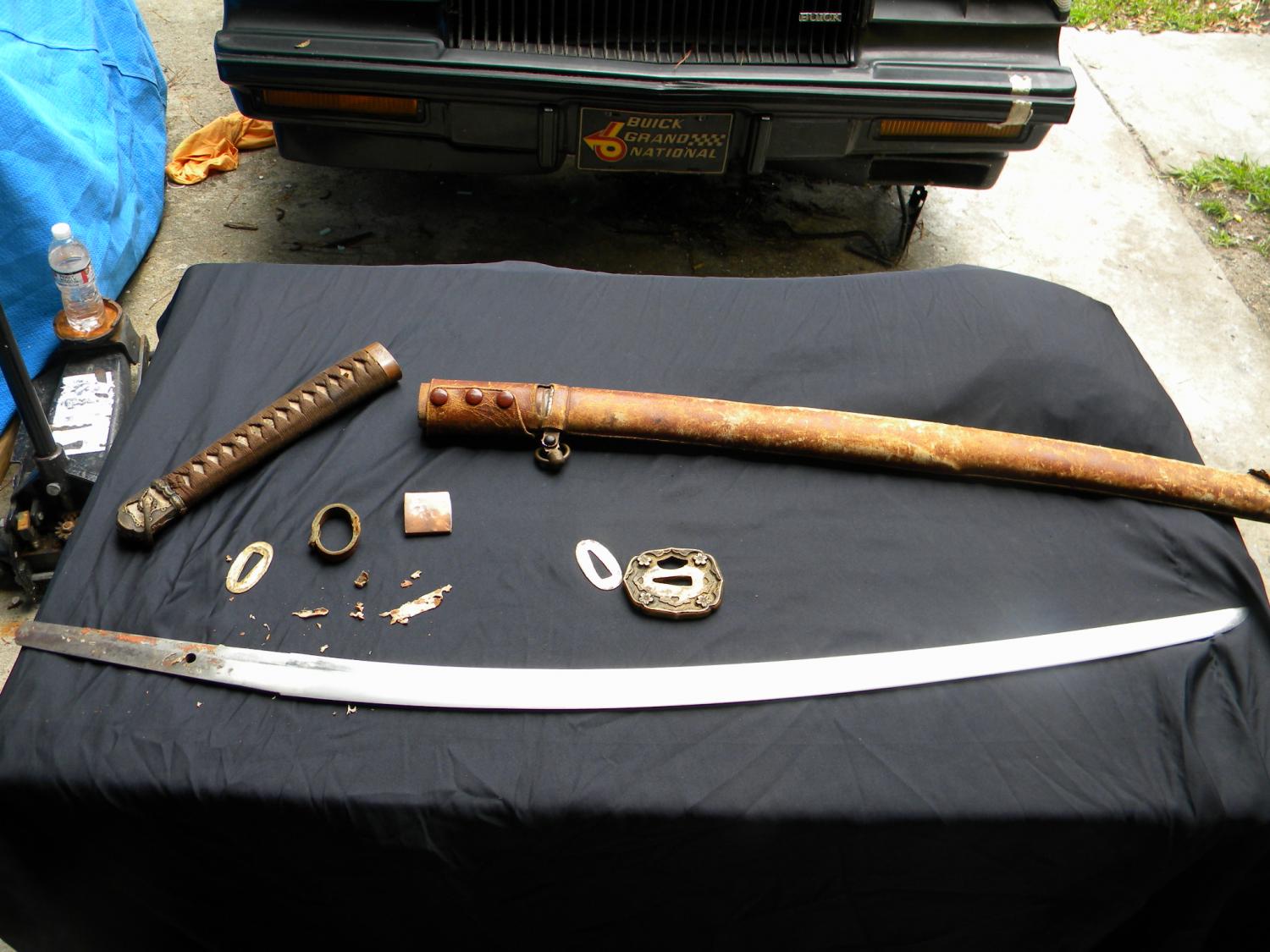

Gents,   Relatives are off deck,  and this morning got the wife's van running right again.  So I had some time to work on "Masterpiece Theather"

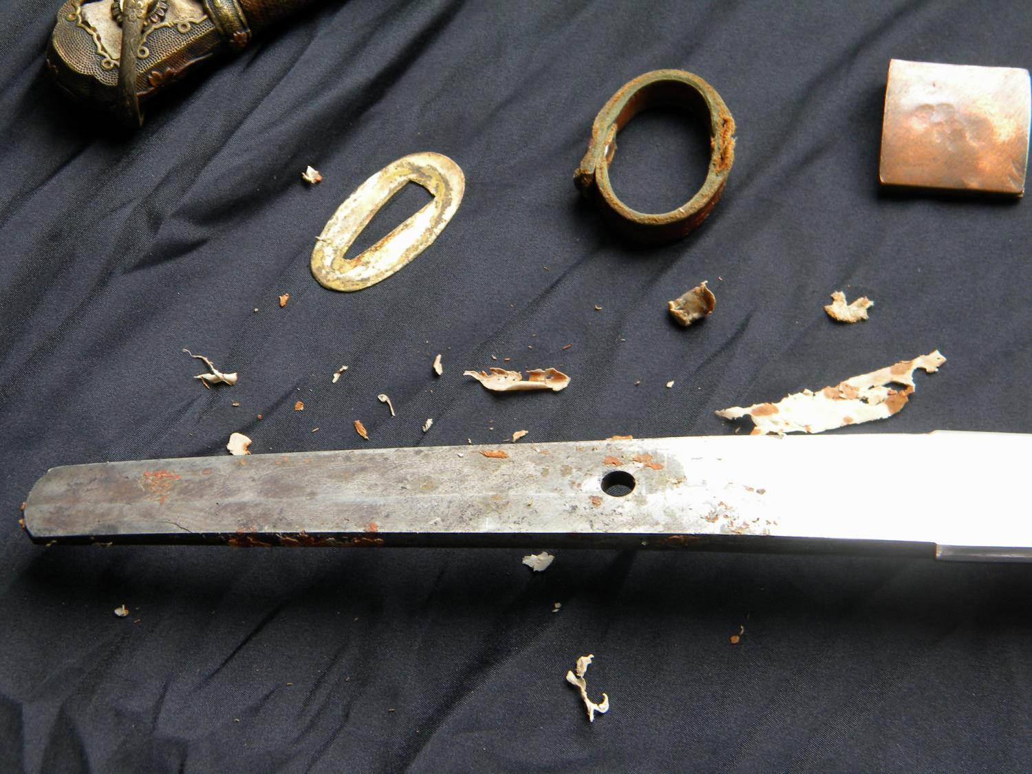

    I took the sword out and grabbed a few more pictures to for everybody to study and make a final rendering.   Nakago is unsigned and has shallow filing.   You can see some of the hada still in the nakago.  Color looks like Navy rust resistant steel almost.   Whomever made this is/was very skillful,  as you can see there is a little hazuya stone hamon but no nie/nioi.    The handle was held on by some sort of modern adhesive.
   I have 4 leather gunto's to compare to, and comparing fittings they are very good.    I would say the seppa's seem thin,  the cutout on the tsuba for the leather strap is a little off, but nothing sceams Chinese.     The folks at the auction company are good people and didn't have any idea.   I'll talk to them soon and hopefully work something out.

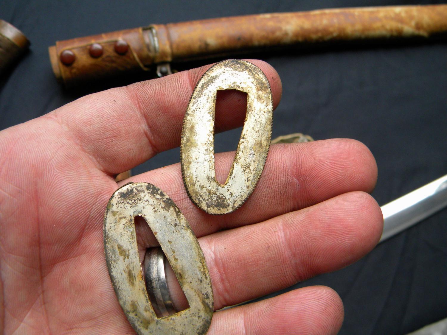

Much better pictures of the fittings. I might revise earlier judgements, now the tsuba is in better light. The contrast is not as dramatic as I thought between patina and polished. They look pretty legitimate to me. That's good news.
New pics of tang look less suspect than before, I'm going to climb back out on my limb and say mumei Gendaito. Very similar to Amahide I had, and the Kanenaga posted earlier,  possibly made in one of the many wartime Seki sword factories?.
Mounts look to be ok, thin seppa aren't that uncommon, especially on gunto in  leather covered saya "field mounts"

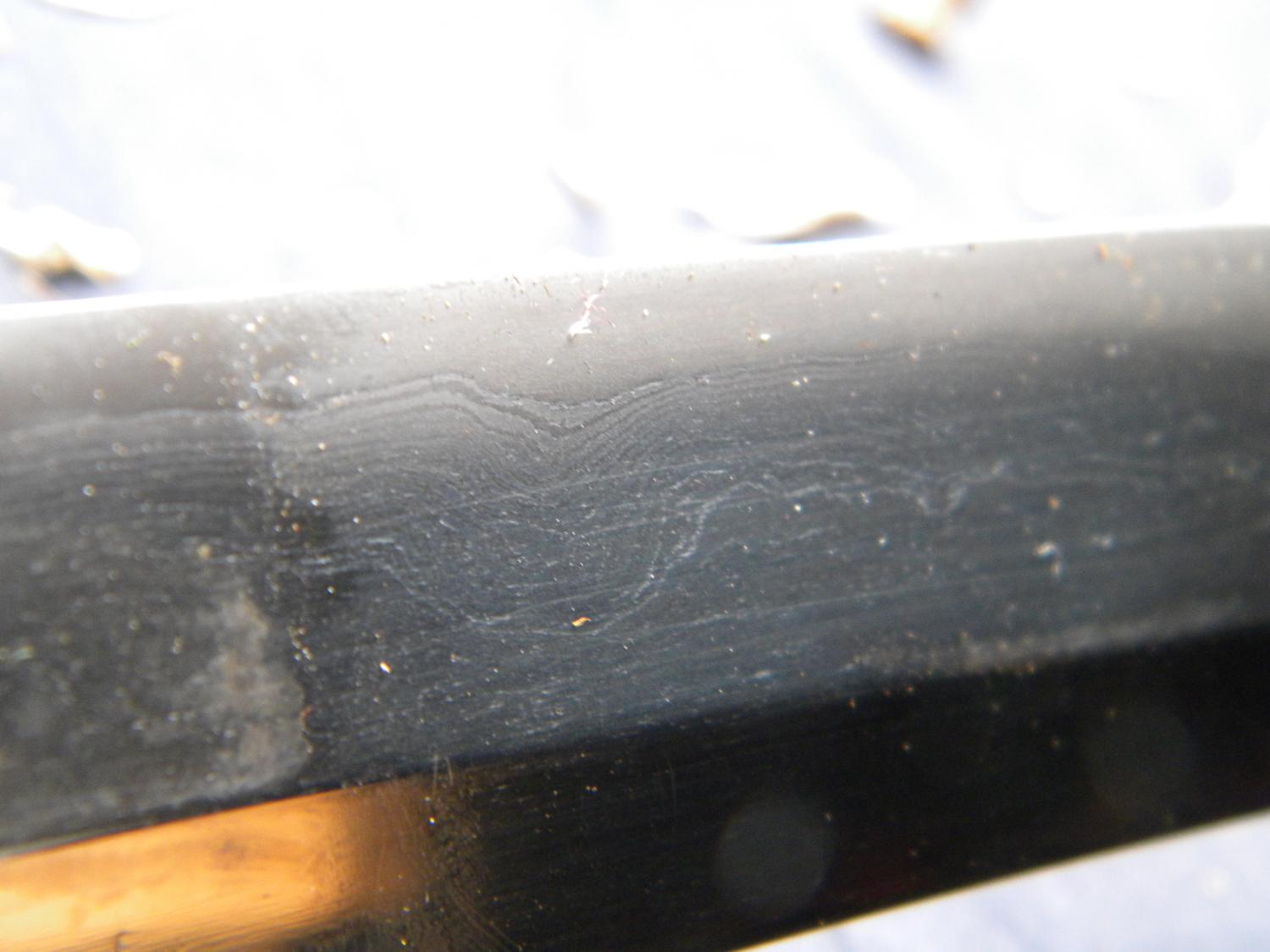

While I think it is prudent to be cautious passing judgment on photos I am very much inclined to believe that this is most likely a fairly decent attempt at a re-worked chinese damasc blade that have been bouncing around the market place since the late 80's early 90's. These blades are very low carbon (.2) and not able to hold a true edge. We tried on a number of occasions to "re-work" the steel but always concluded that they must be mild steel, ie not possible for yakiba.I will add to this point below
Before going on I will just piont out that Instead of repeating what I previously stated I will just say that I stand by my previous comments and will add a few more points.
The nakago - looks to have been done on a belt sander and not yasuri with the exception of the munemachi.
Sugata- I have a couple that have a Bizen Koto Tachi appearance including amost bizen shaped Nakago. . . but still just folded mild steel made in china. Anyone that has some artistic skill and has experience in bladesmithing could clean one ie; Clean up the nakago and add yasuri to all sides (omote and ura can be reasonably done on a belt sander if one has the experience) These blades usually have a true yokote. . nothing to do there.
Hada. Typical alternating/laminated steel of varying carbon content (still too mild to for yakiba and definately no noiguchi) And I guess the big give stand out point is that these blades are often Sanmai in construction using mono steel as the edge to give the impression of a Hamon. This blade looks to have just this type of construction with what appears to be a slight (miniscule) seperation between the inserted edge and the body of the blade.
As for the Koshirae this definately appears to have been a mix of legit pieces added to a fake blade. . .rest is covered in previous posts.
Finally from a personal view I would like to add that over the years I have seen a few legitimate blades get the chinese tag due to paranoia of "the insidious chinese scammers" (seems slightly racially prejudice). This fear has allowed a few opportunistic collectors to pick up some amazing gems from china. Including one which I obtained via a very discerning client whom had no qalms honestly stating he had bought it out of china.. . . I later had this blade verified as legit. I have also sold a number of high end blades to China over the years. And to top it off I have also seen chinese and indian fake items being sold out of Japan ( we all know Daimyo54) so really there is no Black and white rule, just knowledge and prudence.

   Also, here is a another compare of a wild hada Amahide with no desernable nie.
http://www.nihontoantiques.com/archive/fss188.htm
   I do think that this is so close to Lance's examples on page 1, other Amahide shop makes online,  and the Clive Sinclaire's Amahide koshirae article about wraps it up.   Plus as first mentioned the quality of the blade is too impressive in hand.
