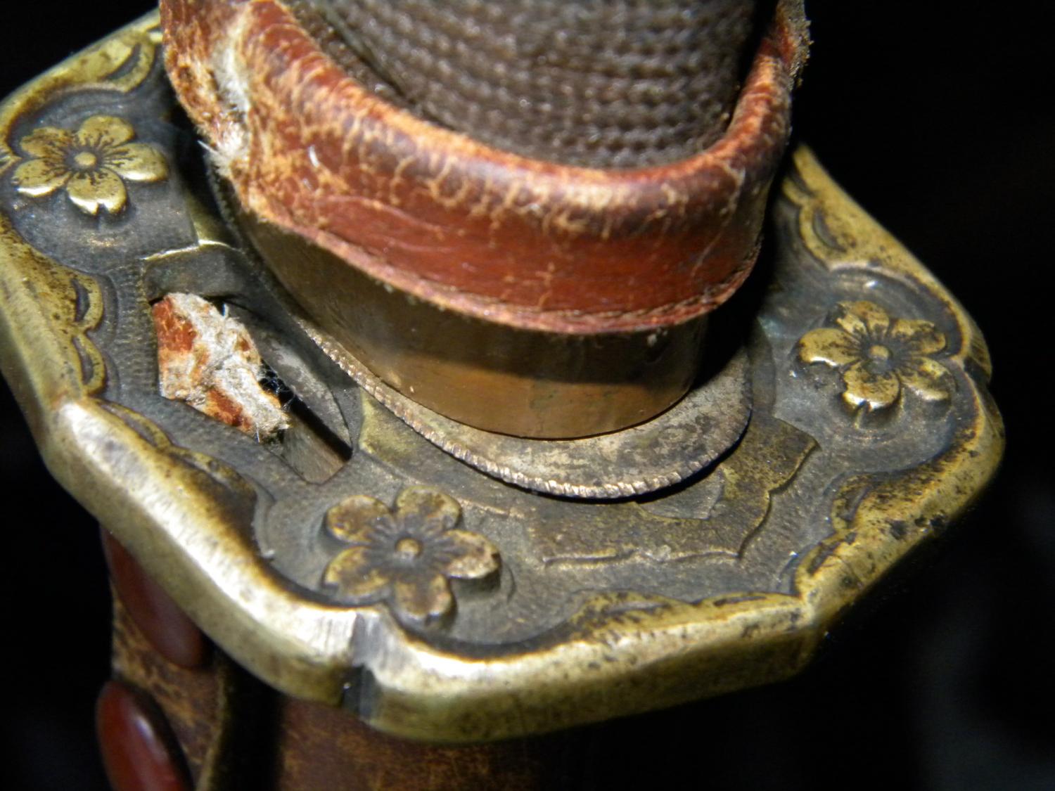

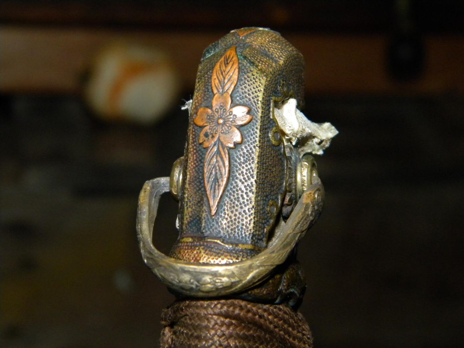

Kam A Posted June 24, 2015 Report Posted June 24, 2015 Hi All I could just be looking at bad pics that are not truly representative of the actual item but honestly think this is a chinese repo "dolled up" to look the part (I have seen these blades get fake Hadori and burnished shinogiji) So before we get to the blade just looking at the tsuka. . .it is a typical "sausage" often seen on amature attempts and the multitude of chinese reapos seen on ebay. From what I can see in the pic the habaki is definately questionable in size and shape. As for the steel. . . looks like the mild steel/low carbon style blades found on chinese repos. Typicallly slightly etched (I see actual texture from each layer) I see no Noiguchi nor an indication of where the yakiba is. I am a bit of a fan of Ikkansai yoshihiro and this is not representative of his jigane nor of Amahide. I have attached a pic of a Ikkansai yoshihiro as well as probably the most extreme Hada you would ever find on a Nihonto from Gassan Sadakazu. Just some thoughts and I could very well be wrong. Kam Ikkansai yoshihiro Sadakazu Quote

tokashikibob Posted June 24, 2015 Author Report Posted June 24, 2015 The handle is probably glued on as it is almost imposssible to get off. Fittings are excellent gunto, hard to belive they are copies, it they are then they have the ageing process down pat. What a let down, let me see what the chances of a return are. Quote
Ray Singer Posted June 24, 2015 Report Posted June 24, 2015 Would you share additional photos of the tsuka and tsuba? Thanks, Ray Quote
tokashikibob Posted June 24, 2015 Author Report Posted June 24, 2015 On 6/24/2015 at 1:46 PM, raymondsinger said: Would you share additional photos of the tsuka and tsuba? Thanks, Ray Thanks for the interest Ray. The leather is worn at the right spots and even broken where you expect to see it, Leather that is covered by button flap looks better than exposed leather. Tsuka has a wierd rice paper vice same. Looks like there is some paper inside the tsuka that keeps the tsuka wedged on nakago. Quote
Ray Singer Posted June 24, 2015 Report Posted June 24, 2015 I think it's worth trying to remove the handle and examine the nakago. With the issue of being glued in, perhaps another NMB member has thoughts on how to do that without damaging the tsuka. - Ray Quote

SAS Posted June 24, 2015 Report Posted June 24, 2015 PS as far as removing a glued on tsuka, I have (once) used a heat gun very carefully to degrade the glue to remove the tsuka on my Paul Chen Hanwei sword for the purpose of checking the structural integrity of the "nakago", followed by judicious tapping with a mallet against a wooden block on the tsuba. Quote
Kam A Posted June 24, 2015 Report Posted June 24, 2015 Hi I do not think the whole thing chinese, but looks to be a original saya and fittings...ito even looks legit. The shape of the tsuka on the other hand is not promising. The blade I believe is chinese. Just speculation but I would suspect that this was assembled in the west and palmed of as a "my grandad" story. Kam Quote

Lance Posted June 25, 2015 Report Posted June 25, 2015 Hi Kam, Hopefully the tsuka can be removed and the mystery solved one way or the other, maybe some better pics of overall shape of the mounts and the blade under different lighting too.... . I understand the skepticism about the tsuka but for whatever it's worth I've come across so many different grades of gunto tsuka, both in material quality and assembler's skill levels (pre-internet and ebay) at flea markets, small gun shows. or garage sales direct from the famiilies, I'm not trying to tout myself as an "expert" just that I'Ive seen a lot of swords that you could be 99.999% sure were never tinkered with and this fits in with those pretty well. (Now I'll end up being wrong , although for Bob's sake I hope I'm not ) Best regards, Lance Quote
Shamsy Posted June 26, 2015 Report Posted June 26, 2015 It could be the lighting, but the tsuba and other metal fittings look artificially aged. The patina isn't usually so strong (meaning the difference between the "rubbed" or "worn" metal is a sharp contrast to patina of the recessed areas. Maybe too much contrast. It looks to be aged then polished up. Notice how the raised areas are polished, even when there is no logical reason why they would have "rubbed clean" (not near hand etc). However, as always it's very difficult to say with any certainty without hands on inspection. If the fittings are fake, they did a fine job with the details. It's only the patina I'm skeptical about. Cover over saya looks good though. A bit out of focus, so hard to gage how the leather preserved under the buttons looks. Paper in tsuka is fine for later war examples. I've also seen genuine examples with glue on tsuka before. More experienced members have spoken on blade so I'll leave that. Quote

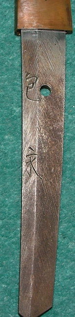

tokashikibob Posted June 26, 2015 Author Report Posted June 26, 2015 Gentlemen, Brian has asked me to return my 100 posts signed and framed Nihonto forum certificate and complemetary coffee mug, which I use daily I might add. Tsuka was attacted with some sort of caulking/glue and nakago shows it's true Chinese birth. Anyway, I after I send my certificates to Brian I might just start collecting stamps as there are lots of old collections at auctions these days. For the new guys I got plenty of Nihonto books including the guidebook , have Sesko's ebooks eating my hard drive space, been to shows and still got a F in class! So, try to by right from the vet family if your a treasure hunter or, from the board. Best Regards, Bob Quote
