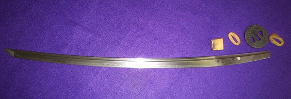

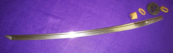

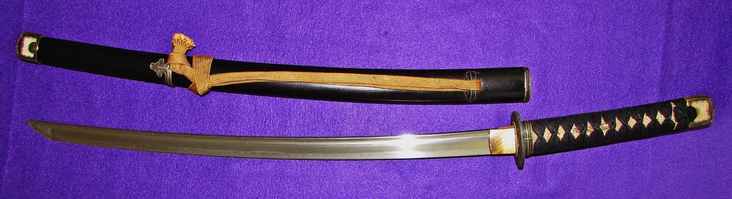

A recent addition, please give your thoughts and opinions on this wakizashi..  The nagasa is 20 3/4", mumei, relatively good polish. with a kakitoshi-hi, or groove which extends all the way through the nakagojiri.  Any thoughts are appreciated.  I am interested to know any opinions, but also  to  what old sword period this sword would originate.   I am thinking possibly Nambochuo rather than Muromachi.
Thanks
Edward G.  :dunno:

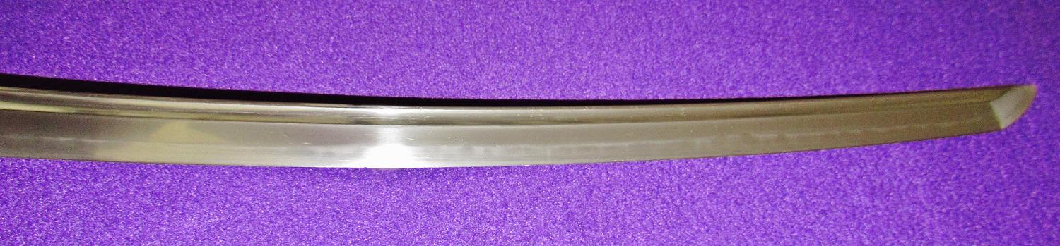

Do you have macro photos of the hamon, hada, and boshi? Your sword looks lovely.
Regards,
Hoanh

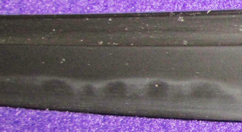

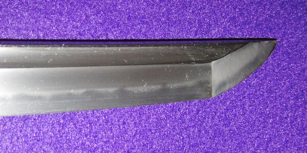

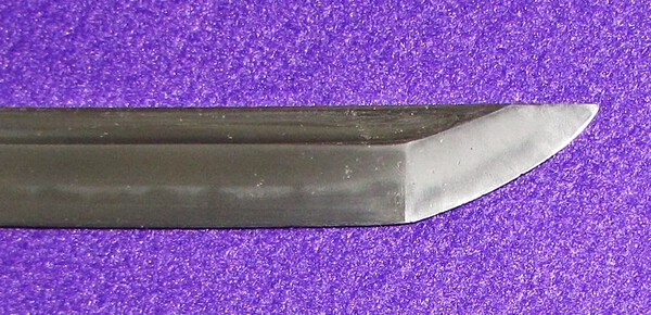

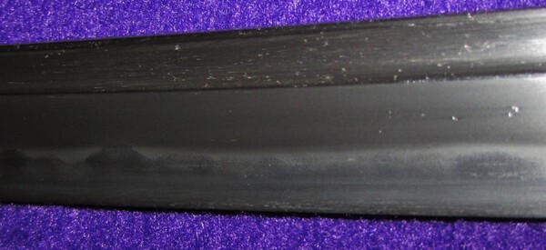

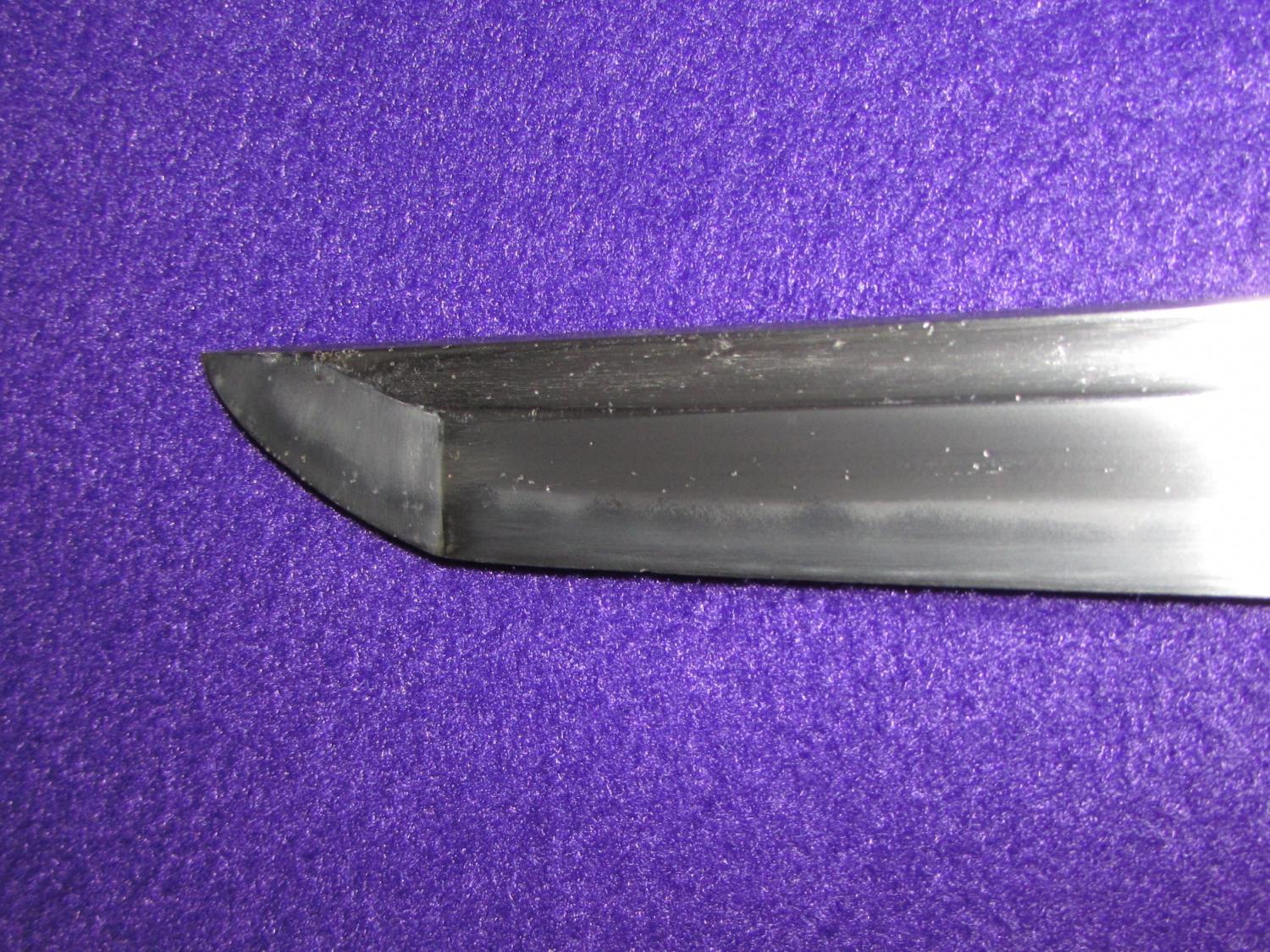

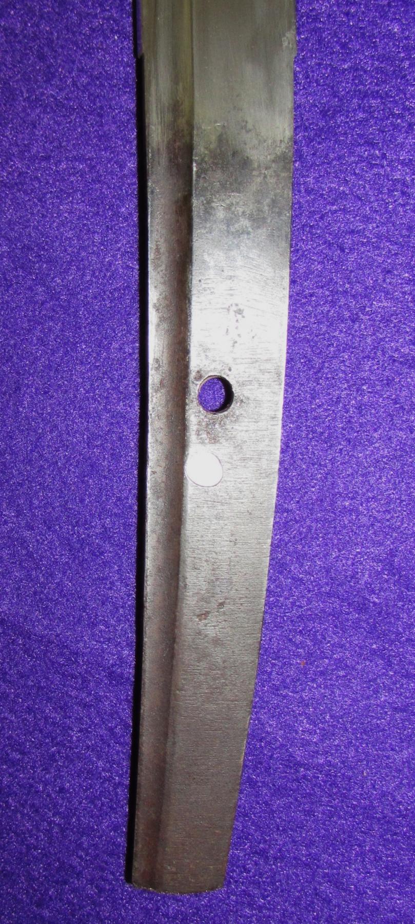

More photos of the sword.  Hope this helps clarify some of it's characteristics.  Cannot see too much hada in the photos unfortunately.
Edward G.
Additional measurements are as follows:
Nakago is  6 1/16"
Width at Ha-Machi is 1 1/8"
Kissaki  is  1 1/4" length
width@ yokote is 3/4"
sori  is 1/2"
Thanks
Edward G
Thanks for the comment Hoanh. Certainly this is a possibility, I plan to Shinsa it next year, but wanted some current opinions on it now. I do not have much experience with kakitoshi-hi on swords, other than almost all I have encountered were dated somewhere in the Koto period.  It is difficult to photograph all the activity in the hamon, however, I can see quite a bit of ashi in this area.  I also understand that many old sword styles  were duplicated as a revival in the Shinto Period.
Edward G.
Bizen, suriage - possibly o-suriage - the lack of taper or funbari in the sugata makes me think Nambokucho, but I don't see the hada that I'd expect in a blade of that period. And it bothers me that the boshi isn't a continuation of the hamon, as are most Koto blades. So it's likely Shinto.
