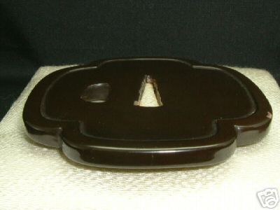

What are their use, when do they appear?
In short, I should be grateful if anyone could provide some data about their history and pictures. Some seems to have been elaborated.
Well, since no one else is replying....
As was mentioned, seems like they were used early on with black lacquer - mostly dogu like a tosho.  From what I can tell, seems the fell out of favor in lieu of iron and metal tsuba, then came back en vogue late Edo period, with some very gussied up examples.  Probably a similar reasoning as the leather gusoku armors of the same period.  The big koshirae book has pics of the earlier ones.  I recall some pics from swords taken from temple rafters that had a number of lacquered leather tsuba.  The Edo and later period ones can look both understated (i.e. formal fittings) or pretty fancy.  Have seen both maki-e as well as pressed designs in these.
Can you narrow down what specifically you're looking for?
Thanks Junichi for this answer. I don't know anything about wooden tsuba and did not know they existed, so I did not know what to ask for. I was wondering what were their utility compared to iron ones, were they ised in fights? Were there schools? Are they collectors? Can they be papered?
Ah, sorry Jean.  I saw "lacquered tsuba" and immediately thought leather.  Regarding wooden, I've only seen late edo examples, and could only tell because because the lacquer was chipped that it was wooden vs. leather.  If lacquer is intact, I might be harder to discern whether thee core of these light weight tsuba are leather vs wooden?  I have a lacquer example where one of the layers has bubbled from the inside and cracked the surface, indicating it was leather and not wooden.

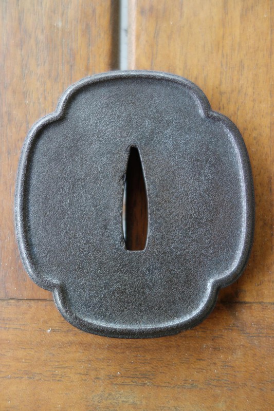

Please find attached an example of a wooden tsuba that I came across recently. I thought it was iron until I picked it up. The lacquer has an iron affect to it. Probably would have fooled most people if mounted on a sword.
