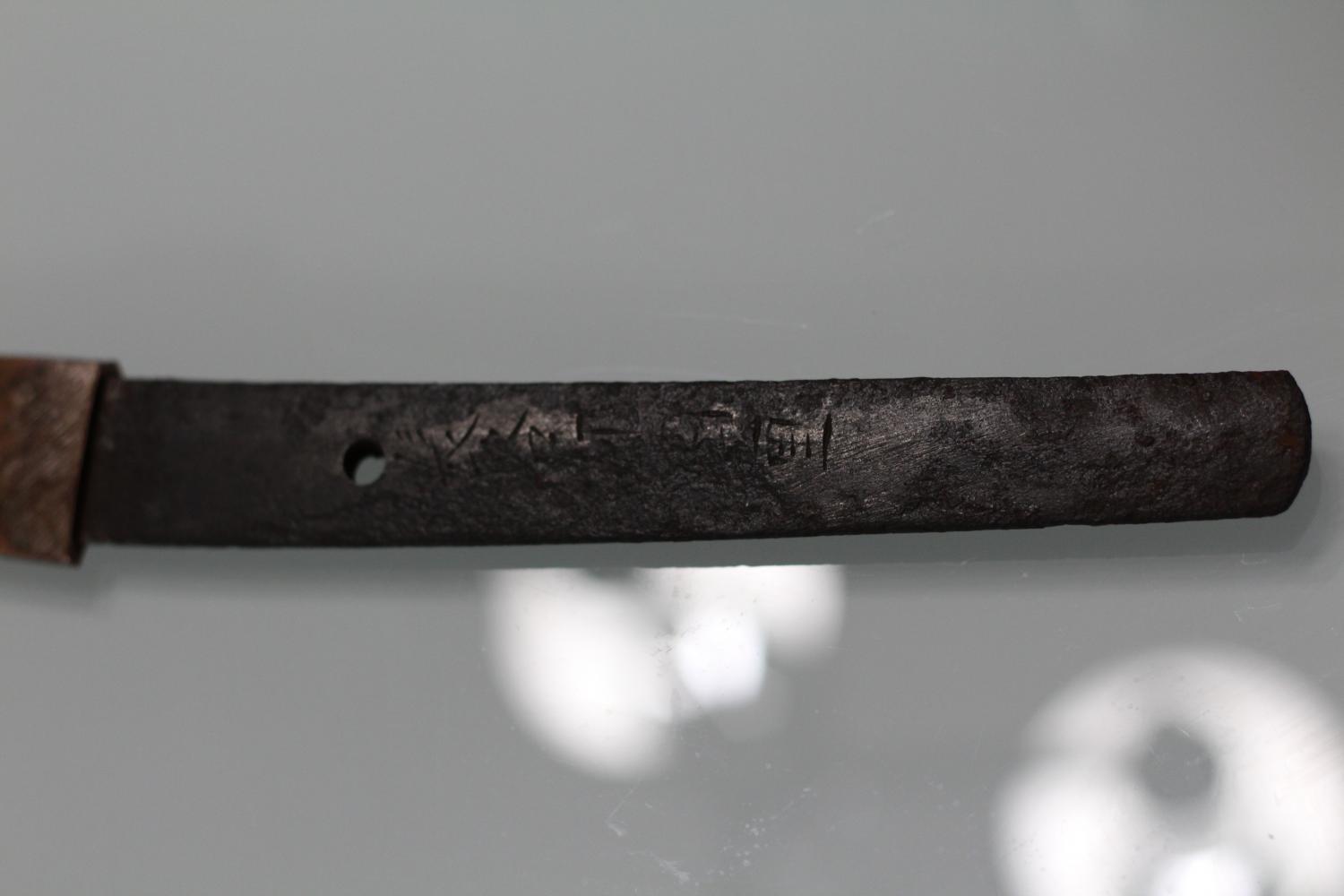

isidro305 Posted June 9, 2015 Report Posted June 9, 2015 hi i recent buy this blade i try to find my self the mei is not 100% visible but can be hasebe ? kunishige any help i will appreciate Isidro: Quote
John A Stuart Posted June 9, 2015 Report Posted June 9, 2015 It appears to read so, but, I have little faith in its veracity. John Quote
Jean Posted June 9, 2015 Report Posted June 9, 2015 The mei does not fit the blade. Should it be this lineage of smiths the blade should be worth more than 10K€... Quote
b.hennick Posted June 9, 2015 Report Posted June 9, 2015 Hasebe Kunishige squeezed the mei near the bottom of the nakago. The writing is not his and the tnag shape is not typical of his work. Quote
isidro305 Posted June 12, 2015 Author Report Posted June 12, 2015 thanks all for the help, question in this condition of polish can be submit to shinsa only to check the mei i don't pay to mooch for this one but i don't want to pay more for a polish and remove the mei if is not kunishige Isidro: Quote
