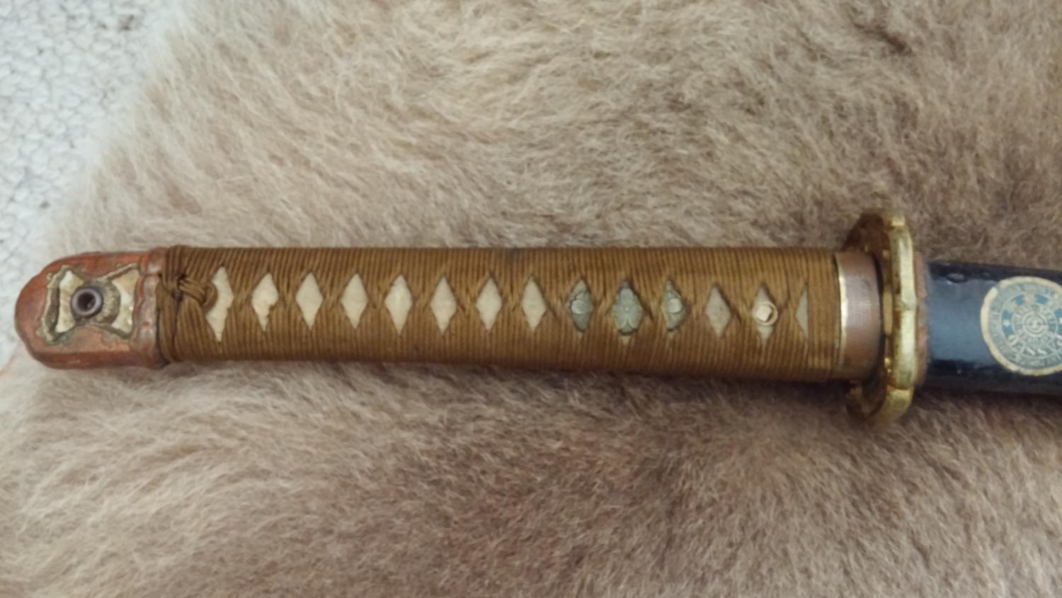

There are two swords in question. The first was sold as a very late war Type 98 Officers Sword. The fittings are all very low quality and were I to see the sword now I would be wary. However, it also displays all the correct signs of age and has a curious sticker on the saya, where the combat cover has worn away. The blade is also seemingly well made and correct. Having read Military Swords of Japan, I'm currently undecided on this one.

The blade with the Gifu Ken sticker is real; I've seen those before and I doubt the Chinese know of them.  The NCO I'm not sure of.  There is a strange angle where the mune disappears into the habaki that doesn't look right.

Thanks you so much Grey. That is a big relief. My instincts said yes, but the poor quality fittings made me doubt, since Japanese craftsmanship is usually so stringent. It also happens to be my favorite sword. NCO... I'm also not certain, but again it shows all the right signs of age and is consistent with my other 95's in scale and wear.
Both late war, the latter from Seki Cutlery company and kinda rare according to F&G. The poor casting of tsuba often confuses, seen one with better tsuba as well.

I would have called fake on the NCO but am happy to defer to those with more knowledge of these than myself. Sounds like it is a known variant.

these are war time swords and have nothing to do with NIHONTO. They were factory made in thousands and there is no craftsmanship involved. There are hand-forged blades in existence which were made in traditional ways.
I can confirm that the one with the cast tsuka is very likely a true late war production. I saw such a piece on a flea market in the formerly known GDR. Hence befor 1990 in an isolated market ;-) Tsuka had the same color!
I went searching for the reference to the Seki sticker Stephen mentioned in F&G and finally found it. Matches perfectly, and when I read that it was rare, I couldn't help but grin.
In 'Military Swords of Japan' Plate 51 seems to show the same sword as the 95 I have above. Now, the issues I had with this one to begin with was the cruder casting and the seemingly 'hammered' numbers, but the casting at least seems to be validated as a cruder emergency pattern and opinion seems to suggest it is genuine.
