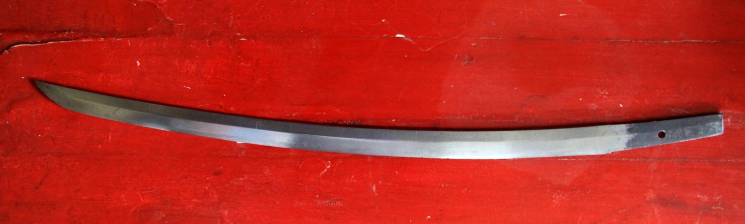

Hello ,

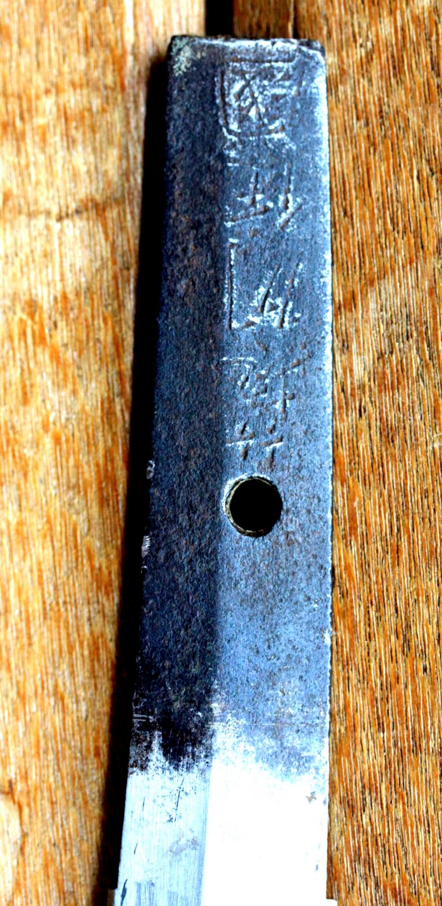

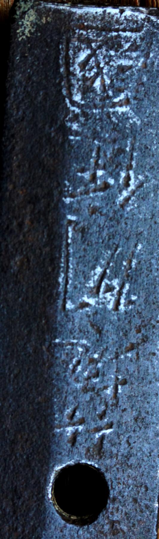

Here some picture from a Wakizashi ,I  have already post some pictures from the Nakago and a member : John A Stuart wrote that It might be Sasshu ju Kuni.I made some research but unfortunately I was unable to find more information.
I ‘m new in Japanese sword and and I have bought  few swords in order to add in my collection ( my field of interest is the European  swords from 14th to  17 th century. May be the Japanese swords collector could be shocked but I prefer to buy at low price an old sword with a blade in poor condition. I ‘m not specialist  and I don’t care about the sign of use and age if the sword is authentic  so even in poor condition a Japanese blade  stay attractive in my eyes and if you compare with a European sword from the same period specially for the blade with more  than 4 centuries  the conservation of Japanese blade is really amazing.
It would be very nice if a member could tell me more about this sword and his components I would like to know from which period this blade is  I understand that based and the pictures it is may be not easy but if a member has some clues his opinion  is welcome.

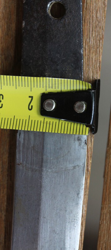

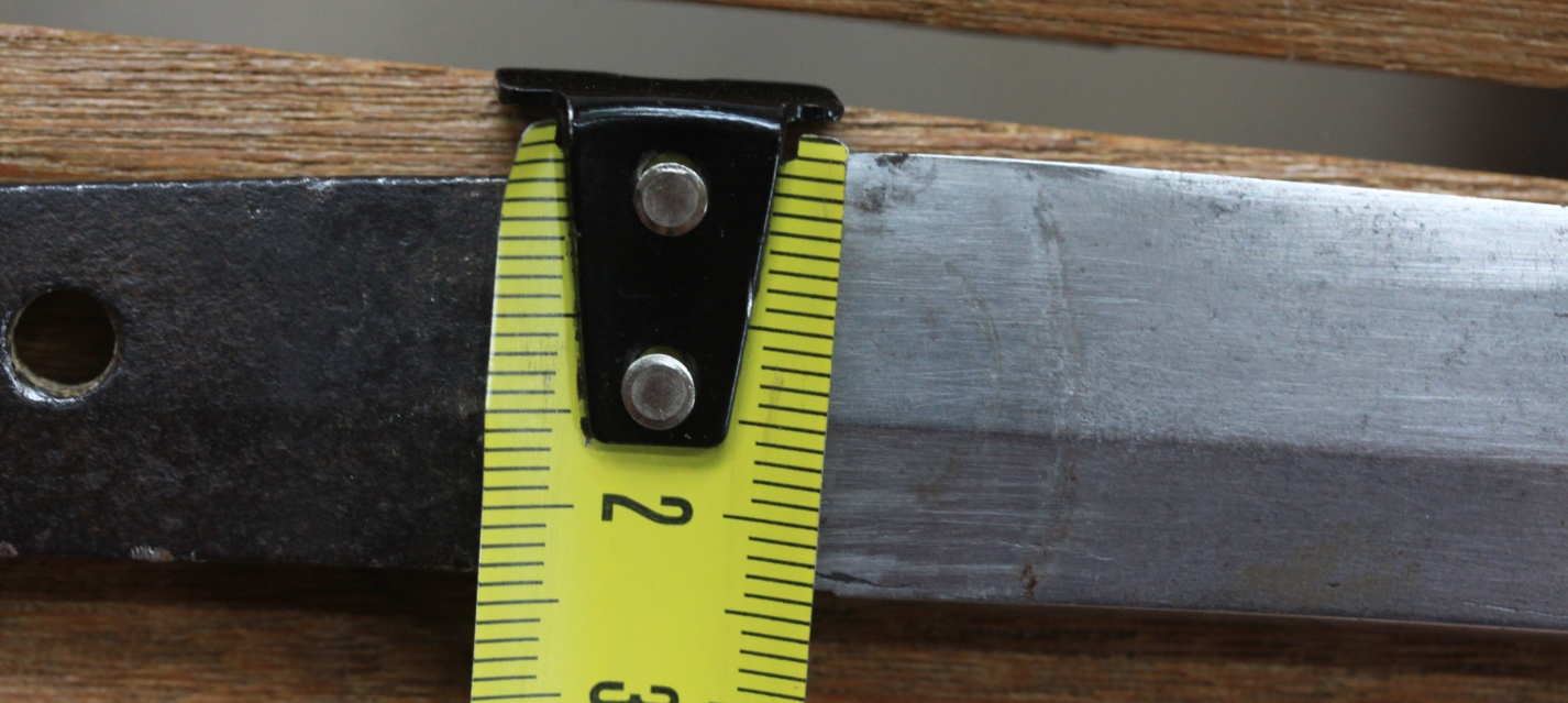

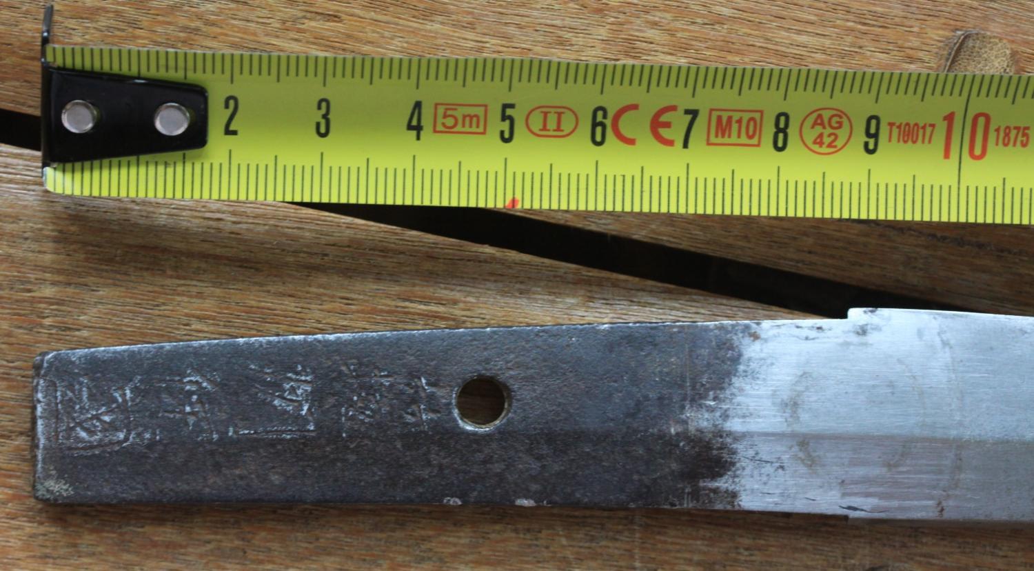

Nagasa  44.7cm
Motohaba  30 mm

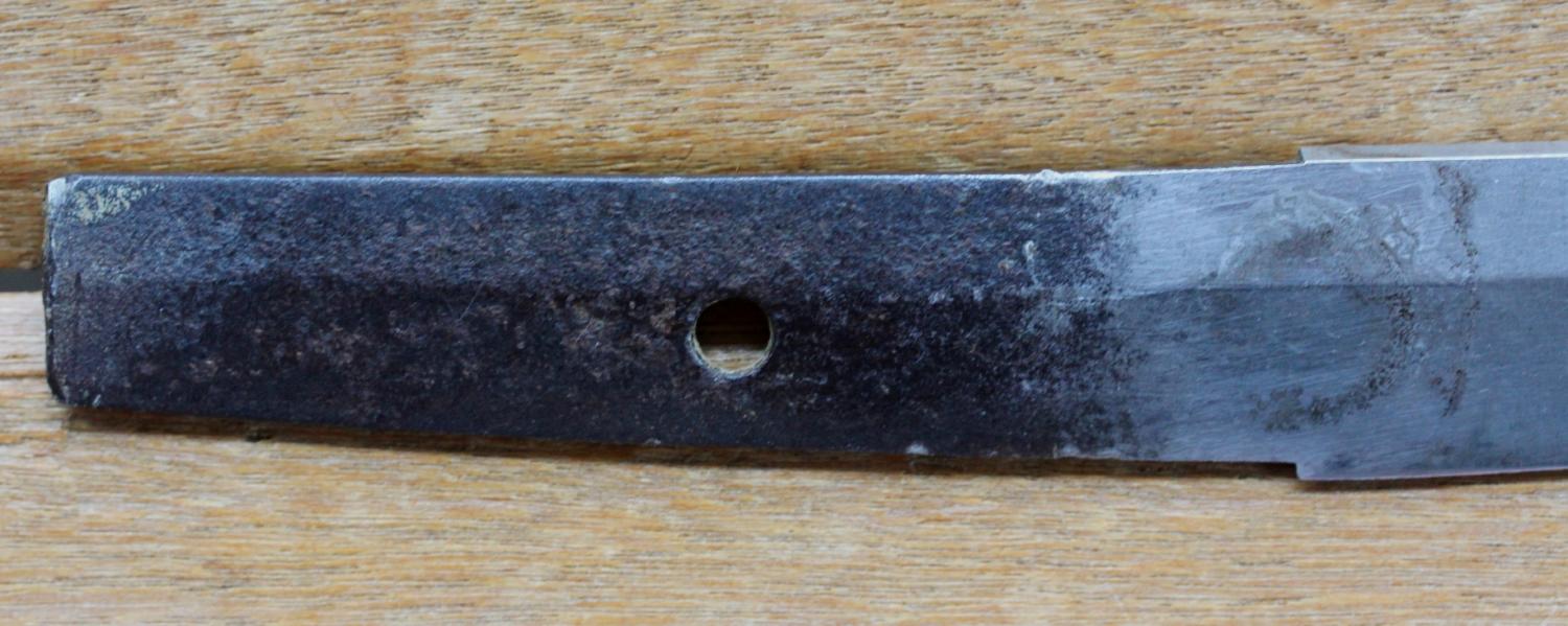

Nakago  8.9 cm Kiri Yasuri
Kasane ;6.3 mm ( the tickness has been measured at the shinogi.
Iori mune

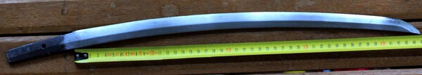

In my eyes  but may be wrong   Shinogi  Zukuri.That it 's all I can say

A real blade, Cerjak, shinogizukuri, although I can't tell if there's a yokote. The photo of the Kanji is upside-down. The nakago is o-suriage, of course, & the mekugiana is chiseled. A whole lot of sori for a wakizashi, & it looks koshi-zori. Hamon is some type of suguha, but your photos of the hamon & hada are just too blurry to tell anything. Maybe if you can take some better, IN-FOCUS shots, it would be easier to help you.

Ken, if the nakago is o-suriage then this has to be gimei.  Do we know this for a fact?  With the strong sori I would watch for retemper.  Be careful Cerjak.  Your acceptance, without knowledge or experience, of blades in rough condition is setting yourself up to pay real money for worthless blades (not saying that is the case here).

Hello KEN
Many thanks for your answer,
I can confirm you that there is no yokote  and as you can see  , this blade has heavy traces of corrosion and also seriously  damaged  by unprofessional hands ( may be criminal for a collector) !

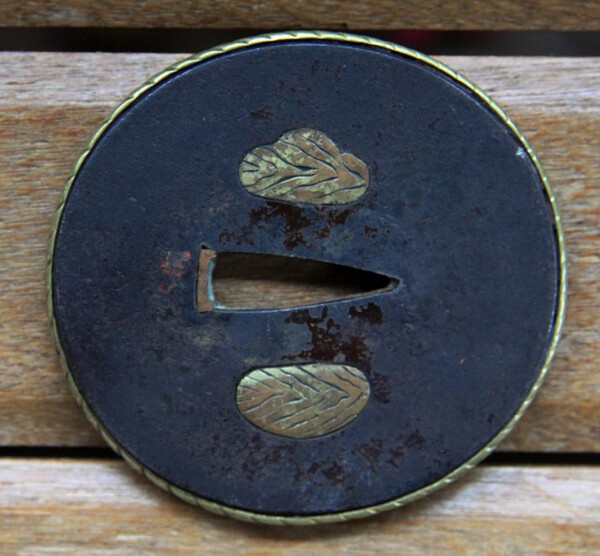

Anyway I would like to have your opinion about age and also about tsuba and Tsuka  if possible .

I mentioned retemper because that often is the cause of exagerated curvature in Japanese swords.  Not saying that the sword is retempered (can't tell just from the pictures) but if it is, no one will be able to judge age or much of anything else about the blade (no one includes the guy who sold it to you).

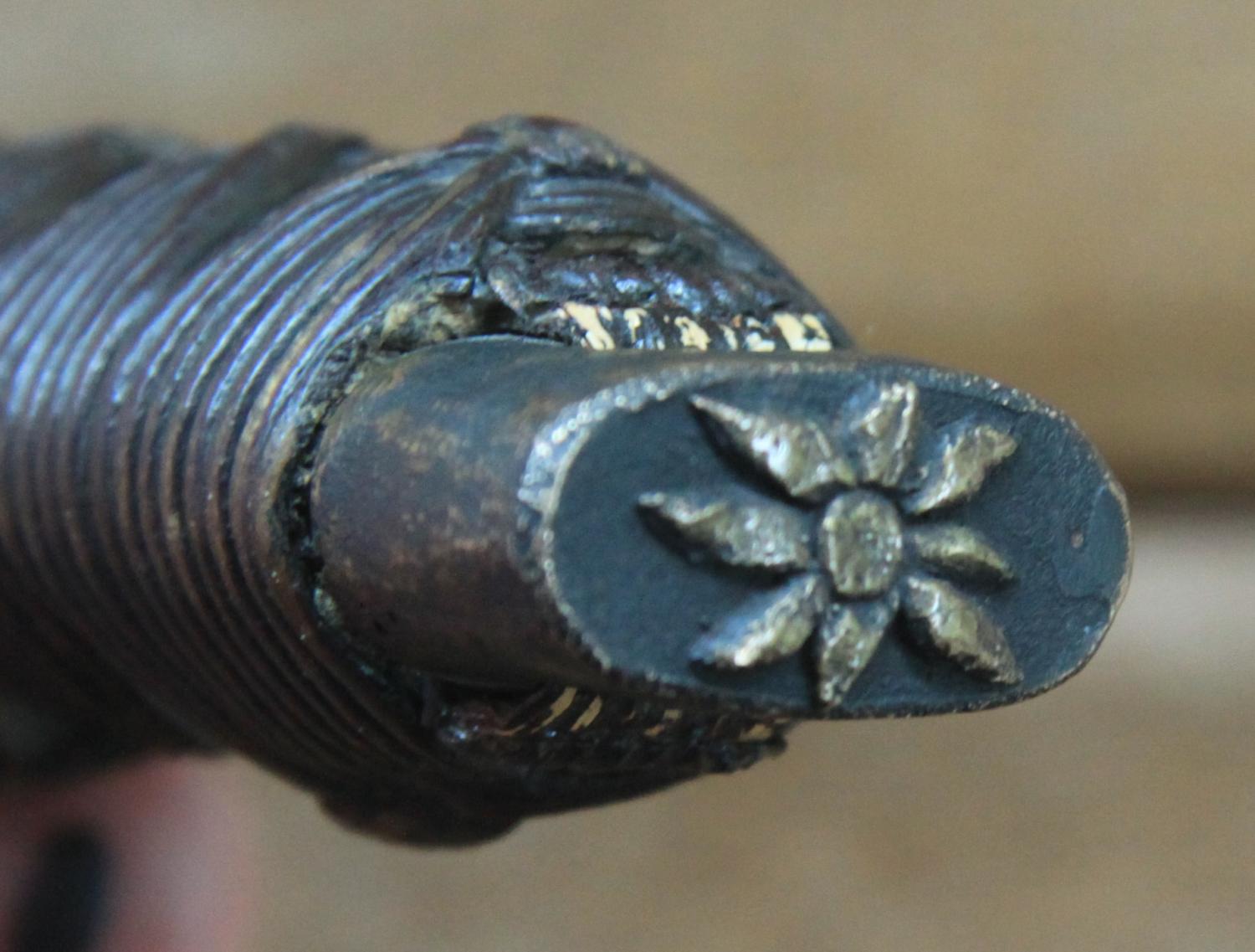

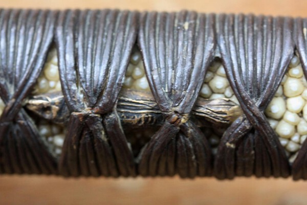

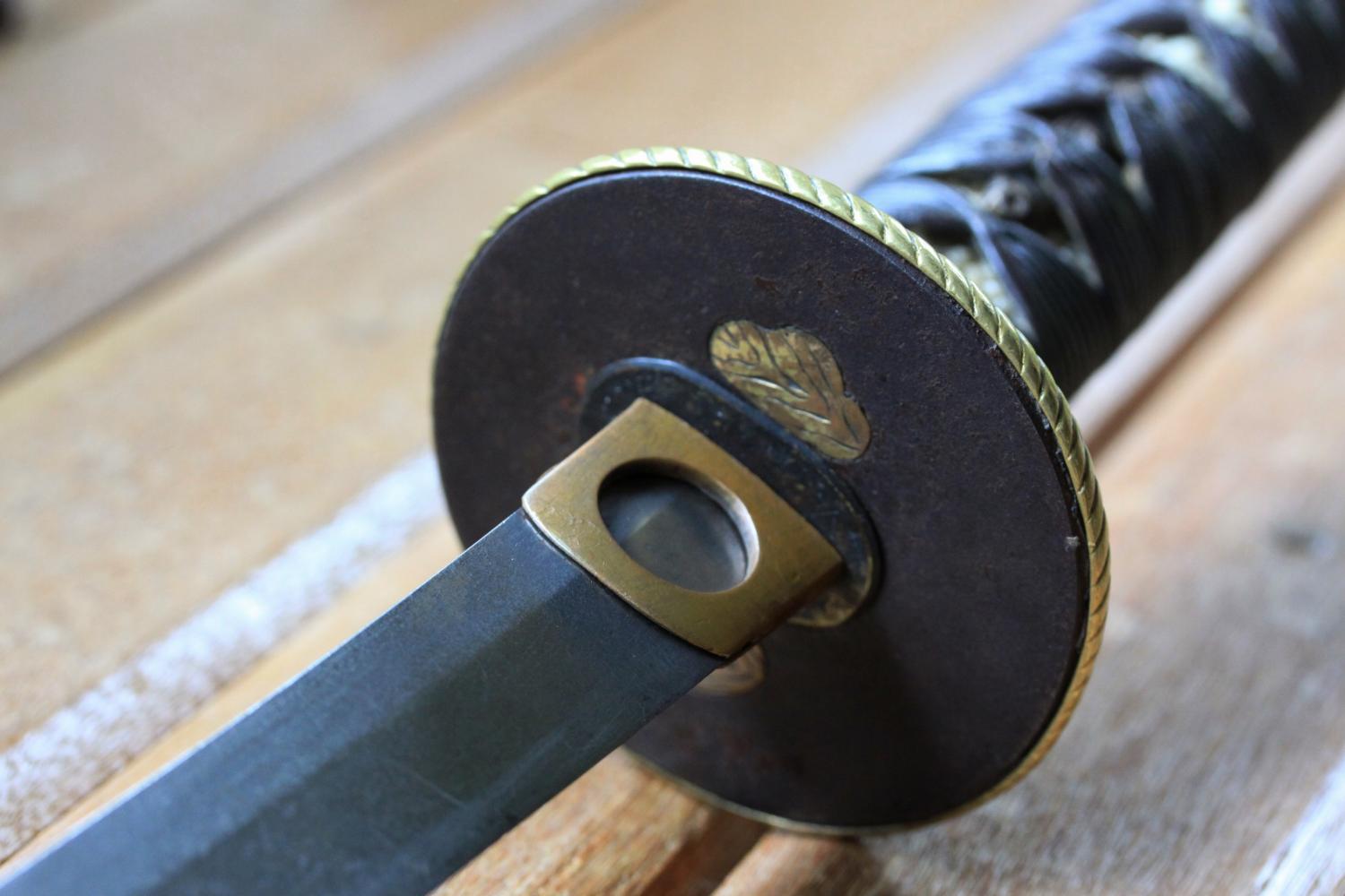

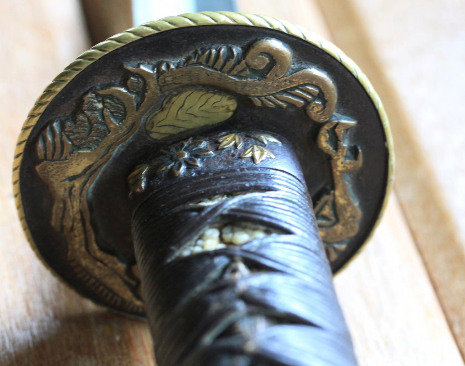

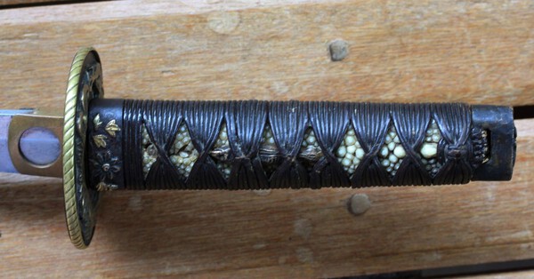

I'm not a tosho expert, Cerjak, but the tsuba looks more recent than the blade, & appears crudely-made. The tsukamaki looks old, but also a bit odd, as the strands look as if they're welded together. That may just be age, though. The underlying samegawa looks real, & I have no idea what the menuki represents. The fuchi & kashira match, although they don't appear to be really high quality. The habaki is a basic copper
You'll notice that I've left the blade for last. My guess is that it was shortened into an uchigatana-type wakizashi from a much longer blade which, as Grey points out, would make the blade gimei. I see no sign of retempering, but your photos really aren't clear enough to really tell anything in detail. Age-wise, going from the lack of visible yasurime, I'm guessing at least Muromachi, & possibly older, but please remember that this is nothing more than a guess.
Aloha!
Ken

Just to add that the menuki represent dried fish and the tsuka maki is probably lacquered paper, not common but original.  I don't think the fuchi is original at all and it is possible that a perfectly adequate iron tsuba has been jollied up with the added decoration though we can't see much from your images.
We probably don't need to worry to much about gimei, either for or against but it seems possible that this was a wakizashi which has been shortened, losing part of it's original mei.  We may only be missing one kanji so the smiths name is Kuni.......  However the position of the mekugi ana and indeed the mei remain odd.
