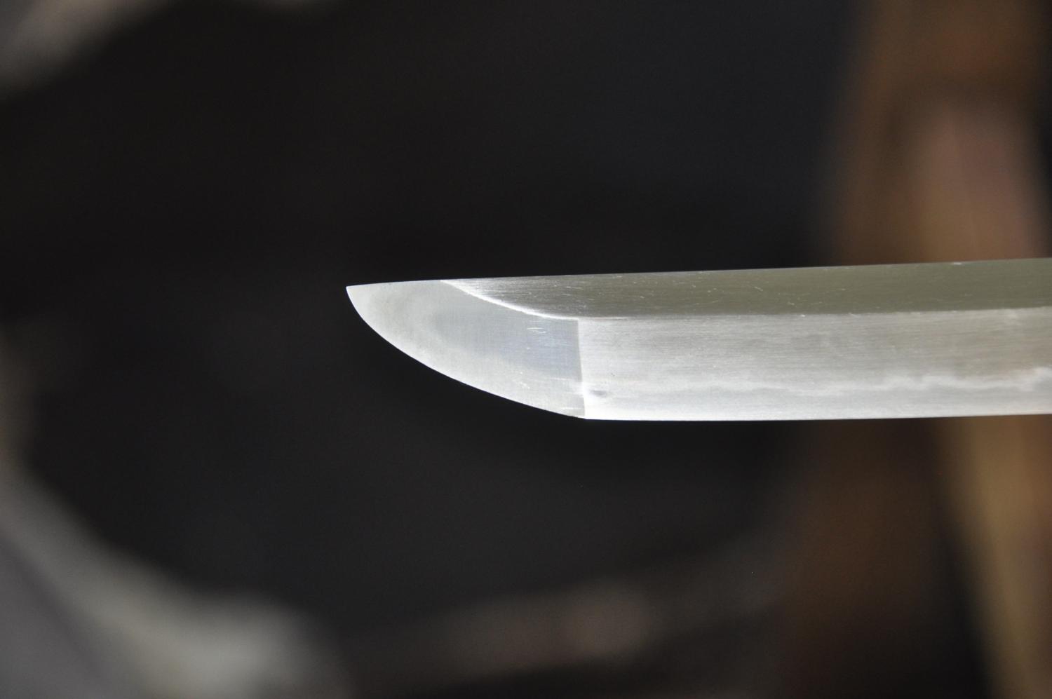

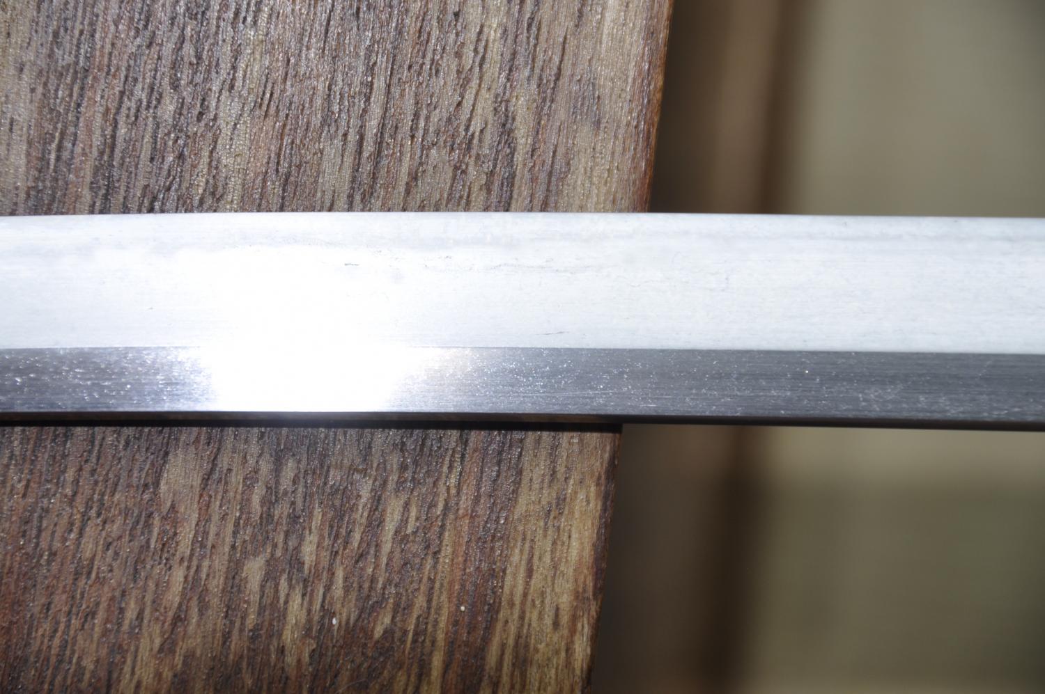

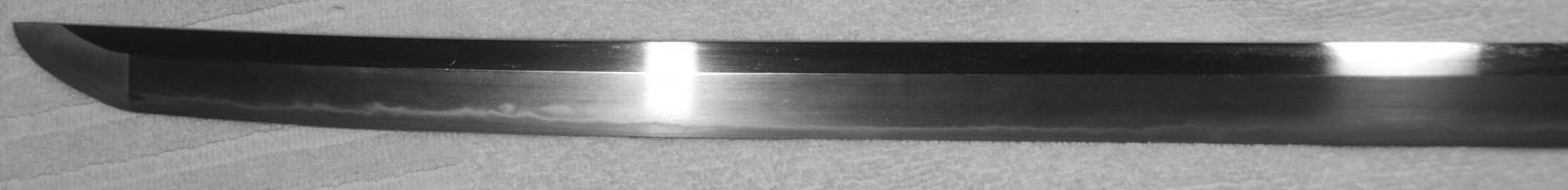

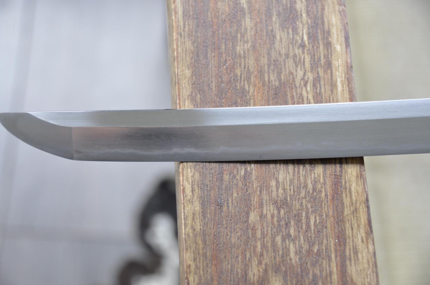

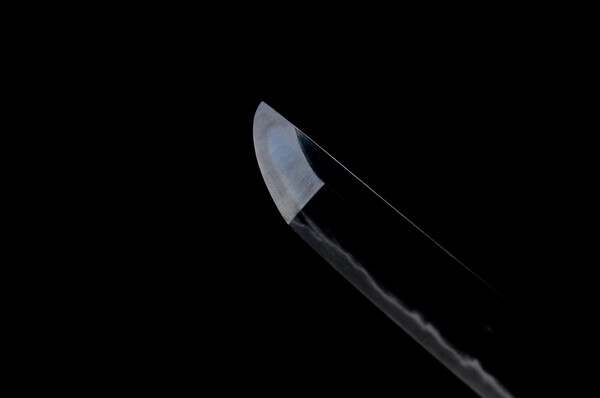

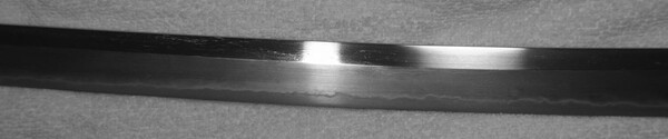

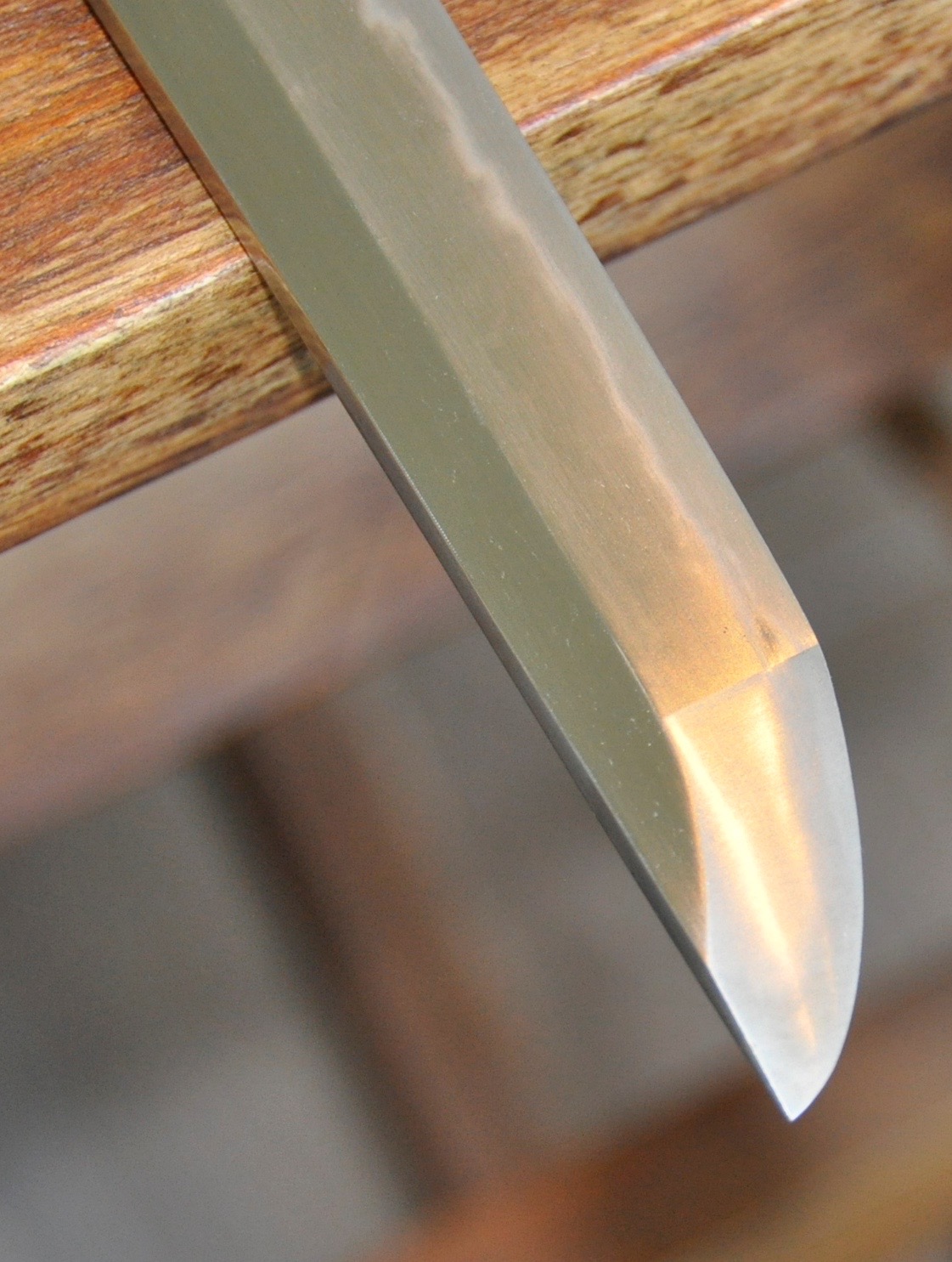

I would like to ask you to assist me with filling in my inventory sheet based on the pics. I enjoy looking at this sword, it's just that I can't find certain answers.
Blade length: 64cm
Blade width: Machi: 0.7cm Yokote: 0.4cm
Mihaba: 3 cm
Sori: 1.6cm
Koshi-zori
Mune: Ihori (hikushi) from the mune side, it's almost rounded but it does have an "edge".
Probably where it becomes slightly more difficult are the following areas.
Kitea: ??? My idea is masame, any confirmation?
Hamon:???
Utsuri:???
Boshi: ???
When I look at other examples, it seems so easy to see, is this a way of photographing?
Kissaki: chu-kissaki

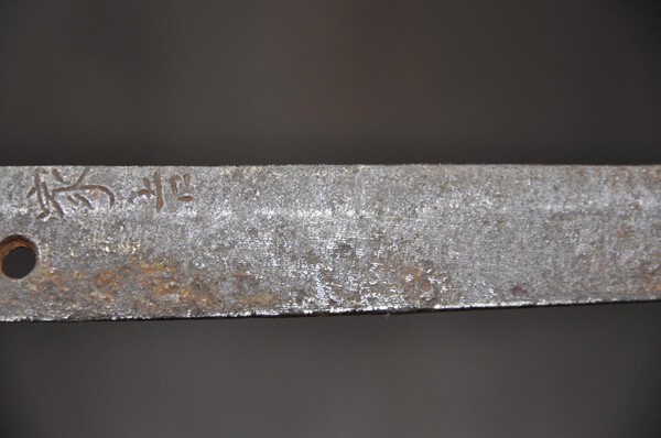

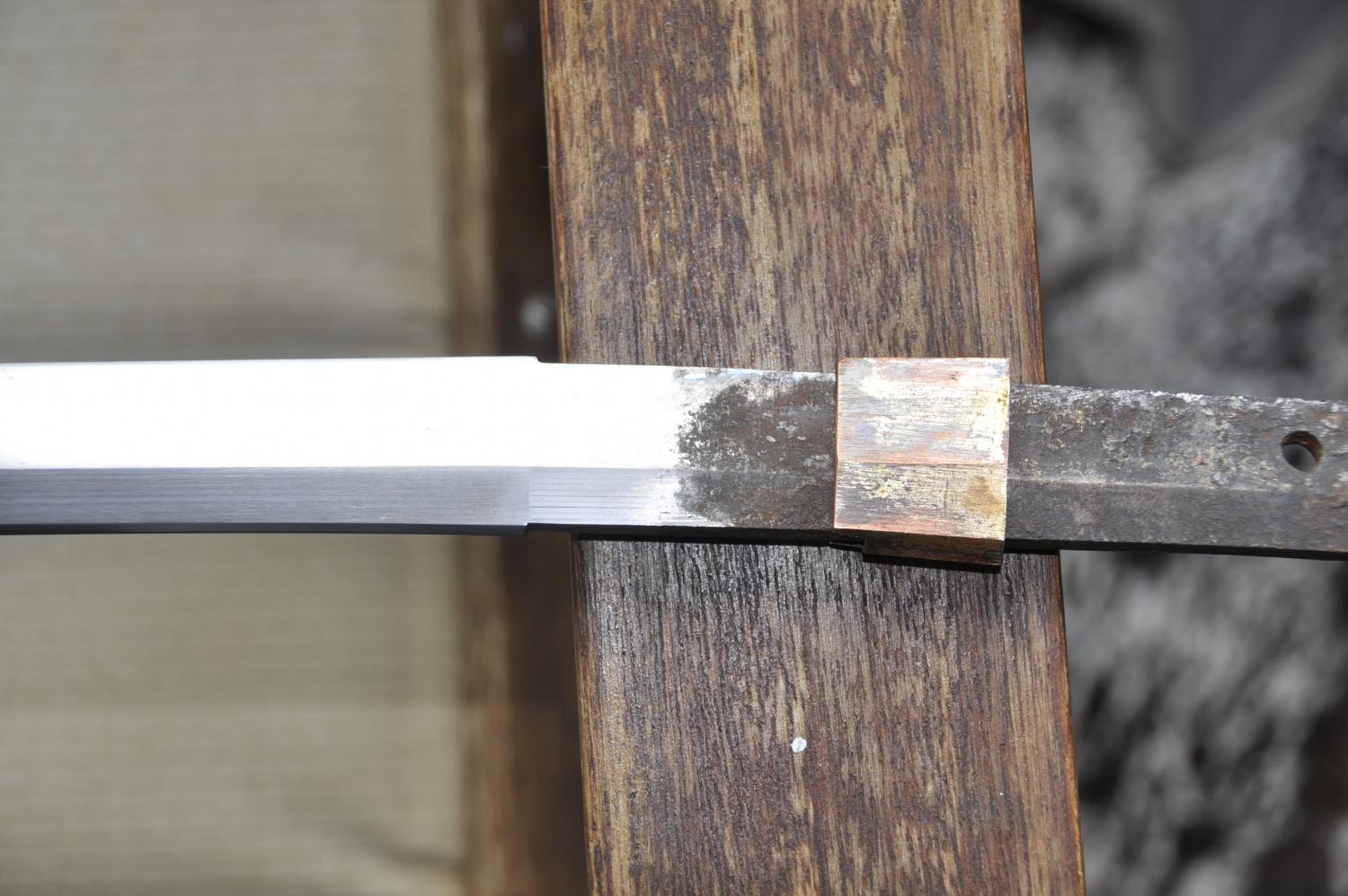

Nakago: O-suriage, mei is still visible, is it still called o-suriage?
Nakago length: 24cm
Mekugi-ana: 1
Nakago-Jiri: Kiri (ichimonji)
Yasurime: Very hard to see.
Mei: Tachi mei
Looking forward to your comments, please be gentle, still a novice.
Best, Ron G.
Kitae: don't think it is masame, but not visible in your pictures
Nakago: suriage
Boshi: perhaps O maru but due to the picture difficult to see where it stops
Hamon: based on suguha, gunome midare, seems to be nioi deki but here again need better pictures
No utsuri visible from picture and difficult to see if your sword is not in top polish
Not sure of the Koshi sori
