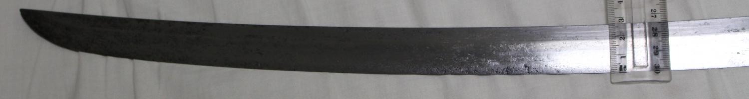

Nagasa:662mm.

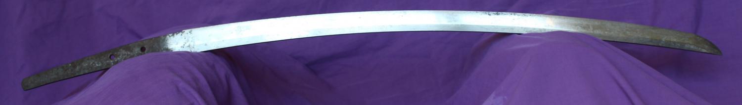

Sori: ~27mm

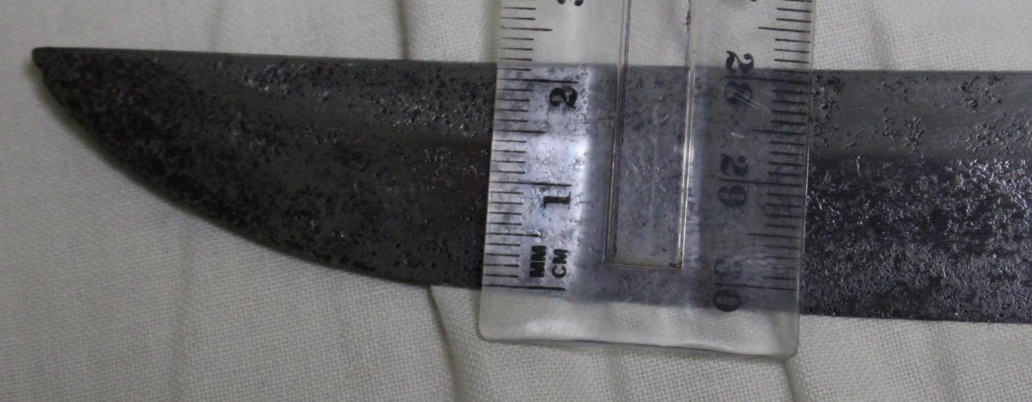

Mihaba:31mm
The following post will have pictures with Mihaba a kasane width.
There appears to be hada but it is hard to make out through the scratches and what appears to be oil stains(my uncle was an old school farmer, no such thing as too much engine oil. I wiped off a layer about 1mm thick and it hadn't been out for years...anybody want a cheap plain leather saya:) but I'll leave judgement on that to a more discerning eye. I can't see any hamon, again it could(hopefully) be hidden.

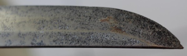

Kasane starts at 7mm at the mune-machi, tapering to 4mm about 1/3 of the way along the blade. ~70mm from the yokote, it tapers to 3.5, then back out to 4mm ~15mm from the point then tapers out (photo following)
Kissake: ~35 I can't make out an obvious yokote. Would this be considered a long or medium kissake?

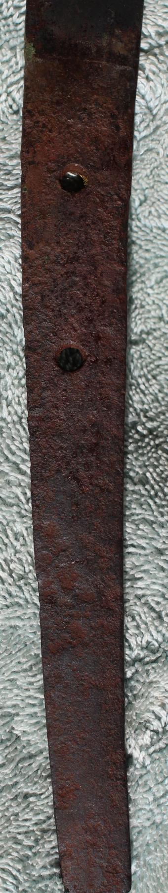

The koshirae is all plain leather. the leather is not just a protective cover over a fancier koshirae, as somebody has opened it at the bottom of the saya and there is no saya underneath. There is no fuchi and no koiguchi fitting. There is a tassle, plain brown, so I'm guessing this is a military sword of some sort. Possibly the nice furniture is still at home...
The blade is bent(looking down the mune) with a deflection of ~4-5mm returning to ~2-3 at the kissake. There is what appears to be a ware(or possibly a scratch) on the mune 50mm long about 1/3 of the way along the blade.
In my uneducated opinion this is an older(pre showa) nihonto....or a fake...I hope it's not a fake. I put a lot of time into this report:)
It appears that I've mislead you. On further inspection, the tassle appears to be multicoloured. Maybe green/orange? Also, it is possible that the leather on the saya is a cover. Where it's been opened, you can see 2 layers of leather and also the outer leather looks like it was meant to go over the sayajiri rather than leave it exposed. I know these don't affect the sword in any way, but anything can help.

The saya is a cover for the missing wood saya.  The tsuba is older than WWII, probably Heianjo Zogan work.  The blade is real Japanese and also older than WWII, maybe a lot older.
While a strong curvature somewhat like this can be found on some very early blades, it often is found on blades made later that have been in a fire and retempered (saiba or yakinaoshi).  If you search the site for retemper you'll find earlier discussions with what to look for to determine if your blade is retempered.
But even then, given your newbie status, you won't know for sure.  Find a reputable, more experienced collector and ask his opinion.

I wasn't saying I'm sure the sword is retempered, just that it's a possibility.  Other signs of retemper: weak, indistinct, and/or odd temper line; mune-yaki (tempered spots on the mune) on a sword that isn't supposed to have them (not typical school work); dry, burnt feeling nakago; temper starting above the ha-machi on a suriage blade; coarse, open grain; and the tip test.
The tip test: remove all koshirae and hold the blade with both hands on the nakago, edge down, and point away from you (good idea to do this over a pillow or couch cushion).  Loose your grip a bit and let the blade swing downward; stop it before it hits anything.  If the blade has its original temper it should fall true; if retempered it will want to turn its edge up towards the ceiling.
None of these are hard and fast but if the sword exhibits more than a couple, good reason to suspect retemper.

Wondering if anybody would be able to confirm my assessment of the sori? Based on my measurements it seemed like the deepest part of the bend was close to the centre, maybe a little bit towards the nakago. At what point does it become koshi? A few further measurements shows slightly more curve from machi-centre than kissake-centre. Of course this all becomes moot if the blade is o-suriage.
