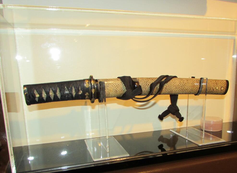

benatthelake Posted May 19, 2015 Report Posted May 19, 2015 Apologies to the purists, but I enjoy displaying this one. I think utilizing minimal materials to highlight the koshirae is appropriate although not traditional. UV resistance treated acrylic case combined with desiccant to maintain a lower RH provides protection. BEN M. 1 Quote
benatthelake Posted May 20, 2015 Report Posted May 20, 2015 On 5/20/2015 at 12:49 PM, Jean said: Ben, Is the blade inside the Koshirae? Jean: Yes, blade is inside. Which is why I included the desiccant to maintain a lower RH. It did not come with Shirasaya. Issues or opinions? Ben Quote
Jean Posted May 21, 2015 Report Posted May 21, 2015 Ben, Be very careful, generally swords are stored in shirasaya because they need a dry environment while koshirae are stored away from light and in a moist environment due to the lacquer Quote

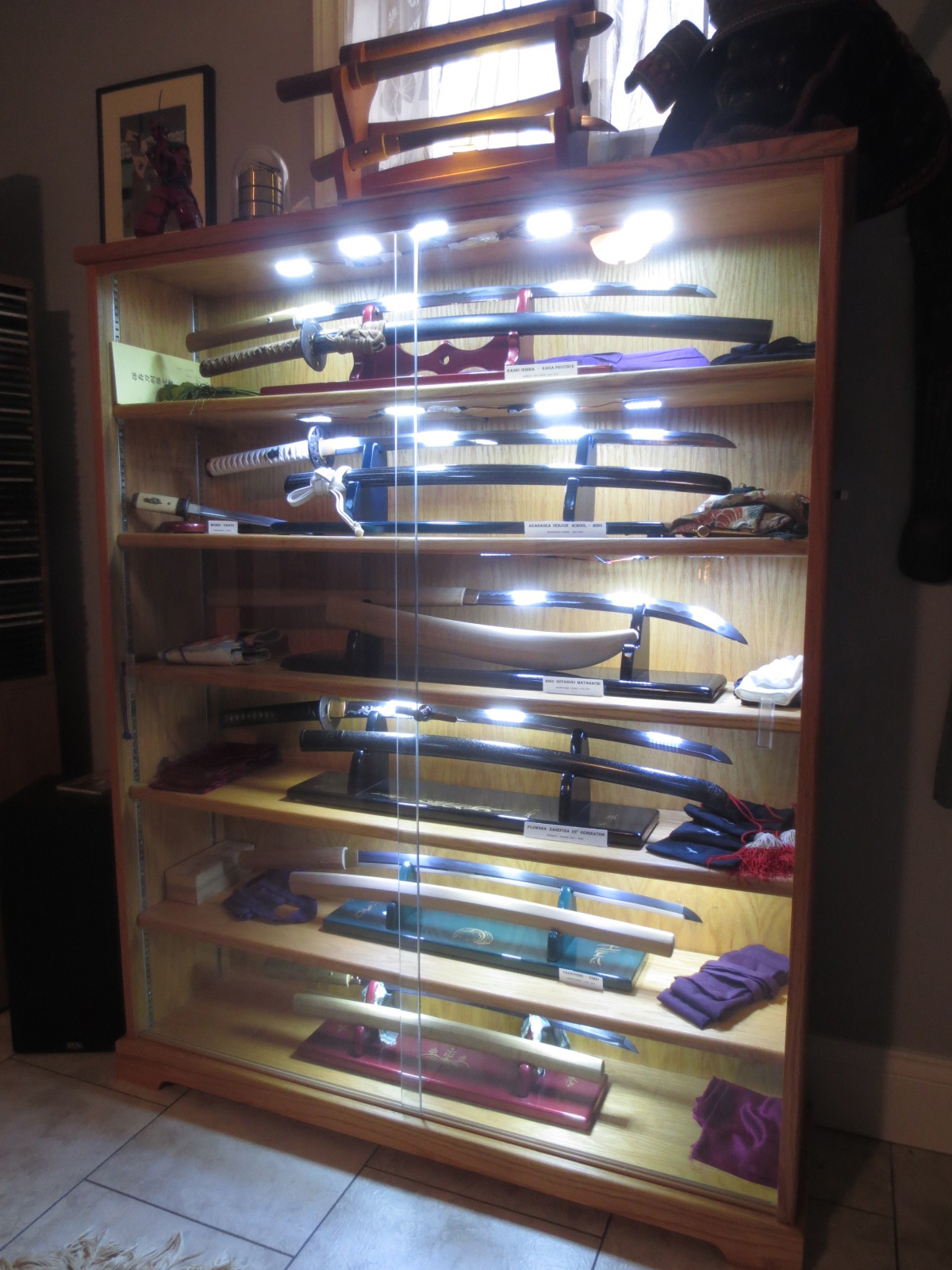

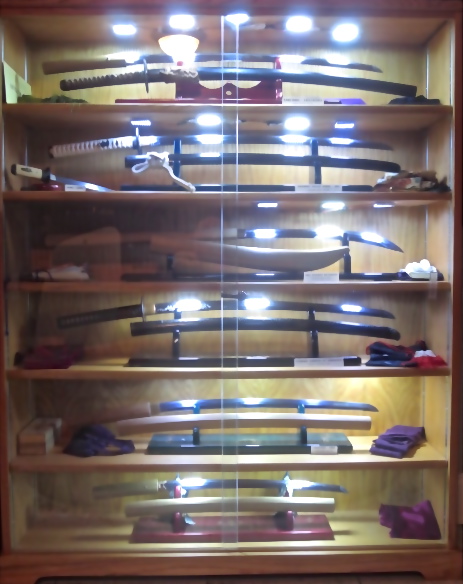

drbvac Posted May 22, 2015 Report Posted May 22, 2015 MIne are are stored edge up on home made stands behind locked glass with a dehumidifier bar in the bottom to lower the humidity to 30% and I can look at them all day 1 Quote
Jean Posted May 22, 2015 Report Posted May 22, 2015 Good display but best way to destroy the lacquer work, I wonder why no one has asked himself why swords and koshirae were stored apart in Japan. I wonder why people are going at length to preserve the blades and do their nest to destroy the koshirae lacquer works. Ask Guido or Henry W. how they store their Koshirae.... Quote
drbvac Posted May 22, 2015 Report Posted May 22, 2015 On 5/22/2015 at 11:27 PM, Jean said: Good display but best way to destroy the lacquer work, I wonder why no one has asked himself why swords and koshirae were stored apart in Japan. I wonder why people are going at length to preserve the blades and do their nest to destroy the koshirae lacquer works. Ask Guido or Henry W. how they store their Koshirae.... I am sure they are stored somewhere to keep them from drying out and cracking - I do make sure the humidity doesnt go much below 30% and I wax the koshirae with Rennaissence Wax. Hasn't seemed to do much damage in 20 years so = ? Quote

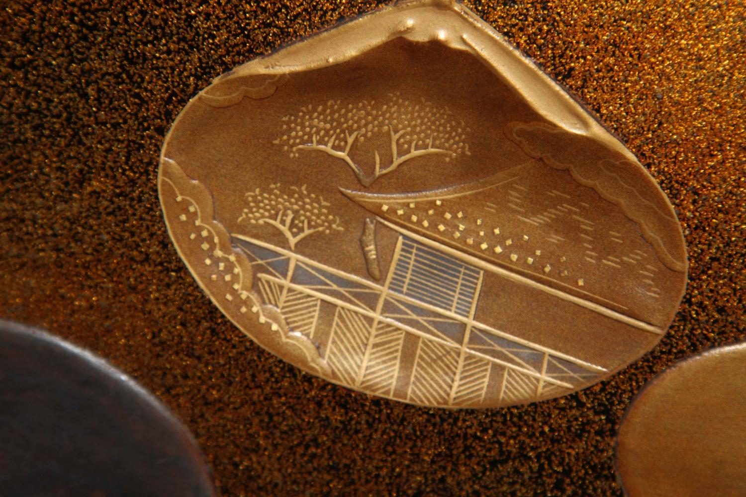

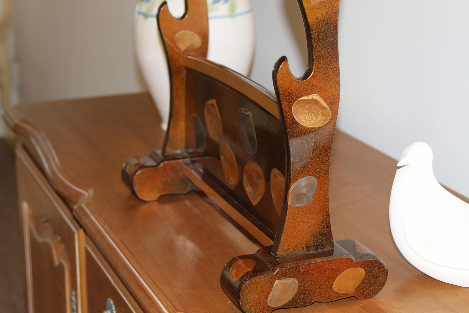

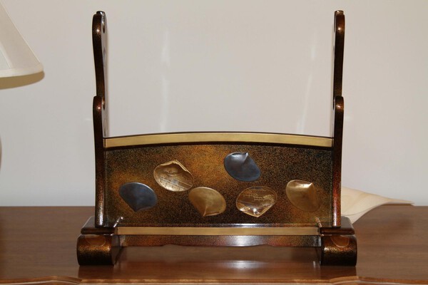

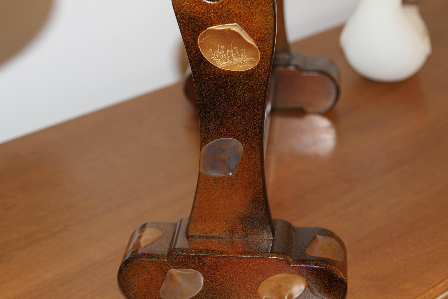

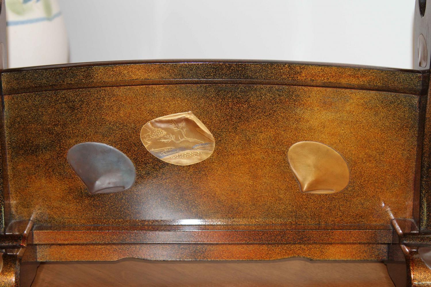

Loco Al Posted May 23, 2015 Report Posted May 23, 2015 Regarding storage, I keep my swords and koshirae in their bags and in a safe when not at home. Recently acquired a new katana-kake. Reluctant to display a koshirae on it though, for fear of scratching or marring the lacquer. Lots of photos. Alan 2 Quote

Loco Al Posted May 25, 2015 Report Posted May 25, 2015 Kronos, That was a very interesting article on lacquer from the Bishop Museum. I saved a copy of it. Now I am afraid to leave any Japanese lacquer-ware (koshirae or stands) out on display in case they deteriorate from UV light. In answer to Ben's question: My katana-kake is supposed to be late Edo period. It was up for auction on the Aoi Art website, but no one bid on it. This is a bit off topic, I know. I inquired about it immediately after the auction ended. Having only bought one other item from them, they agreed to a small discount. Every once in a while, something really nice pops up on their website. I would try not to get involved in a bidding war for something on their auction page, unless you really must have it. They have been most reliable to deal with, and they ship items promptly. Alan Quote
