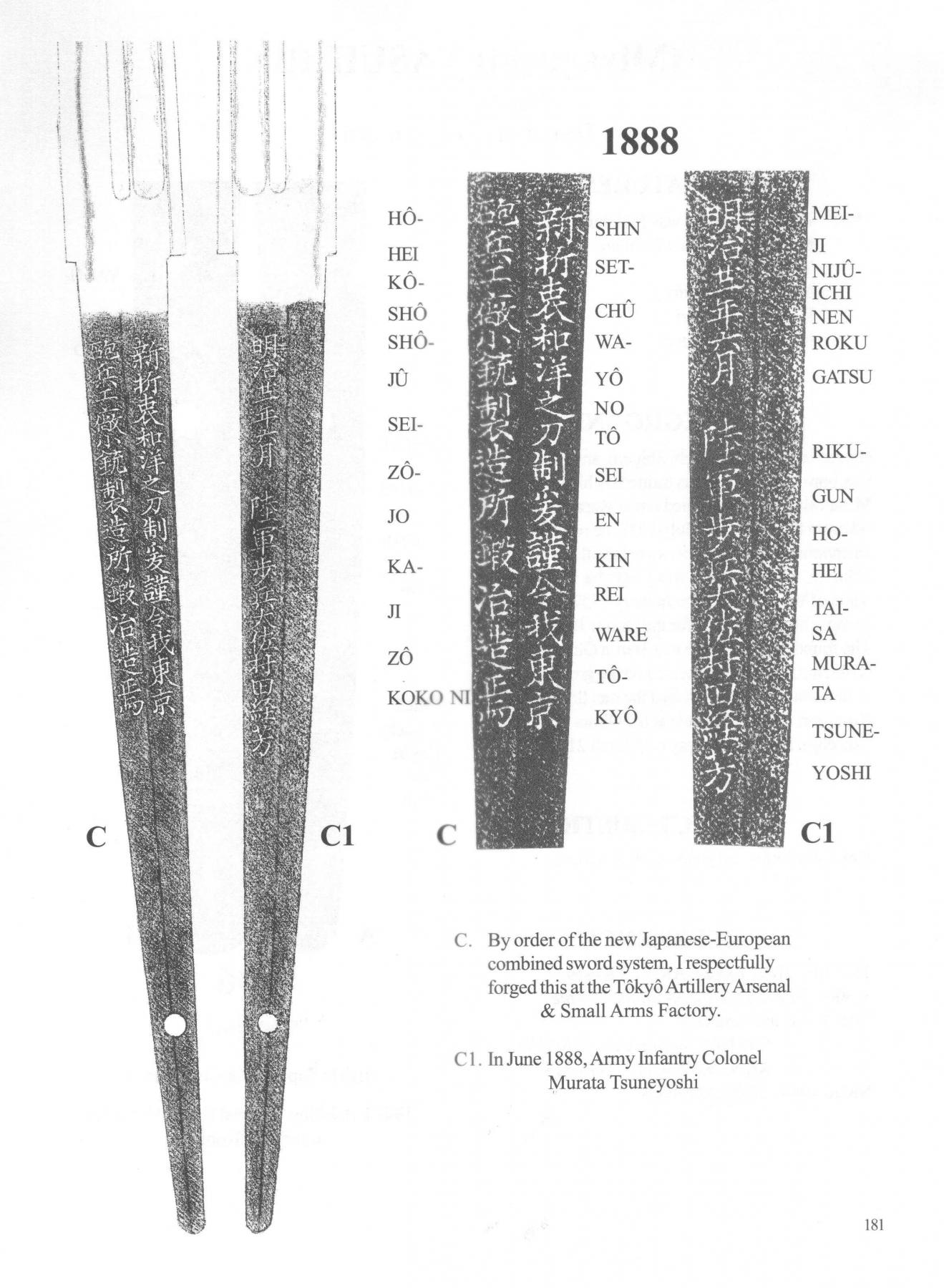

Mark Posted April 16, 2015 Report Posted April 16, 2015 page 181 of John Sloughs Oshigata book has a blade that shape made by Murata dated 1888 Quote

jct3602 Posted April 16, 2015 Author Report Posted April 16, 2015 Mark, where do you find John Slough's Oshigata book? Would be very interested in seeing that particular Oshigata. The information that Ohmura-study/net gives does not indicate anything forged that early, but Murata was working with the best smith's of his time in his effort to produce appropriate officer's blade styles during that period, so it is certainly very reasonable to have a date that early. Great info, thanks John Quote

Stephen Posted April 16, 2015 Report Posted April 16, 2015 John page 181 will be scanned and PM me your email and ill do it for free Quote

jct3602 Posted April 17, 2015 Author Report Posted April 17, 2015 My thanks, Stephen and Cisco! The oshigata in Slough's book are very clear; obviously the seminal piece for the kogarasumaru style general's sword. Also the signature is different - the piece in Slough is signed Murata Tsuneyoshi; mine is signed Sho-Uju Kanemasa. Still an early piece with no armory production number and tempered, but almost 2 years younger than the prototype. Next question was the type of steel; Ohmura says Solingen steel was used in some of the early trials as was a mixture of Swedish and Japanese steel - this is one I feel will go unanswered unless my friend Michael Bell the swordsmith can give me a strong opinion. Once again, thank you all john Quote
Stephen Posted April 17, 2015 Report Posted April 17, 2015 recheck page 180 i sent you...far left ShoJu Kanemasa AKA Tsuneyoshi...Mid to high grade Gendailto A. Shoju (small arms) Quote
