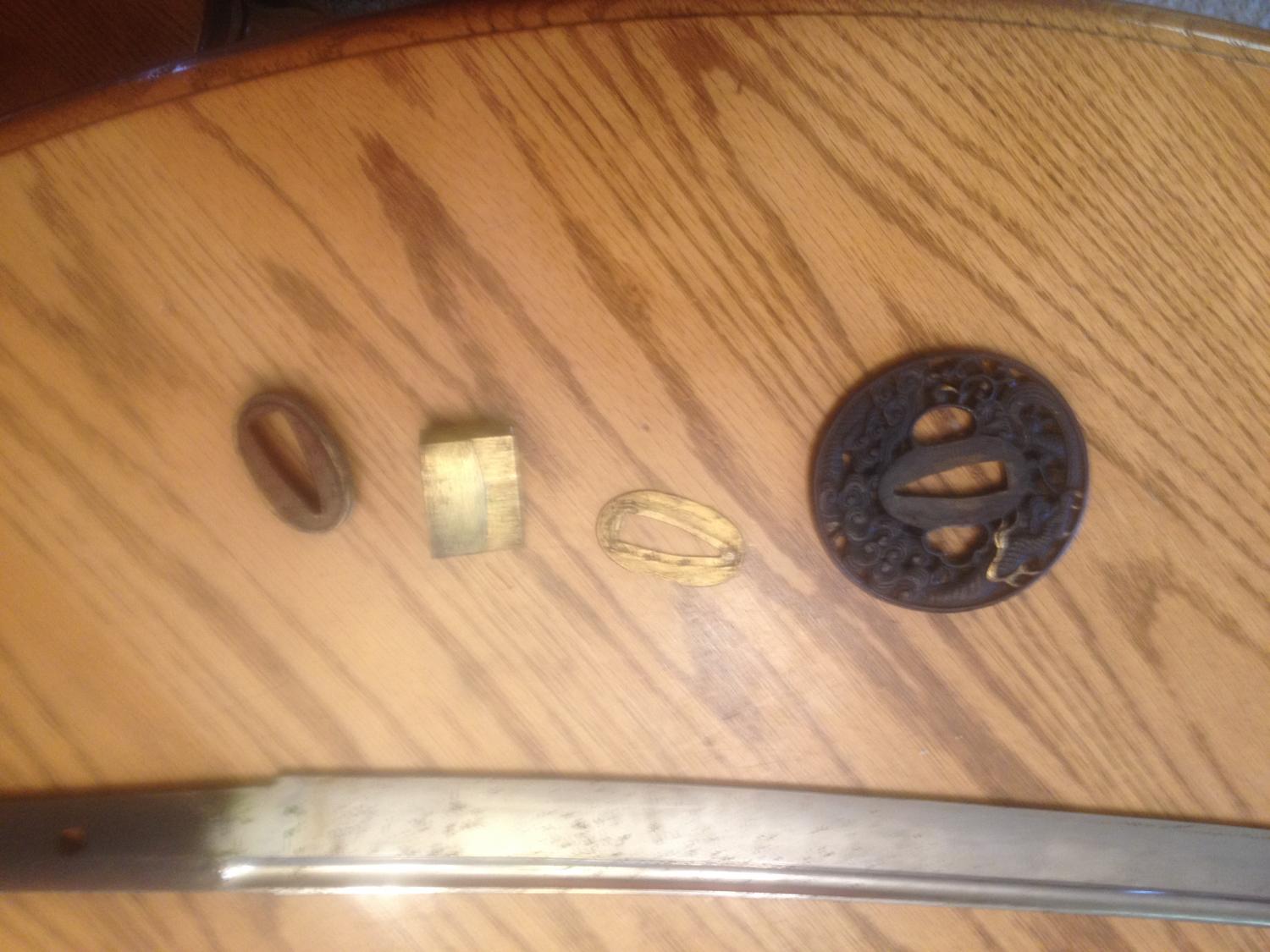

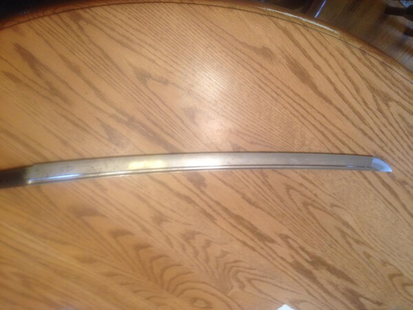

64 ragtop Posted April 11, 2015 Report Posted April 11, 2015 I have owned this sword for many years. It was given to me by my parents when they moved out of their house.It was left to them in a house they bought in 1964. I have been trying to research it and have come up with very little. I hope my photos are clear enough. The handle is in bad shape as is the scabbard. The blade is very sharp but has small bits of rust on it. I have not cleaned it just took it apart.

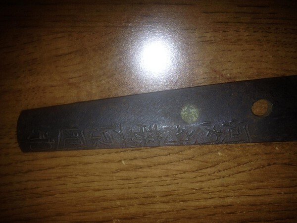

SwordGuyJoe Posted April 11, 2015 Report Posted April 11, 2015 Looks like a Shinto wakizashi. Can you provide better pictures of the nakago and fuchi so we can have a better chance translating? The sword looks like Kawachi no kami fujiwara kunisuke
Brian Posted April 11, 2015 Report Posted April 11, 2015 Good looking sword. Nice tsuba, well cut hi (groove) and a double habaki point towards something better than average. Give it some oil. Brian

cabowen Posted April 11, 2015 Report Posted April 11, 2015 As Joe mentions, the blade is signed Kawachi no Kami Fujiwara Kunisuke. This line worked for several generations in Osaka in the 1600's and onward. Many fakes of the first few generations who are well known. The way the signature is positioned towards the end of the nakago makes me wonder if the blade wasn't shortened....It is hard to tell from the photos as none show a full picture of the nakago (tang) nor do you give any measurements. I would take Grey's advice and seeks some informed opinions at the sword show where people can view the sword first hand. If the signature is good, it will most likely be a good sword. If the signature is not good, it will be worth much much less and may or may not be good. You can use google to search for more information and examples of valid signatures to do some comparison...Search 河内守藤原国助

Darcy Posted April 11, 2015 Report Posted April 11, 2015 100% it was shortened. I think the signature is OK. I think this is probably a copy of Shizu or Sadamune. The ratio of the width of the shinogi-ji to the width of the blade is often found to be small in the end of Kamakura / early Nanbokucho period blades and this school liked to copy Shizu and Sadamune. So it should polish up nicely, but there is a harsh devaluation factor on the value of Shinto blades with altered nakago.
cabowen Posted April 11, 2015 Report Posted April 11, 2015 Looking a little closer, I believe the end of the nakago has been cut off and a machi-okuri done ("notches moved up"). Usual nakago-jiri (end of the tang) is different in this school and the end of the bo-hi (groove) usually finishes above the "notches", while here is it lower. So, the blade has been shortened a touch. Kawachi no Kami Kunisuke school is known primarily for one thing: their distinctive choji hamon called "kobushigata choji" which is a fist-shaped choji. They are said to have roots in the Ishido group which worked in the Bizen style. The shodai's early work is similar to Oya Kunisada, but later, and successive generations, worked mostly in their trademark choji, which is considered Bizen den, not Soshu. Never heard of this group liking to make copies of Sadamune and Shizu, but they are famous for their choji. See an example below. There should also be a yaki-dashi, or straight section, leading in to the main hamon.
