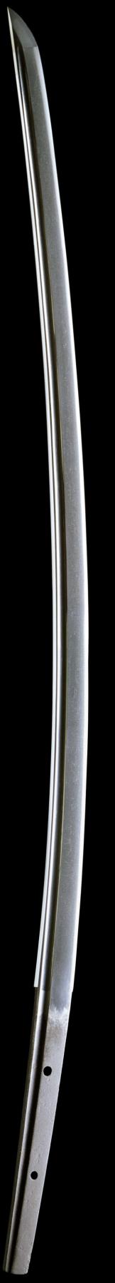

Jean Posted April 8, 2015 Report Posted April 8, 2015 Some have already the answer nagasa 70.0 cm, sori 2.4 cm, motohaba 2.8 cm, sakihaba 1.9 cm, kissaki-nagasa 3.1 cm, nakago-nagasa 20.0 cm, nakago-sori 0.1 cm. Den attribution, the sori is impressive, unsual utsuri. Kantei Sheet0001.pdfFetching info... Quote
pcfarrar Posted April 8, 2015 Report Posted April 8, 2015 On 4/8/2015 at 10:43 AM, Jean said: Some have already the answer The answer is in the file name of the images. 1 Quote
jensen6865 Posted April 8, 2015 Report Posted April 8, 2015 Hi, Beginners first guess- Enju. Since Hi ends lower perhaps after Kamakura or late? Don't have a real solid idea yet of what hotsure looks like. Please don't laugh, haven't been at this long, but I really like it, Dan Quote
Jean Posted April 8, 2015 Author Report Posted April 8, 2015 Thanks a lot to have dared to participate. Not bad guys, you are pretty good. I shall give the answer Friday, considering that other members would like to have a shot at it. It is not so easy for a few reasons I shall detail. It is not easy, even NBTHK conclusion are laconic and lack demonstration. :-) What would be educational is that both of you give your reasonning. I expect: Period? School? Smith? Quote
jensen6865 Posted April 9, 2015 Report Posted April 9, 2015 Okay, Here goes, I really think Jean is just making me look like the amateur I really am!!! Not really, I think this way of learning is way, way better than just looking, looking and reading! At least I have learned more! Sugata-looks more Tori-zori than Koshi-zori-at least with some smiths later in Kamakura or on, Not huge, wide or thin and no long Kissiki of Nambokucho. Sori-almost an inch- early blade. Motohaba is only 2.8cm, pretty narrow for Nambokucho, some narrowing up the blade, Suraige- at least from meks are quite a ways apart- first position one handed of Muromachi? Don't think so to me- doesn't feel heavy or thick enough. Nagasa still 70 cm. Pretty long. Bohi- down from some I've seen, made when need some space/length to sharpen kissiki. Later kamakura at least? Hamon-continues nicely all the way up and around the kissiki, boshi-not late when some midari-komi? Nie- early, nice even suguha hamon. Hada- looks very even and well forged, no Chikei listed, steel doesn't look bright and shiny as late more modern steels. Period- Late Kamakura? School-I was more bold at first- kind of felt like Enju-now... it doesn't seem to all fit.... Smith- I don't have a clue. Feeling like I need to look and read and engage in this a lot, lot more, Dan Please be hard and bluntly direct so I may learn! Quote

Toryu2020 Posted April 9, 2015 Report Posted April 9, 2015 Late Kamakura period Yamato Den - Shikkake school Shodai Norinaga Quote

Jussi Ekholm Posted April 9, 2015 Report Posted April 9, 2015 I'm going to go with Period: Late Kamakura - Early Nanbokucho School: Yamato - Tegai Smith: Kane X (not skilled enough to differentiate smiths) Quote
Jean Posted April 9, 2015 Author Report Posted April 9, 2015 You guys are very good, you are exactly at the level I am in front of this sword. Of course, you are all wrong. At kantei, I would have said Tegai, but there are two objections: no high shinogi (not easily visible on a sword unless strongly visible) and the ji nie is not so strong, you are very close. A hint, the smith made slender tachi and had masame in his hada. Answer, tomorrow. Quote

Ken-Hawaii Posted April 10, 2015 Report Posted April 10, 2015 Okay, let's try it another way, Jean. I hadn't noticed your kantei sheet, so thanks for that extra info. I do wish your photos were larger, though, mostly because I can't tell if the yakidashi goes past the machi. Utsuri is seen on Bizen & some Soshu blades, but since it's nie-deki, it's likely not Bizen. That's supported by the fact that it's torii-zori, although it still could be suriage, even if the photo makes it look ubu. The sugata looks Nambokucho to me, & probably early as it looks more graceful than other Nambokucho blades I've seen. Could this be a Rai? Ken Quote
wbt Posted April 11, 2015 Report Posted April 11, 2015 I think based on sugata, mix of itame and masame hada which appears to stand out, shirake utsuri (seen in some kunimune blades), suguha and nie hotsure. Also the the fact you said it wasn't obvious, but looks like a Yamato den product. nambokucho/early muromachi Uda nidai kunimune or 3rd gen. Long shot, but Uda is pretty generic. Regards Brent Quote
Kronos Posted April 11, 2015 Report Posted April 11, 2015 Time period: Late kamakura School: Rai Smith: Ryōkai Edit: Changed my answer to Ryokai, seems to fit better... Quote
Jean Posted April 12, 2015 Author Report Posted April 12, 2015 Atari James Not an easy Kantei as his swords are not often seen and above all becausee often his works can be mistaken to Yamato swords, A comment from NBTHK on a Ryokai sword:" in short, the jiba is not as bright and clear as we would expect it from a Rai work. So the tachi is a work of Ryokai who was a Yamashiro smith too. As mentionned, the jiba of for example Kunitoshi, Kunimitsu and other Rai smiths would be clearer and brighter, the nioiguchi would be wider and more nie and hataraki would appear within the ha." From this comment one can see that Ryokai is a smith apart in the Yamashiro Rai school. You will notice that he is the only smith in the Rai school not to be called Rai and he has not the kanji Kuni in his name, same for his lineage, his son Hisanobu and grandson Nobukuni. In fact Ryokai swords are either Yamato influenced or Rai oriented. Some of his swords are typically Yamato, high shinogi, masame... It is oversimplified to compare all his works to Rai Kunitoshi. Common point, they both have a mix of nie and masame combined and his work is presented as slightly inferior to sanji KunitoshiCompare to Yamato Tegai, Ryokai hada has very fine ko nie, sugata is slenderer and usually his daito have a strong torii sori. His hada is characterised by the mix of itame/ko itame and masame or itame nagare and a shirake utsuri, some fine chikei can be found. In the ha some ashi can appear and ko choji, hotsure. The nioiguchi is tight and somewhat subdued. Ryokai-juyo (1).pdfFetching info... Ryokai-juyo1 (2).pdfFetching info... Quote
Kronos Posted April 13, 2015 Report Posted April 13, 2015 I did have a post written about my reasoning as Jean requested but accidentally pressed the back button and lost it all. Suffice to say the Sugata is clearly Late Kamakura and could only really be either Yamato or Yamashiro with that hada so that narrows it down somewhat. It didn't seem like Yamato even with the masame as it lacks a high shinogi etc and I wouldn't expect masame just near the HA, but mixed in and more often near the mune. Just from looking at it it reminded me of Rai but i couldn't tell you why exactly, especially the Rai Kunimitsu on Darcy's site. After going round all the Yamato/Yamashiro schools of the time it didn't seem to fit in anywhere due to the lack of activity except Chu-Enju, however that would be too late for the Sugata and the Hada should be less refined. The Boshi is reminiscent of Rai Kunitoshi who was my first guess As Kunimitsu was a lot more flamboyant although with Kunitoshi you'd still expect Ashi, Sunagashi, Kinsuji,ko-chogi and so on as well as the shirakke utsuri and masame being wrong. So at this point I was floating round Rai or one of the offshoots like Enju and decided to look at Markus' Koto Kantei Zenshu and while browsing Yamashiro found Ryokai which was a perfect match. More subtle than Kunitoshi without all the activity in the Hamon, the slender sugata, shirake utsuri and masame near the ha, everything finally clicked into place. It took me about 2 hours and i doubt anyone else spent anywhere near that time so perseverance pays off This was a fun exercise and I learnt a lot about yamashiro which is probably my weakest gokaden so you should post more of these Jean if not make it a regular thing 1 Quote

Jean Posted April 13, 2015 Author Report Posted April 13, 2015 Kantei becomes very complicated when you deal with a Ryokai sword with high shinogi. Concerning masame along the hamon, Yamato schools have it too, you find it in Tegai. The Juyo zufu is very concise for the least in its conclusion: "This blade is ô-suriage mumei and came with an older attribution to Ryôkai and as it is hardened in suguha and shows a tendency towards masame in the ha, we agree with this attribution." That is probably the shortest Kantei analysis and reasonning I have read. Furthermore, the utsuri is described as shirake. In fact, when you look at the blade it is a midare utsuri which faded in shirake utsuri, itis probably why the attribution is "Den Ryokai". Quote
