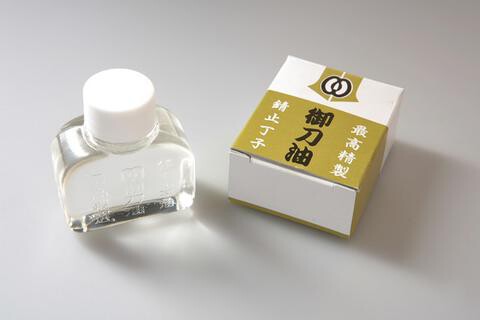

Dave R Posted September 21, 2018 Report Posted September 21, 2018 I play safe and use this one, ever since I saw a Japanese Nihonto dealers video of sword care, where this featured. Personal choice, and I have no complaints, but people have commented on the excellent, even and consistent coverage. https://www.fine-tools.com/pflege.html 1 Quote

Blazeaglory Posted October 22, 2018 Report Posted October 22, 2018 I love the smell of choji oil. First thing I do when I open a package from Japan is take a huge whiff... most of the time it's a lovely vintage smell with hints of choji and aged fabric/wood. I use the half round with flat bottom and white cap choji oil. 1 Quote

ROKUJURO Posted April 7, 2021 Report Posted April 7, 2021 We had this subject already a while ago. It is important to remember what properties we are looking for. It is not lubrication but protection against moisture and air/oxygen. This can be achieved by any liquid that forms an airtight layer. This has to be so thin that it remains almost invisible. Most natural (plant) oils have a tendency to oxidize earlier or later, that is they increase their viscosity as a result of polymerization. If you want to make a lacquer, that is a desired property, but for blades you want a material that keeps its very low viscosity, so it can creep into the finest crevisses of the HADA for protection. Mineral 'oil' is not really oil, but hydrocarbon made from rock oil/crude oil. Vaseline and liquid paraffin are similar products but have different viscosity (and molecular chain length). These materials have limited lubrication properties, but a tendency to gather in droplets (= surface tension), which is the opposite of what we need. Any additional (friction reducing) material like Teflon is of course useless on swords. A point to look at are the 'inspection intervals'. If you oil and clean your blade regularly related to your local climate, a vegetal oil like TSUBAKI (Camellia) will be absolutely fine as it will be removed long before it becomes rancid (= that is the polymerization process). Modern technical lubricant oils may have some desirable properties, but usually they have a lot of additives which could harm the metal or obstruct a clear vision of the HATARAKI and the HADA of a blade. I would not say all are bad, but this would have to be long-term tested. So as long as I have no better oil, I stay with Camellia. 2 Quote
vajo Posted April 7, 2021 Report Posted April 7, 2021 As for me i use camellia oil mixed with choji 5/1 for a little smelling of clove. Quote
