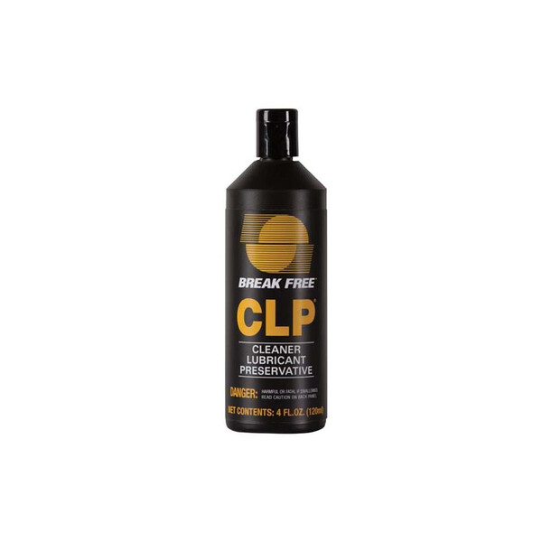

Breakfree CLP......
Smell = Average oil.
Consistency = Yellow, thick.
Protection = A
Overall = I used this stuff forever on my firearms, and it works well.  It has the cleaning aspect,  which worries me on my nihonto though, especially residue in the shirasaya.
$6 for 4 ounce bottle, at most stores.

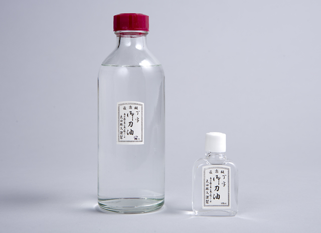

Ohota Katsuhisa Syouten Co Choji Oil ......
Smell = None
Consistency = Clear, medium sticky.
Protection = B-
Overall = Probably based on mineral oil.  Similar performance.  I've used this for a long time, and no complaints.
$20  for 18cc glass bottle, from Japanese dealer.

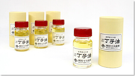

OHS Okamure Heibei Shoten Choji Oil.....
Smell = None
Consistency = Light yellow color, ligh medium sticky.
Protection = B
Overall = Probably based on camellia oil.  Similar performance.
$30  for 10cc glass bottle, from Japanese dealer.

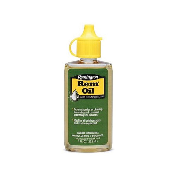

Rem Oil.....
Smell = None
Consistency = Clear, very light.
Protection = B+
Overall = Very good performer.  It is very light, and probably doesn't hold up well on firearms, which could explain why it is considered average in reviews.  But it goes on smoothly, with no color, or stickiness.  Cheap and sold everywhere.
$4  for 2 ounce bottle, in most sporting goods stores.

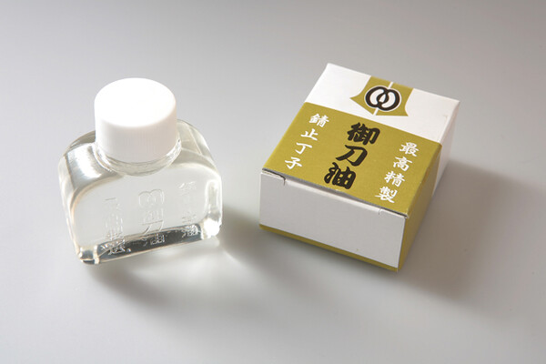

御刀油・最高精製錆止丁子油  Choji Oil....
Smell = None
Protection = B+
Overall = Reminds me of Rem oil, actually.....   The little glass bottle looks nice, but the top is just an open hole, which makes applying it a bit messy.  Really nice stuff.
$20  for 20cc glass bottle, from Japanese dealer.

Sorry for bringing up this old thread but I do have a question.
First of all, this is an excellent thread! Thanky ou very much for the great work you have done.
After reading everything and giving it some thought I decided that Rem Oil loosk to be my favorable product.
However I read on its bottle that it contains Teflon Lubricant
Teflon = Plastic.
Any thoughts on this?
Thank you
Looking for it, I cam also up with this product:
https://www.ebay.com/itm/Remington-REM-OIL-with-TEFLON-LUBRICANT-Gun-Care-HQ-CLEANS-LUBRICATES-PROTECTS/222705356440?epid=2254777676&hash=item33da460e98:g:FA0AAOSwPHxbCJC6
It says it contains cleaning chemicals. That seems to be Petroleum Destilates. So same thing as in Neverdull whoch I have found to be safe and good on swords. But I can not comment on the other indigrents?
This makes me think twice.
The last one claims to be choji oil, Luis, which is really an inorganic oil with a bit of choji "flavoring."
What do you want to know about the Remington oil? I'm a bit surprised that petroleum distillates are listed before lubricating oil, as the distillates will evaporate quickly, compared to the oil, & so shouldn't be the major ingredient.
