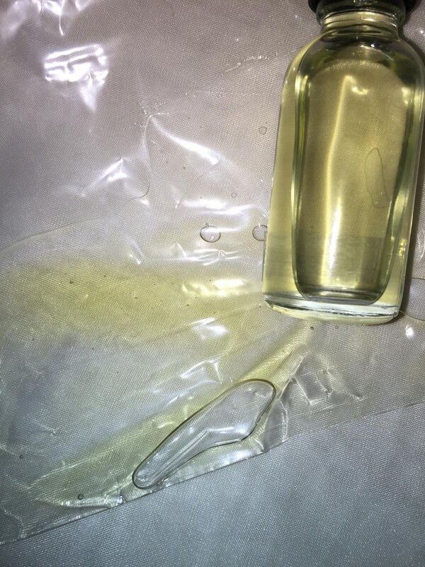

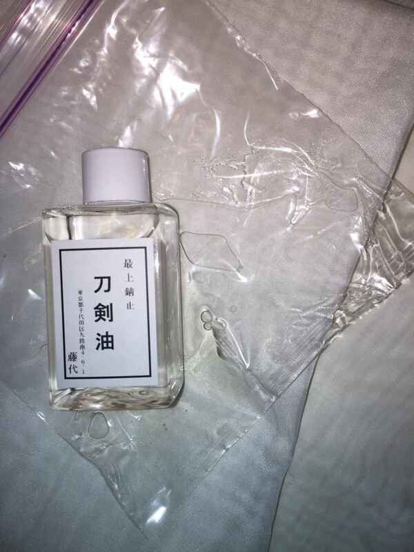

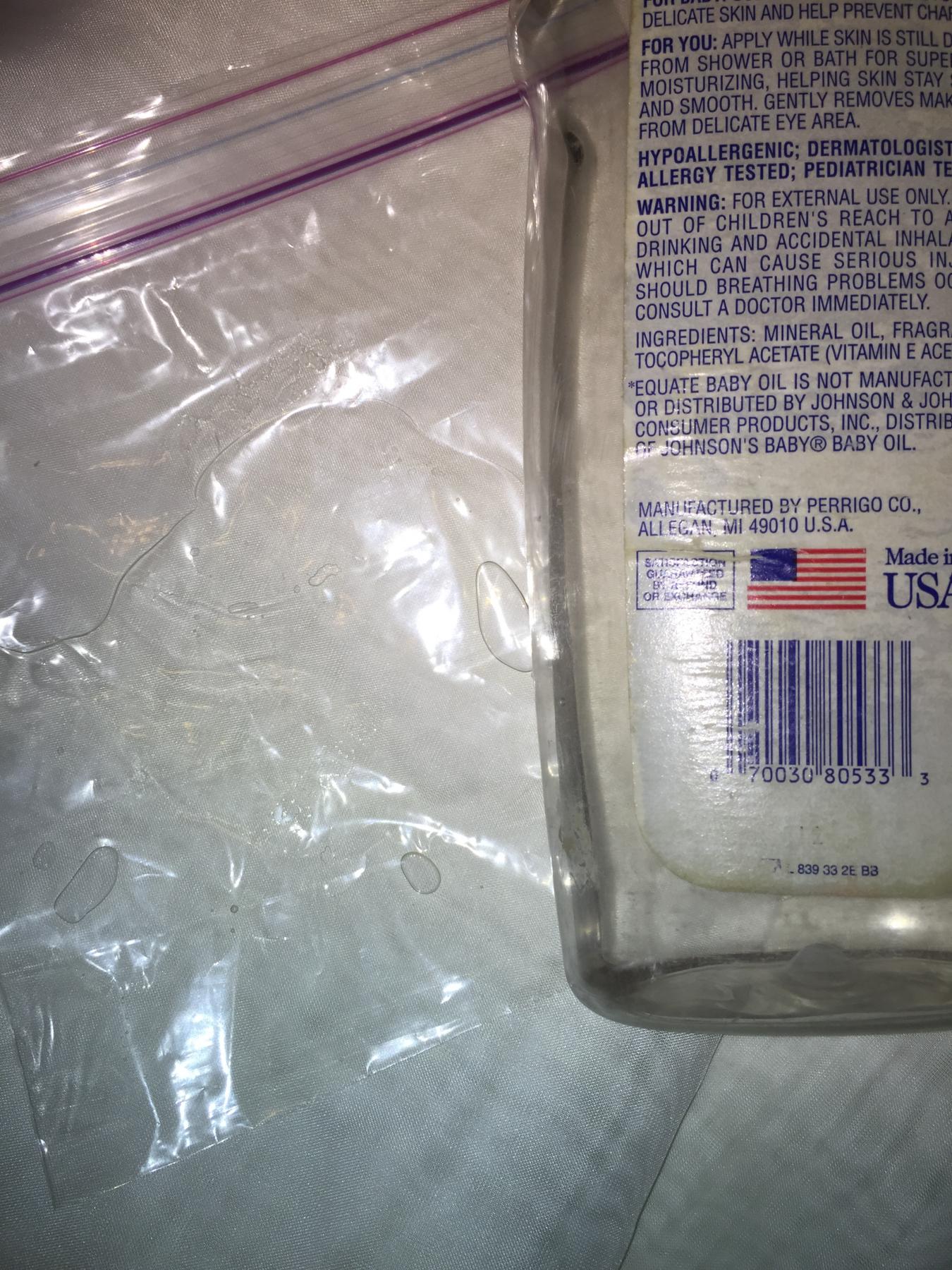

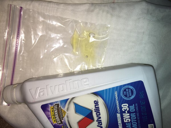

These are the pictures of the new oils:
Fujishiro Oil, Mineral oil, and choji oil are clear and no smell.
Camillia oil is slight yellow, and has very light organic smell.
OHS choji oil is light yellow, no smell.
WD40 clear, definite odor.
Motor oil is thick, yellow, strong odor.

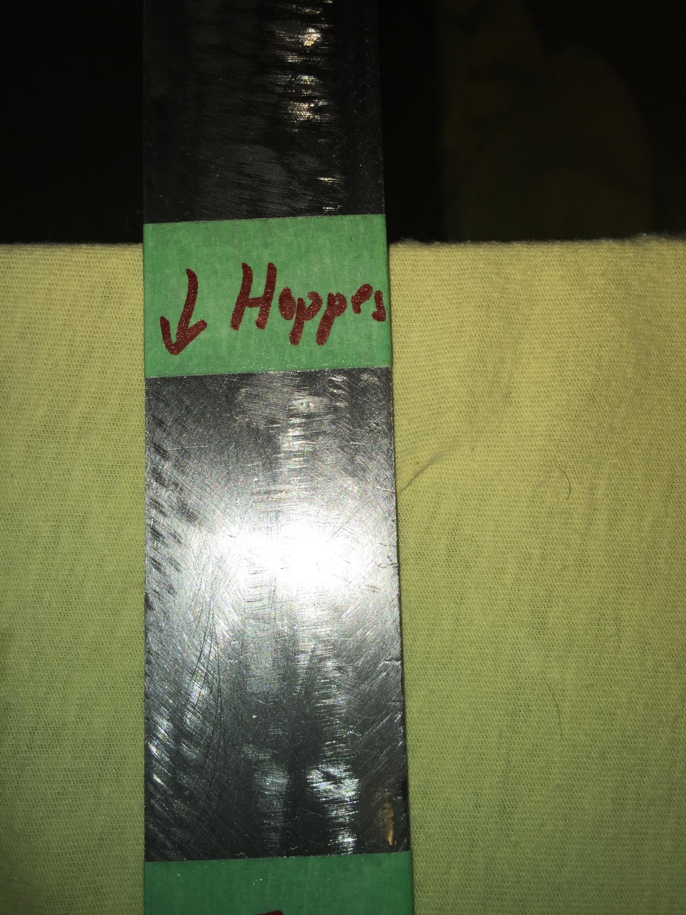

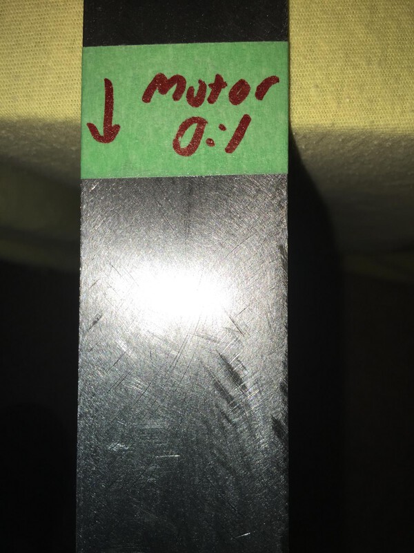

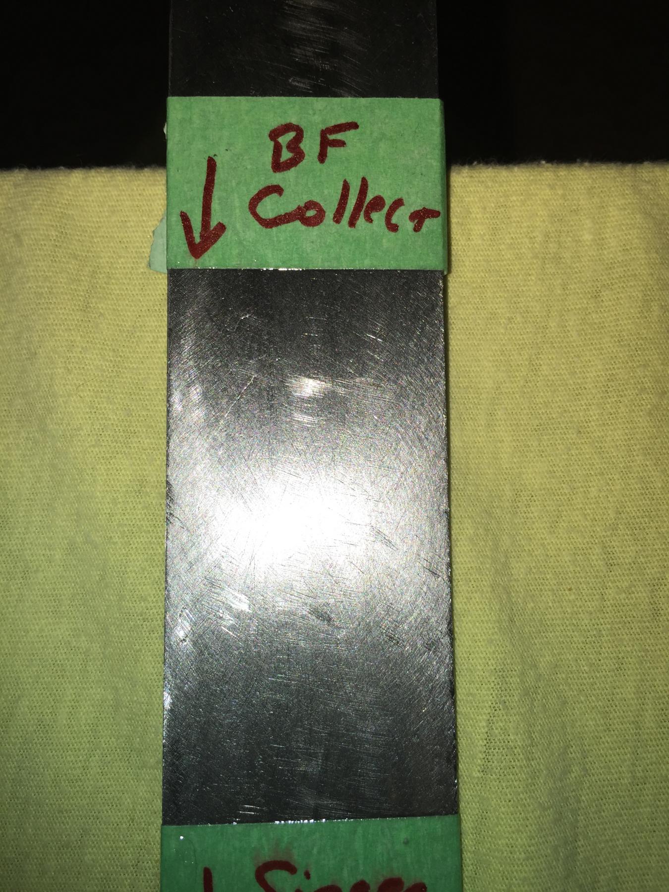

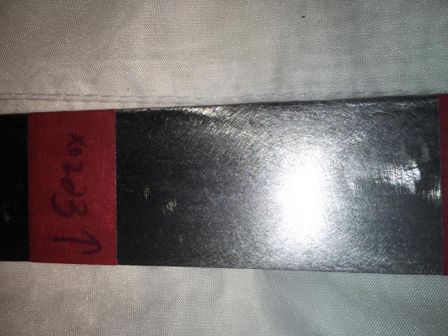

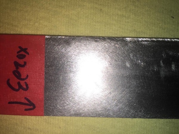

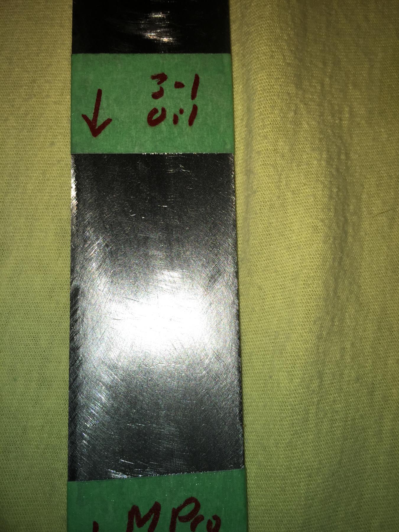

I developed a test based on these ideas, but focused more on nihonto.  I used two identical pieces of mild steel.  36” long by 2” wide.  I separated the steel pieces into 9 equal sections, using 1” tape.  I thoroughly ground down, sanded, and cleaned the steel, then treated each section with a different type of oil.  I left one section unoiled as a control.
 After liberally applying the oil, I wiped off any excess with a new cloth.  I then set aside the steel for 10 minutes.
I created a saline solution of 1%, which is similar to sweat, blood, and spit, any of which may end up on our swords.  I applied saline solution to each section, then wiped it with my bare thumb.  All of this was to simulate a situation where someone touches the bare blade.
I then left the steel inside on a table to measure rust.
I also put a sample of each oil into a zip-lock bag to judge color and smell.
Finally, I treated separate knives with oil, let them dry, then touched each one to judge stickiness.

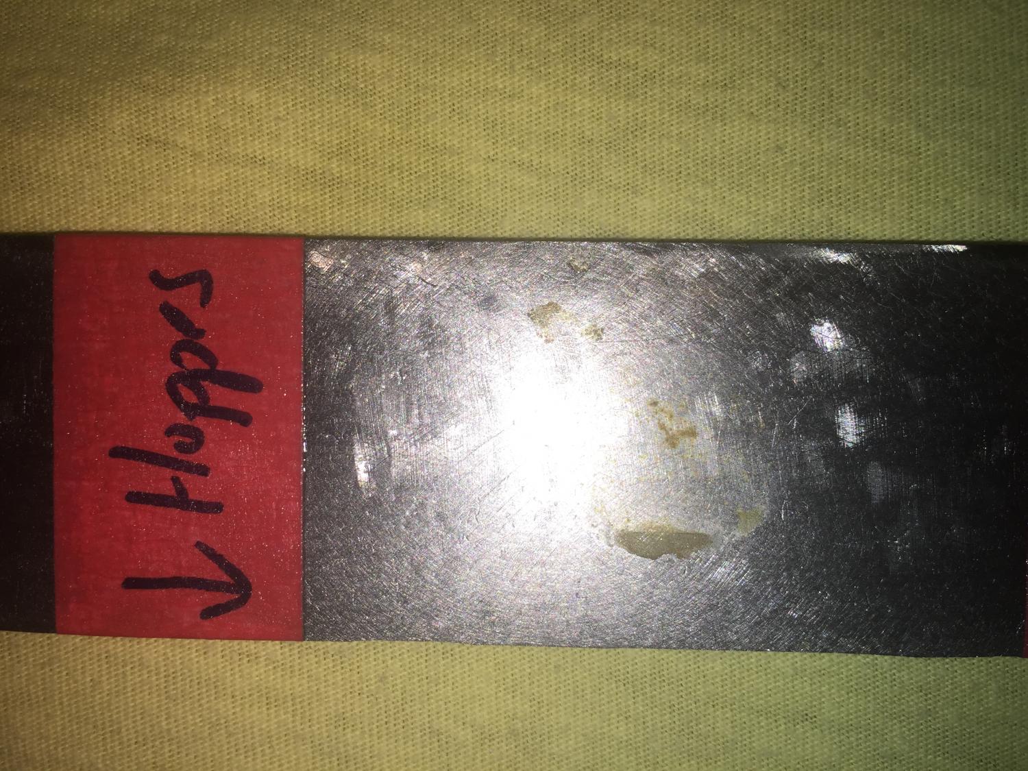

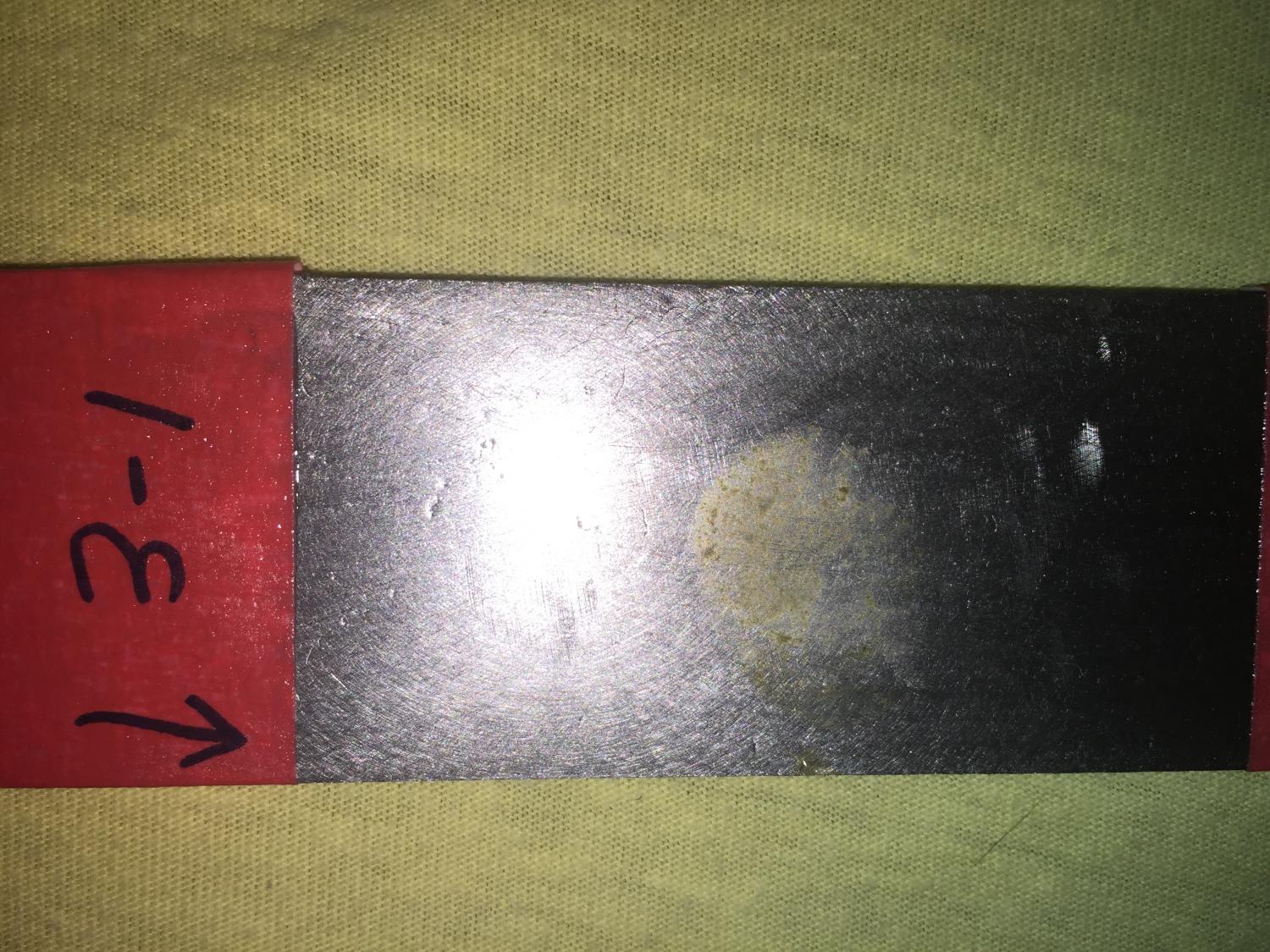

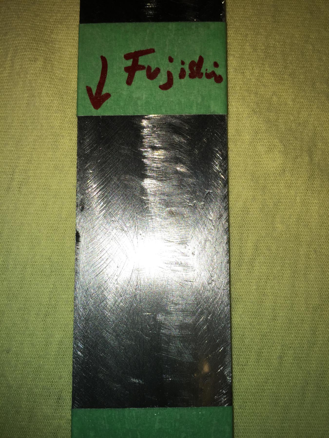

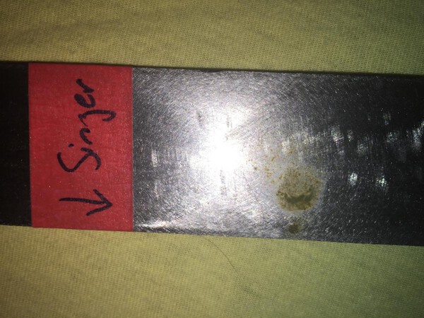

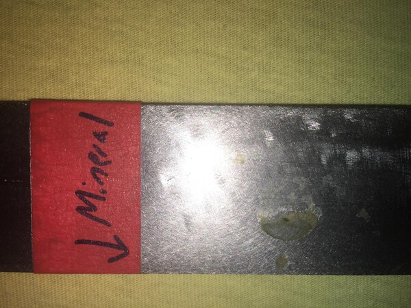

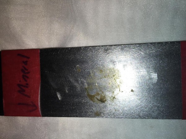

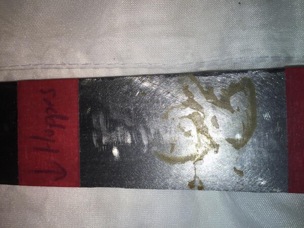

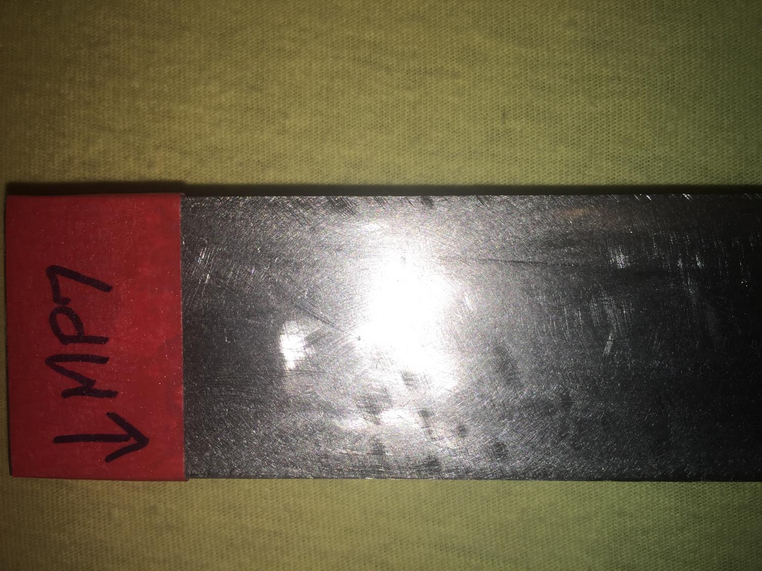

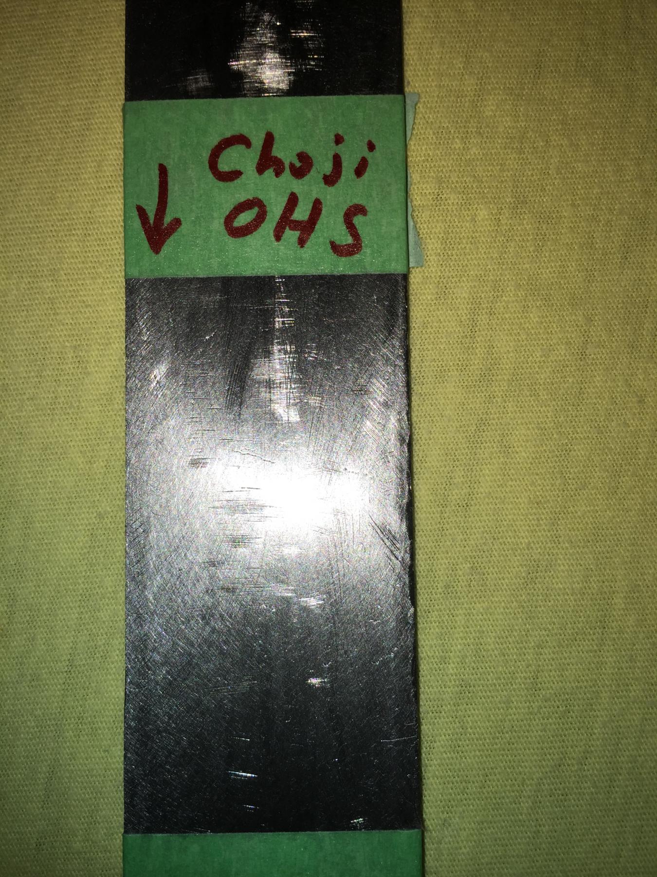

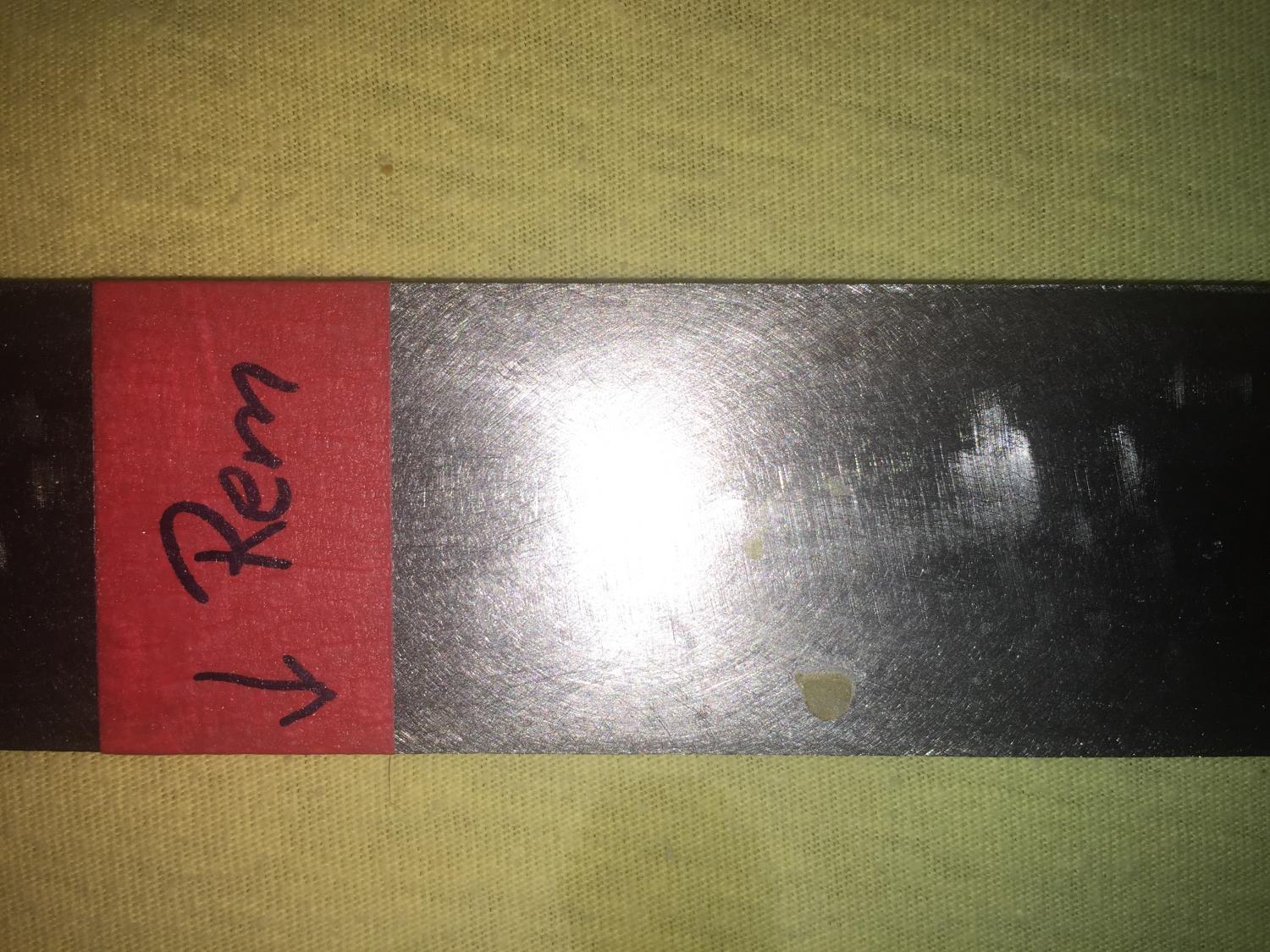

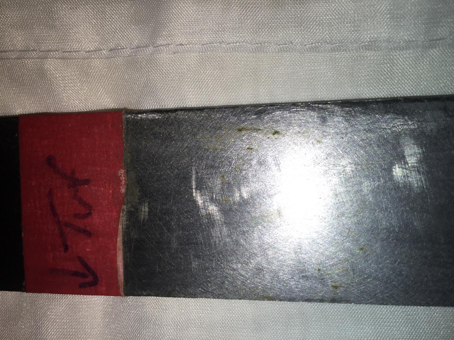

So, at 12 hours, these are my observations:

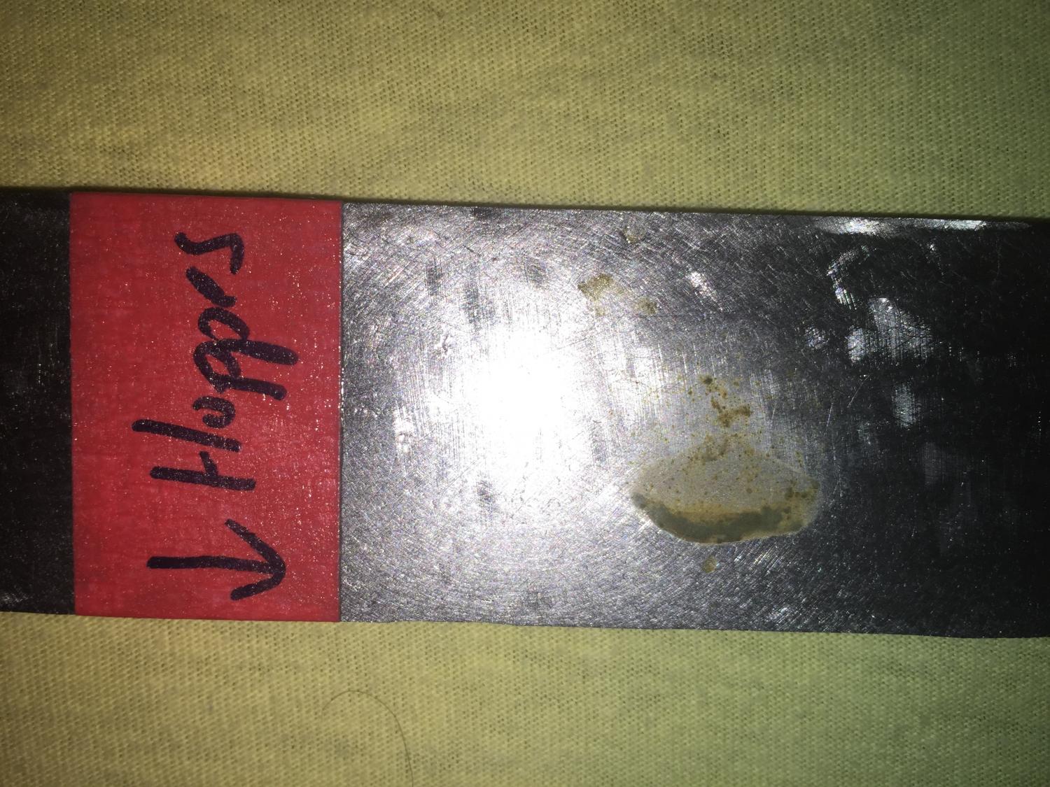

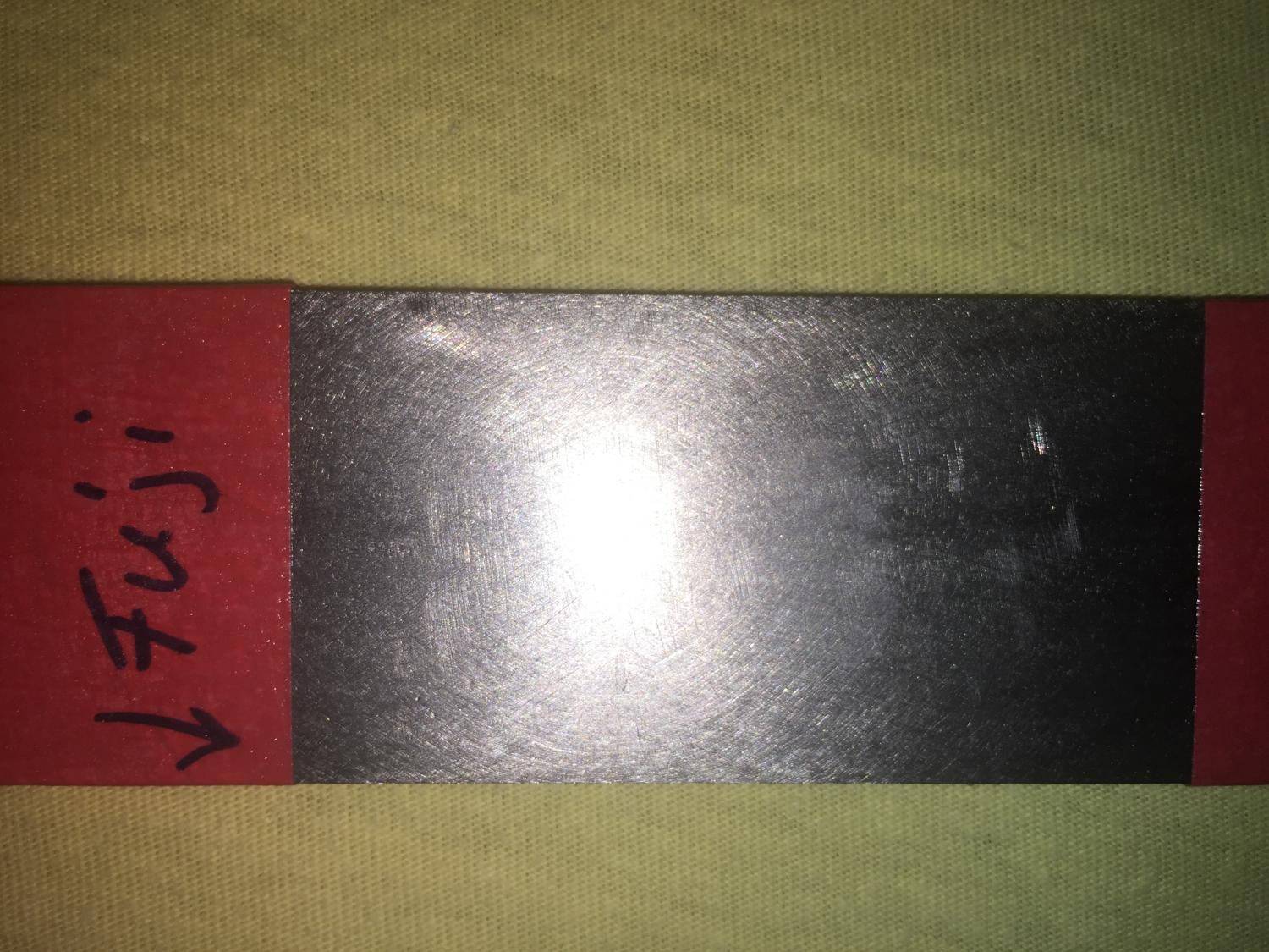

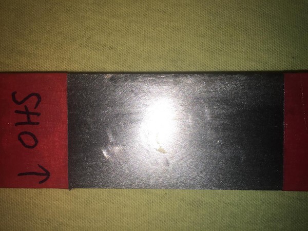

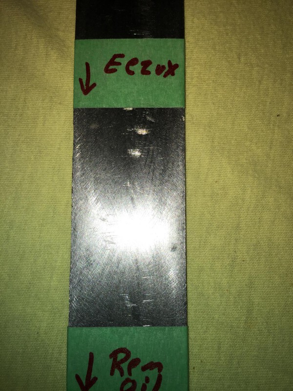

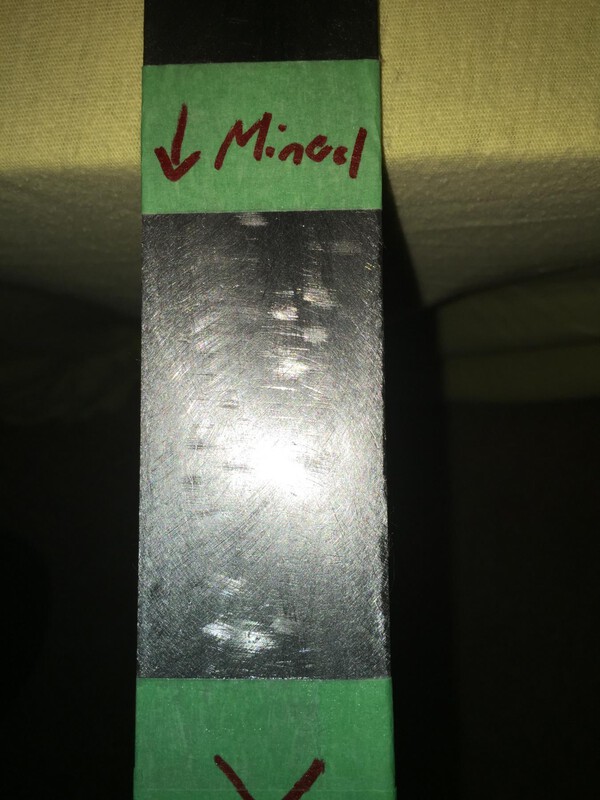

No change:  Breakfree CLP, Tuf-glide, MPro7, Breakfree Collector, Fujishiro Oil, WD40, Eezox
Very light discoloration:  Camillia Oil, 3 in 1, Rem Oil, and OHS Choji Oil
Light discoloration : Mineral Oil, OKS Choji Oil, Motor Oil, Hoppes, Singer, 御刀油 Choji Oil

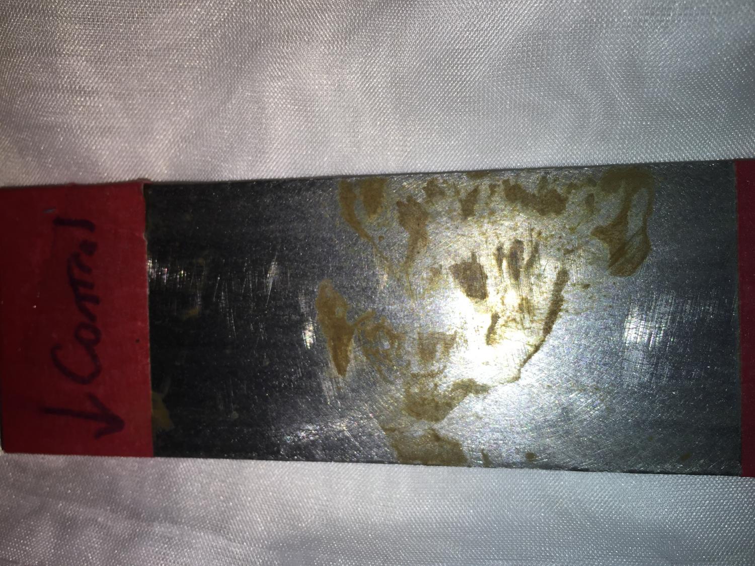

Dark discoloration: Control
Next check at 24 hrs.....
OHS Choji and Camilia oil look very similar perhaps not surprising they perform the same but we will see. Fujishiro also sells a yellow oil variety but it is rated not as good as their Jo quality and they might have dropped it.
I'm a bit surprise with OKS Choji, I believe it is actually odourless mineral, same oil is rebranded and stocked by one of the most prestigious sword dealer in Tokyo but I haven't used it long enough.
I think Fujishiro san would be very pleased if the 12 hours do confirm overall result. Personally I think Breakfree, Eezox, WD40, although excellent rust preventer has side effect that may make it unsuitable for Japanese sword.
Wah

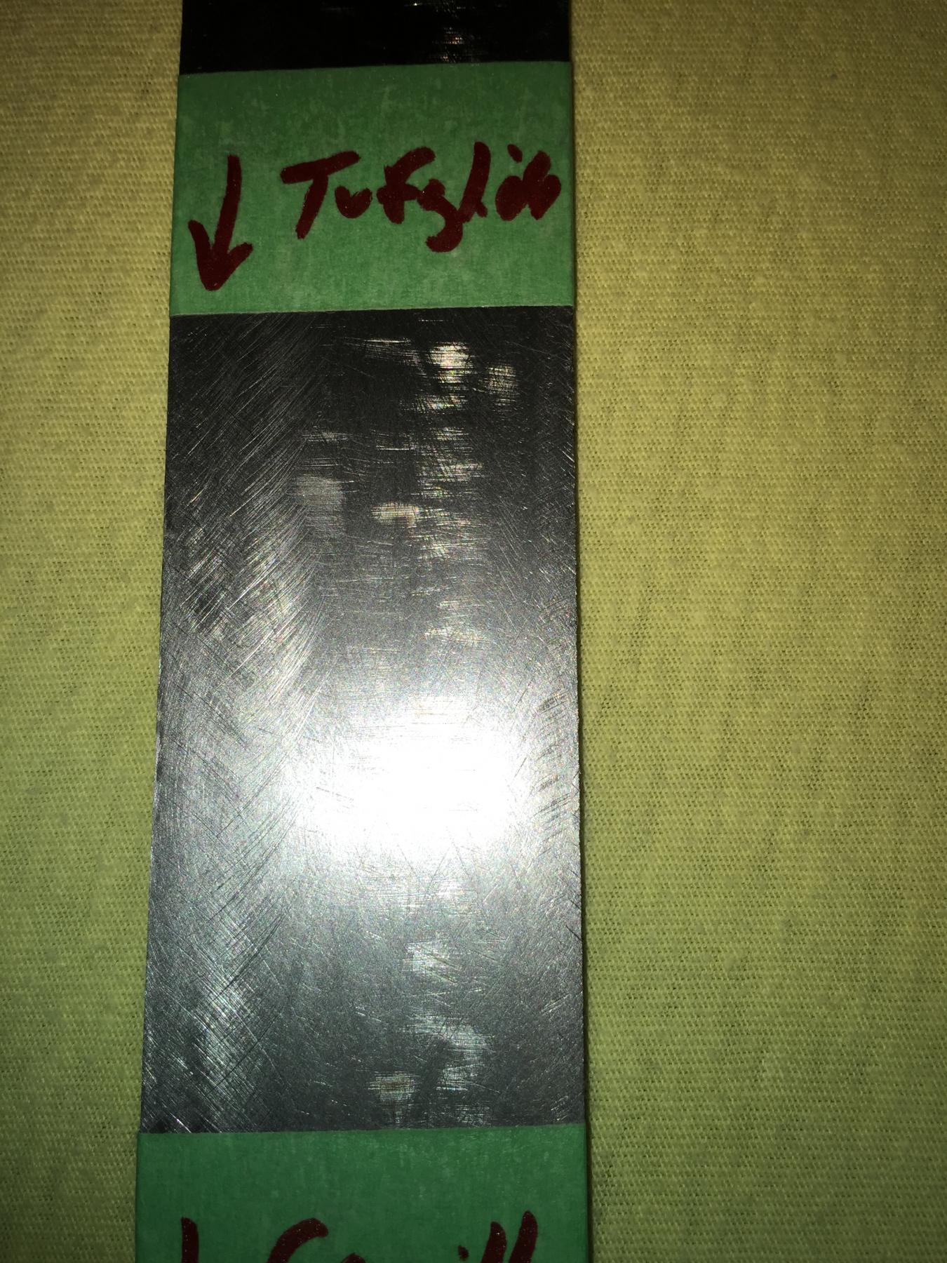

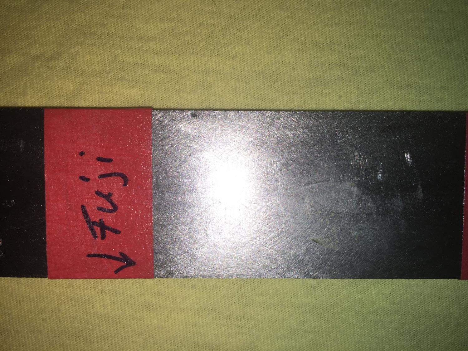

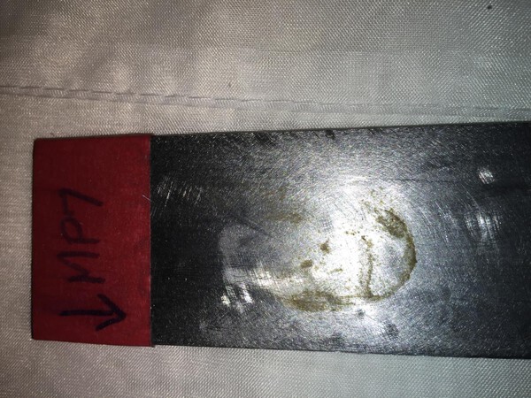

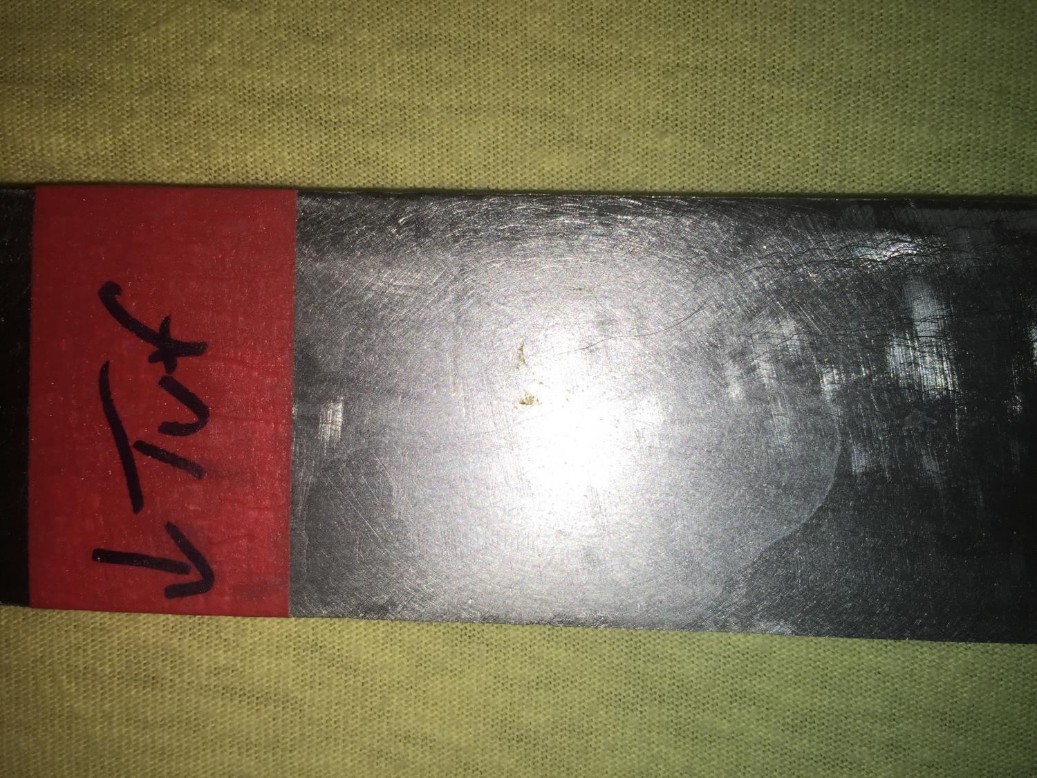

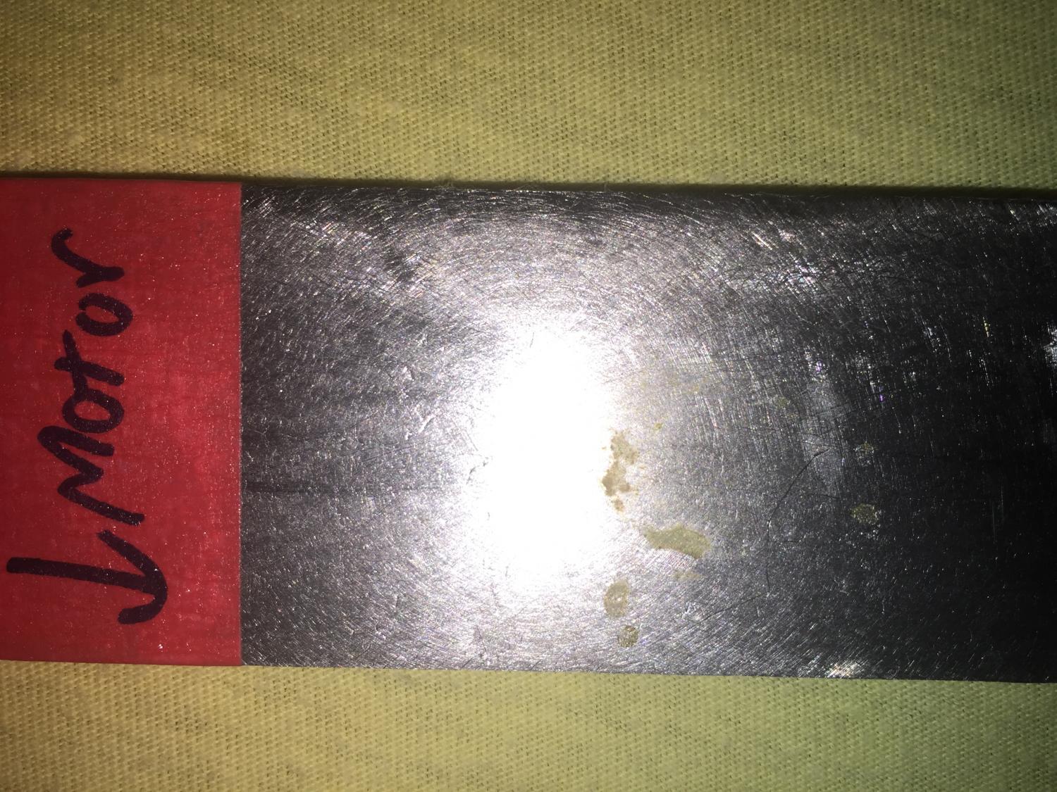

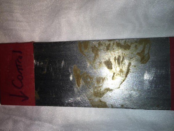

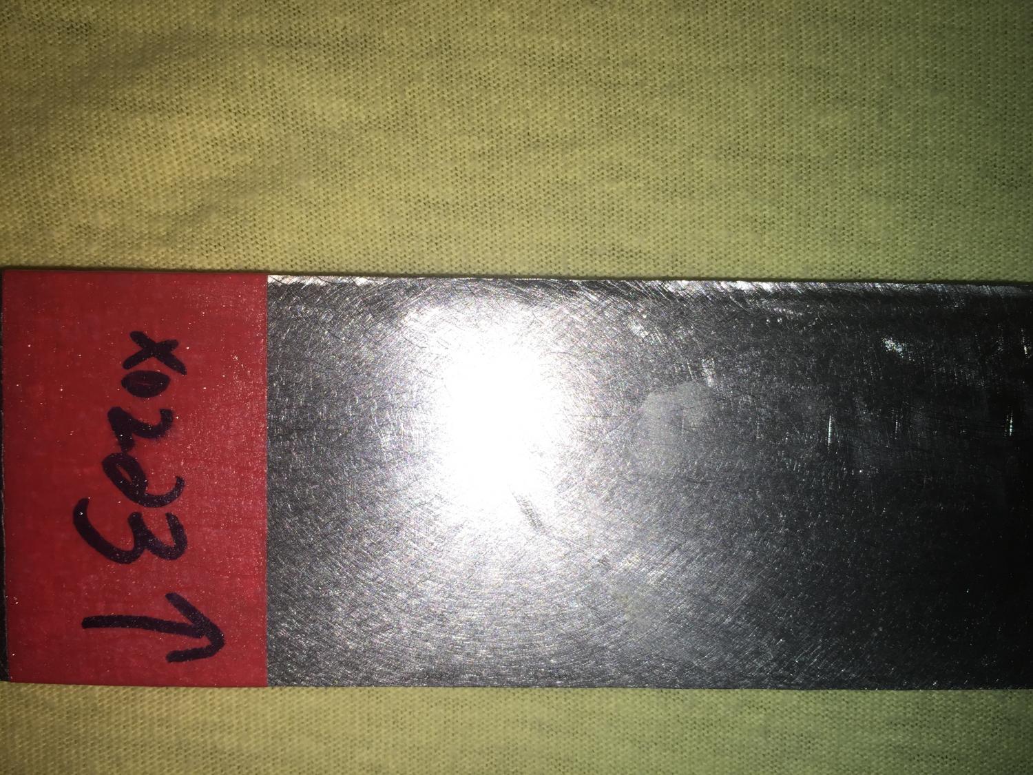

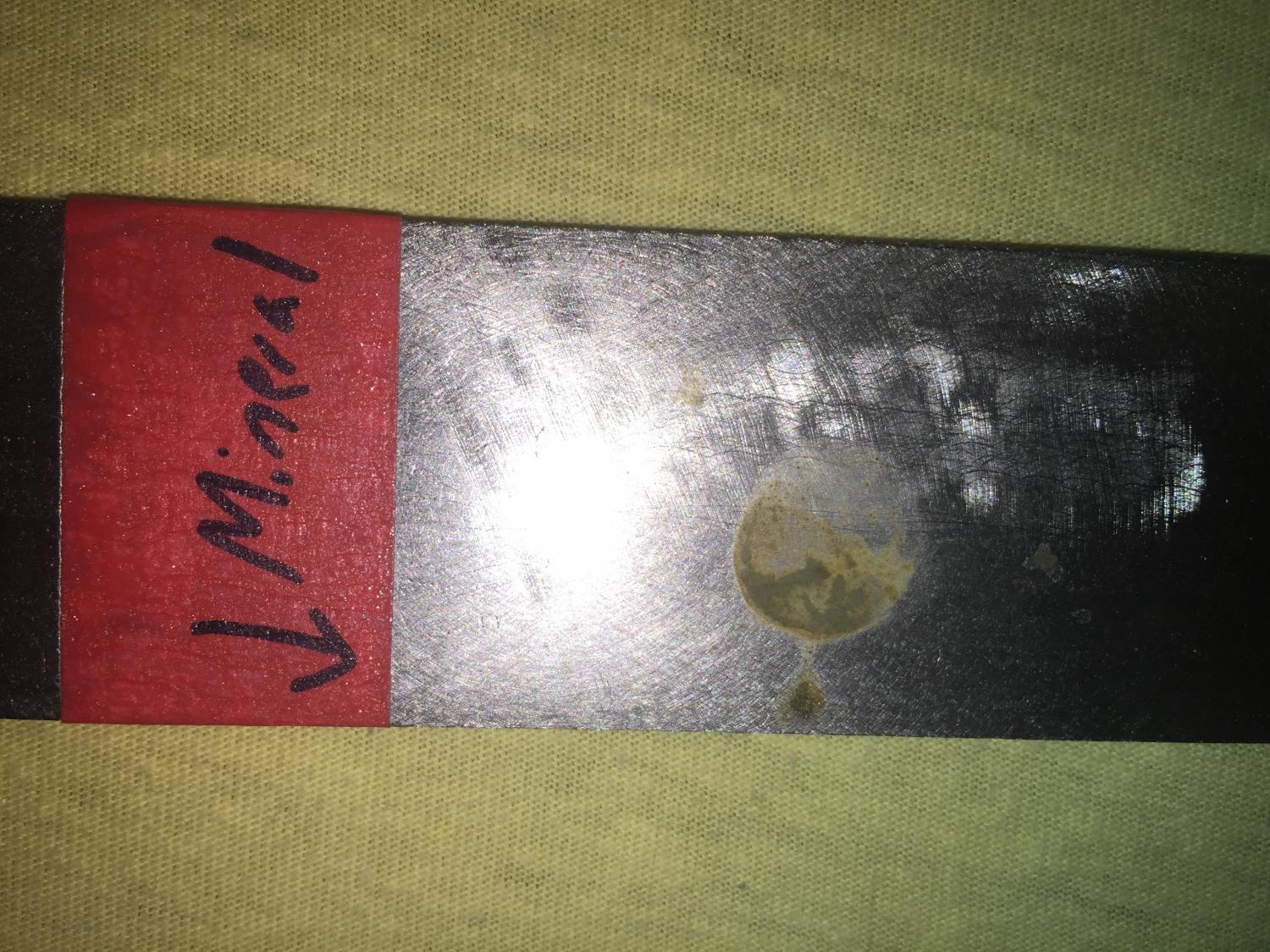

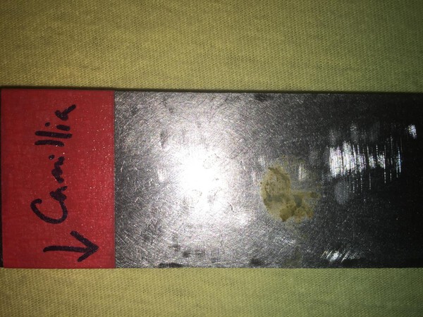

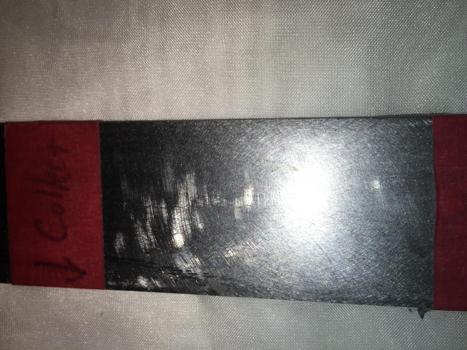

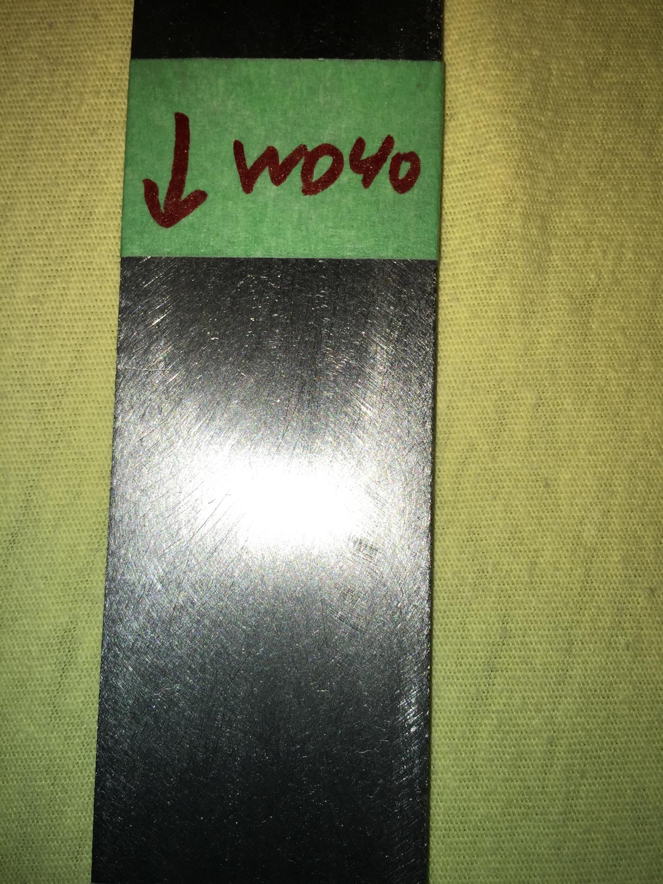

At 24 hours, these are my observations:
Breakfree Collector, CLP, Eezox,and Fujishiro oil show no change.
WD40, Tuf Glide, and OHS Choji oil show a very slight discoloration.
MPro 7, Camillia, OKS Choji, Rem Oil, 3-1, and Choji oil all have light, but clear discoloration.
Hoppes, Motor oil, Singer machine oil, and Mineral oil all display medium to dark discoloration.
The control area has rust.
Honestly I'm surprised WD40 worked as well as it has - it doesn't have a great reputation in the firearms world.  I mostly use Breakfree CLP, Boesheild, and Ren Wax which have all worked great - but on firearms only.

Motor Oil......
Smell = Very bad.
Consistency = Thick amber color.
Protection = D
Overall = Very poor performer.  I used this mostly as a base line, as everyone is familiar with this stuff.  (I used Valvoline, if it makes any difference....)

Hoppes......
Smell = None.
Consistency = Very light yellow, thin, average stickiness.
Protection = C
Overall = seemed ok, not a lot of protection.
$6 for 4 ounce bottle, at most stores.

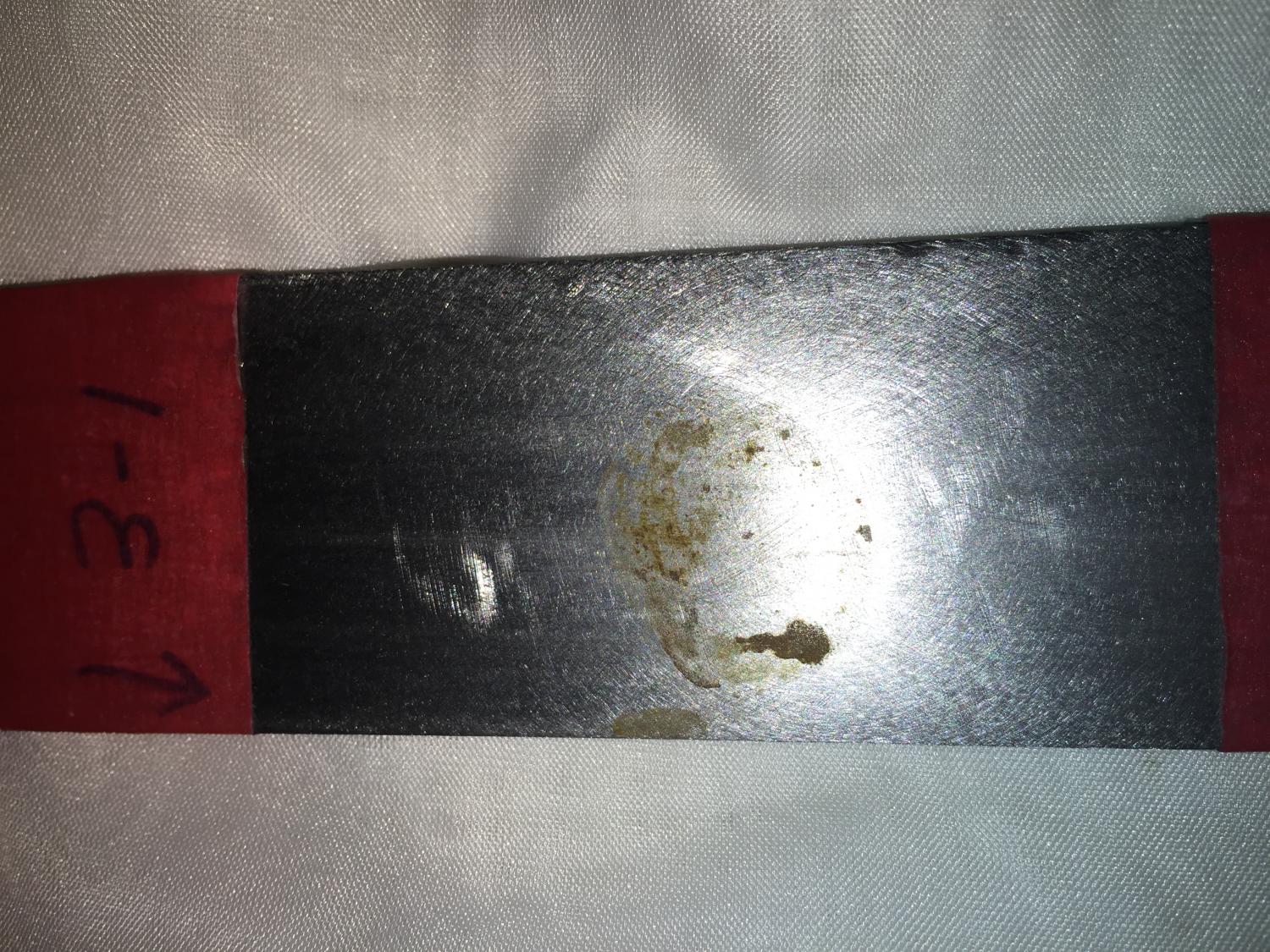

3 in 1 oil......
Smell = Not as bad as motor oil, but almost.
Consistency = Thick, sticky.
Protection = C+
Overall =  Also an ok performer, but odor and stickiness
would keep me away.
$4 for 3 ounce bottle, at home improvement store.
M Pro 7......
Smell = None.
Consistency = Cloudy, looks like melted butter.
Protection = B-
Overall = .  Goes on thick and cloudy, but seems ok after.  Medium stickiness.
$9 for 4 ounce bottle, at sporting goods stores.
Singer Sewing Machine Oil......
Smell = None.
Consistency = Clear, very light oil.
Protection = C+
Overall =  Goes on easy, not sticky, basic protection.
$4 for 4 ounce bottle, at Walmart.
Tuf Glide......
Smell = Like plastic and oil.  Not bad, but noticeable
Consistency = Brown, like soy sauce.  Goes on thin.
Protection = B
Overall = Protection is good, but seems to leave residue.  Messy application.
$15 for 1 ounce can, on ebay.
