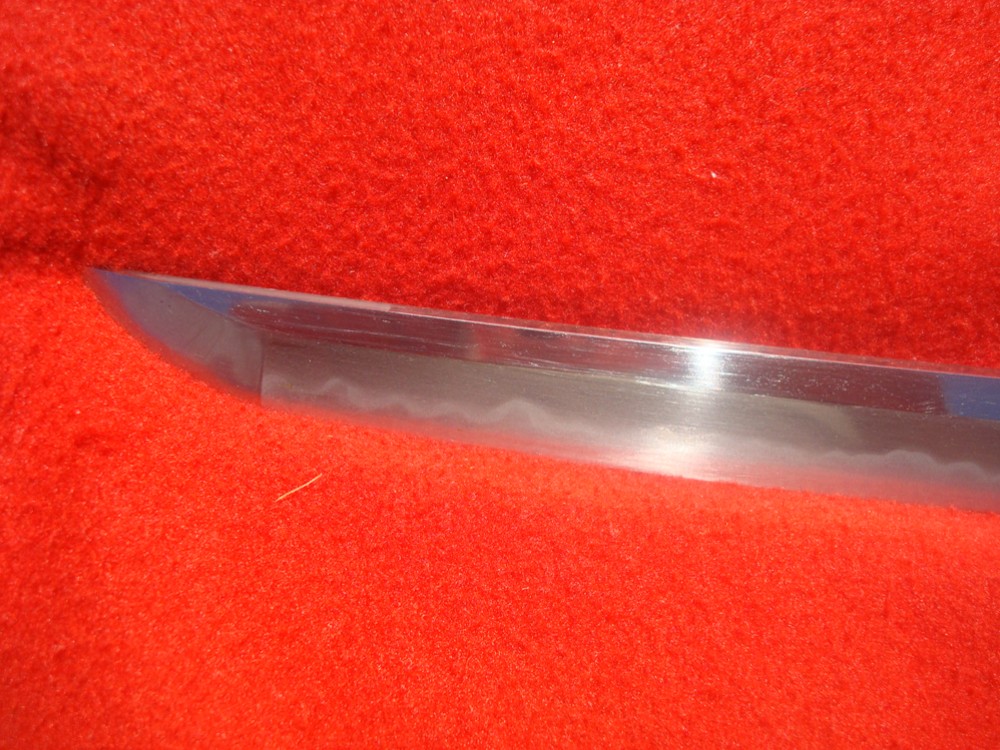

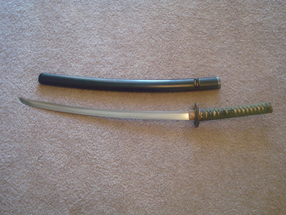

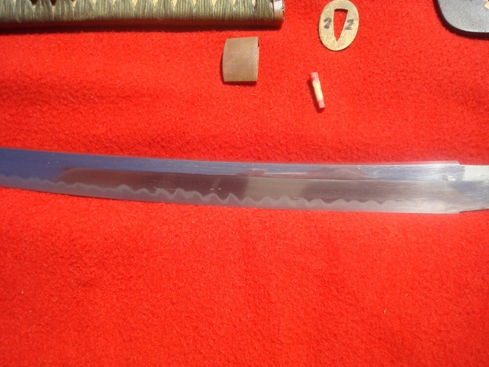

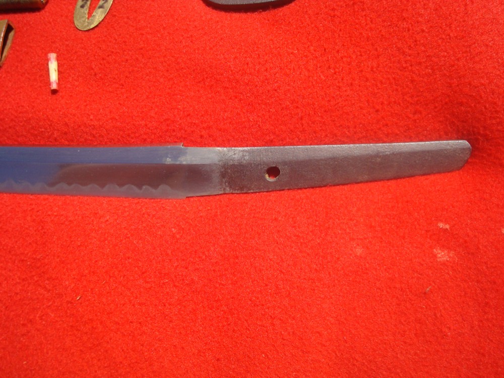

Hello everyone my name is Mike Miller and I am into meteorites. I hunt them, I also cut and etch them for a living. I am in Kinmgan AZ and have always been facinated with Japanese swords. Although I must admit I have learned very little about them. I will include some pictures and hopefully someone here can tell me something about my sword. About all I was told was it was made in the mid 1800's and it is a Samurai sword. I apreciate any help you can give and I am not selling it, but it could become nesecary if business does not pick up pretty soon.
I think Stephen is right. The piece I think is middle period Muromachi, Mino, probably something related to the Kanesada line. It was shortened towards the end of the Muromachi period, and a new nakago jiri done for it. If it were kiri then it would have been shortened later.
It might have had a large chip from fighting, and the only way to save the sword was to shorten it for wakizashi use. The nakago does not look like a normal one made for the sword in later times.

Muromachi period is 1392-1572. There were both good and lesser mass-produced swords during that time. Towards the end, they were many wars and therefore swords were produced faster and with less care. But there are also fine swords made during that time.
Mino is the province and hence style/school of tradition that possibly made this sword based on its characteristics.
The sword was probably originally longer and shortened from the back as was common when tastes, styles and preferences changed. Also done if there was damage and it needed to be saved.
The end of the tang shape where it was cut off is the nakago jiri. The shape indicates what Darcy was pointing out. A straight cut is kiri, while yours indicates earlier shortening with its shape.

Edit to add: Darcy:- If this is o-suriage (shortened) then wouldn't we expect to see the hamon continue with the gunome (bumps) through the machi area, instead of the yakidashi that appears to be there currently?
