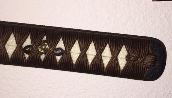

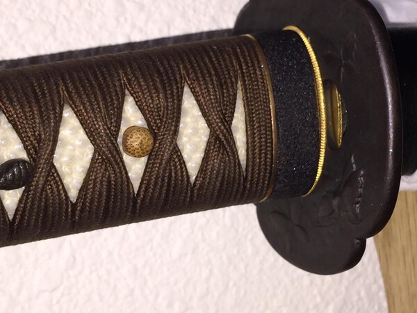

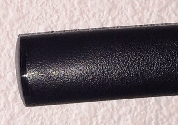

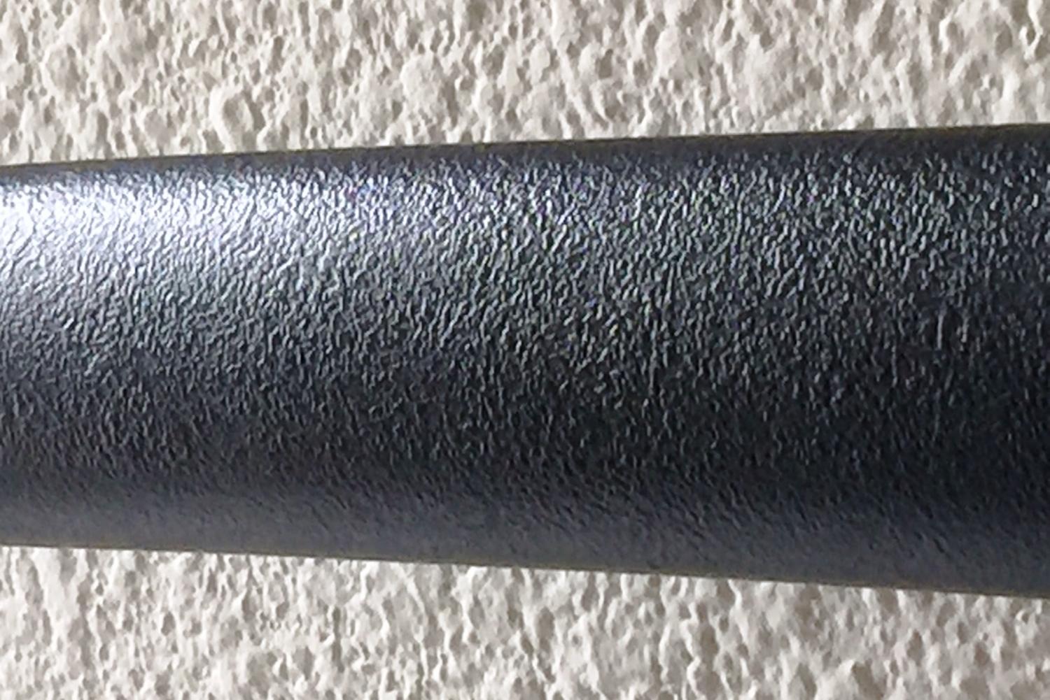

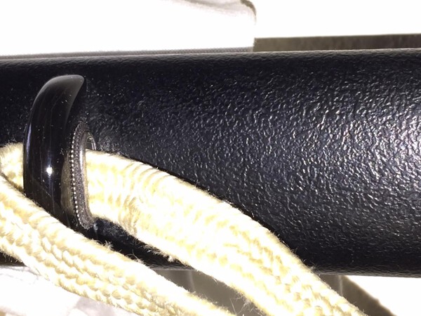

CurtisR Posted March 24, 2015 Report Share Posted March 24, 2015 Although it's taken a while, I received the koshirae for my Aikihiro katana made by Hans Koga in Chiba, Japan. I provided the f/k and tsuba as well as the hibaki and he made the rest. IMHO, it came out very beautifully and feels amazing. The saya is done by hand in ishimeji (wood grain or like tree bark) pattern, and the horn koiguchi and kojiri both shaped and fitted, and the tsuka done with a full-wrap same and new shitaji cut and shaped. The ito is mid-grade silk. I'm not forcing the blade in and am letting all of the parts "get to know each other", but the fit really nicely! Also included were hand-sewn bags for shirasaya and koshirae from old, very pretty kimono obi. I can say that dealing with this was a bit of a process, having not sent the blade to Japan but he nailed it for fit and was a true pleasure to deal with. Curtis R. Link to comment Share on other sites More sharing options...
cabowen Posted March 25, 2015 Report Share Posted March 25, 2015 Does the seppa occlude part of the hitsu-ana? Link to comment Share on other sites More sharing options...

Guido Posted March 25, 2015 Report Share Posted March 25, 2015 Sorry for being a party pooper, but I, too, think that the tsuba is a little to small, looks like wakizashi size. It might be difficult - but certainly not impossible - to find a larger one with the same thickness. Plugging the hitsu-ana is another option, but probably not a good investment. I also don't think the blade will somehow fit into the saya magically after the parts "got to know each other". If the habaki fits into the saya without the sword, the inside of the saya has to be reworked. Not an easy task. I don't know Mr. Koga, but if I was a koshirae-shi, I would think long and hard about accepting a job like this without the blade in hand to properly fit the koshirae; it's a hit or miss situation, and can easly do harm to one's reputation. Ishime, btw, means stone surface. 2 Link to comment Share on other sites More sharing options...

CurtisR Posted March 25, 2015 Author Report Share Posted March 25, 2015 Chris, the seppa cover a bit of the hitsuana...it's gendai and is actually larger than it looks, as is the tsuba - it's very nce construction from iron, and although I haven't cut down the seppa, it still has a nice feel. I agree that I should probably fit the seppa properly. For Guido and Steve, correct - I did not send the blade to Japan - the wood for the saya was sent to a wood craftsman here in the US (who I DID send the blade to), who cut the space for nakago and the dimensions and fit for the blade in the saya. Might seem like a bit of a long process but it was much easier than sending the blade to Japan! And Chris is absolutely right...it's the change in humidity that it's adjusting to - it will of course fit flush now but needs a bit of time to have the RIGHT fit to be drawn smoothly, yet not to rattle or be loose at koiguchi. It'll be just right very soon. And Ken, yes - it was very easy customs-wise to send back and forth...as long as there's no blade. Oh - forgot to mebntion that he also carved a woodent "insert blade" (can't recall the term) for the hoshirae which kept everything connected during shipping. One very important part of the process is to have the Tsuka and saya fitted very well before traveling on to Japan for finish. I was a little hesitant/skeptical also, but the proof is in the holding and examination . I can tell you that after using chinese blades for Iai, I wouldn't hesitate to use this sword --- not for tamishigiri of sourse but for kata, certainly! Mr. Koga can be found on facebook under "koga-bijutsu". Curtis R. Link to comment Share on other sites More sharing options...

Jamie Posted March 26, 2015 Report Share Posted March 26, 2015 Curtis, Tsunagi is the term for the wooden blade keeping the koshirae together. Link to comment Share on other sites More sharing options...

CurtisR Posted March 29, 2015 Author Report Share Posted March 29, 2015 I re-examined the seppa and it is only perhaps 2mm larger than it should be Alex - and thank you for the warning. The seppa - also - is only slightly larger on one hitsuana, and not both, which should make fitting it a snap. Yes Jamie - that's it!! When I was writing the post I couldn't recall for the life of me. I will attach a photo alter this evening, as well as a few more photos. As for the price of the entire koshirae, SAS ~~~ it was not inexpensive but absolutely worth it. To be polite in my answer (value is different to each is my point here...) I will say it was less than half of the price I pair for the blade itself, which was a bargain to begin with. IMHO, with a beautiful koshirae the monetary value of the blade goes up from my understanding. I will also confess that Koga-san has an amazing eye for balance, history and beauty and made several suggestions/improvements that I'd NEVER have thought of. And he was correct :) . I can elaborate if you'd like, but I can assure you it wasn't to "up-sell". Curtis R. Link to comment Share on other sites More sharing options...

Koga Hansuke Posted March 30, 2015 Report Share Posted March 30, 2015 Guido Schiller. No such thing as a party pooper. Ishimeji would be the most correct way to say stone pattern in Japanese, but Ishime is sometimes used. ( not wrong ) Both of them are right but Ishimeji (石目地) would be more thural refering to ground pattern like stone. Sincerly Koga Link to comment Share on other sites More sharing options...
