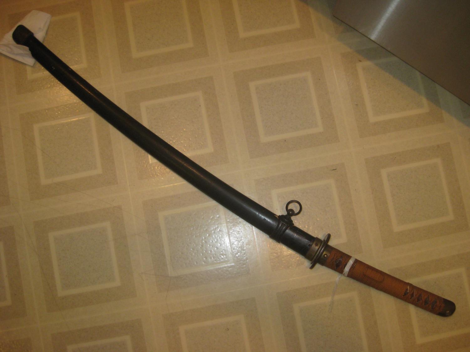

I've had this Late-'44 (Type 3?) shin gunto for a number of years, thought I'd perhaps share a looksee here and solicit opinions on some whys and wherefores.  I've heard that the change in fittings from the earlier style gunto was perhaps to simplify construction and save valuable copper and copper-based alloys for other war efforts, hence the blackened iron tsuba, ashi, ishizuke and kabuto-gane on typical Type 3s.  However, my example, while visually simpler than its more numerous brothers, uses copper in place of blackened iron for the end pieces.
The blade has a 25.5 inch nagasa and is fold forged and water tempered, signed only Kokura Arsenal (I think).  The ito is standard old style silk over black lacquered wood (no same or shagreen).  The saya is a rough black lacquer over wood (no metal).

So, does anyone have feedback as to
1. How does this model fit into the progression of Type 3 style?  If a simple, end-of-the-line, "last ditch" effort, then why the use of copper instead of iron?  Or maybe just a one-off Kokura Arsenal production?
2. Can anyone confirm or deny Kokura Arsenal as the mei?
3. What are the kanji on the nakago mune and what do they represent?
4. Any other insights into this piece or the progression of Late-'44 gunto in general?
TIA!!!

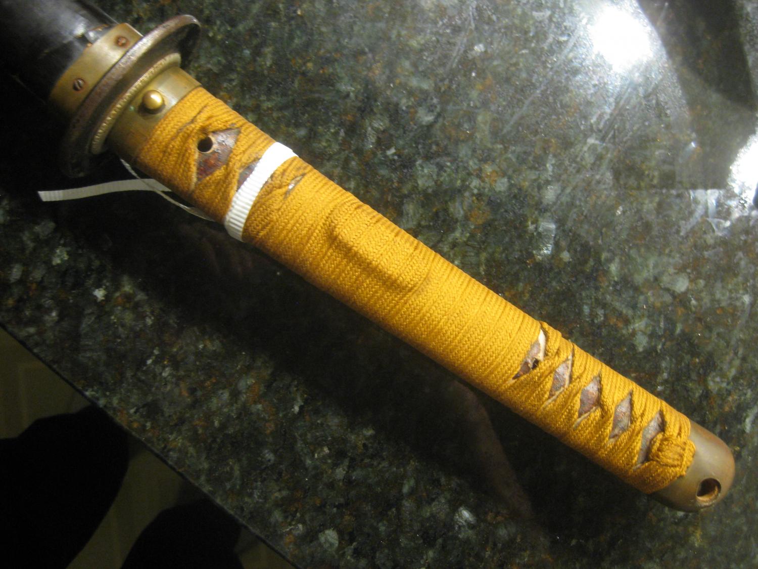

Same style tsuka...
Thanks for the pics!  All the rest of the koshirae appear to be identical to my example.  So it seems that this fittings style may have been standard issue at Kokura Arsenal.  What about the blade mei?  Is this the fourth example here of Kokuri Rikugun Zoheisho with no personal swordsmith signature?
