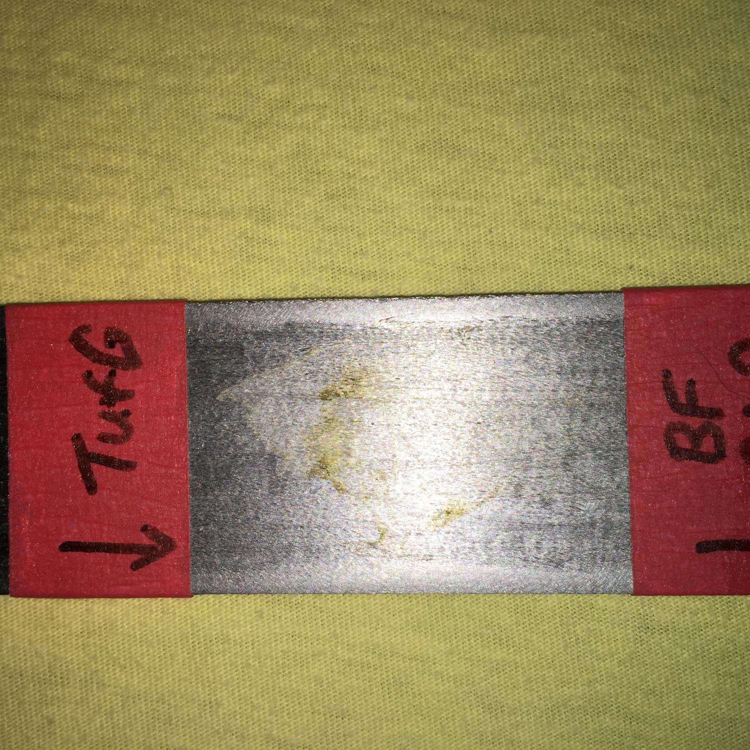

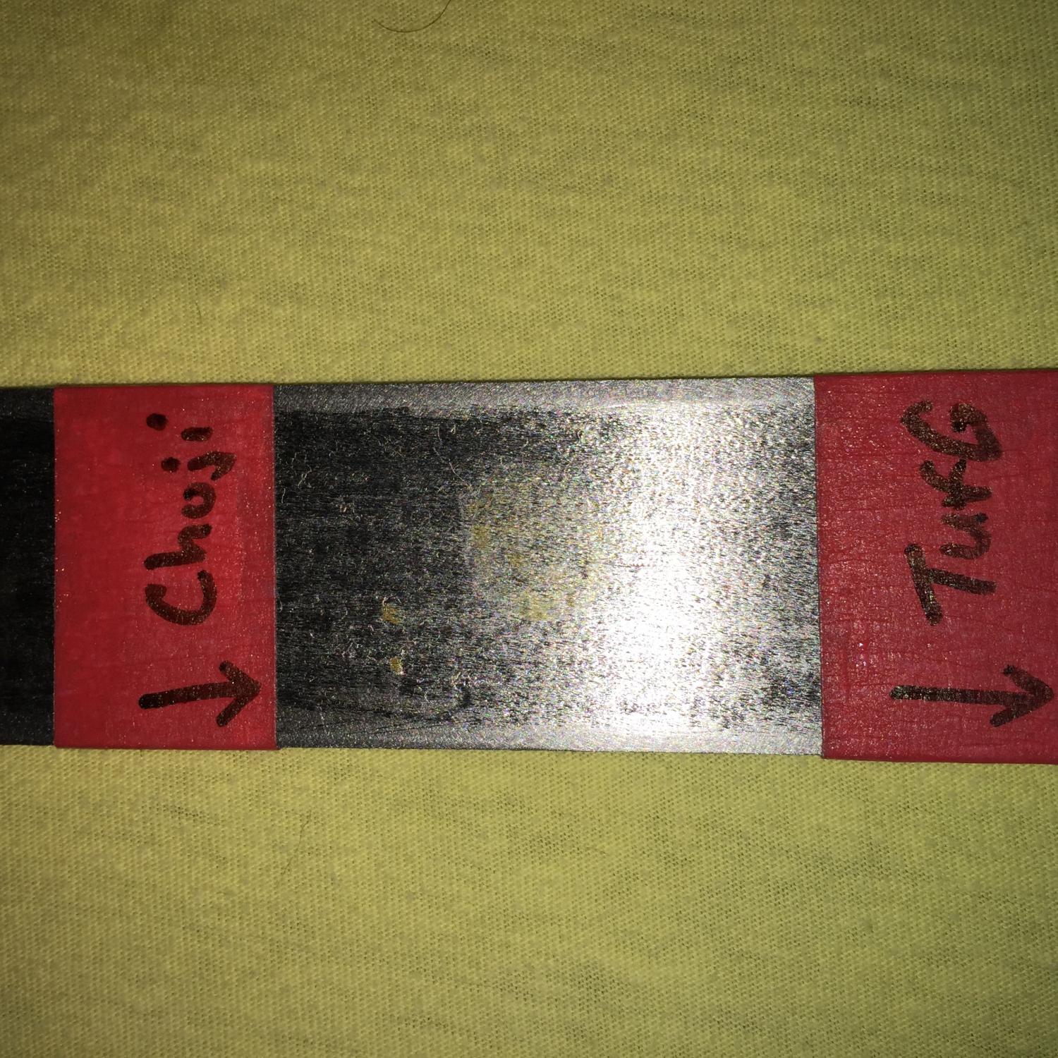

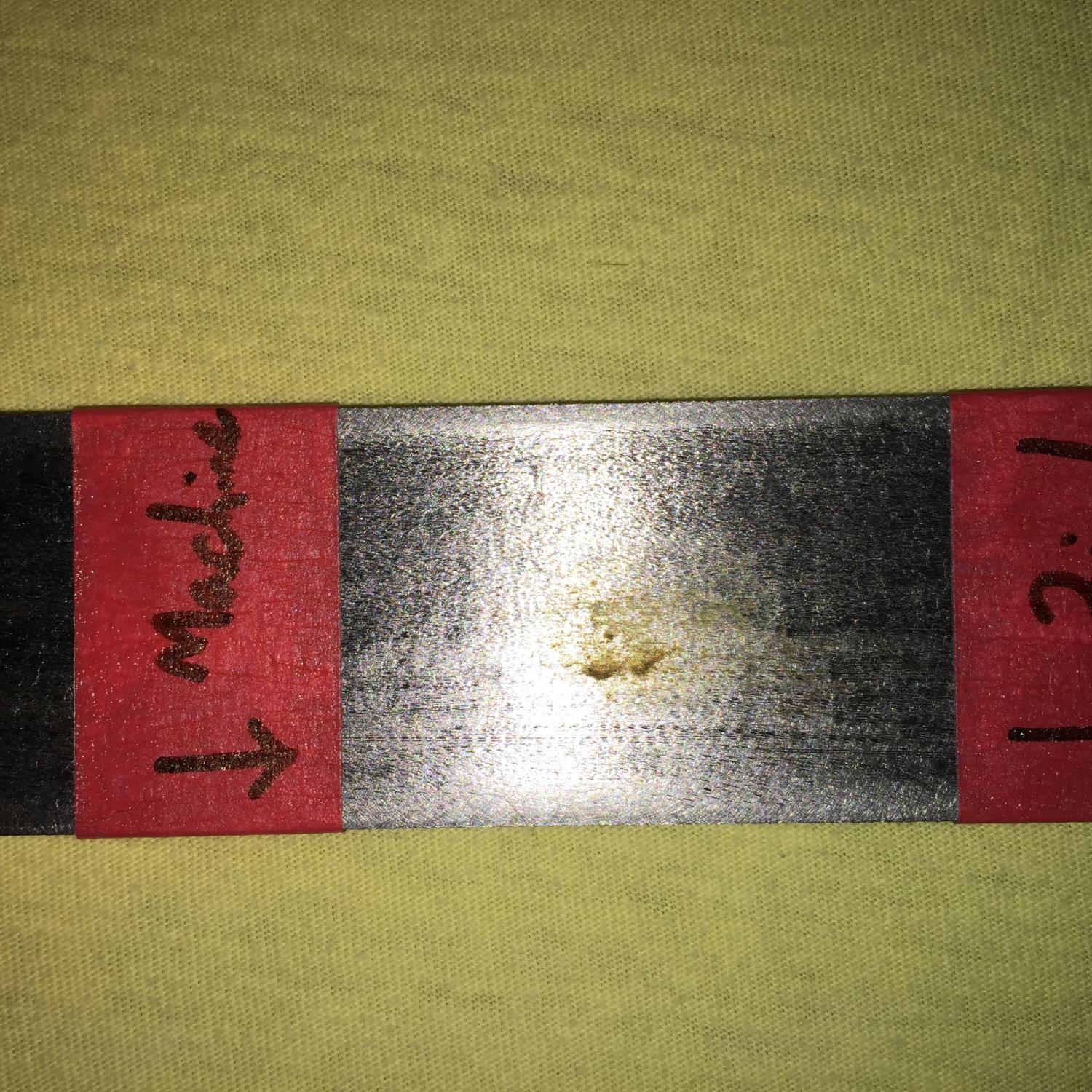

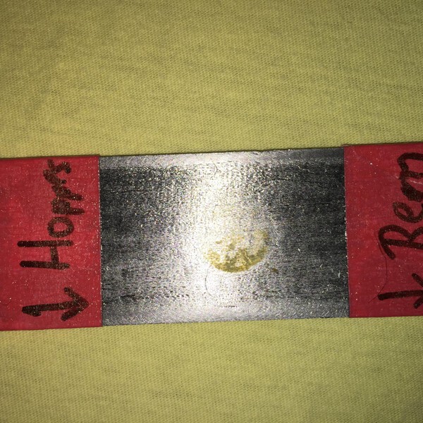

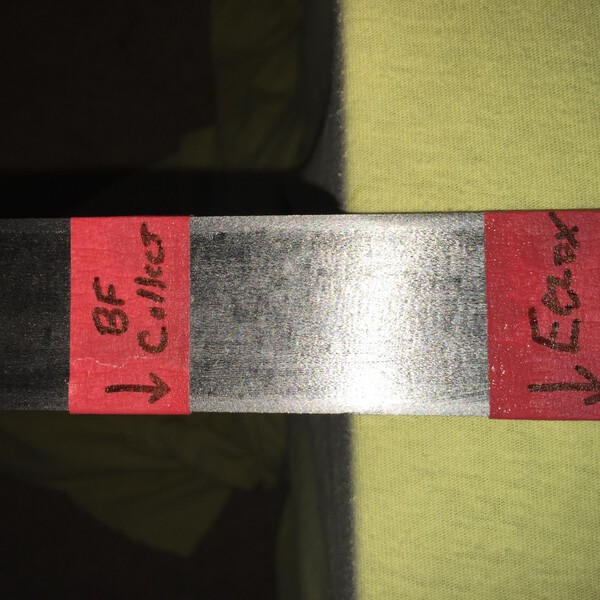

Derek Posted March 12, 2015 Author Report Posted March 12, 2015 Just completed 24 hrs on test 2. Control was rusted. Hoppe's, Singer machine oil, Tuf-glide, and 3-in-1 oil all are very discolored. Choji oil, M-pro 7 had mild discoloration. Eezox, Rem oil, CLP, and Collector had no visible change. After comparing both tests at 24 hrs, the only significant difference was that tuf-glide may have more discoloration than before. Pictures to come... Quote
