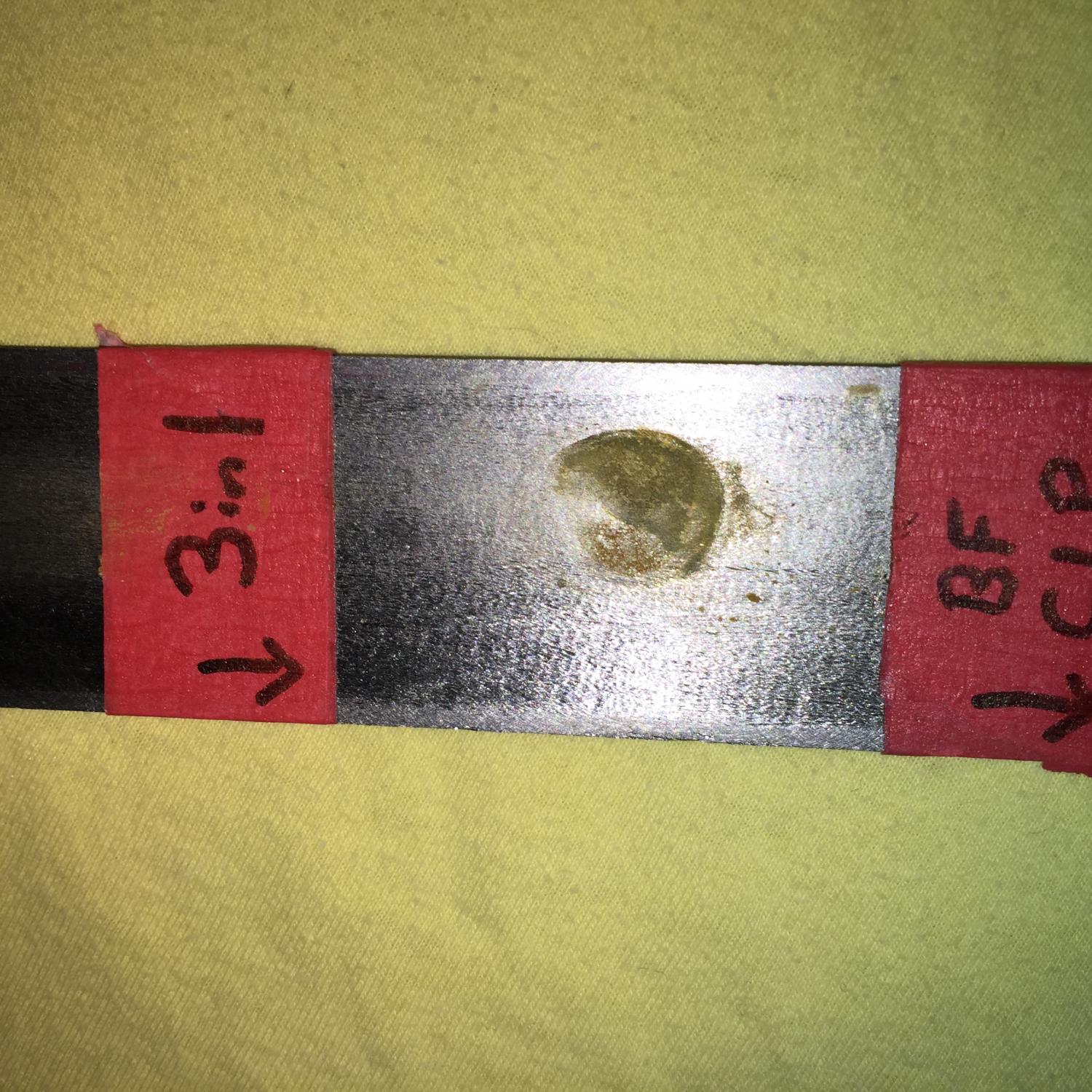

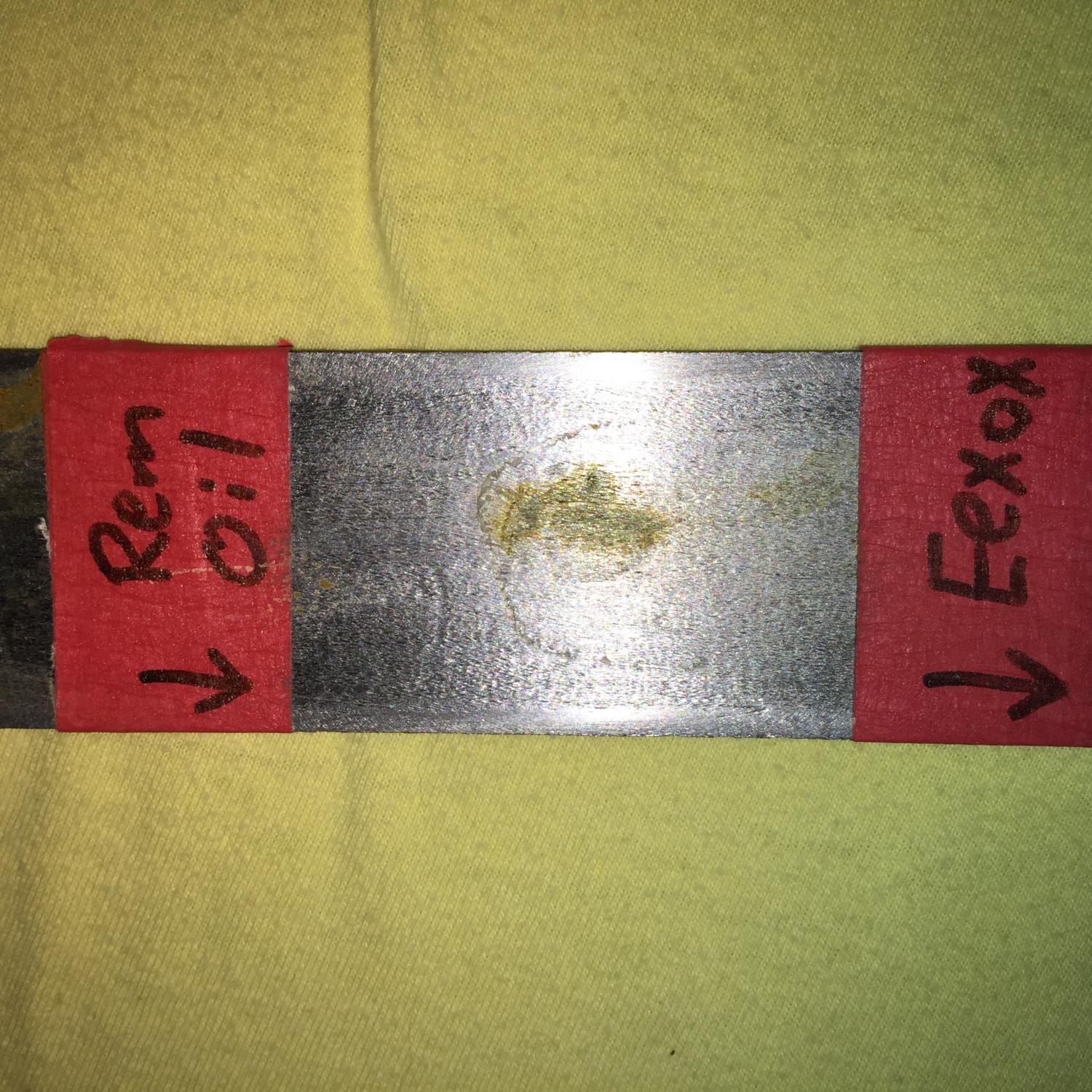

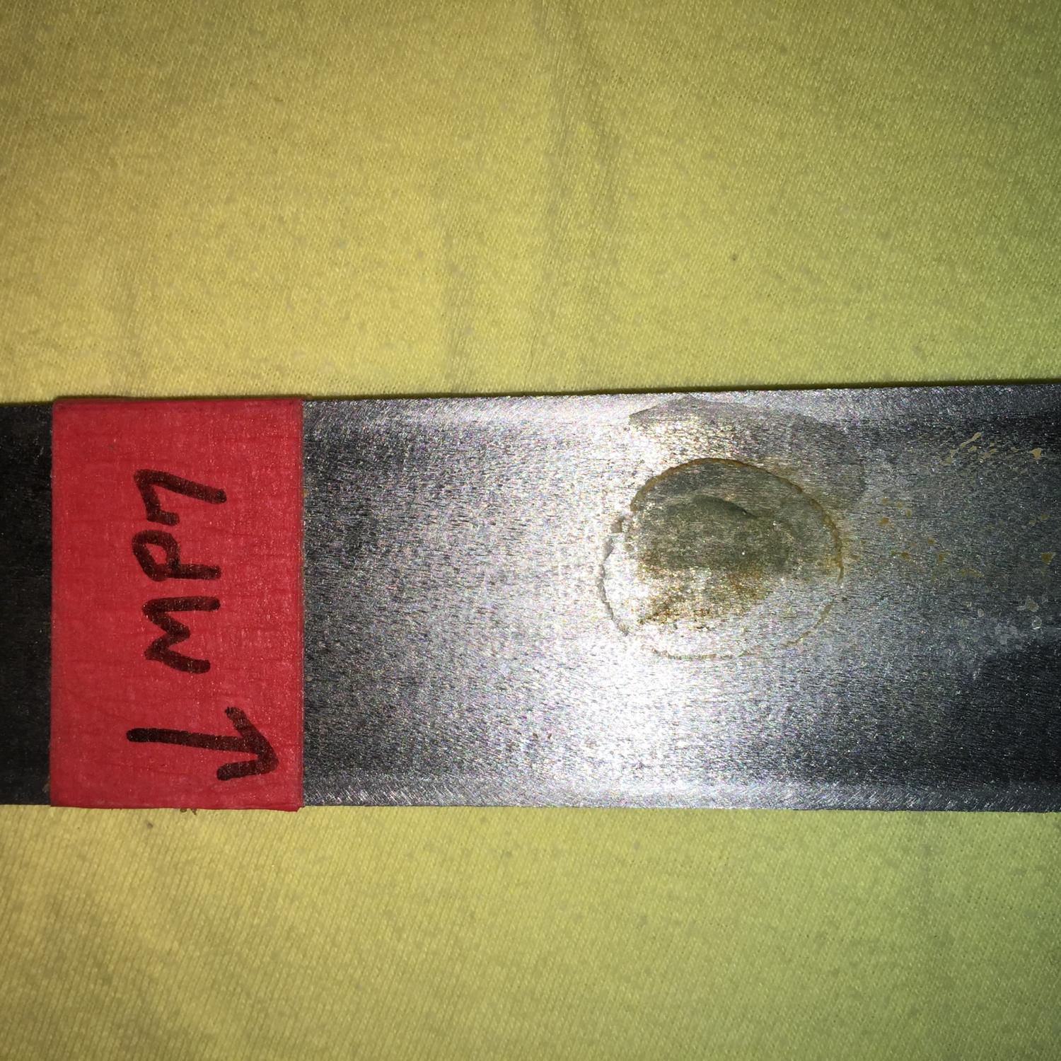

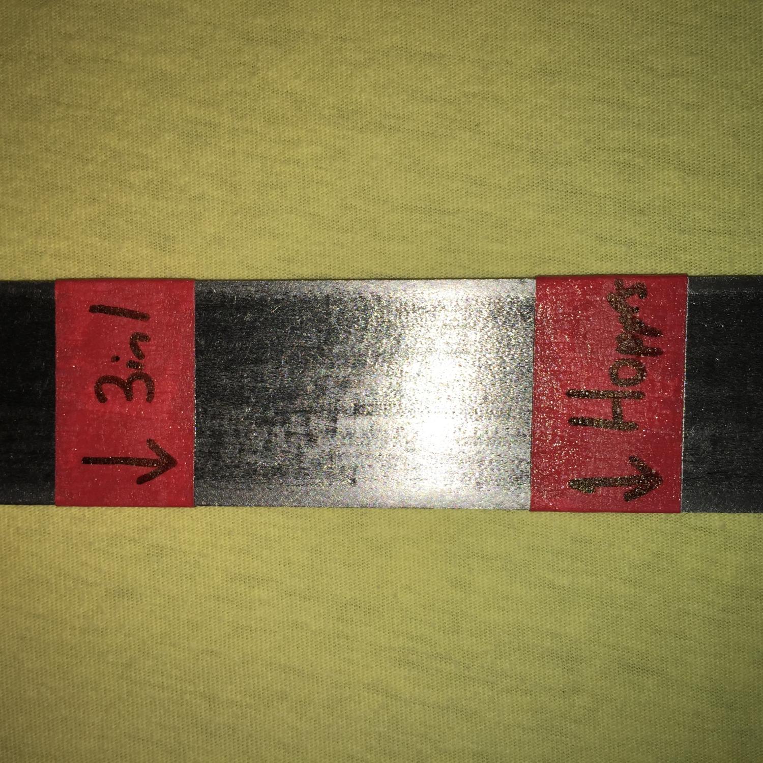

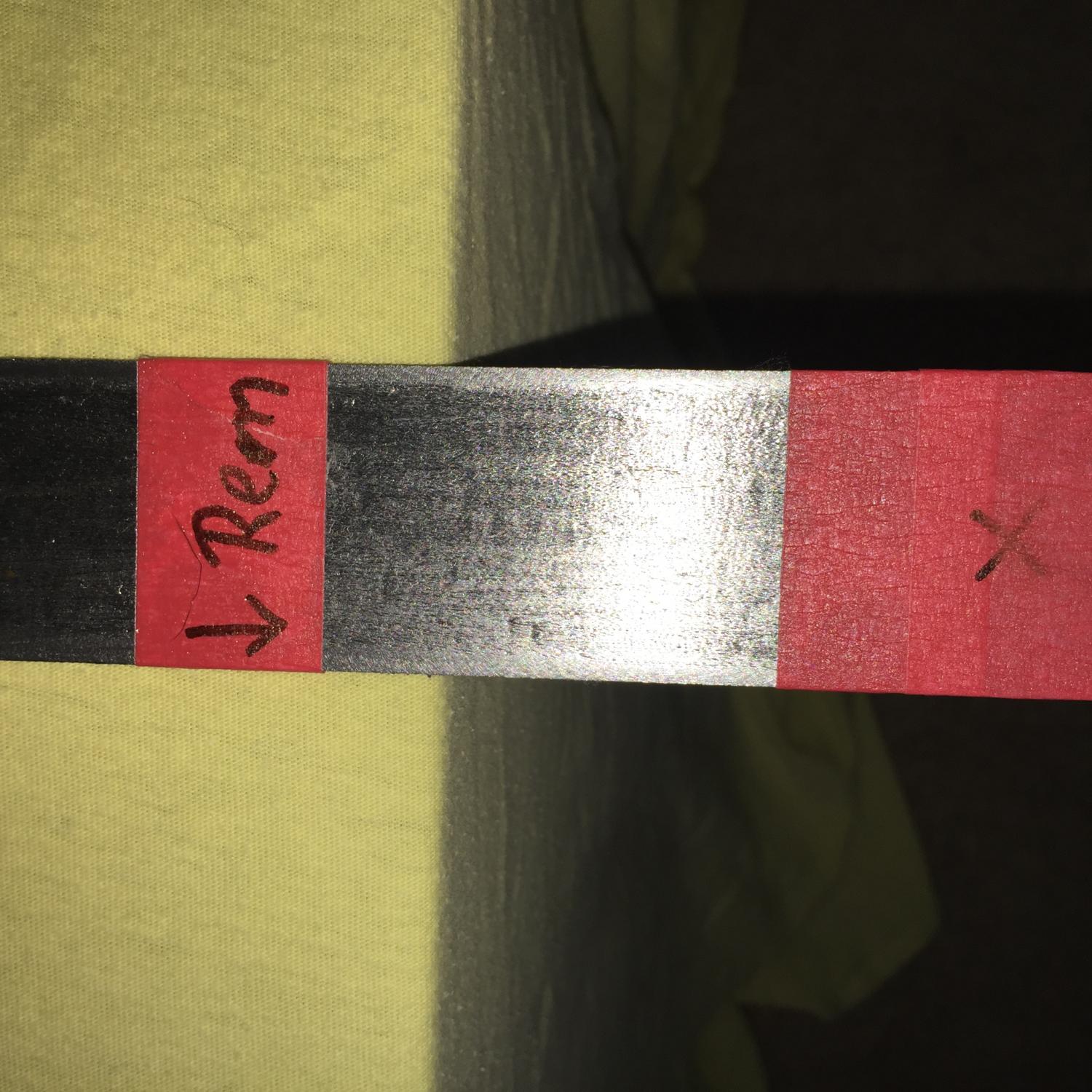

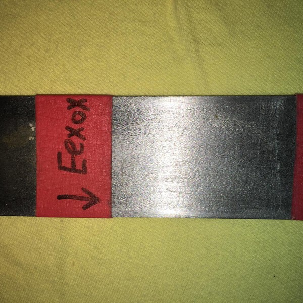

Derek Posted March 12, 2015 Author Report Posted March 12, 2015 Thank you to all who have responded, both here and privately! I know that it's not a perfect experiment, but it's interesting to me. I'm a bit of freak when it comes to this stuff.... I know that choji oil has been used forever, and I respect tradition. On the other hand, uchiko has been used forever, and I think microfiber is a much better option. (As Darcy points out ) Also, as Jean says all the time, many climates don't require oil at all. Our summers in WI are quite humid, so my collection requires oil. I also worry a ton about my Muramasa coming home from Japan with a thumb print from a customs officer... I will be running this whole thing again to verify, but I have already observed some interesting things: Old fashioned choji oil (at least from the big Japan vendor) is excellent. Rem oil did very well on the first run; it offered better protection than choji oil, but with the same thickness. Breakfree collector is very nice, and seemed to offer better protection, but it is really thick and seemed to attract dust. Eezox is intriguing.... It went on easy, no sticky residue, and was the only sample to have no rust. It has a strong odor though, and that odor stays on the metal. I can honestly say that none of the other tested products will go on my nihonto. Next round of tests to come. Quote
brannow Posted March 12, 2015 Report Posted March 12, 2015 Maybe I missed it but did you use a high carbon steel? Also was it a drop of water you put on after rubbing on the oil? Thanks! Quote

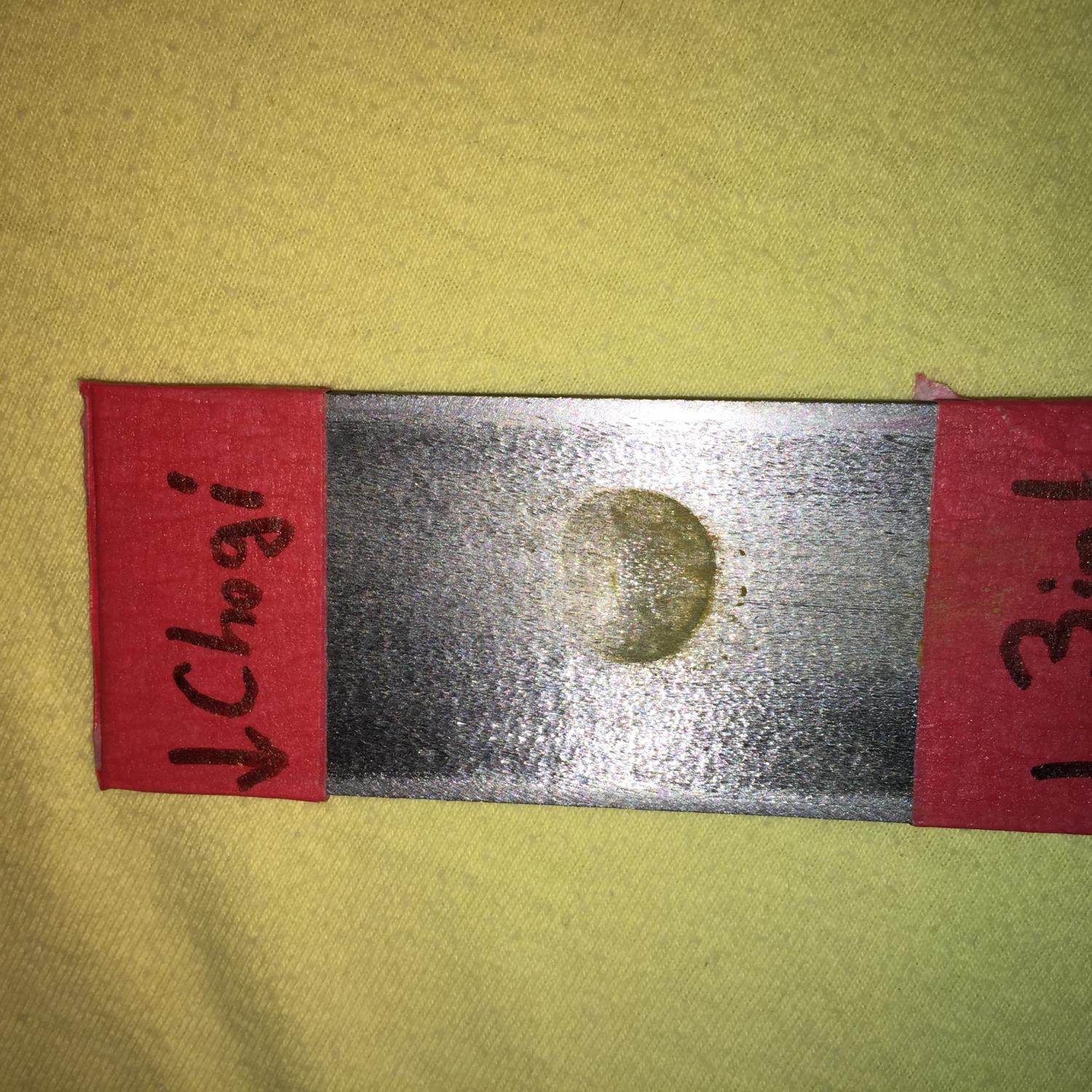

Derek Posted March 12, 2015 Author Report Posted March 12, 2015 Hi Bill, I used Low carbon hot rolled steel. I have some blanks for welding. I ground off the top layer, sanded it with 220, and cleaned it thoroughly. I oiled each section very well, wiped off the excess, and let it dry for ten minutes. I added a drop of 1% saline, then pressed in with my bare thumb. Again, I was trying to imitate a person touching my nihonto with a sweaty hand without my seeing it, then seeing what oil offered protection. Not a perfect test, but I thought it would be interesting. My first test seemed to show that choji oil (From a reputable source) does an excellent job. Rem oil was a bit better. Collector was good, but it had a very sticky residue. Eezox was the best protector, but smelled strongly. Not perfect, but interesting. I will try to replicate these results. Maybe others will try. I'm not trying to tell anyone what to use, just testing what's out there. Quote
Derek Posted March 12, 2015 Author Report Posted March 12, 2015 Chris, I will do some separate tests with the Eezox. I'm interested to know what you find as well. So far, I like everything except the smell. Quote

Darcy Posted March 12, 2015 Report Posted March 12, 2015 I think it's very interesting and I'm glad you did this. About the Eesox probably it is not a good choice. After Chris wrote what he wrote, I checked Amazon reviews and users said that it becomes gummy and builds up. This is also possibly why it's so good at what it does heh. Some oils that "dry" are oxidizing and/or being wicked away by the wood. The oxidation turns them into a kind of plastic and this is part of some wood finishing like with tung oil or linseed oil. Those oils because they do dry (oxidize) make for a durable finish that protects the wood (not as well as lacquer, poly, and other stuff, but they are the basics that come before all of these processes). Not sure if that is part of the process with Eesox... Also read this where one gun owner is saying not to use it due to some major issues: http://www.mdshooters.com/showthread.php?t=158025 And of course they debate it. It's the internet. But worth reading. I read elsewhere it is silicone based. That means that to remove it you'll either have to use a solvent or you'll have to use uchiko. This sounds like bad news to me. Eesox does say it "cures" which means it is oxidizing similar to these old fashioned natural oils. It's basically putting a finish on the metal which is going to protect it similar to the way these finishes would protect wood. Doesn't sound like the right choice for swords. Further edit: reading a lot of complaints on the smell from gun owners (though some seem to like it). Quote

Derek Posted March 12, 2015 Author Report Posted March 12, 2015 Thank you for the feedback! Again, I am not trying to talk anyone into using a certain oil. I just wanted to know what I was using on my nihonto collection, and how it stacks up against alternatives..... What I'm seeing so far is that chojji oil is very good. If you are using it, I think it's a good choice. To be honest though, Rem Oil seems to be just as good. (Maybe better ) Two others seem to offer better rust prevention, but... Collector is too sticky for my taste, and Eezox smells really bad. I have just started the second test, which I will update next. Barry- I think you and I share very similar opinions here. Brian- I like your idea. I may try something like that. My wife may have something to say about leaving an oily piece of smelly steel in our bathroom though. Quote

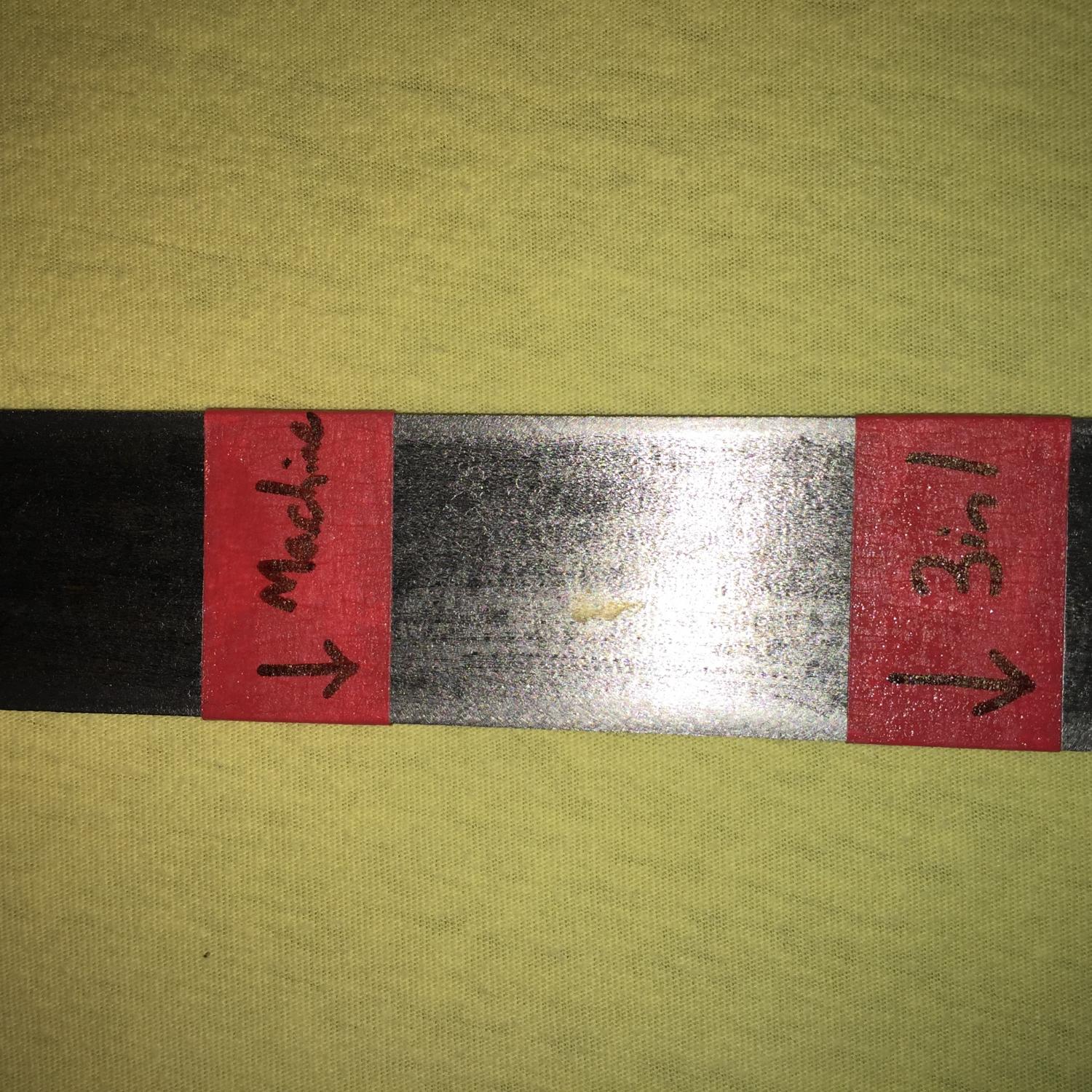

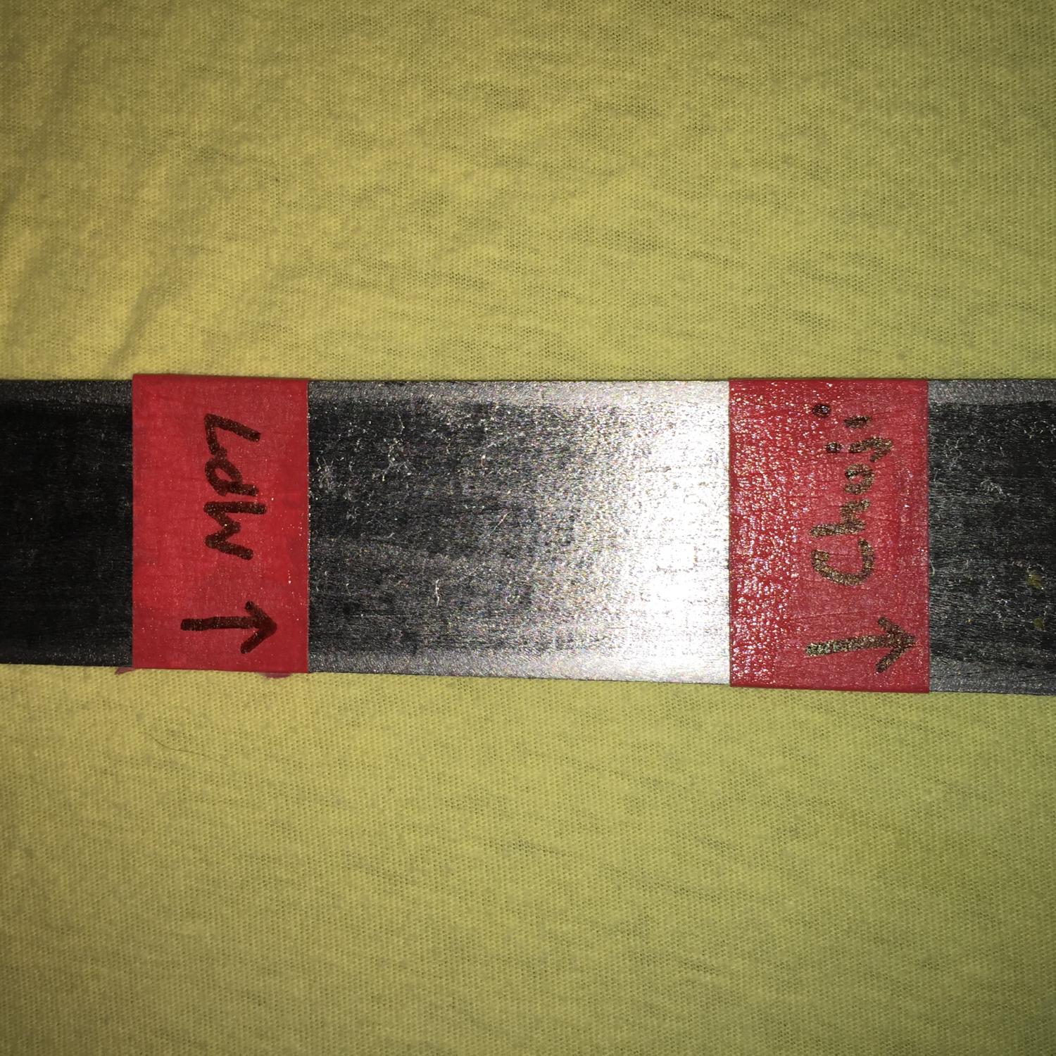

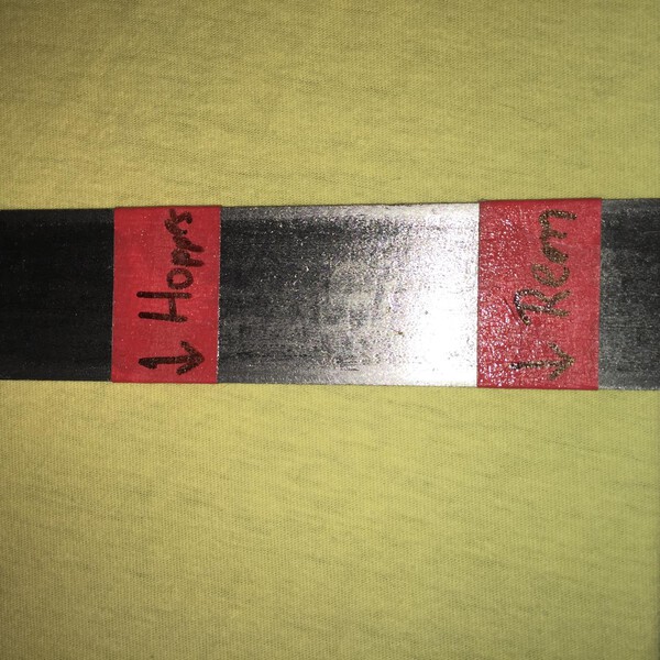

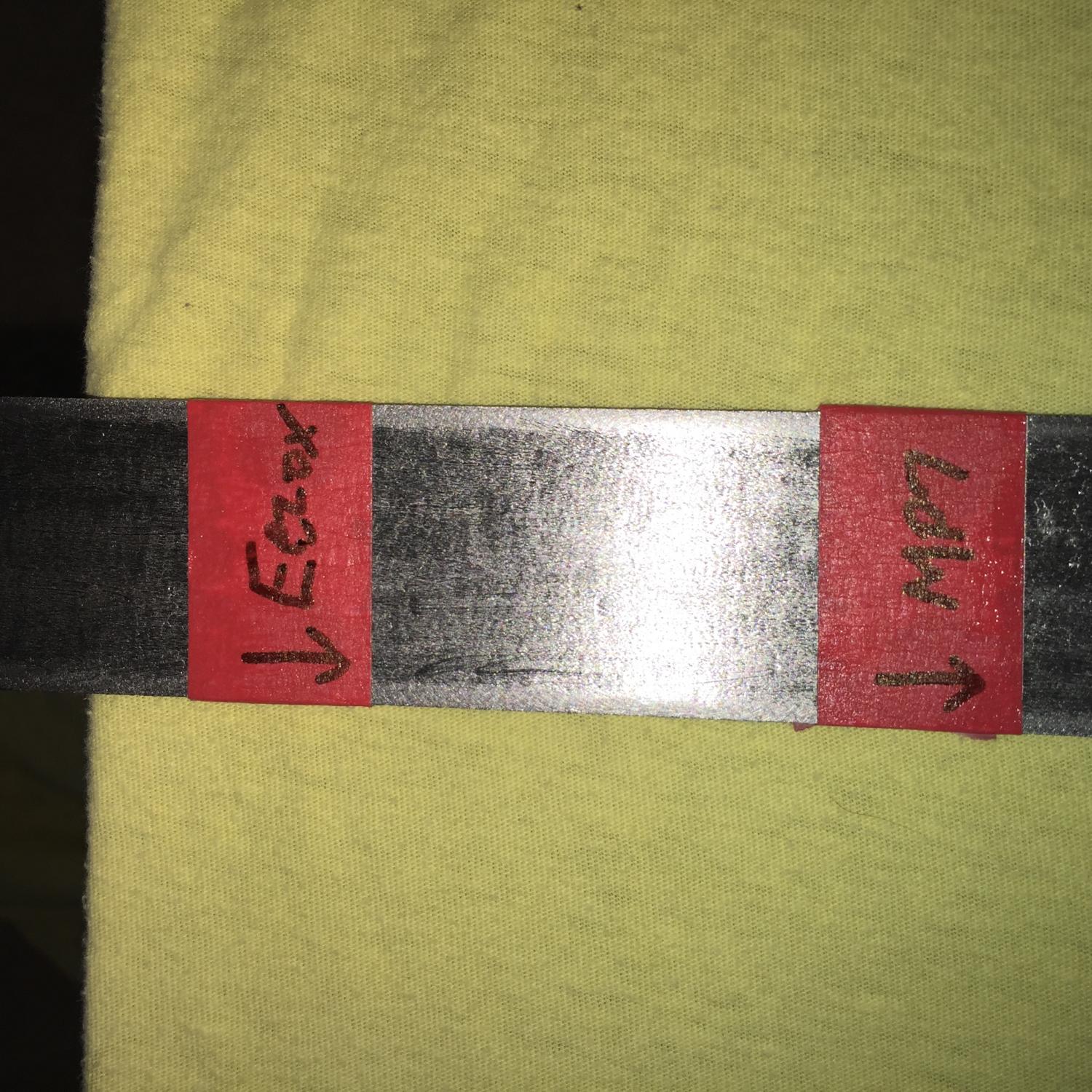

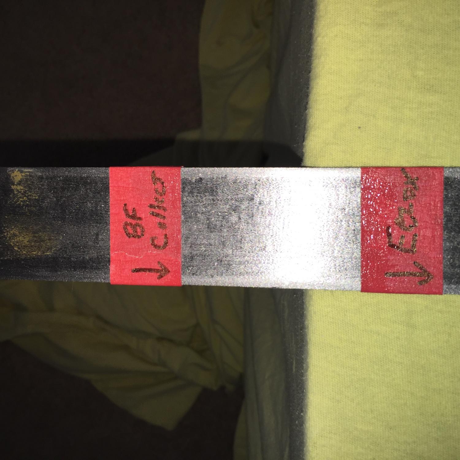

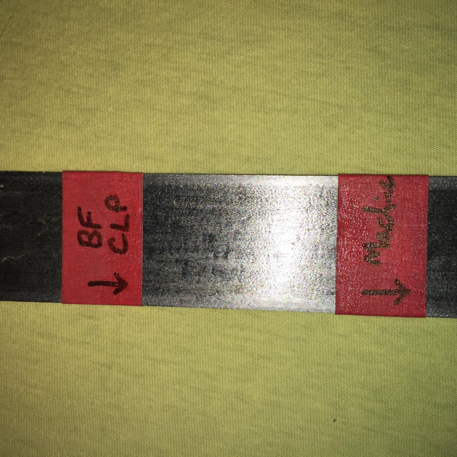

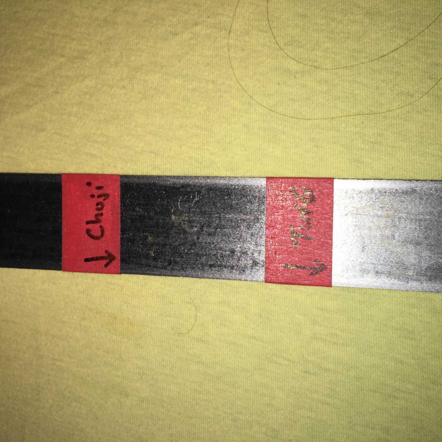

Derek Posted March 12, 2015 Author Report Posted March 12, 2015 I am now posting the second round of the same test. I ground down a new piece of the same type of steel, sanded with 220, sectioned them off, and applied samples of oil in different locations. I then treated with a 1% saline mixture, and pressed my thumb into each area. At 8 hours, control was already rusted lightly. Machine oil was discolored. Tuf-glide had a waxy residue. All other samples showed no change. Quote
