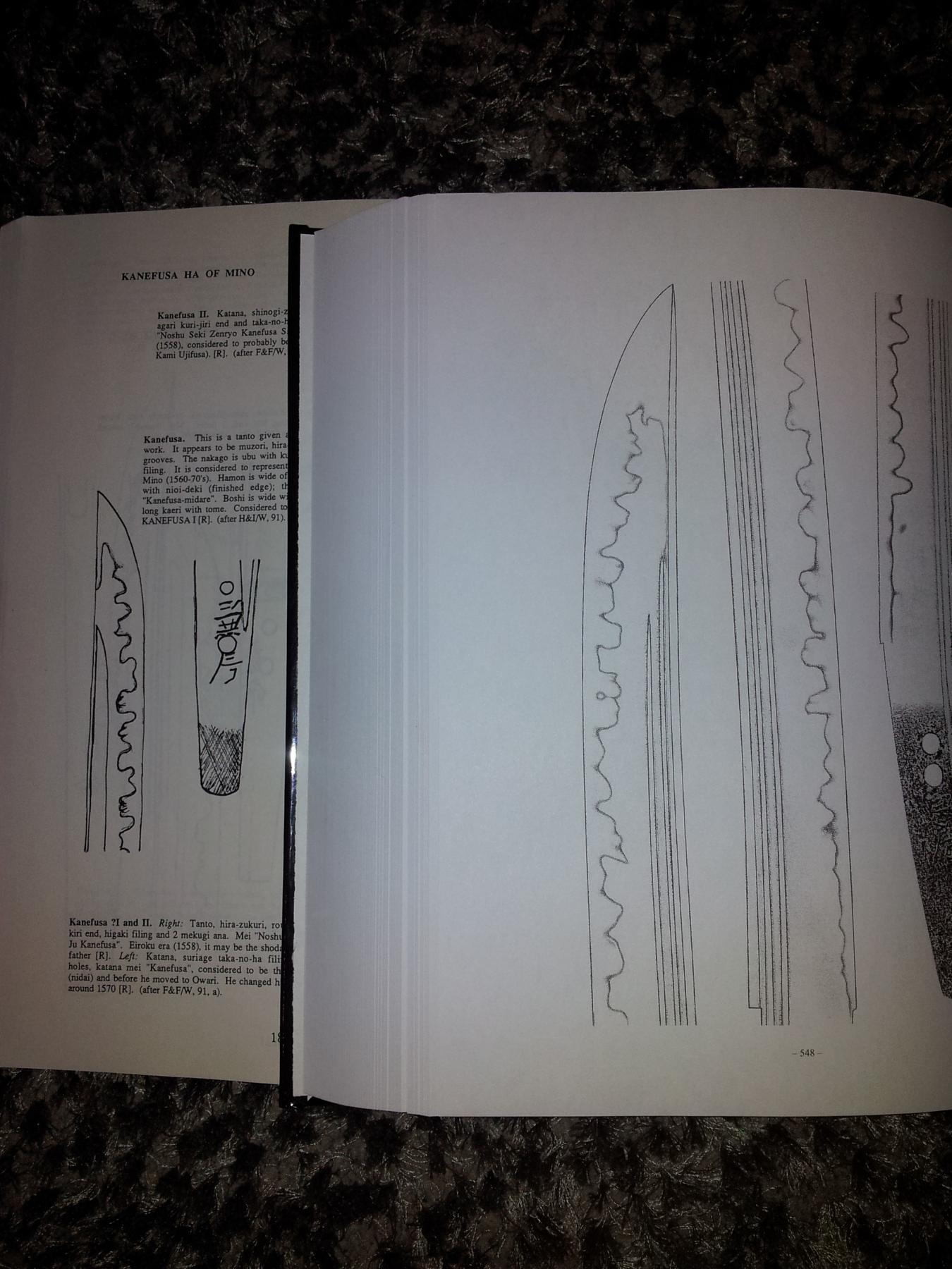

I'm trying to find representative photo(s) of the "Kanefusa midare" style hamon.  I have seen various photos on-line, with the description that it was a unique style/innovation at the time that distinguished that school.  However, I am having a difficult time understanding the "essence" of the pattern, because there seems to be little consistency (to my untrained eyes) across the photos that I have seen so far.  Thank you in advance for any help in furthering my understanding.

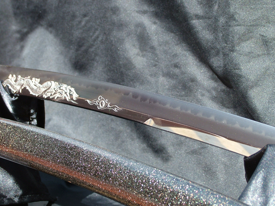

Hopefully these will help. Koto-kantei book states that it's called Kenbô-midare. It's described having roundish yakigashira and narrowing bases. So it would have rounded peaks of hamon. I can PM you few additional pics.
Thank you, Chris and Jussi.  I definitely see what you mean in those photos by the rounded peaks.  But I guess I'm not yet seeing how the roundness of those peaks are so distinct that I would be able to recognize it (without the mei) and think to myself "Ah ha!  That must be from such-and-such school/influence."  More study/practice is needed I guess... :doh: Any more photos would be most appreciated.

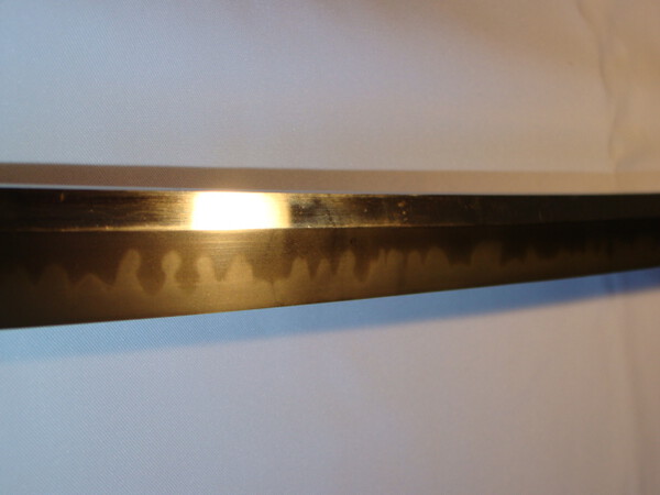

I actually see more of a gunome as opposed to midare but the characteristic you are looking for are the bulbous ends of the hamon.  In some examples, they almost look like large drips.  Here is an example that I owned years ago that dated to late koto times that illustrates a typical Kanefusa.
Robert
Thank you for those pictures, Robert!  I think I have a much better understanding of what to look for now.  :thumbsup:

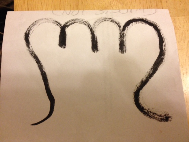

The key to remembering Kanefusa midare is the rounded heads of the gunome that contain ashi. Like the attached drawing, it is sometimes referred to as Kobushi (clenched fist) midare. fwiw
-t
Thomas, thank you so much for that illustration.  It definitely helps a lot.

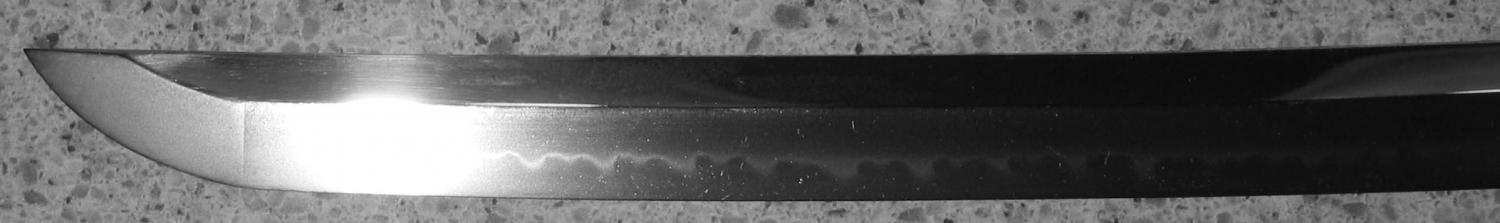

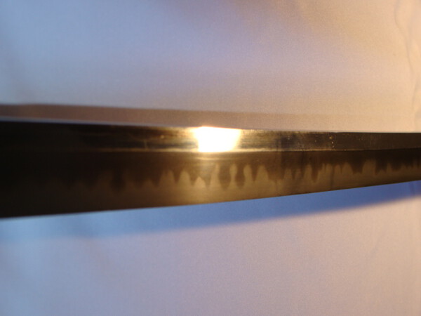

The Midare is not quite the same - this blade has been on the board several times as it is 23rd Kanefusa and / lengthy discussion as it sure as hell looks like a traditionally made - water quenched blade
The throw off was the showa stamp and there ensued an even longer discussion on when and where these were used
So - FYI here you go
