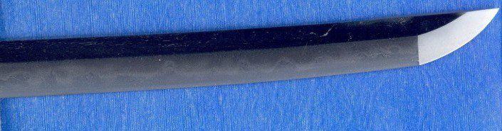

Travis Clarke Posted February 12, 2015 Report Posted February 12, 2015 Hey guys, A friend of mine recently sent me this sword to look over. He's had it for several years now under the assumption that it is Shinto Ishido School work. That was the opinion of the togishi that last worked on it. It very well could be Ishido work. Last week I posted this sword on a Nihonto Facebook group and started a decent discussion. I've had quite a few very good and informative opinions on this sword so far. Some suggested it could also be a ubu Koto Bizen Uchigatana. Before I thoroughly examined this sword and asked around a bit, I originally thought it was O-suriage. The yaki-dashi and second mekugi-ana threw me off. I figured I would post it on NMB and get a few more opinions. A much broader audience here on the NMB. This sword has recently been returned to its owner. He plans to send it away for a new shira-saya and papers soon. Any and all opinions are welcome. Thanks. Quote
nagamaki - Franco Posted February 12, 2015 Report Posted February 12, 2015 On 2/12/2015 at 10:09 PM, Travis Clarke said: Hey guys, A friend of mine recently sent me this sword to look over. He's had it for several years now under the assumption that it is Shinto Ishido School work. That was the opinion of the togishi that last worked on it. It very well could be Ishido work. Thanks. Shinto Ishido School work is quite a reasonable call considering the shape, the hamon almost touching the shinogi in the monouchi, the tight-er hada, along with other details. Don't see Koto Bizen here. P.S. nice clear images, camera? lighting? Quote

Brian Posted February 13, 2015 Report Posted February 13, 2015 I would go with ubu, not o-suriage. The hi and nakago patina don't lend themselves to suriage, neither do the sugata.I also don't see a lot of Koto Bizen there. Hada looks tight, wouldn't be surprised if it came back Shinto at all. Nice thick nie too. Brian Quote
Travis Clarke Posted July 14, 2015 Author Report Posted July 14, 2015 Greetings, Just a little update. This sword has been professionally re-polished and submitted to NTHK Shinsa in Japan. The verdict.......Sue Koto Bizen. Either Katsumitsu or Kiyomitsu. I'm only getting bits of information so far. I'll update this thread again when I find out more. Quote
hxv Posted July 14, 2015 Report Posted July 14, 2015 How interesting and unexpected! I was thinking Shinto Ishido surely, especially given the flamboyant hamon and how the boshi is not a continuation of the hamon. Thank you for sharing, Travis. Regards, Hoanh Quote
lonely panet Posted July 14, 2015 Report Posted July 14, 2015 the double mekugi ana is pure sue koto sukasada, but the im just a stunned as everyone else with kiyomitsu/katsamitsu why is this not signed, its far higher then most sue period blades regards H Quote
Brian Posted July 14, 2015 Report Posted July 14, 2015 Yeah..... I'm not getting Sue Bizen Koto. Oh well... They know far more than me... Brian Quote

Travis Clarke Posted July 21, 2015 Author Report Posted July 21, 2015 Hey guys, Here's my newest bit of information regarding this sword. Bizen Osafune Katsumitsu, Eisho (1504-1521). I think it scored around 75-76 points. Quote

Jacques Posted August 19, 2016 Report Posted August 19, 2016 Nie deki, many tobiyaki, roundish gunome no nioi ashi : not a shinto Ishido Nakago, boshi : not a koto Bizen Quote
Stephen Posted August 19, 2016 Report Posted August 19, 2016 not Katsumitsu , id expect tight crabclaw hamon. More swirling hada. Quote
Jean Posted August 19, 2016 Report Posted August 19, 2016 The blade is machi okuri and probably slightly suriage. I had a Tadamitsu slightly suriage with such kind of nakago jiri. Concerning the boshi, no opinion as thousands of Bizen swords were produced, but it looks like that NTHK jury has seen such kind of boshi on sue Bizen blades. Quote
paulb Posted August 19, 2016 Report Posted August 19, 2016 something that might help the assessment. I was recently looking at a number of Bizen NBTHK kantei. From their description I noted the following: it there is a tight nioi-guchi, tight itame hada with some nagare, masame in the shinogi-ji and the blade is thick it is unlikely to be koto but most likely shinto or shin-shinto. The best way I found to differentiate between Ishido smiths is to look closely at the boshi. There are a number that produce very distinctive shapes. In your pictures ( in which it looks to be a very nice sword BTW) I cant see the boshi clearly nor can I tell how difuse the nioiguchi is, that probably has more to do with me than the sword, the polish or the images Also the dimensions and shape will offer further clues. Quote
nagamaki - Franco Posted August 19, 2016 Report Posted August 19, 2016 On 7/21/2015 at 2:59 AM, Travis Clarke said: Hey guys, Here's my newest bit of information regarding this sword. Bizen Osafune Katsumitsu, Eisho (1504-1521). I think it scored around 75-76 points. Hmm ..... http://www.sanmei.com/contents/media/A10938_S5501_PUP_E.htm Quote
Travis Clarke Posted August 20, 2016 Author Report Posted August 20, 2016 Hey guys, Here are a few of the swords measurements. I appreciate the comments and discussion so far. Nagasa: 61cm Sori: 1.3cm Kasane: 0.8cm (Yokote Kasane: 0.5cm) Mihaba (machi): 3.1cm Mihaba (yokote): 2cm Quote
