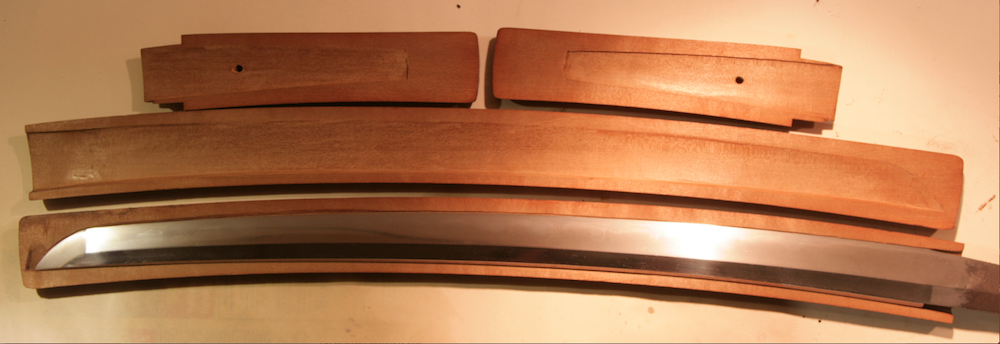

Hi Eric
I am not one to pre-judge your skill set but: a shira zaya is a resting zaya and its construction is an art in itself. Improperly made it will damage the sword, every time it is housed and drawn, that of course is contrary to the purpose of the item.
Also as already pointed out, wood choice is very important, wrong choice and your blade can ‘R I P’ (rust in piece).
Get some reading on the art of zaya making it is a craft. The Craft of the Japanese Sword. L&H Kapp, is a good reference on several aspects, and includes Kazuyuki Takayama’s scabbard making.
As a guide see what a Japanese Zaya of some age looks like when opened.
This has been opened by a skilled man, to check the cleanliness and re fit after a blade polish.
He was delighted with the original workmanship, both in fit and interior finish. Nothing needed doing.
I am privileged to own such an art work, to house my blade.post-2022-0-88134800-1423659799_thumb.png
