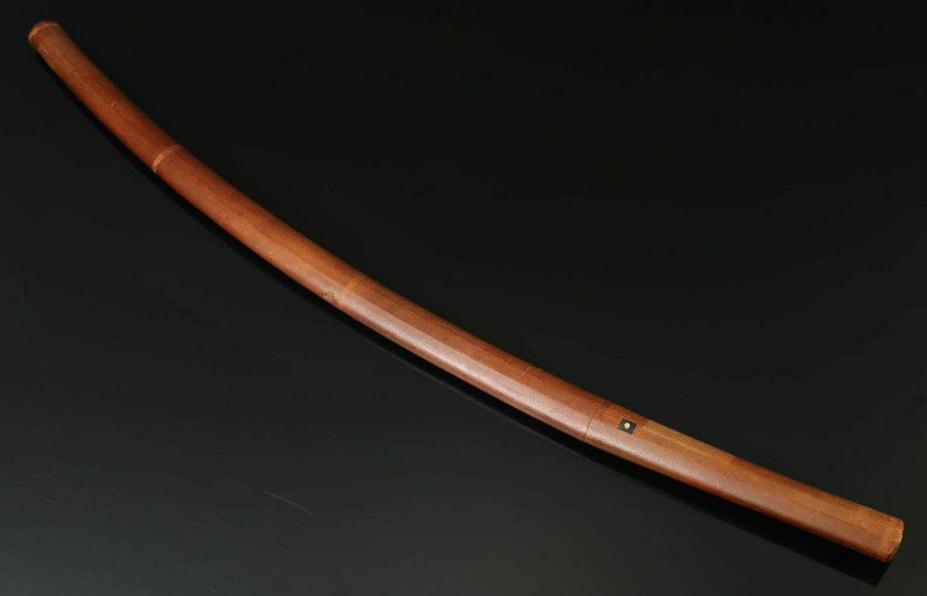

The nagasa is 71,5 cm long and 2,8 cm wide , 0,6 cm thick ,nakago is 17 cm long, Sori 3,8 cm.
Shirasaya total length 101,5 cm.

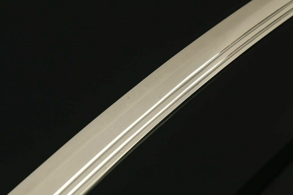

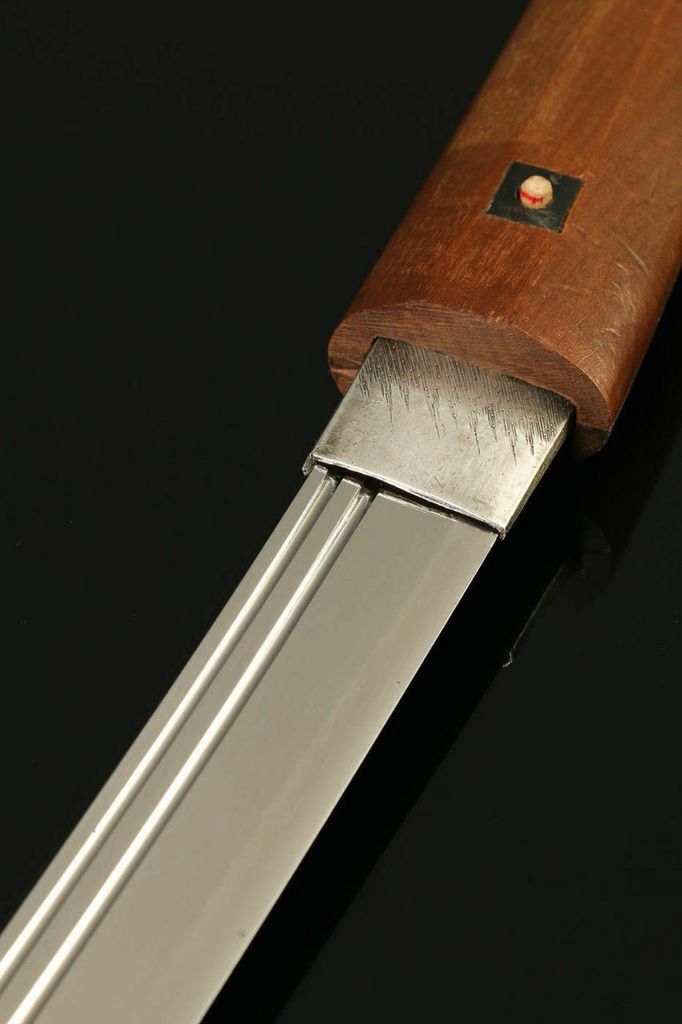

It is indeed nice photos ,but I cant take the credits. Its from the auction House.
Hamish,
The pictures are average at most. If you want to see good pictures see Nihonto.ca or Aoi Art web site or http://nihontofrance.com or Yakiba.com. Apart the nakago, there are absolutely no visible details of the hada or the hamon. The general view of the blade, is taken at such angle that IMO, it gives a false representation of the blade length, due to distorsion

It seems to be a very interesting Yamato blade.
Hoping that you'll be able to take better Hada and Hamon pictures next shot, for the eyes pleasure ;)

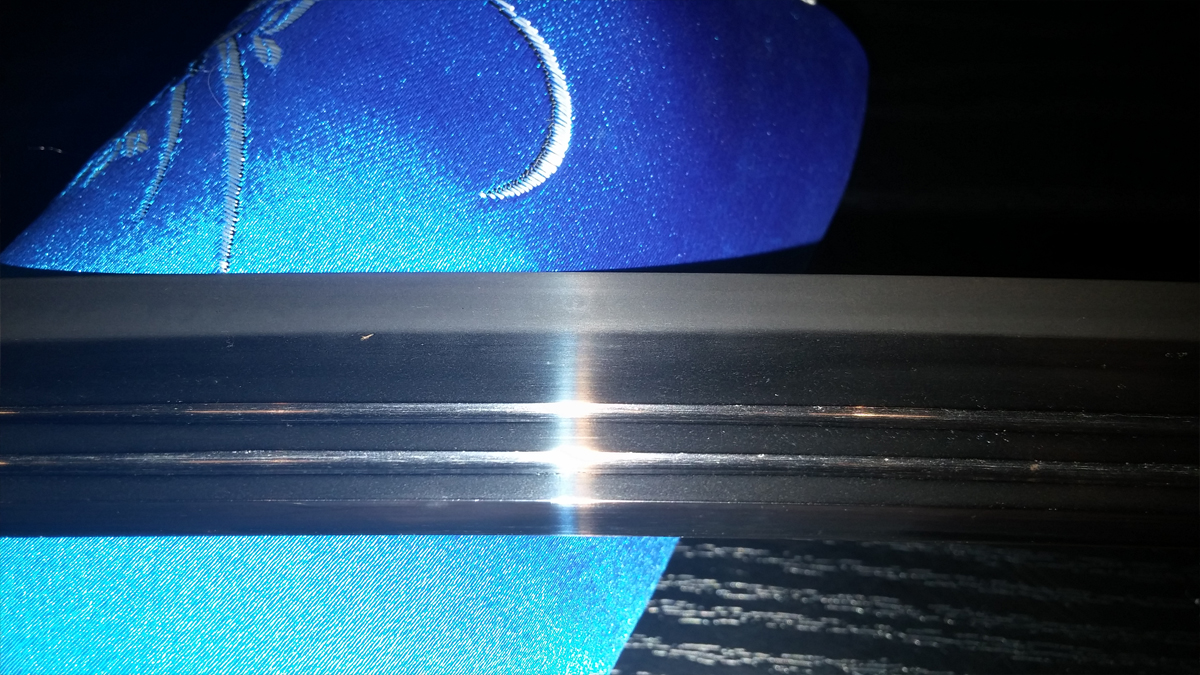

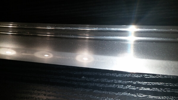

I looked at this blade the other day and are posting those pictures on behalf of Thomas. Pics are shot with my mobile, so please forgive me for the quality.
Guessed at first glance it might be yamashiro or ko-mihare school, but...

You must have seen hundred of swords side by side to be able to spot a dark hada above all on pictures. Uda hada is unmistakable and rough compare to this one. Mino, I don't think so. Blades are less refined. Could be Yamashiro...
Jean, this is why I said the last picture "seems" to show a dark hada. we all realize swords can look different in different pictures. unless held in hand who knows. I do agree with you that the latter uda are ruff, however earlier smiths are quite nice and a lot better quality. regardless , I will stay on topic and say I like this sword very much. look forward to more info and pictures on it. I didnt catch the first kanji but you folks seem to have it covered :clap:

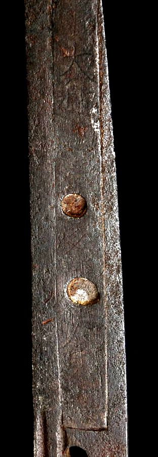

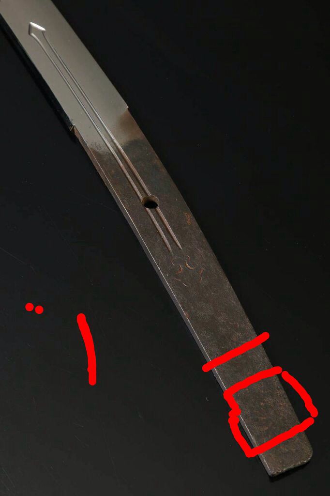

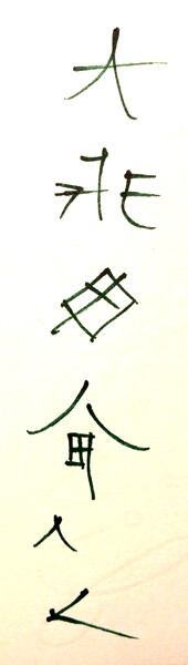

This has been a very long sword once . I have drawed the habaki where it was mounted first time. The Line over the habaki is where the handle of the ken sword ends ,there are faint marks from the engraving.
When we looked at the sword, I tried to write the (very faint) mei the best I could (yes! -I know im not good at it ;))
However I agree what James say, that the 和 (Tegai) kanji is not far from what I wrote... Here is the paper I did. Hope it may lead the investigation further...
I think this sword may well be saiha. The nakago looks deteriorated, the sabi-giwa area looks artificial.
Also, the curvature is a bit strange.
I sincerely hope that I am wrong.
That was an idiotic remark on my part, apologies :-)
As Martin has rightly (if ironically) pointed out, machi okuri is part of o-suriage. I have adjusted my post, accordingly. Thanks, Martin :)
Again, my suspicion that this sword is saiha, is pure speculation, based on the colour of the nakago (or the sabi giwa, to be precise). I'd love to see the hamon - it looks dull in the pictures...
Then again - the red colour below the machi - this could be just some rusting under the habaki...
